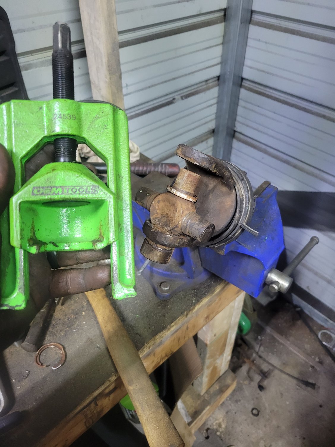

Had to put a new wheel bearing in the 250 today. It went out on way home from work Thursday, and ended up having it towed home. Went ahead and knocked out the Axle shaft U joint while I had it that far apart. Those U joints really tested that puller.

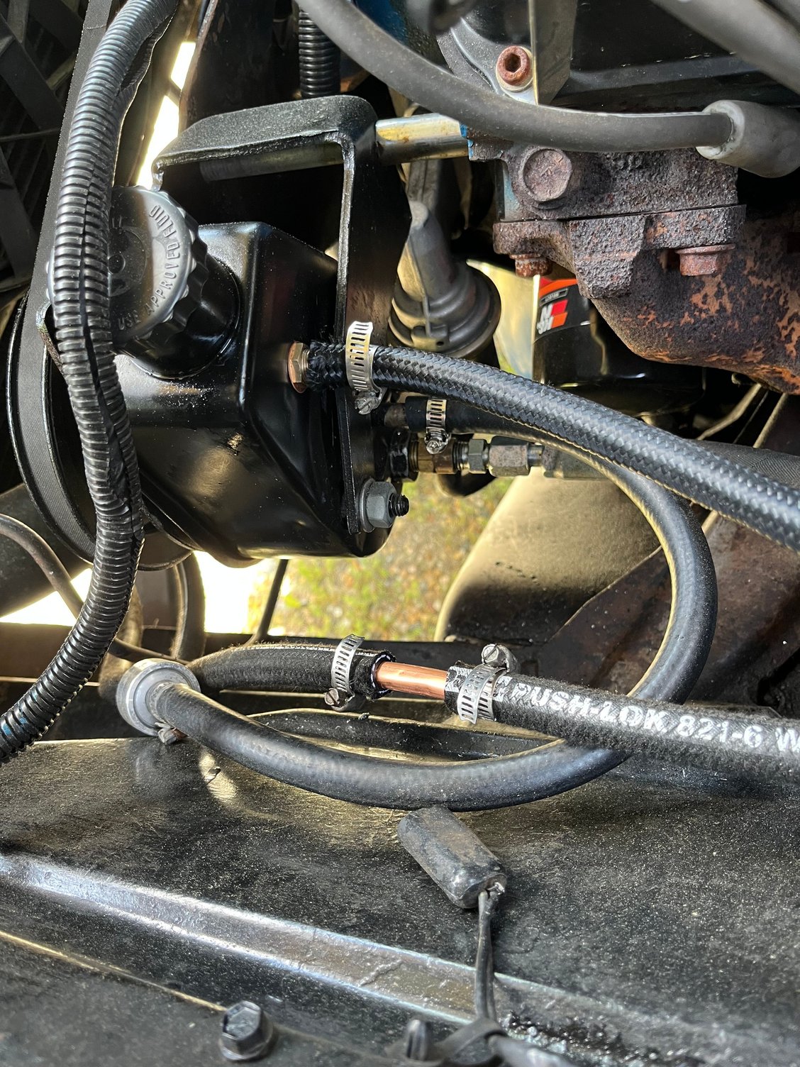

From my previous posts about my brake issue, you might remember that whenever I would start the engine, the brake pedal would go down as the pressure from the power steering pump built up in the hydroboost. My theory was that due to sharing a return line with the power steering box, it just couldn't evacuate the pressure fast enough.
So I made the decision to put a hose barb bulkhead into the housing of my power steering pump.
This is the bulkhead I went with. I wasn't sure about the amount of surface area for sealing, so I JB welded a washer onto one side, and then when I installed it, I used a soft copper washer on inside and outside.
I stuffed a paper towel down inside before I started drilling, and I packed the step bit with grease with hopefully catch all the shavings. Between those two cautions I think I got 99% of anything that came through.
I put a 7/16 bolt with washer on both sides in the hole first and cranked it down nice and tight, so completely flatten any wayward jagged edges, etc. Made sure it was smooth to the finger on the inside and outside before fishing the fitting into place.
I positioned the hole high enough to avoid the internals of the pump, but low enough that it should be completely covered under normal operating conditions. I used tape on the inside of an open end wrench to hold it while I fished it in place, and then pulled the tape out with a little grabber thing.
With the hose in place and my tee removed & replaced with a short section of 3/8 line, it seems to work fine. No leaks (yet!) and the brake pedal does not move on it's own when I start the engine now. I can put the truck in reverse and it will idle backwards, whereas before I had to give it gas to overcome the brakes. So I think this particular problem is solved. I'll road test it tomorrow and see how she does.
*knock on wood*

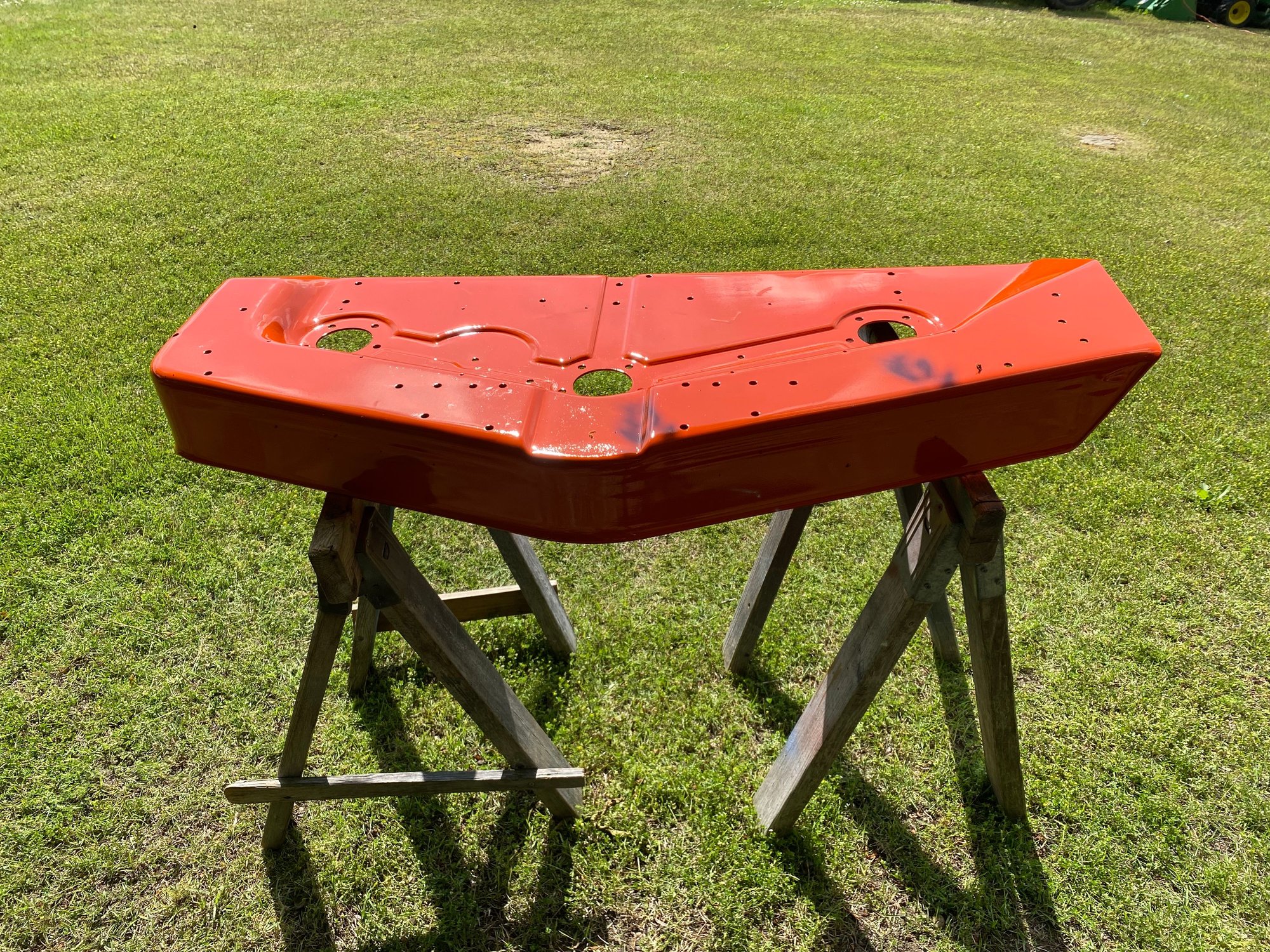

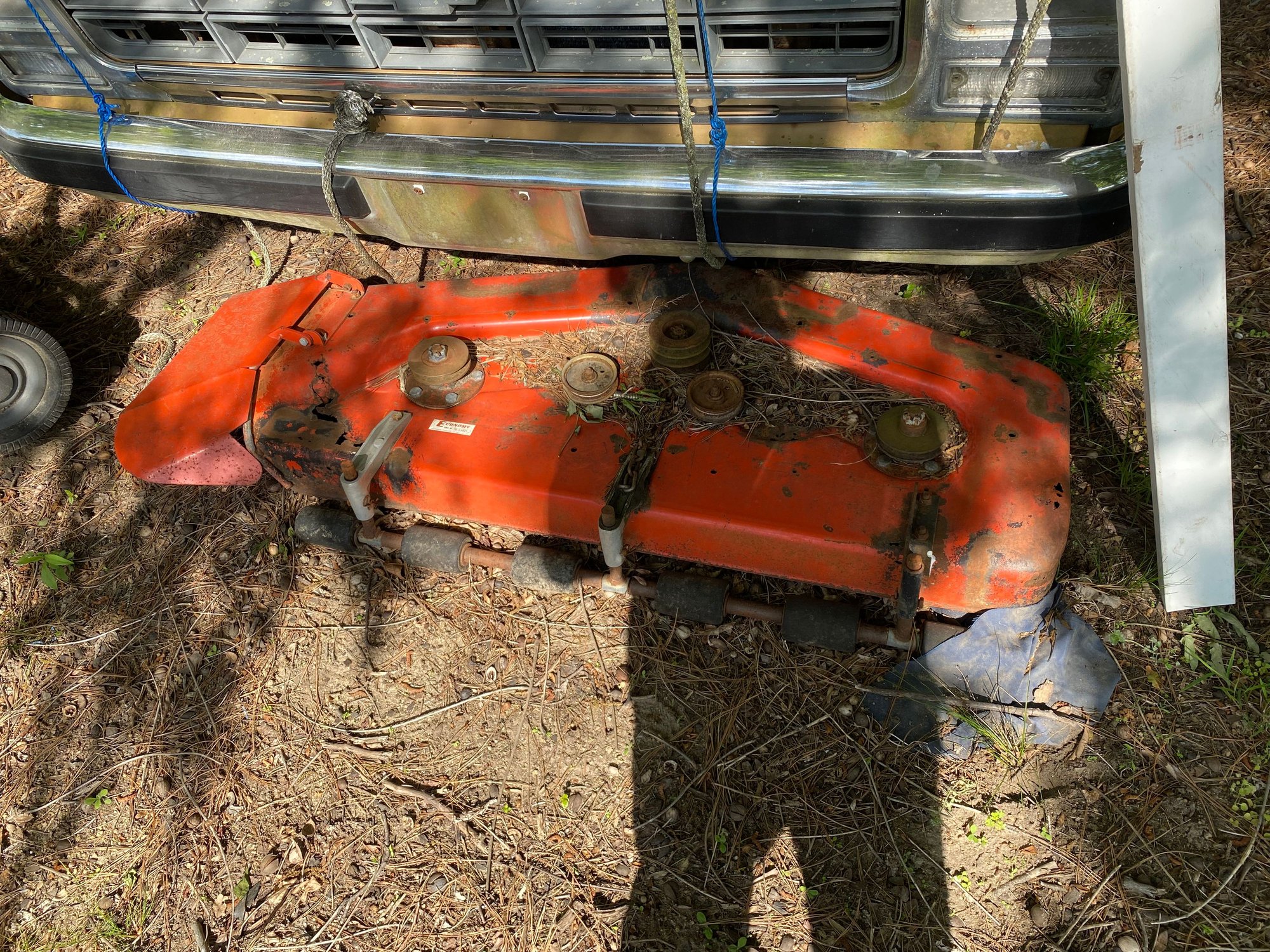

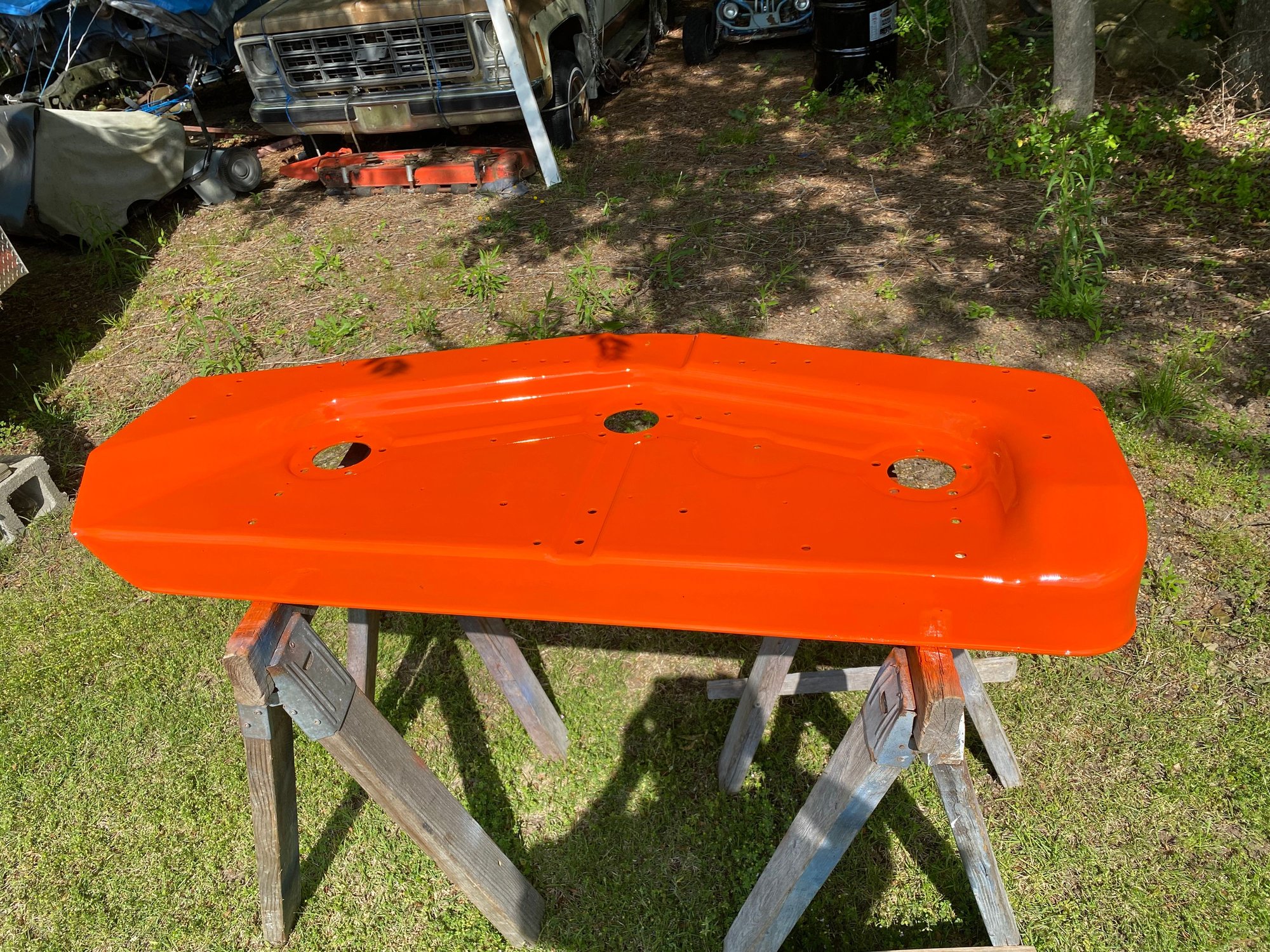

got my new mower deck painted today finally. Have had it a few weeks but the weathers not been cooperating to paint it. The old deck wasnt salvageable. BUT i can still use all parts off the old deck and put them on the new deck.
Old May 6, 2023 | 10:12 PM
  #3400
FuzzFace2's Avatar
FuzzFace2
Posts: 30,912
Likes: 4,123
From: Angier, NC
What did you coat the under side with as they rust from under out.
Dave ----
Old May 6, 2023 | 11:03 PM
  #3401
Sparky83's Avatar
Sparky83
Joined: Jan 2009
Posts: 80,535
Likes: 97
From: Norlina NC
Dave ----
it was powder coated black to begin with from the mfg. right now im just painting it to match the original color it should be. Once i get the color coat done i was thinking about spraying the underside with some kind of bed liner.
Old May 7, 2023 | 04:01 AM
  #3402
Cracker289's Avatar
Cracker289
Joined: Jul 2003
Posts: 2,730
Likes: 20
From: Four Oaks, NC
I wonder if red glyptal would be a good choice for painting the underside!
Old May 7, 2023 | 08:30 AM
  #3403
FuzzFace2's Avatar
FuzzFace2
Posts: 30,912
Likes: 4,123
From: Angier, NC
Well it looks good for an orange machine
At first I was also thinking bed liner but it would be hard to clean / hose off once in a while that I do mine so as fast as it popped in my head out it went LOL
If it was powder coated then that may be enough for now till stones start chipping at it.
Also I dont know what all would stick to powder coat as a 2nd top coat like Glyptal?
I also dont know how strong Glyptal is from chipping?
I know it sticks pretty good in the lifter valley of motors.
Between season's I should pull my deck, clean it and coat it even if it just paint, as it is hard to find a 60 inch deck for my model JD tractor.
The deck weighs a ton, to remove you have to lift the front of the tractor to then slide it out, a PITA, then flip it up to work on it.
Dave ----

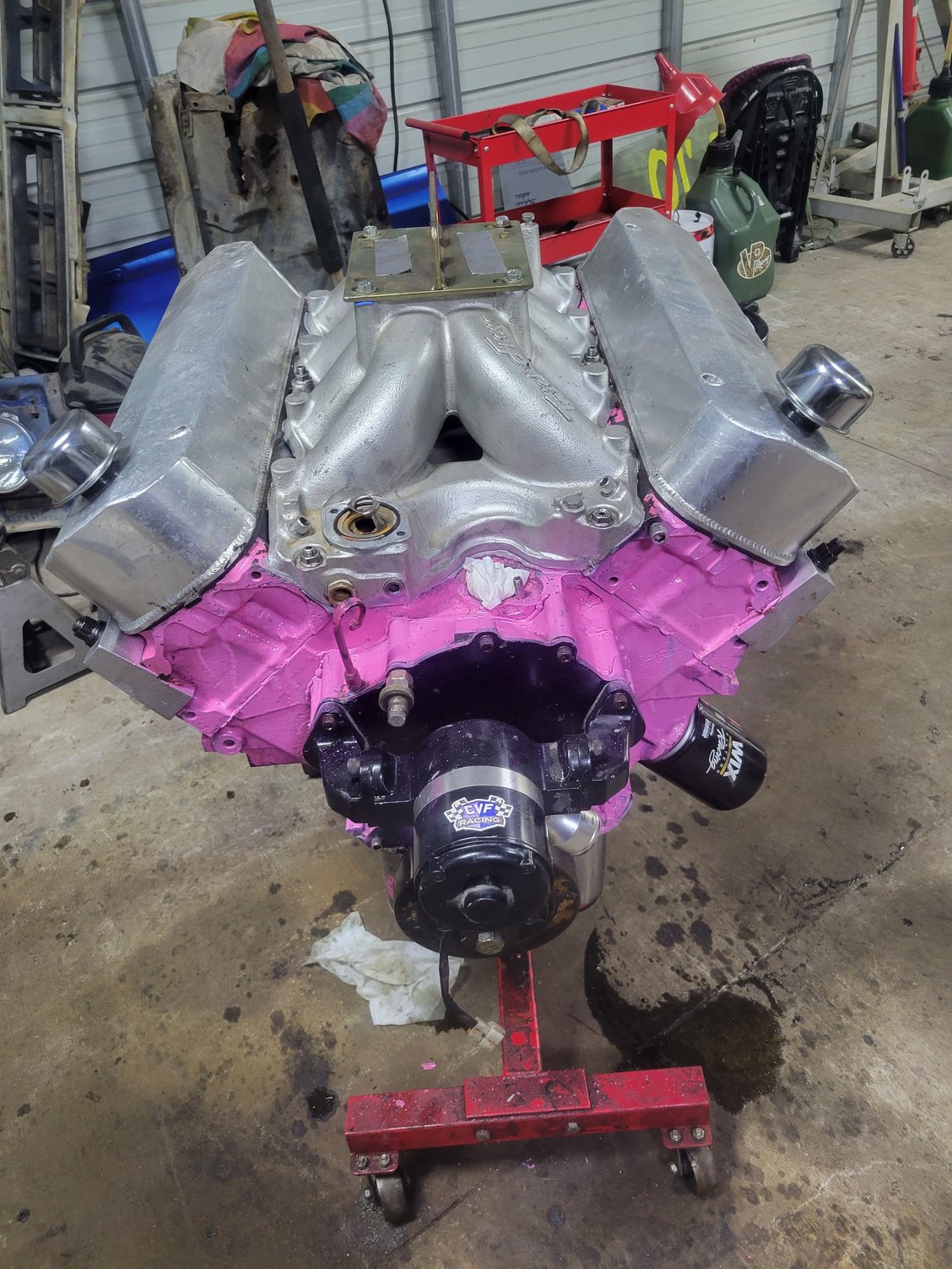

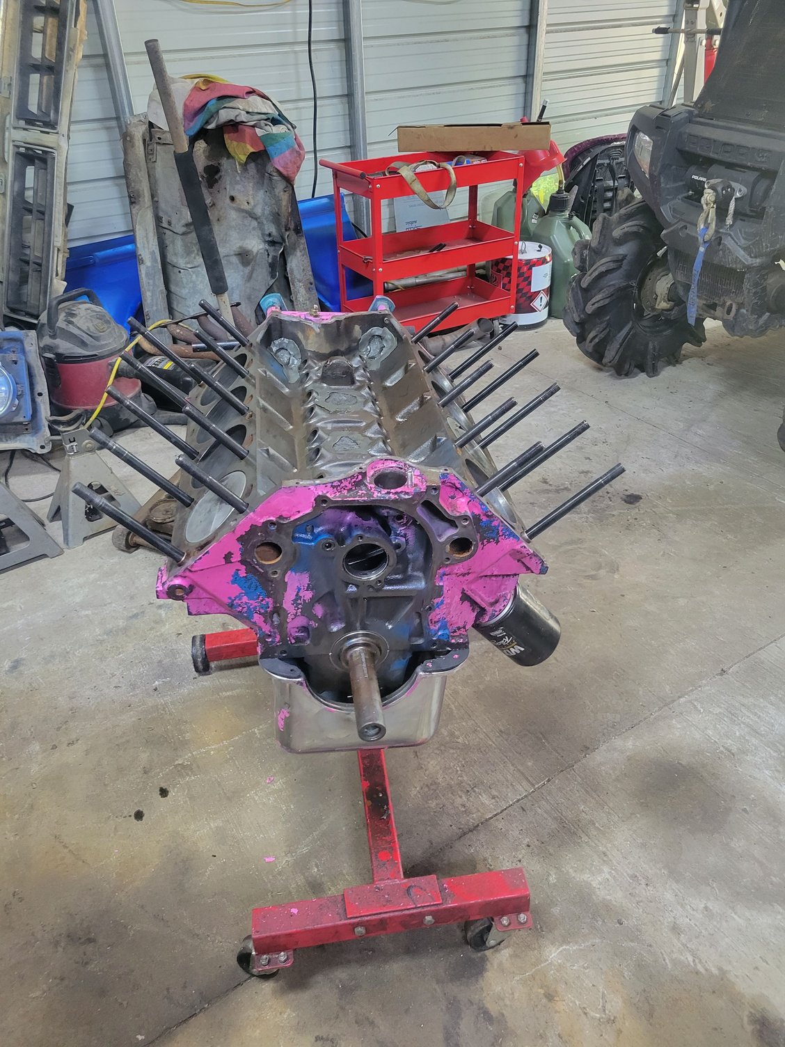

Well I took yesterday off as a sick day to finish my motor, and ended up actually sick today but I muscled through and atleast got the old girl bolted I place...
Yesterday..
And today
It's bolted to trans, and torque convertor then i set the distributor in and got thermostat back in place. Probably all im going to do today as im not feeling the best. Hopefully tomorrow I can get it mostly buttoned back up.
Old May 21, 2023 | 03:00 AM
  #3405
Cracker289's Avatar
Cracker289
Joined: Jul 2003
Posts: 2,730
Likes: 20
From: Four Oaks, NC
Man, look at the size of those intake ports!
