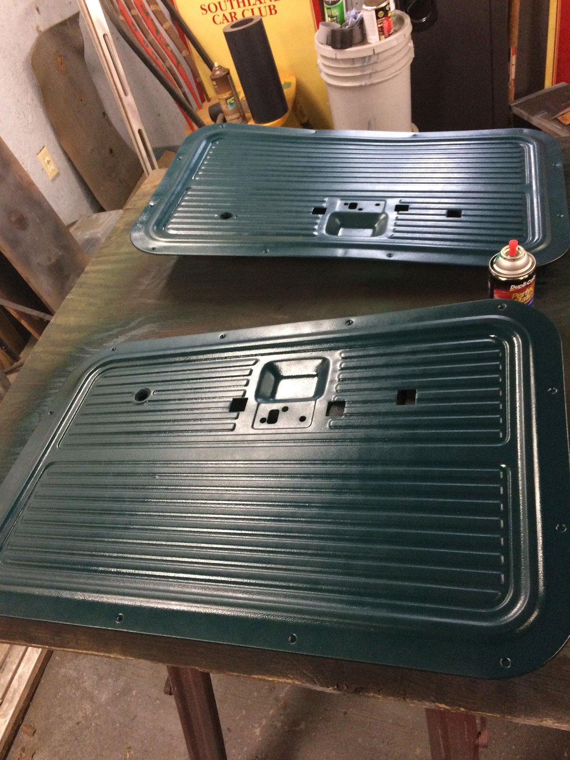

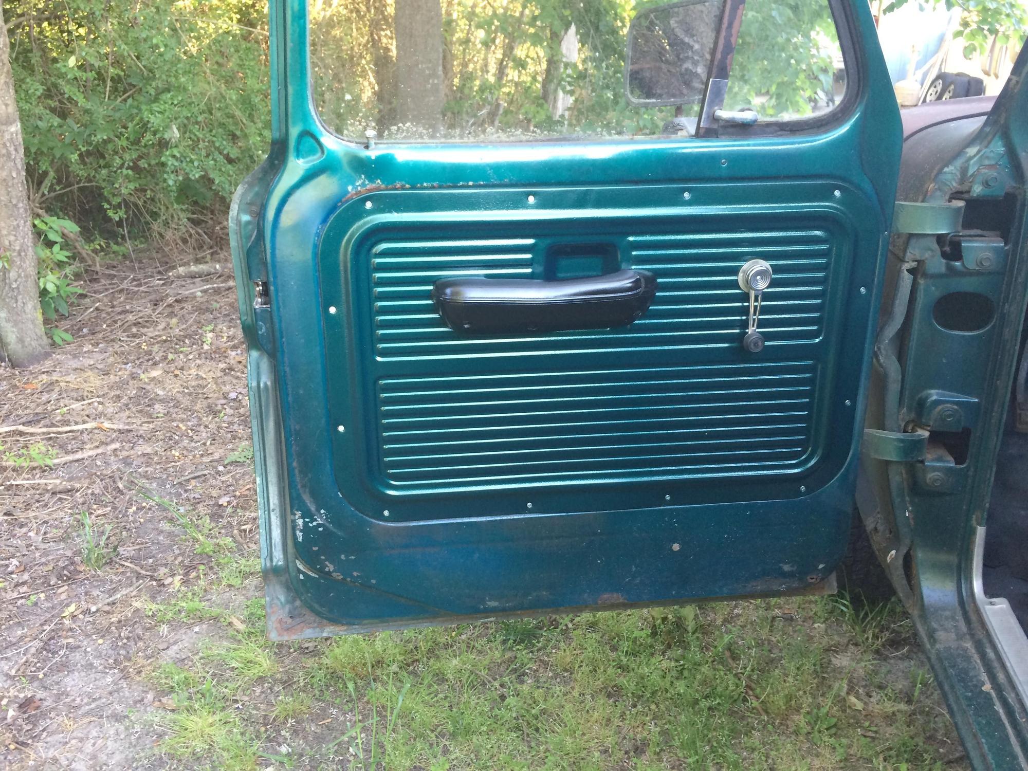

I didn't work on the 83 truck at all this week, but I made some progress on my 69. I got the door panels from my 1970 parts truck, they were in pretty good shape. I sanded them down as well I could, avoiding ruining the grain pattern they have in them. Then sprayed them with rustoleum primer, then color coated them with Dupli-Color emerald green. And when I clear coated them, they really popped! I went through the 4 pads I had and chose the best left and the best right and sprayed them with some black vinyl dye. Installed in truck and looks pretty good. I've never had interior door panels since I owned this truck (2004).

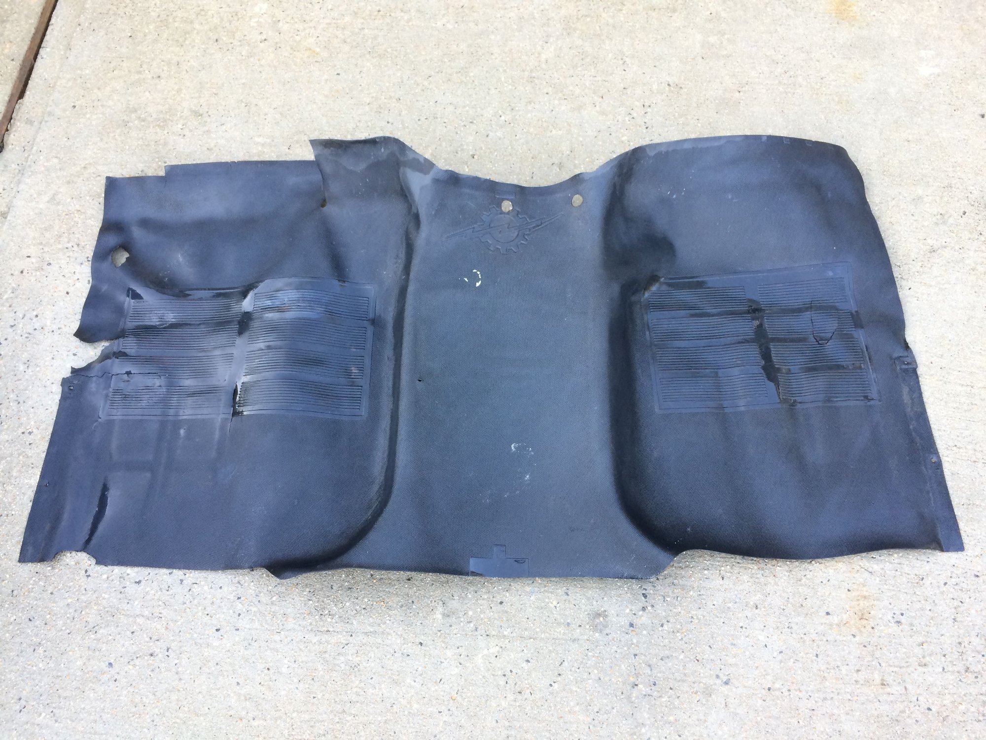

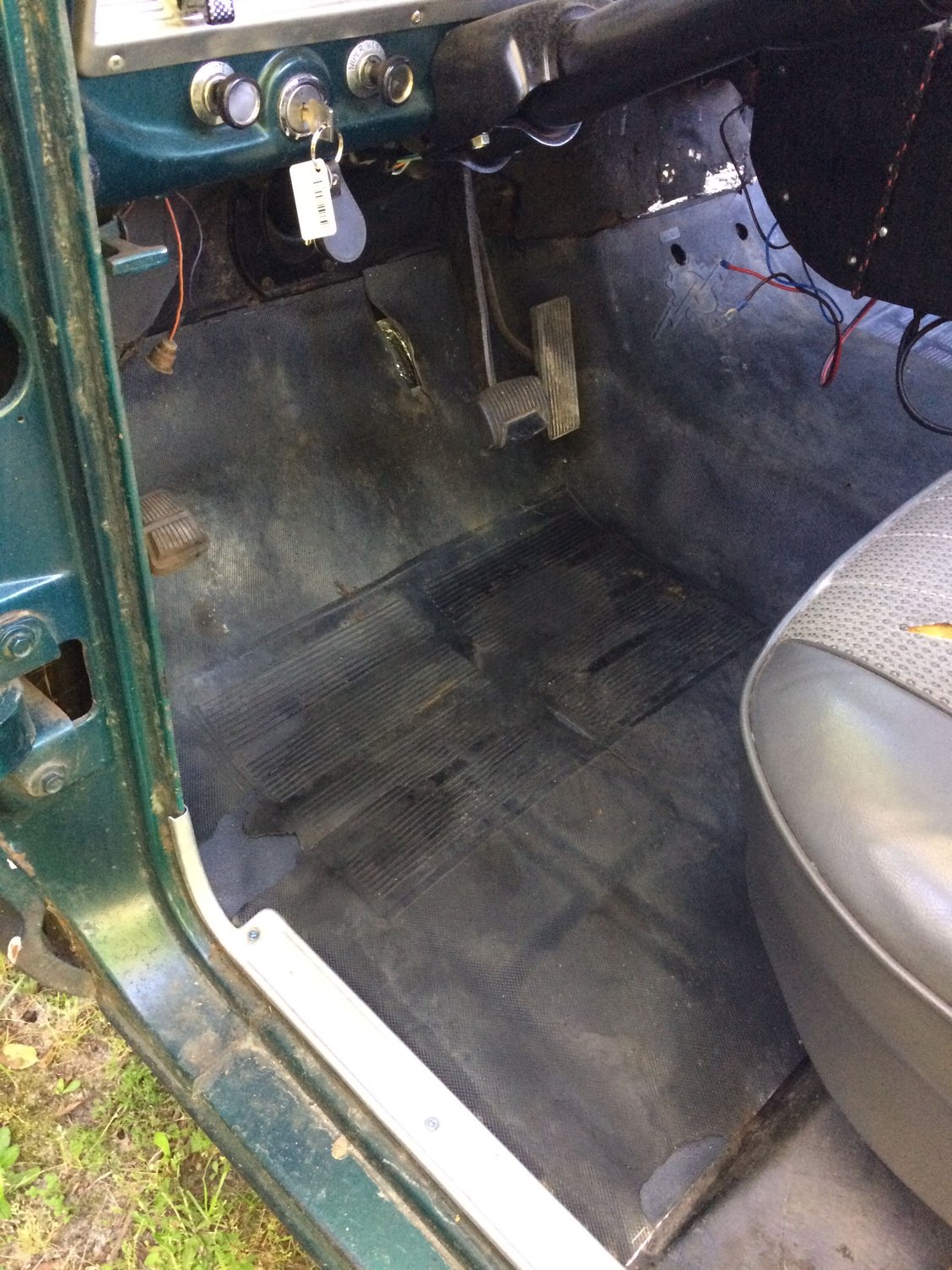

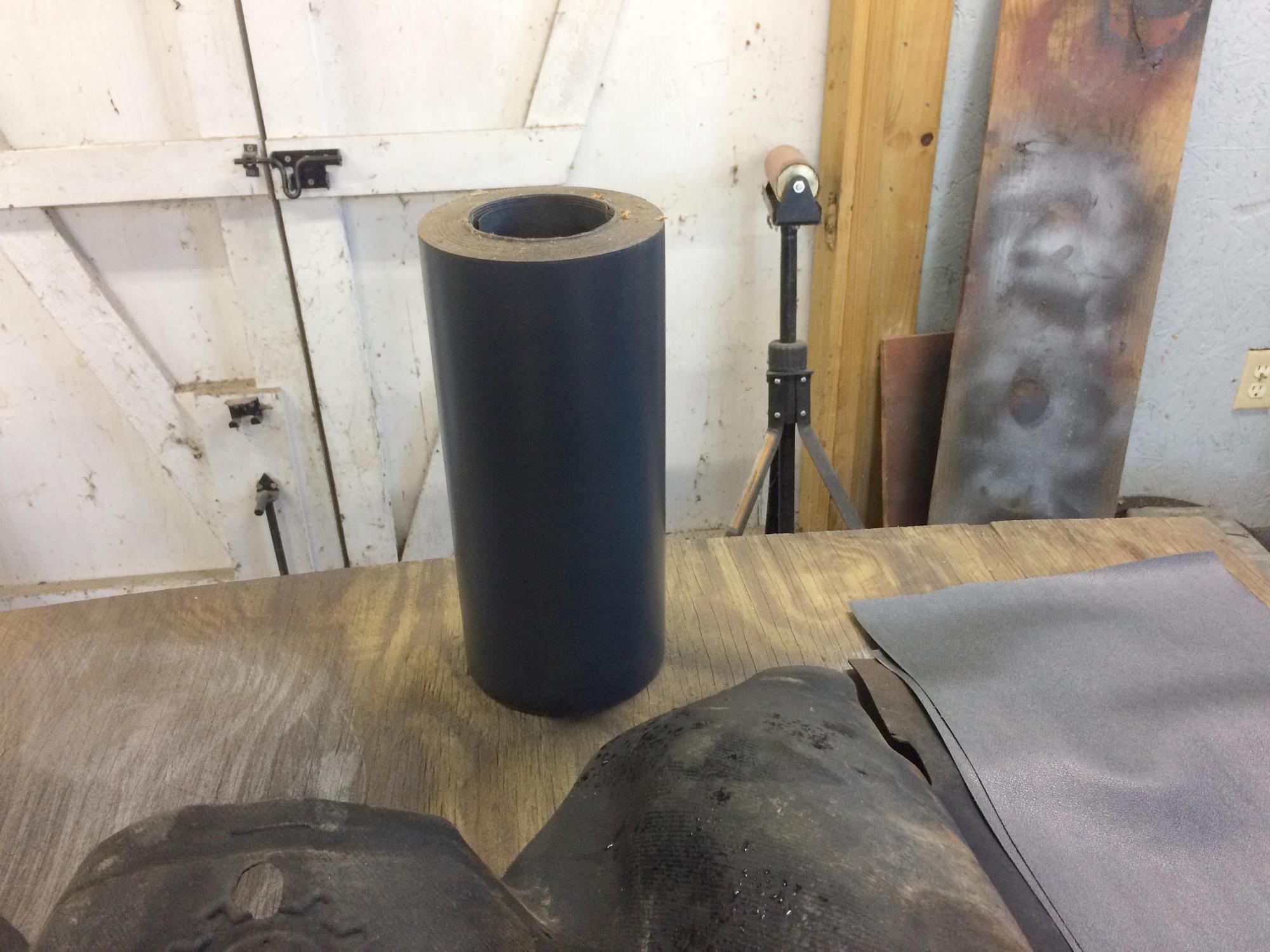

While I was at it, I cleaned the floor mat that I got from the parts truck as well. After pressure washing you could see it is in pretty bad shape, lots of nicks and tears, but overall it's 'better than nothing". I have a roll of leftover rubber flashing so I cut some pieces of that and attached it to the back using spray glue. Wasn't holding perfectly so I put some staples in around the edges. Anyway now at least wherever holes are, there is black rubber underneath. I had fabricate a winch to hoist my console up out of the way so I could install it. Glued down some leftover foil insulation I had in the shop and got the "new" mat in place. Much nicer than plain metal floor, something I've never had.
More work (not pictured), I replaced my stereo and my dash speaker. The stereo had been acting up, sometimes just stop playing music and the screen would scroll "Pioneer" over and over, then start working again. Sometimes it would scroll very fast between AM, FM, and USB, and then maybe it would start working again, or sometimes not work at all for more than an hour. Then when you turn the key off and start the truck again, it acted like nothing was wrong and start working again. So I got a new stereo from Wally World for $69, and my dash speaker was blown, I figured while I was in there might as well replace it (have to remove the glove box and the defroster tube to get your hand behind the radio, and the speaker is right above it anyway), so I salvaged the two 6" door speakers out of the 82 parts truck and installed one in the dash, and then shoved the other one up under the dash on top of the heater box, tie wrapped in place. Seems to work ok (I don't sit on the passenger side anyway so I'm not concerned with audio quality on that side, haha.
So now I got door panels, floor mat, and I'm jamming to my 80's tunes. Life is good!

Nice job on those door panels

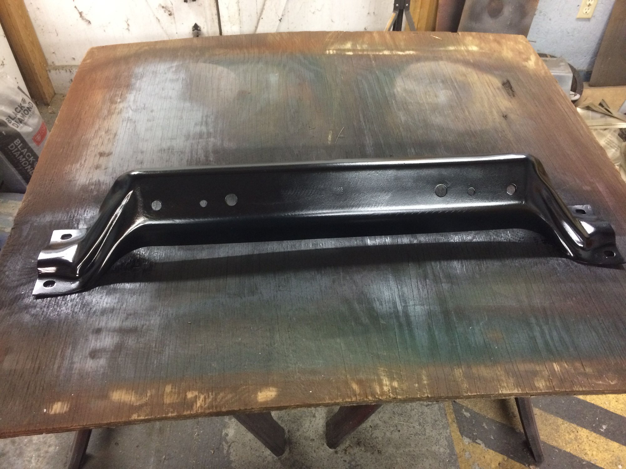

I did some work on the 83 this week. First, this piece here, I am not sure what it's called, mounts to the frame in the front behind the bumper. I guess it protects the oil pan. Mine was bent up real bad, so I pulled the one off the parts truck, cleaned it up, and sprayed some black on it.
Clean, sand, prime, and paint; good as new!
Hard to see in this pic, but it's peeking out from underneath. I installed two eye bolts in it to make it easy to hook a chain too, in case it ever needs to be pulled.

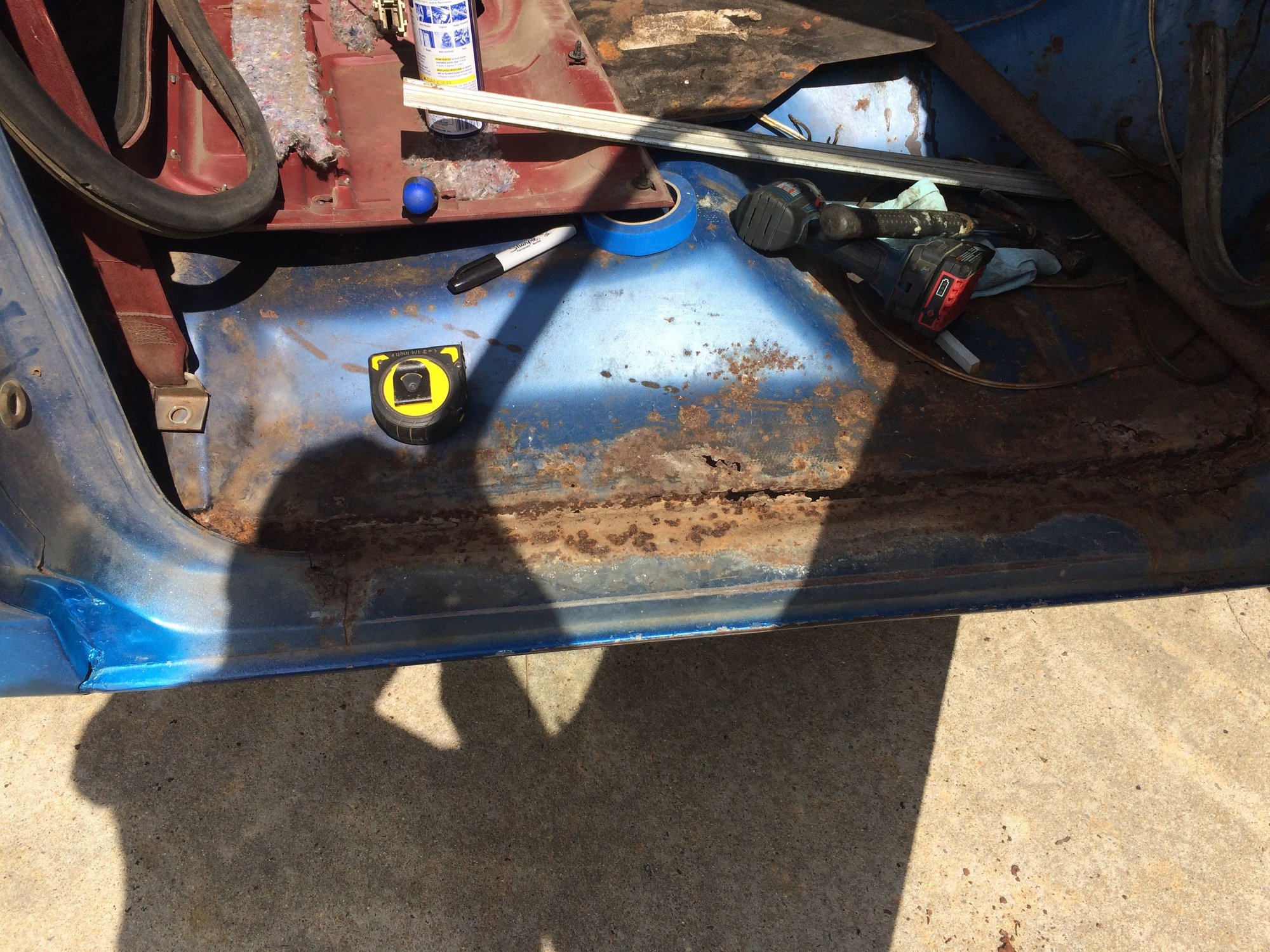

Next, I started on the job of repairing the floor pans.
Believe it or not, this side is the "good" side!
Cut out a couple of the worst spots.

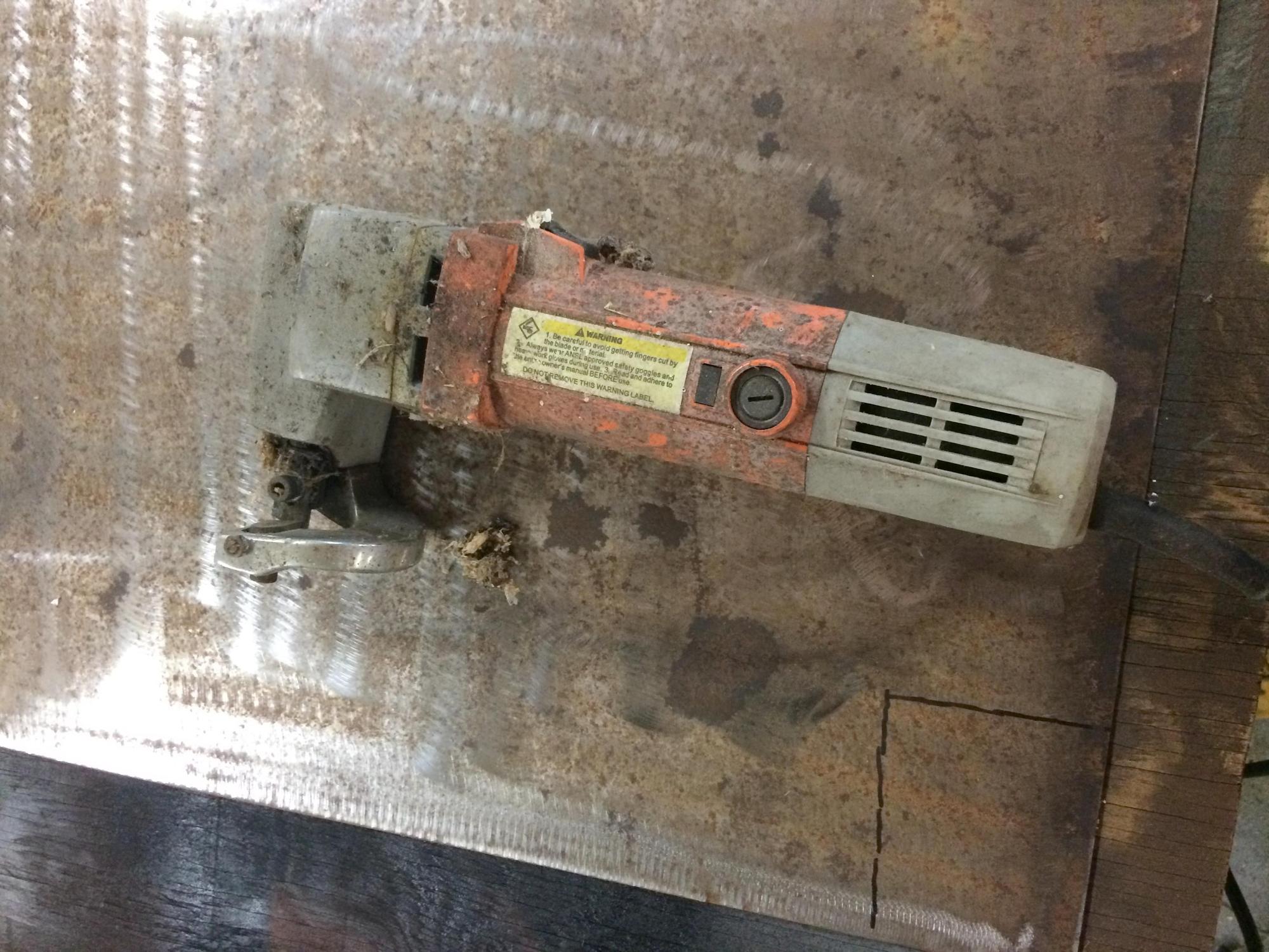

Judging from all the grime dust & funk on this nibbler, I'd say I have not used it in a very long time!

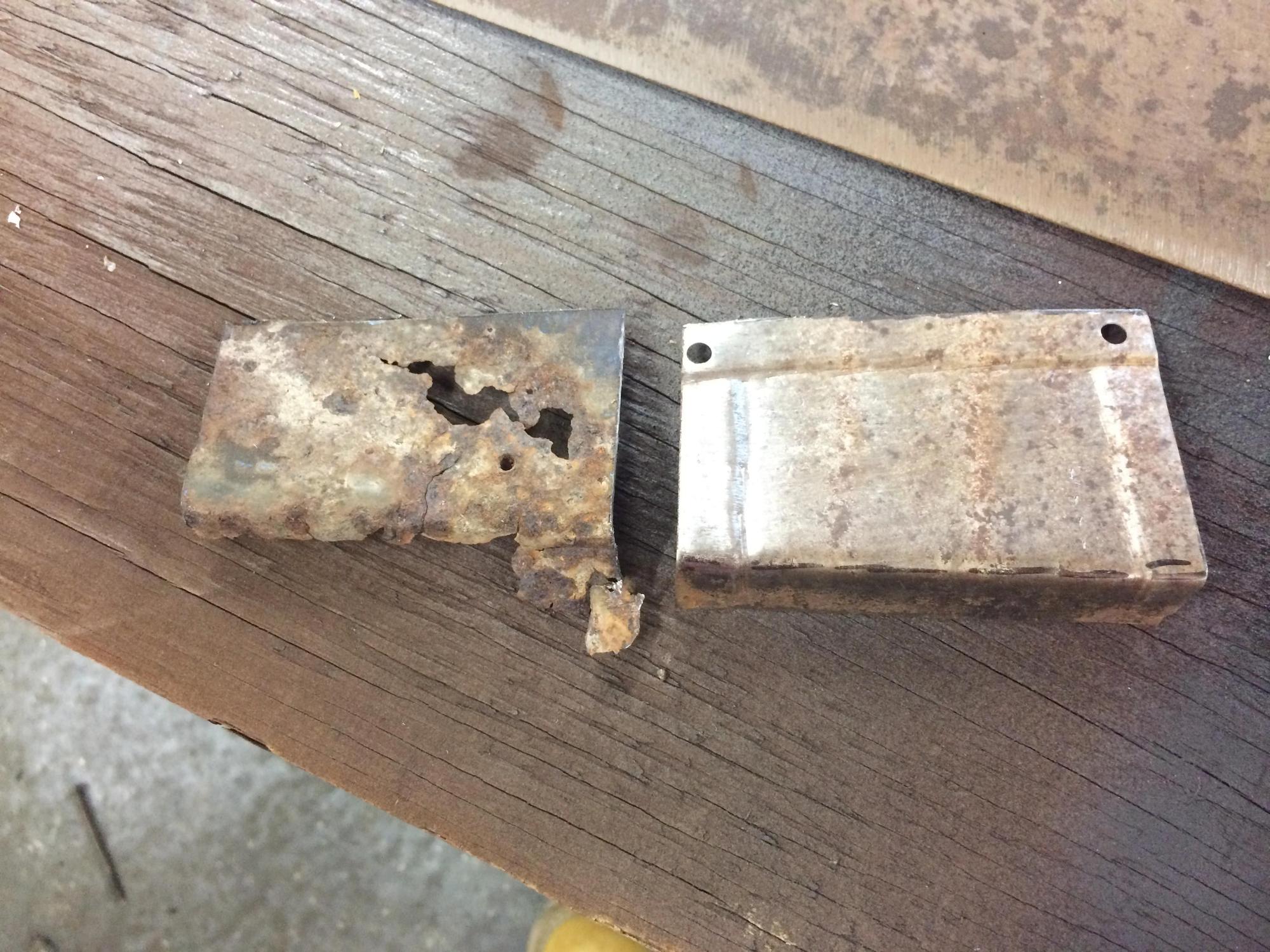

The nibbler goes through the sheet metal I got from Dave like butter. Was easy to make my patch pieces.
May not be perfect but it'll hold! No more Flintstones floor on the passenger side, will tackle the driver side next week.

That front pan / cross member gets bent on all the trucks. I think its easy to put a chain around and it is not that strong.
Just a FYI that front pan / cross member is different between trucks that have a front sway bar or don't as the bars frame bushings get bolted to it.
They say the 4x4 trucks get sway bars more than the 4x2 trucks did.

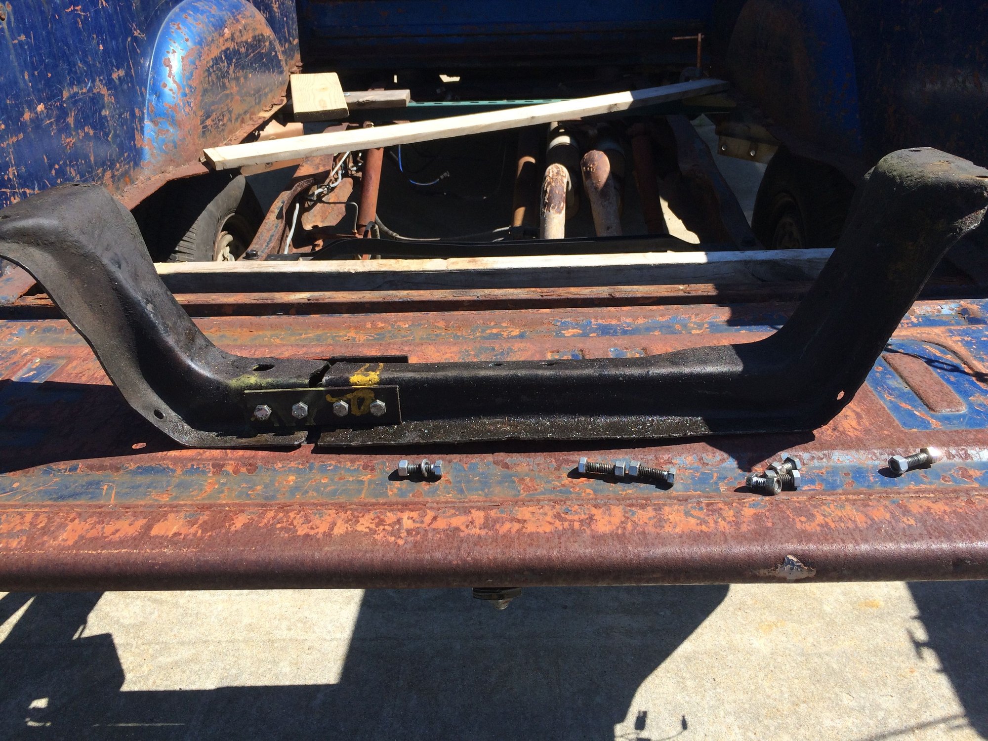

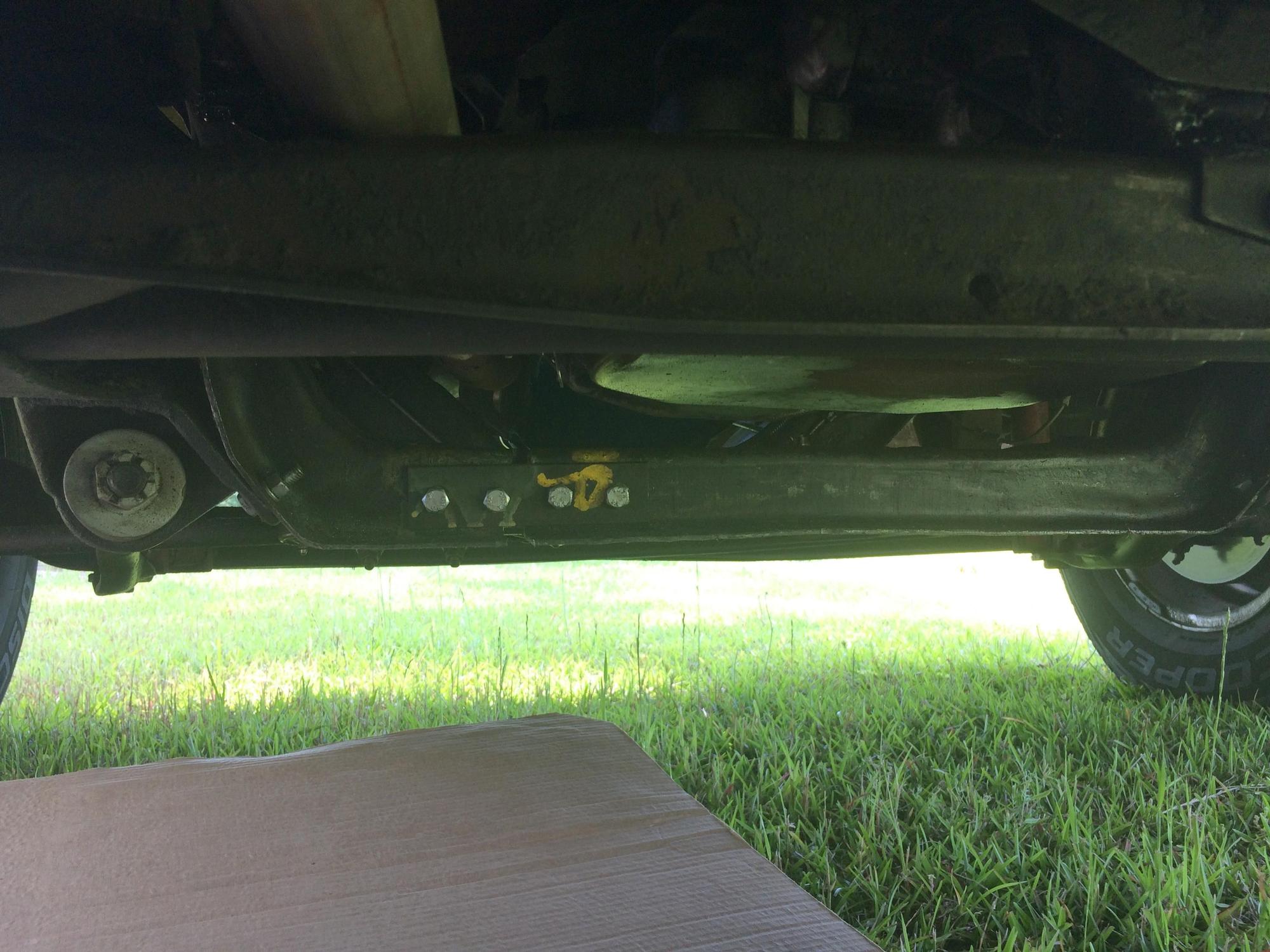

Several months ago while I was underneath my truck working on the shifter linkage, I noticed that this crossmember had been cut in half and "repaired" with 2 pieces of 3/16 steel. At the time I wasn't sure why, and I had never noticed it before, but I had recently had the transmission replaced and assumed the mechanic had to remove this crossmember to let the tranny drop. So either it was already repaired previously and it just became noticeable after being cleaned up and reinstalled, or else my mechanic had trouble dropping it and cut in half to make removal easier.
After spending almost 4 hours working to drop the crossmember on my parts truck, I am definitely leaning towards this being cut by my mechanic.
I dropped my crossmember was not happy with what I found. It had been installed with 3/8 bolts instead of 7/16, and out of the 4 upper bolts (4 upper bolts mount to the frame, 4 lower bolts connect to the radius arm mount), 1 was missing, and 2 were only finger tight!
I gave the butchered crossmember to my friend Jared, he needed one that he could modify to run his exhaust through and did not want to cut up a good one.

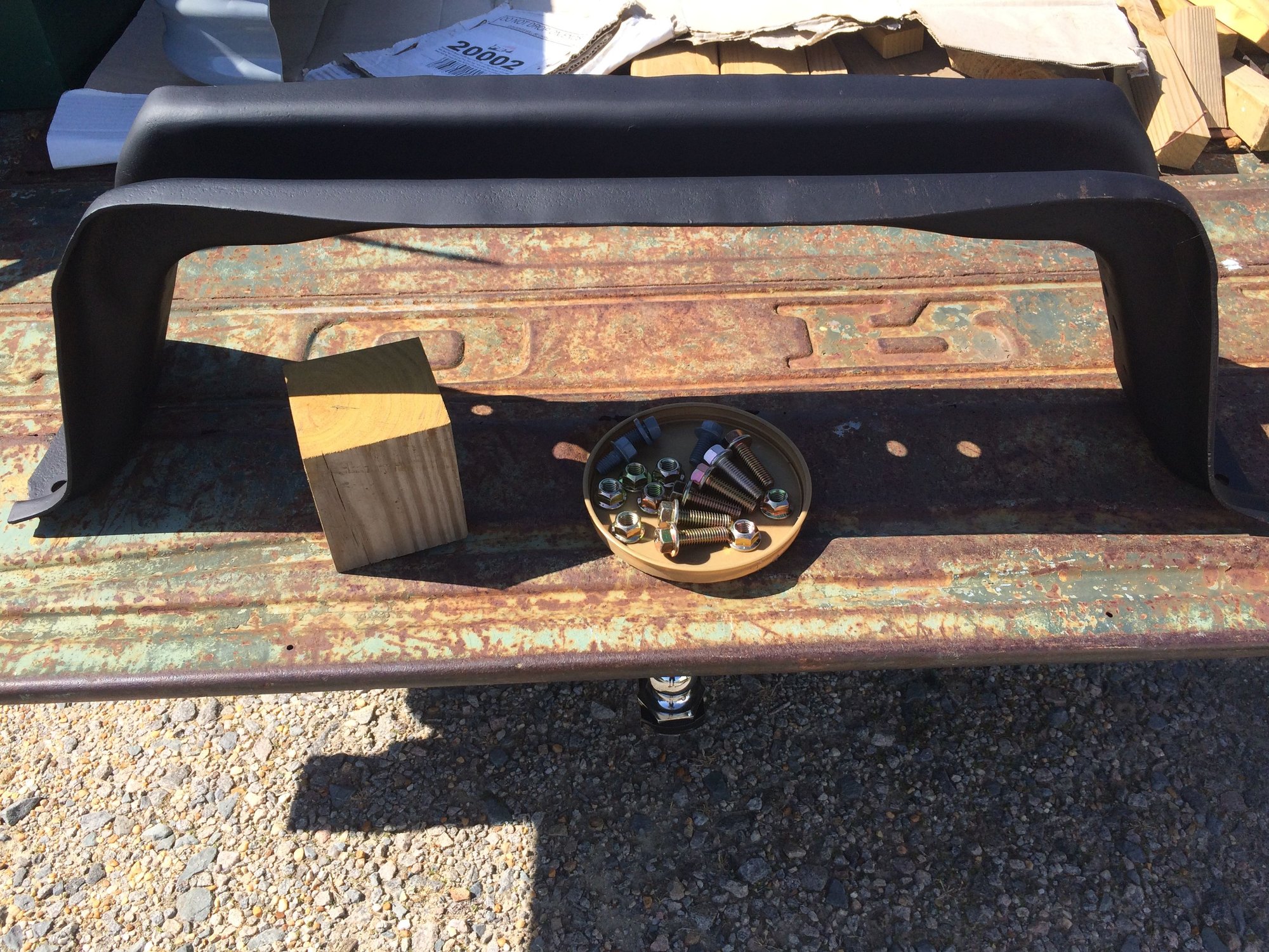

Cleaned & painted the "new" to get it ready for install, nothing crazy, just some de-greaser, pressure washed, and rattle can black paint. Not going to use chintzy little bolts like the last guy, some some nice 7/16 Grade 8 flange bolts & lock nuts, this should tie my left & right radius arm mounts together securely.
Well I found out the hard way, this goes in a lot harder than it comes out (especially considering the old came out in 2 pieces). There is no way to get it in unless you drop the transmission crossmember first (it has to go in at an angle). So I jacked up the tranny and removed the mount and when I did, I found that the crossmember was bolted to the frame with 3/8 bolts! What the hell, was there a sale on 3/8 bolts somewhere? No matter, I will put it back in with the correct size hardware when I finish.
This crossmember was caked in grease and dirt! I'll try to clean it up real good before it goes back in.

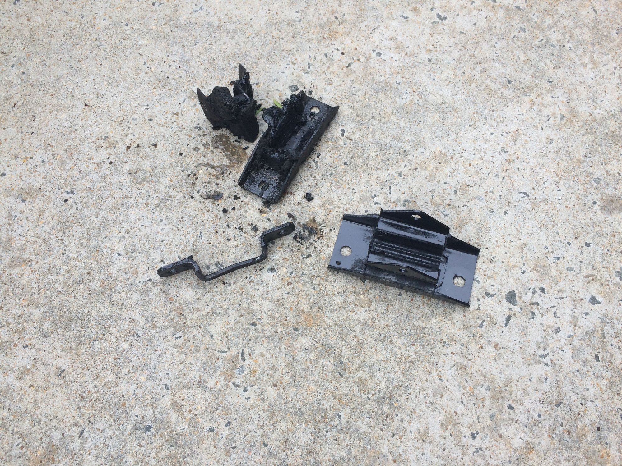

Meanwhile I noticed that the rubber part of the transmission mount is all rotted and falling apart. You know, I have always heard that transmission fluid eats rubber, and this thing always leaks a little. I guess I will need to order a new one before putting everything back together.
Doesn't look like anything was holding this together. No matter, new one from Autozone only $8 and they had it the next day ready for me.
Rainy weather delayed me, but finally today I got the new trans mount installed and used 7/16 hardware on the crossmember.
You know when you're working on an old vehicle there's always a chance it will turn into something bigger than you planned, and in this case what I thought was going to be a simple crossmember replacement turned out to be two crossmembers, a new transmission mount, and 3 trips to the hardware store. But that just makes the satisfaction sweeter when the job is finally done.
