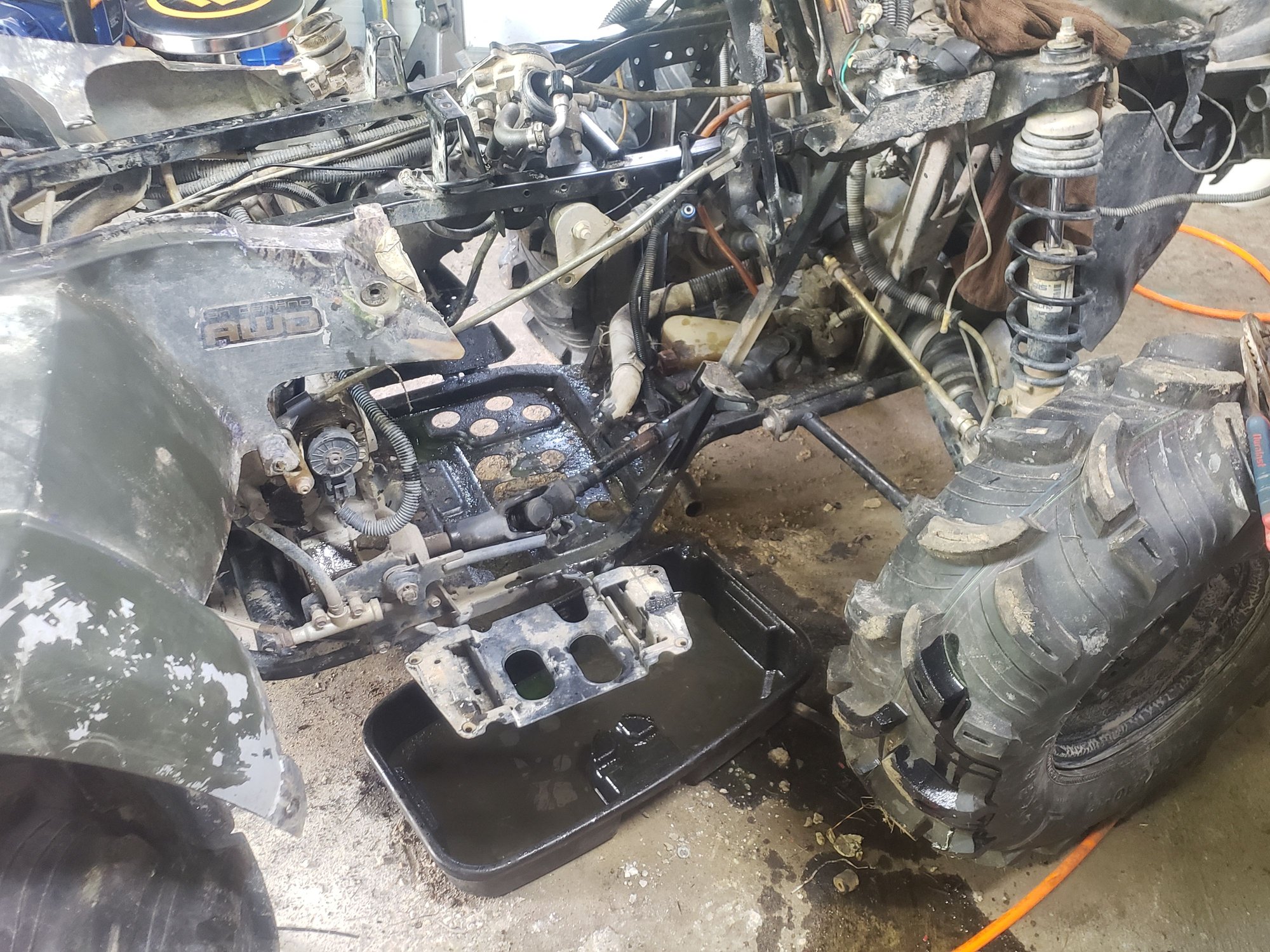

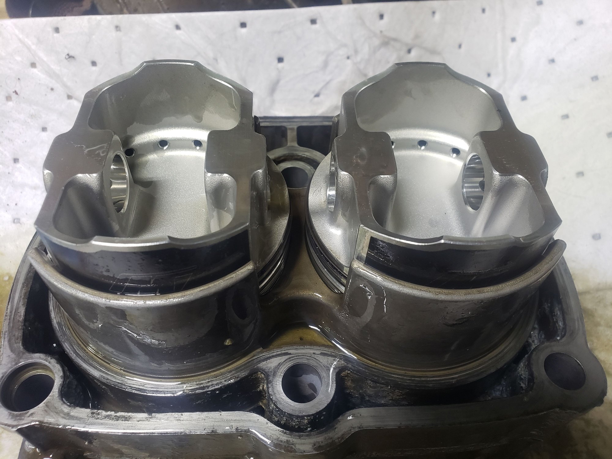

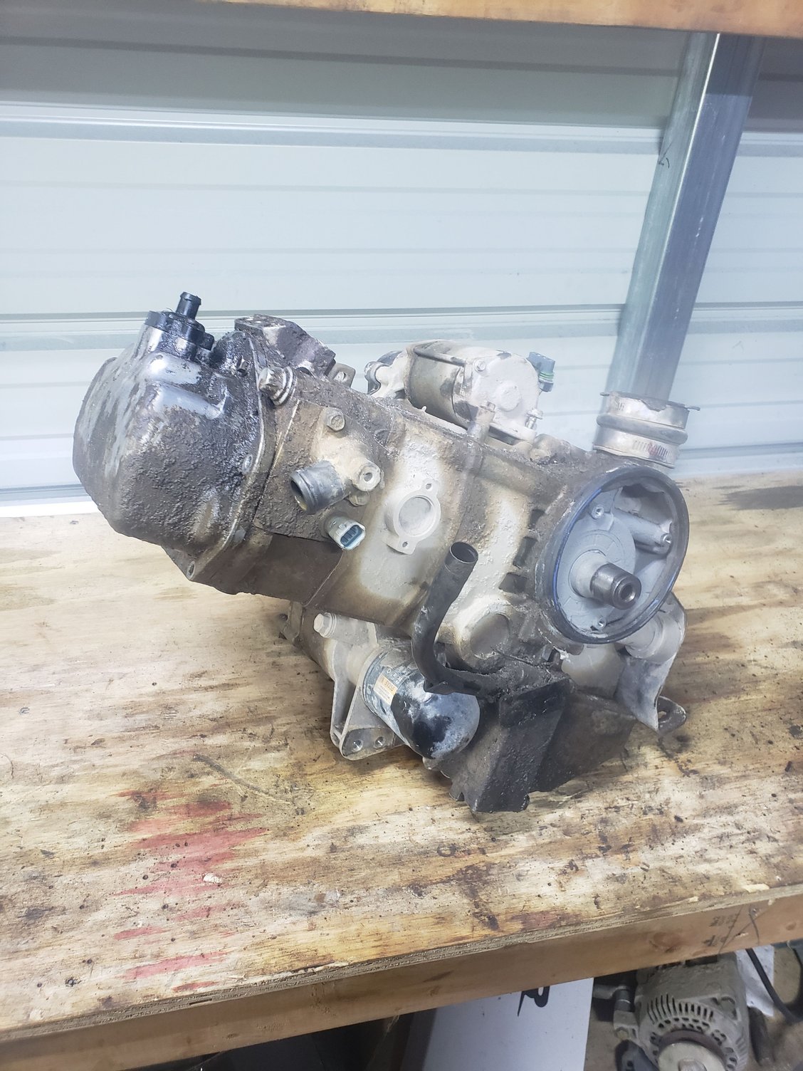

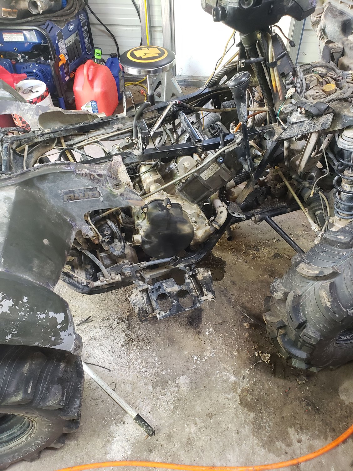

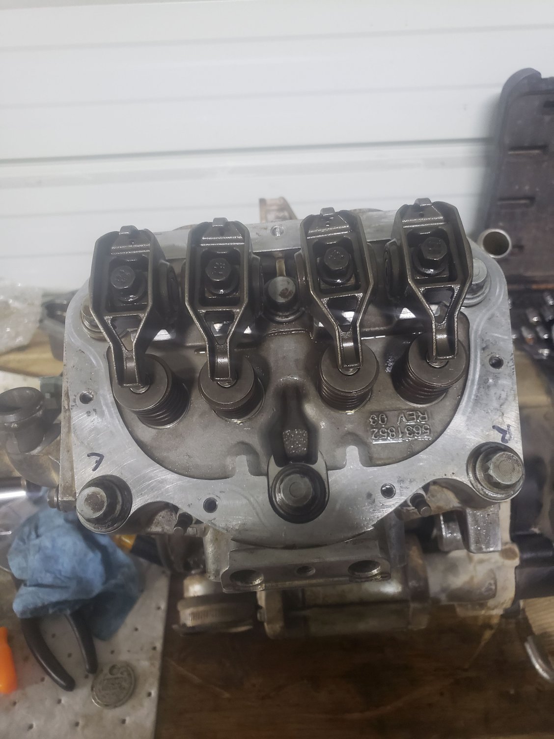

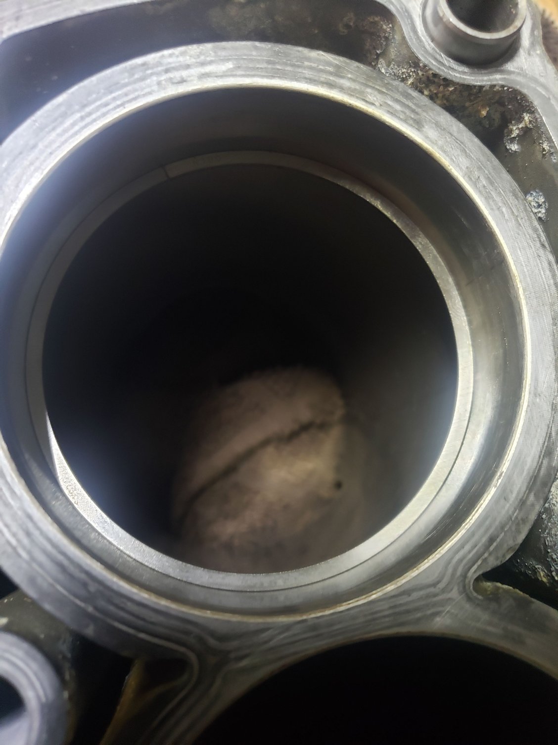

So got the motor out, and on the bench/pulled down.
So looks like it stuck the rings when it went under. Good news is there is still visibly cross hatching on the cylinder walls, and measuring as best I can with my micrometer the jug is okay. Ordered a set of pistons and rings, as well as a gasket kit. Also got a new fuel pump, injectors, injector pig tails/harness, and spark plug wires in route. For some reason polaris thought it was a good idea to glue the plugs to the injectors. Anyways, will probably clean the head up some tomorrow or some time during the week. Then hopefully my stuff will be in by next weekend so I can start reassembly.

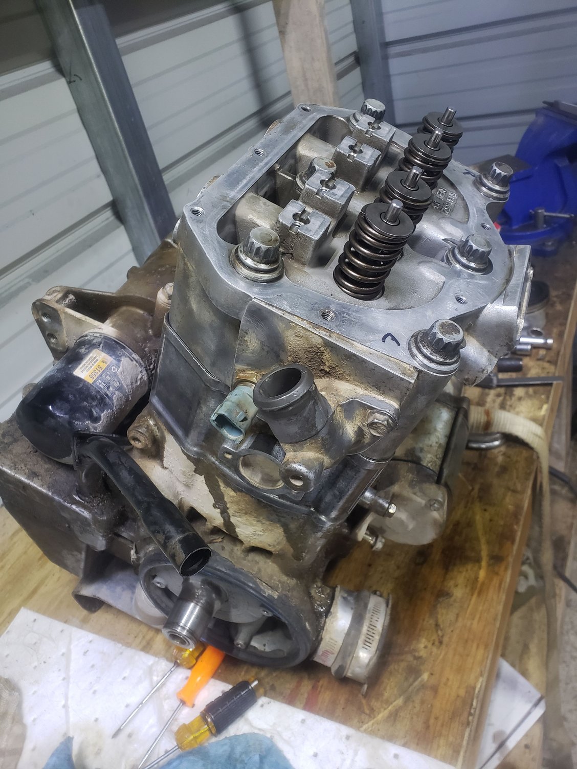

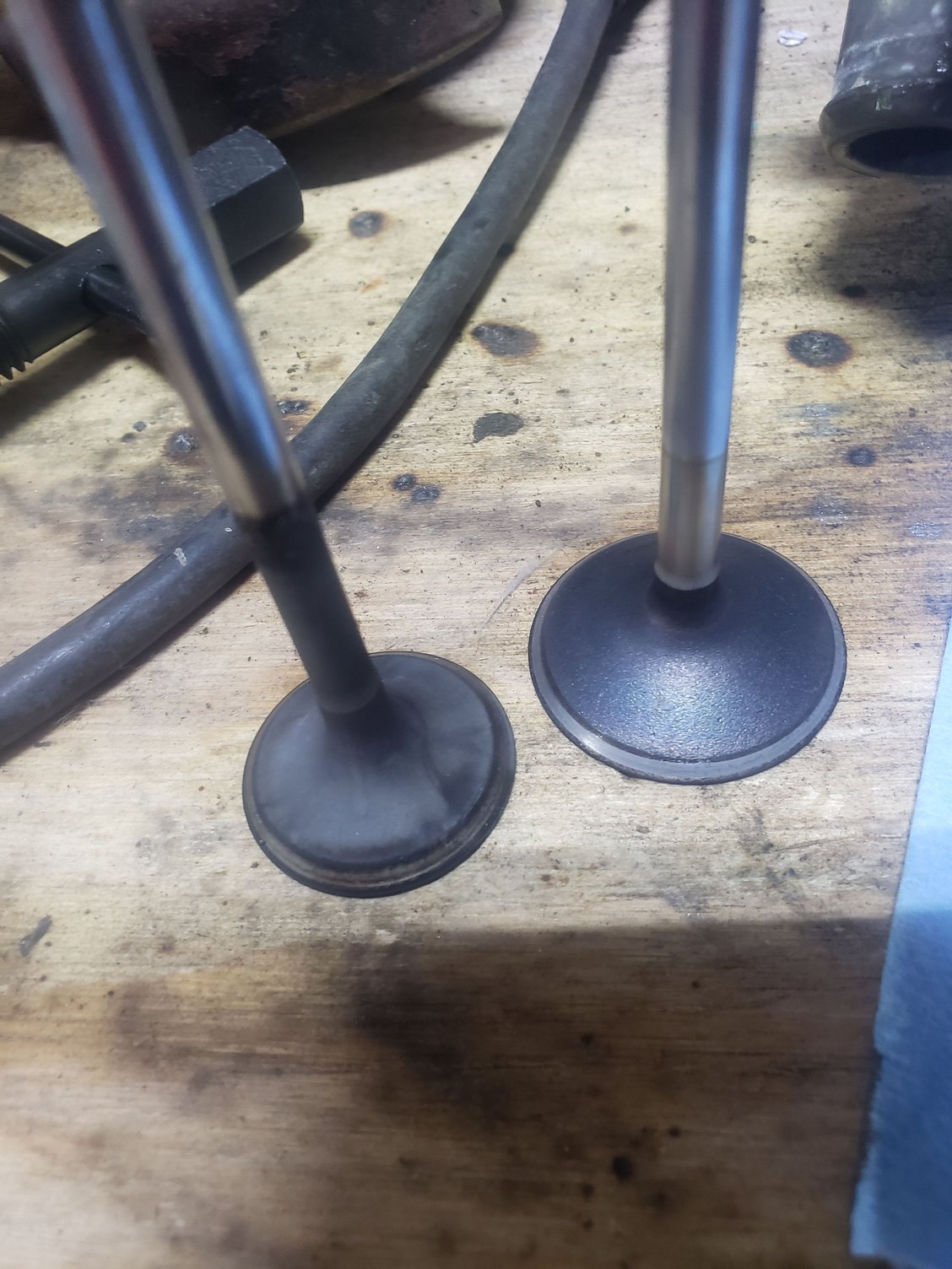

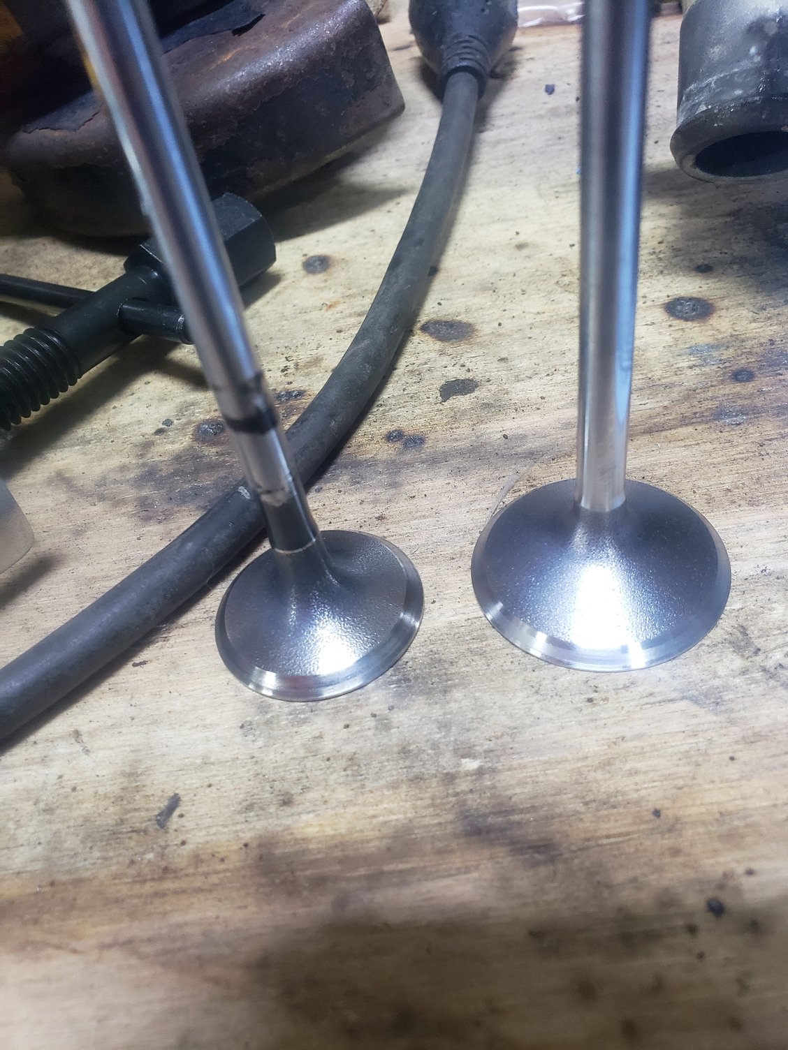

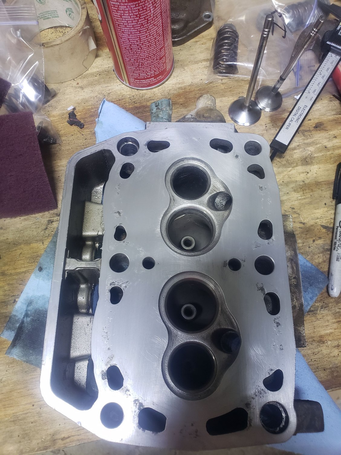

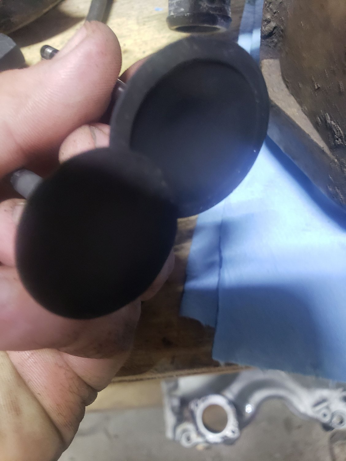

Ran a hone down the cylinders yesterday, they cleaned up nicely. No pics of that cause cross hatches don't show up for crap on pics.
Today I broke down the head, cleaned up the valves, combustion chamber/mating surface. Need to snag some more brake clean so I can finish cleaning up the runner's and valve area, as well as valve cover. Head and valves cleaned up nicely though.

My pistons showed up Thursday, and valve seals showed up today. So I checked/filled rings last night and started assembly today.
Waiting on valve cover gasket to show up now, then itll be officially back in one piece. Probably hold off putting it back in the frame for now. Also little confused why a top end gasket kit wouldn't come with valve seals, or valve cover gaskets.

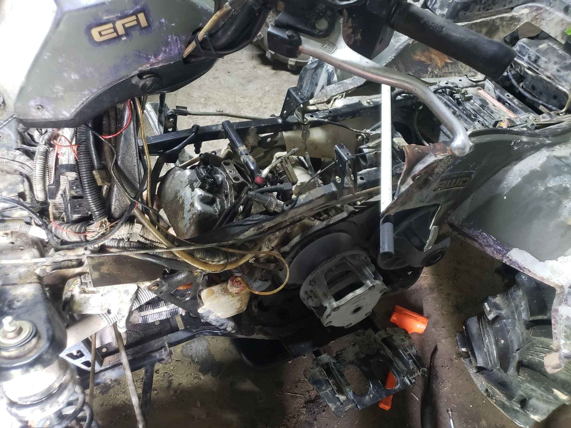

Posts: 7,005
So I got impatient and decided to go ahead and set the engine back in the frame. I hit all the connectors with contact cleaner and dielectric grease before putting them back together. Then I got the new injector harnesses, new injectors, and new spark plugs and wires installed. 2 of 3 engine mounts are hooked up, the third was broke when I pulled the engine, and i forgot to order a new one so waiting on that to finish those.
