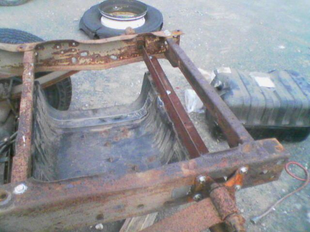

You have exactly what I'm trying to get to. The only difference is that your rear xmbr is in the stock orientation. It worked in your situation because of the stock sized F Series rear tank (19-20 gals?)
I've purchased the larger Bronco tank (33 gal) and it extends lower than the xmbers and is supported by a skid plate on the bottom with straps across the top of the take like this
These require the xmbr to be flat on the bottom to receive the bolts.
Now that I am awake and looking at the pictures I think I see why the Bronco tank is not used.
It shows the top of the tank above the frame. On the PU the tank is flush or just below to clear the bed floor.
Think that is why you don't see people using that tank and going with the 38 gallon one.

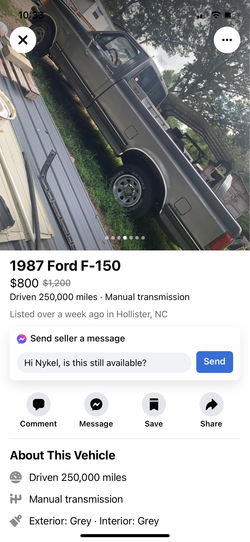

Theres an OBS truck i keep seeing on facebook forget what they were wanting for it. Body looked good condition and guessing it could make for a good parts truck for you. Said it ran till the engine bay caught fire.
found the listing. Tried to share the link but wasnt working.
