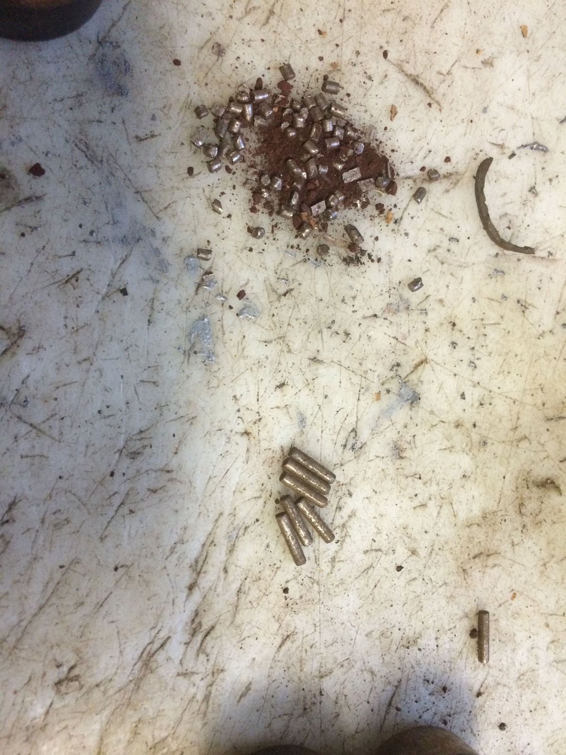

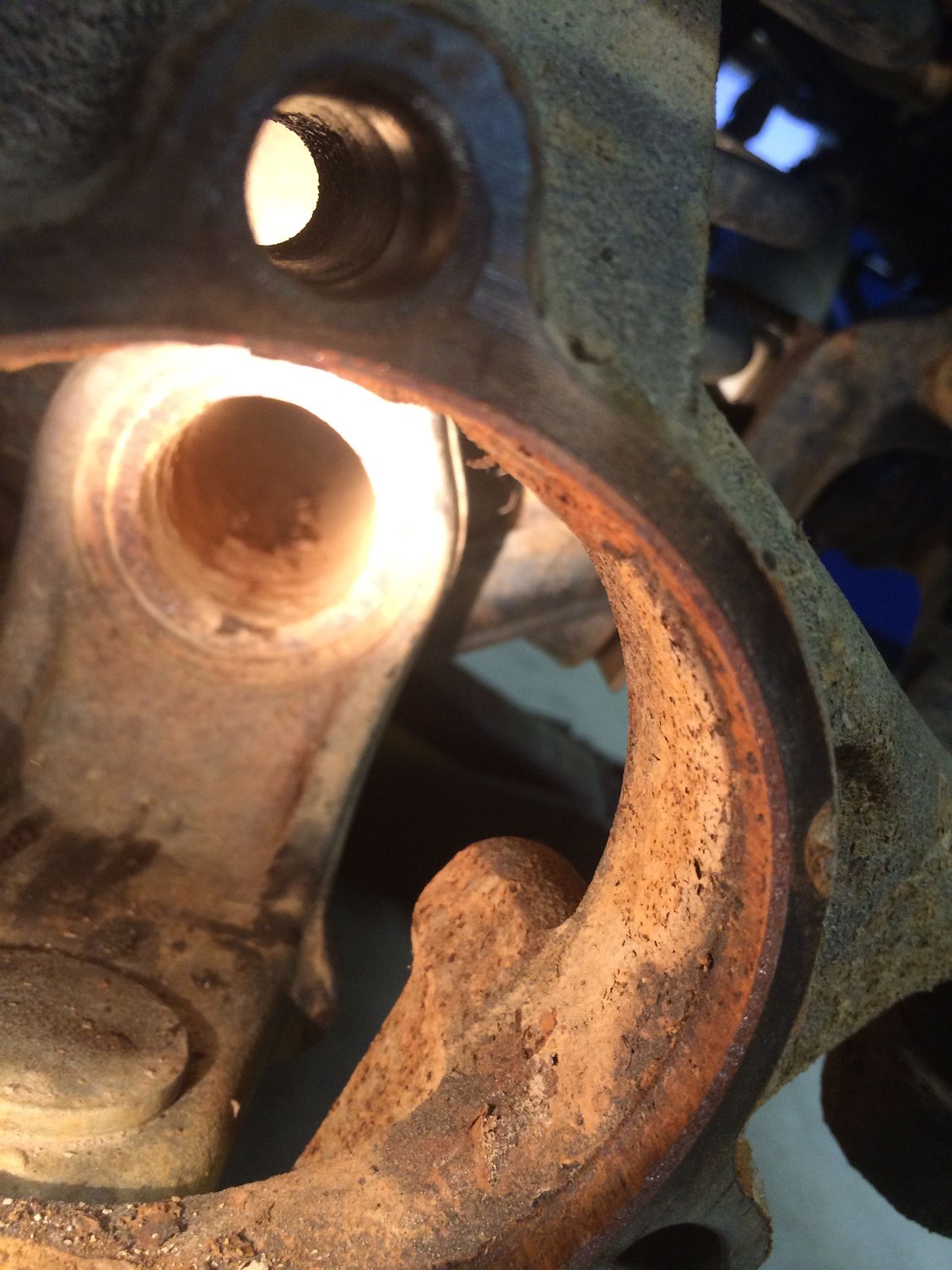

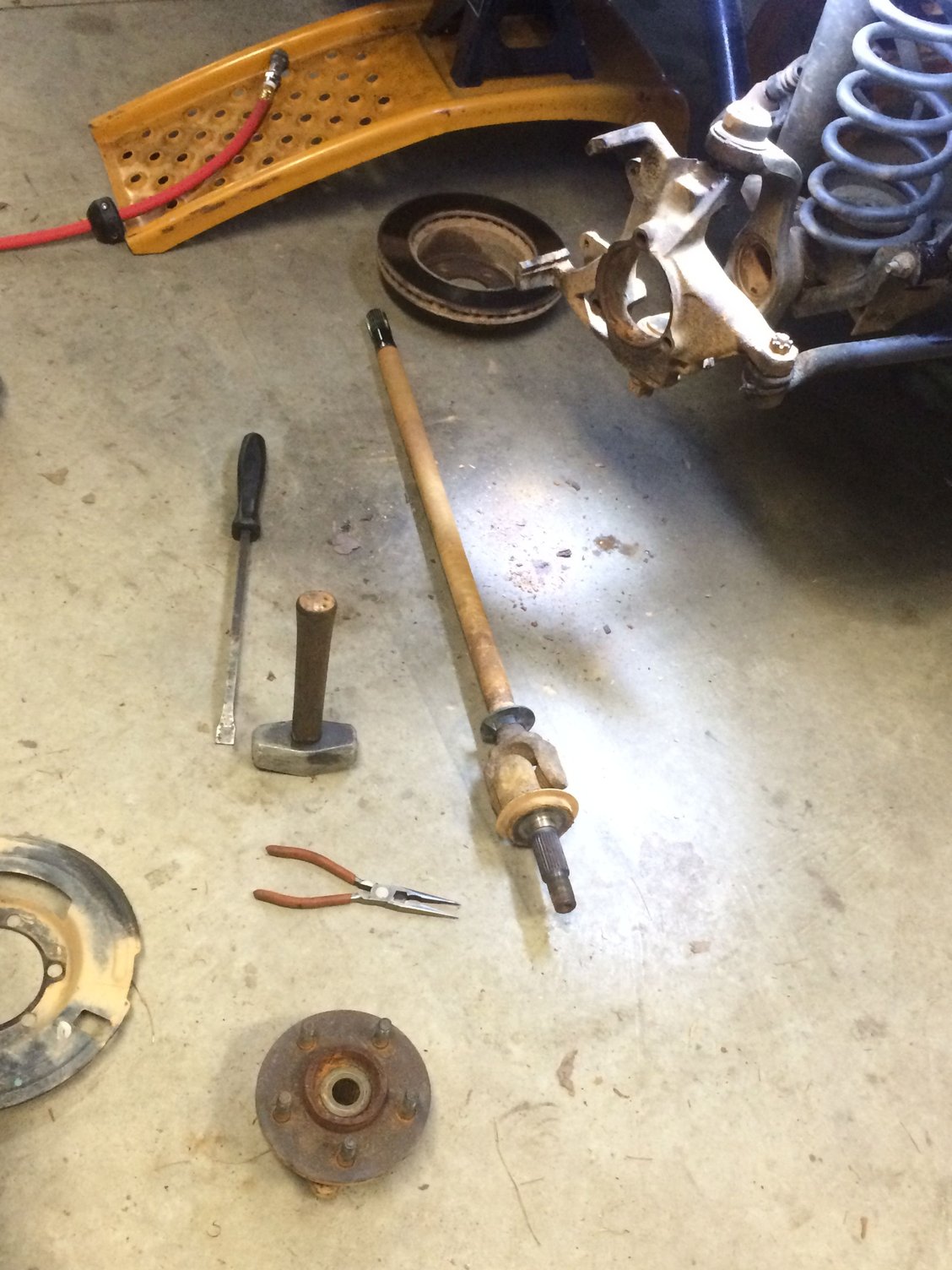

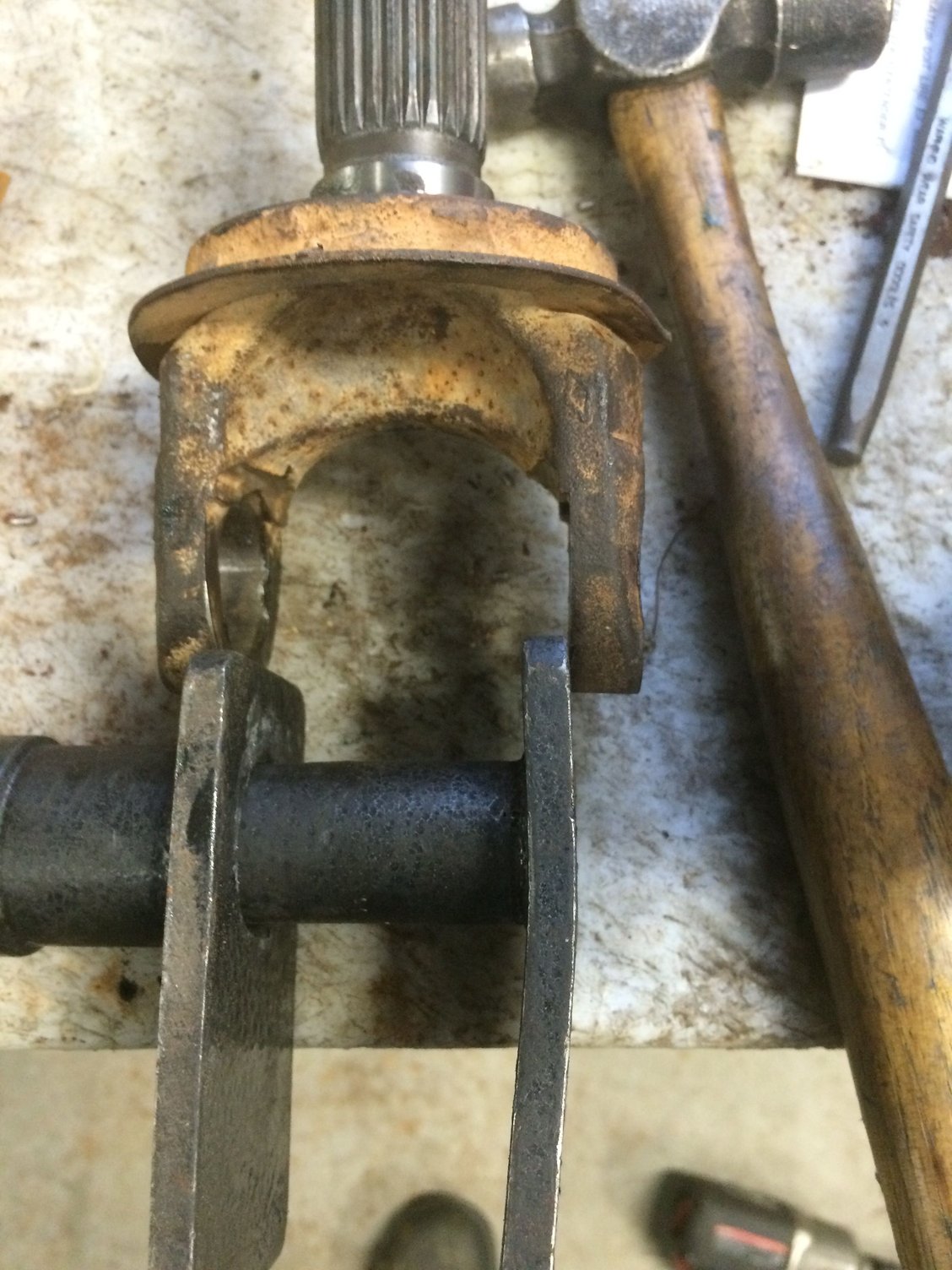

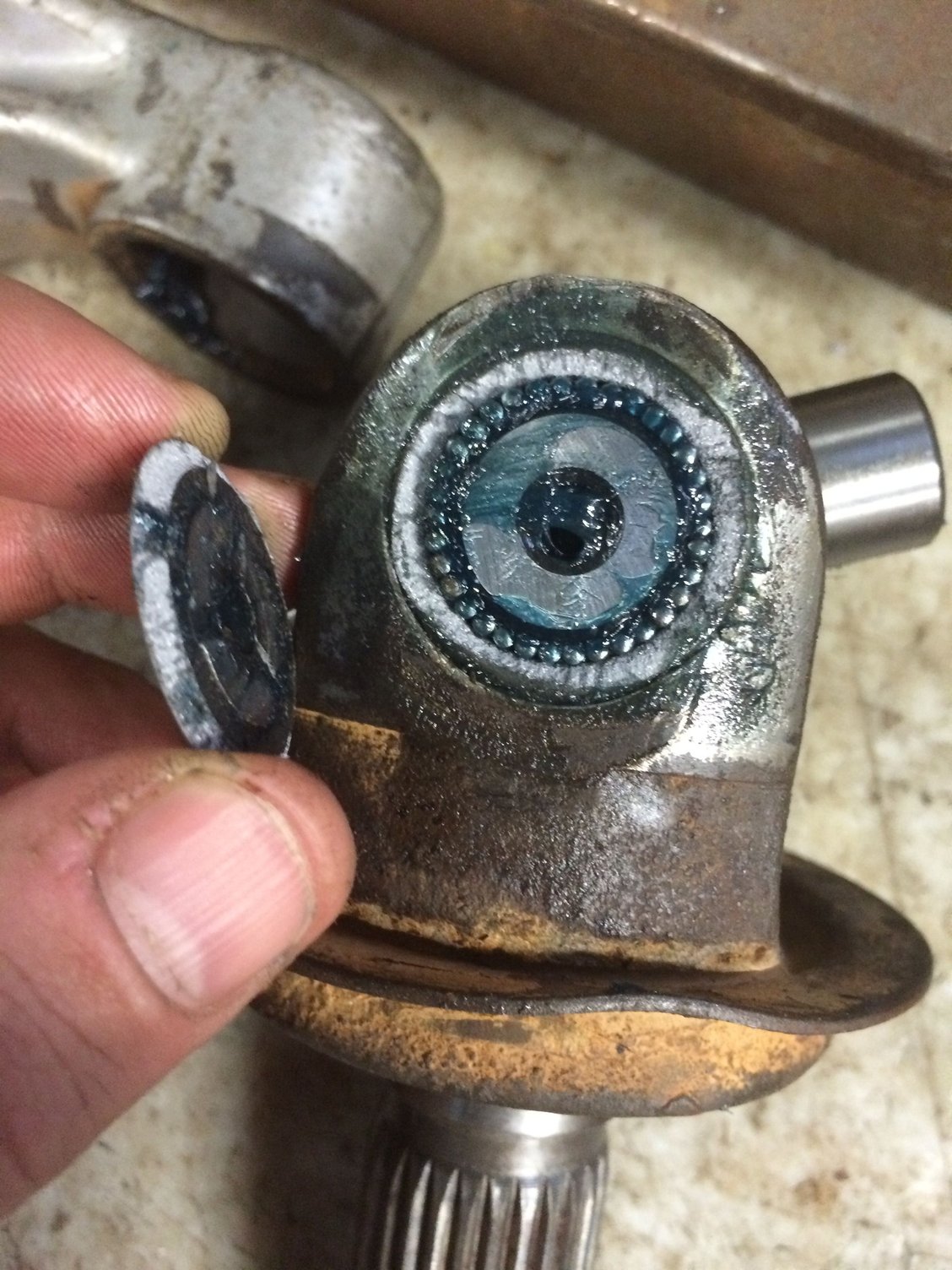

So threw the tires back on the TJ today. I was lazy and only pulled the front tires and brakes looking for the noise..
Drove it around with Mary listening, and then Mary drove it around :O Well in 4wd it still had a hell of a noise. so Decided I needed to tear the axle shafts out and maybe the differential to check all the bearings. Got the passenger side wheel bearing off (fixed, sealed unit) and found the u-joint was done. First one from AZ was not even close.
Popped out the old u-joint pretty easily.
At the top you can see what used to be needle bearings, at the bottom, what good one's look like.
Just a little mud in the axle. This is how I polish them. Nothing wrong, but you can tell it's been through mud.

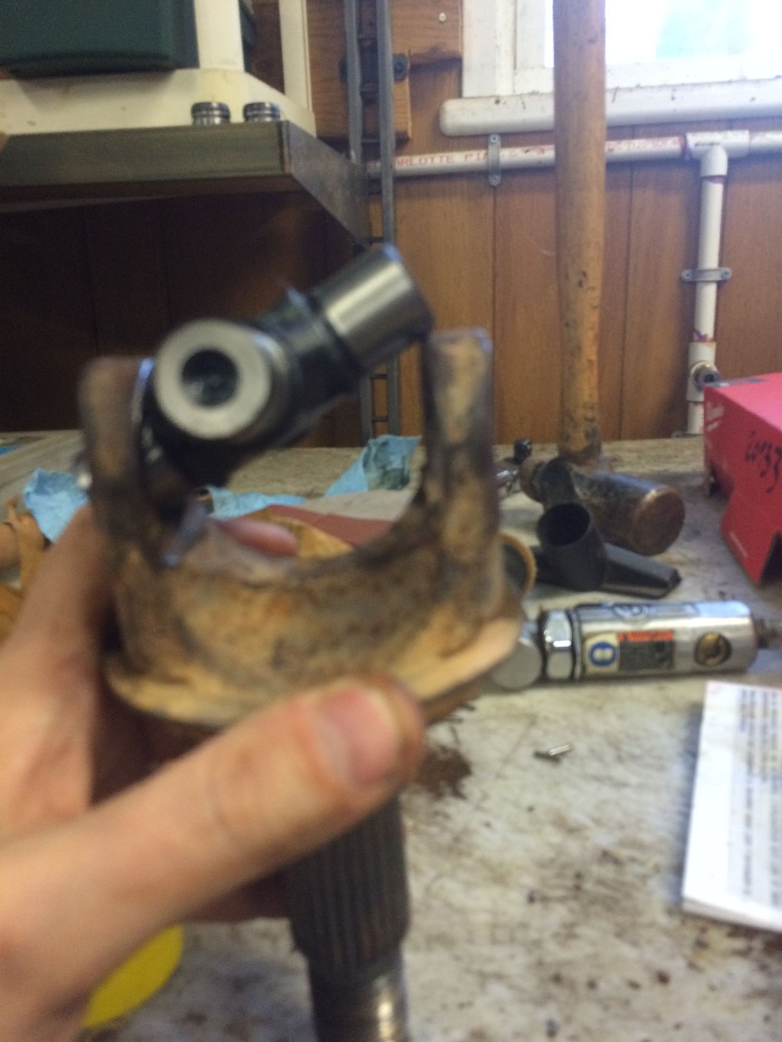

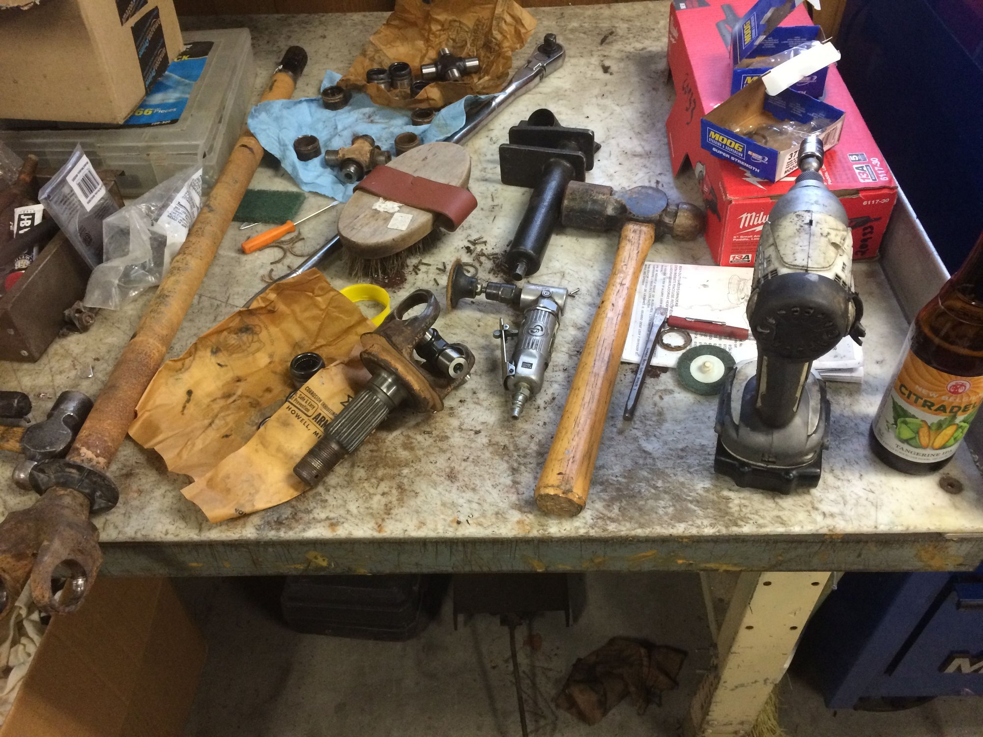

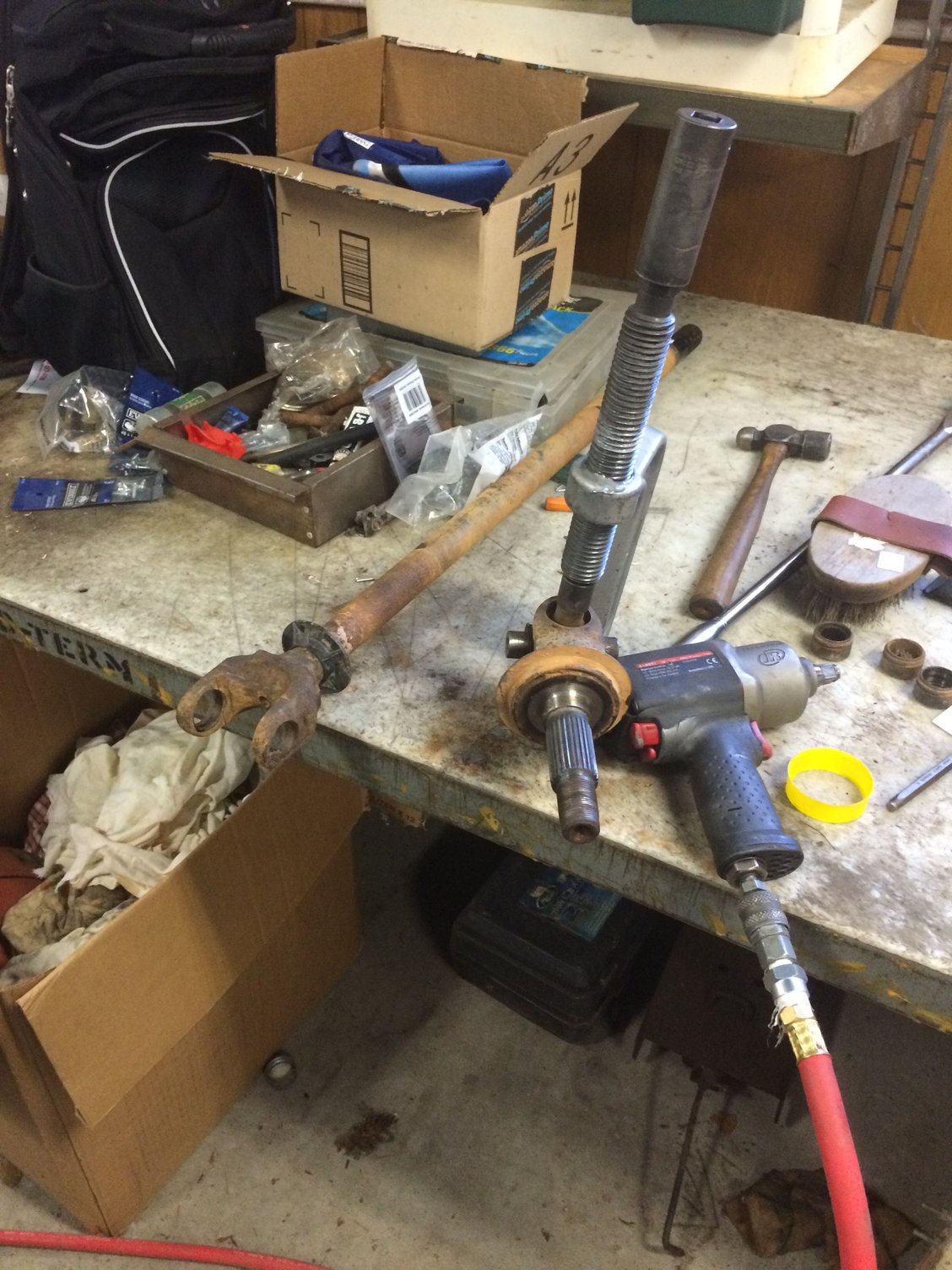

Second set of joints from AZ. Caps were the right size the joint though, well.. it took a little bit of work.
A little bit of work to get the joint in..
Ignore the BIG HAMMER... it's there for.... decoration... but the new joint finally fit... it's a miracle!
hmm.. what did I say about the new joint fitting???
Hmm.. 10 points to whoever guesses what's in my hand and where it's supposed to go... Not sure I can weld this back together..
So short of it all... I've got OEM spicers on order... I'm done with this not quite fitting OEM stuff... now there is a chance that I bent the yoke so... I made need a new outer shaft... but I'm gonna say that if I did, you may for ever call me Non Master Certified Benz Tech...
