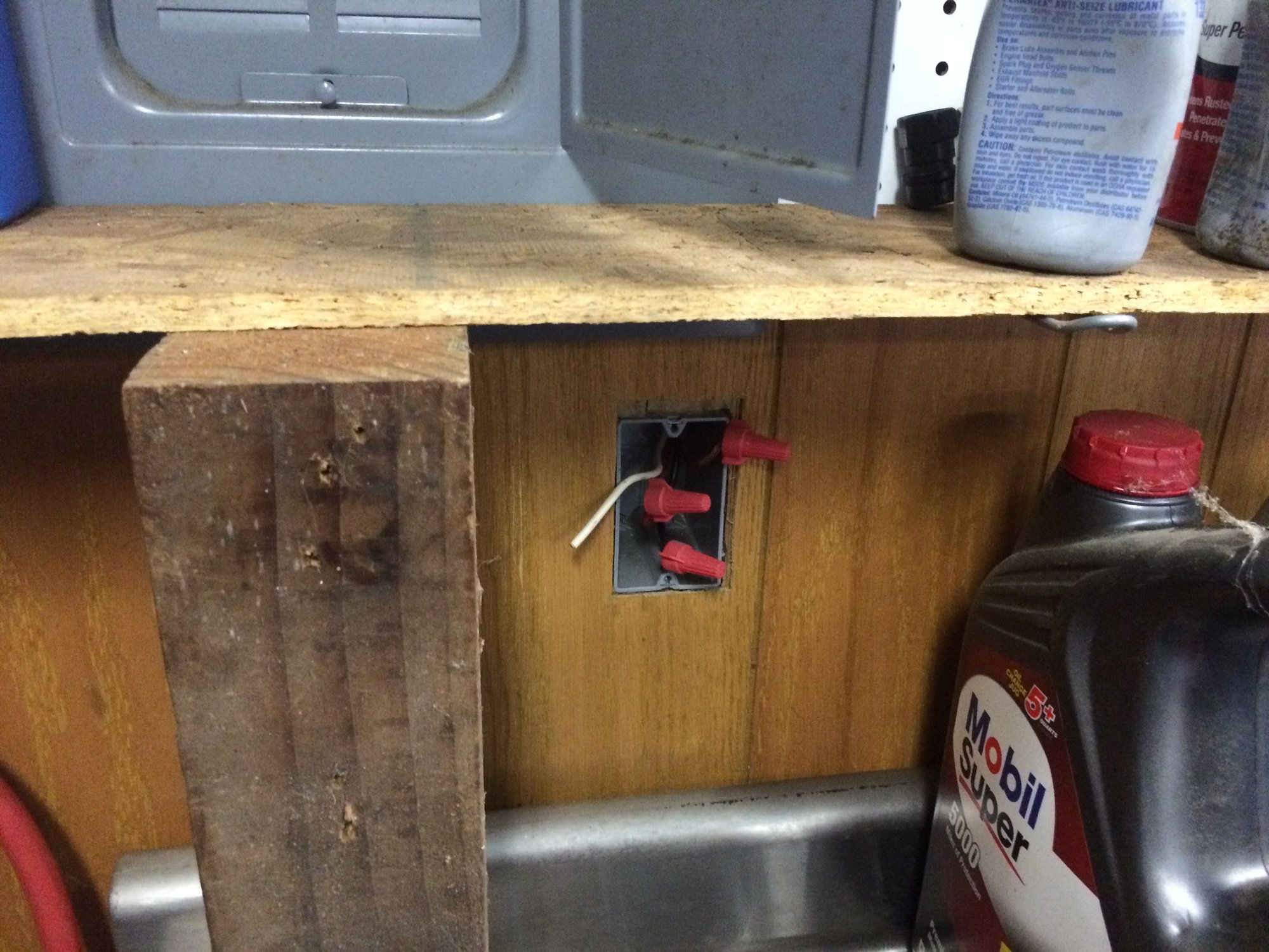

It's going to be a high amp outlet. Think 4 prong dryer outlet. It's for running a brew kettle. The shop has a breaker panel already, and below the breaker panel there is a electrical box with no cover. On the panel it lists that the box is 220 (i believe it is the same box as the one below) and it looks to have a double breaker in it.
The heating element for the brew kettle is from a hot water tank I believe. I think it's just as easy as taking a store bought outlet, and connecting the terminals. I just don't want to burn the shop down if I'm wrong. That would be a bad day.
I'll grab some shots at lunch to show you what all is there already.

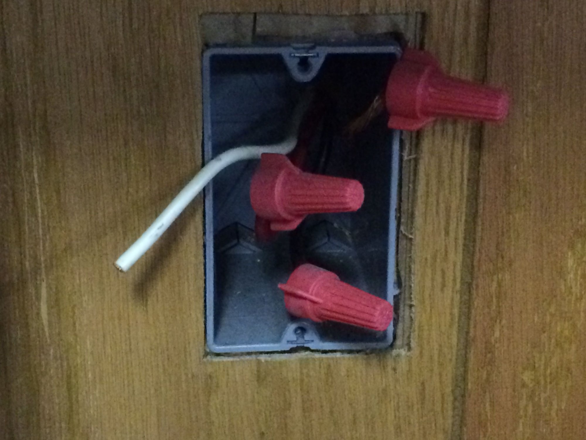

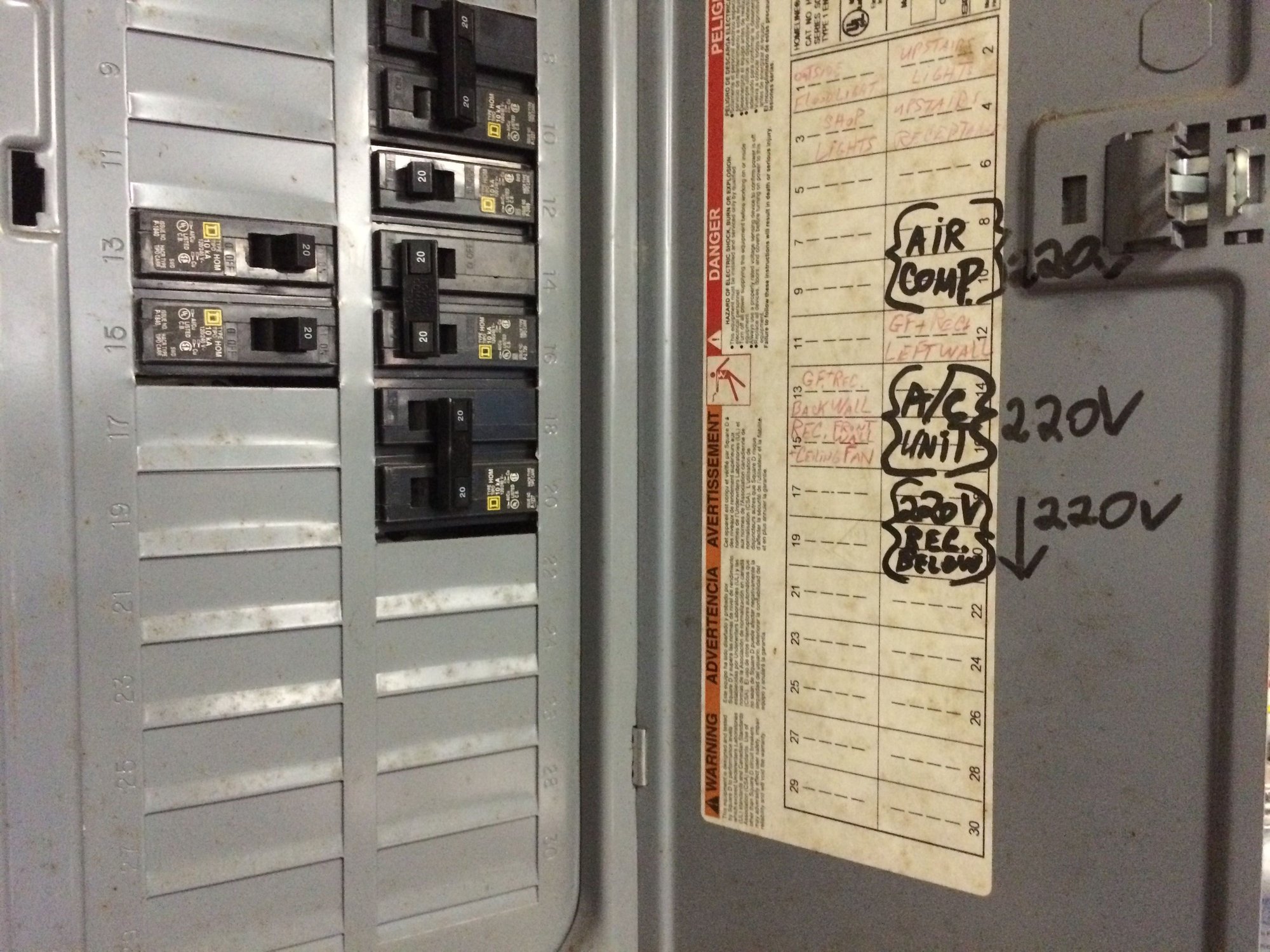

Marty, what do you make of this?
Outlet under panel
Panel
4 wires one is un-shielded, suspect that's the ground.

Looks like they had a small piece of equipment wired or receptacle and took it with them. Judging by the breaker its a 20amp circuit. I would almost bet that the white wire isn't hooked to anything in the panel.
Does your brew kettle have a data plate? and a pic of the plug would be nice. An upgrade of the wiring and breaker may be necessary depending on the amp draw of the unit.

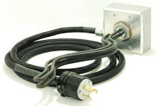

No data plate on the brew kettle. It's sorta home built based on others and internet research. Here's the link where I'm getting my information. The items were also purchased through these guys.
Electric Brewery
The heating element came with a NEMA L6-30 (250VAC/30A) connector
But i plan on switching it to a standard dryer plug, since the NEMA outlet was not available at Home Depot (we don't have a Lowes in Fuquay). The idea was just to be able to plug in and use the boil kettle. If i end up needing to run wiring and such, then I won't have the setup in that location anyway, I'd have it run out closer to the door of the shop.

If the wire from the panel is a #10 then all we need to do is to change the breaker out to a 30 amp. Then put in the receptacle, change the plug out and you're set.
The only thing I don't like about changing the plug is that if you ever get rid of it and someone decides to plug it into a 40 or 50 amp circuit. Bad things can happen if something goes wrong such as a short in the unit or cord.

The panel looks like a Square-D Homeline. Won't be a problem to check the wire size and we can change out that short piece if we need to. No Sweat...go have a beer...lol.
