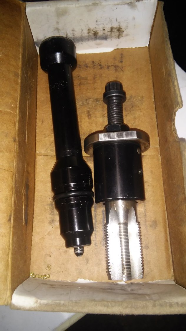

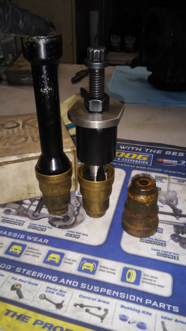

Since we like pictures heres the tool that does the injector cup job a reality
