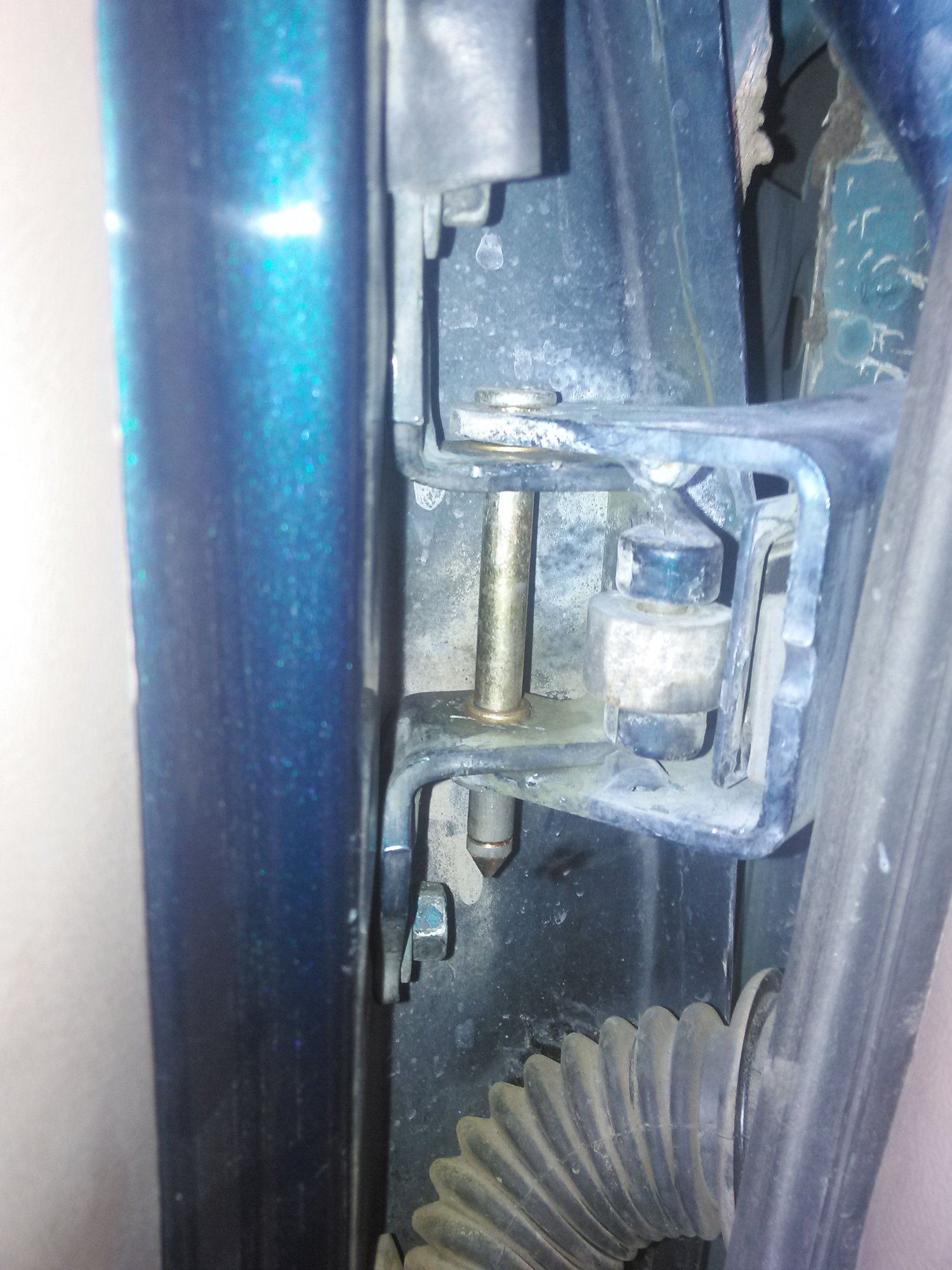

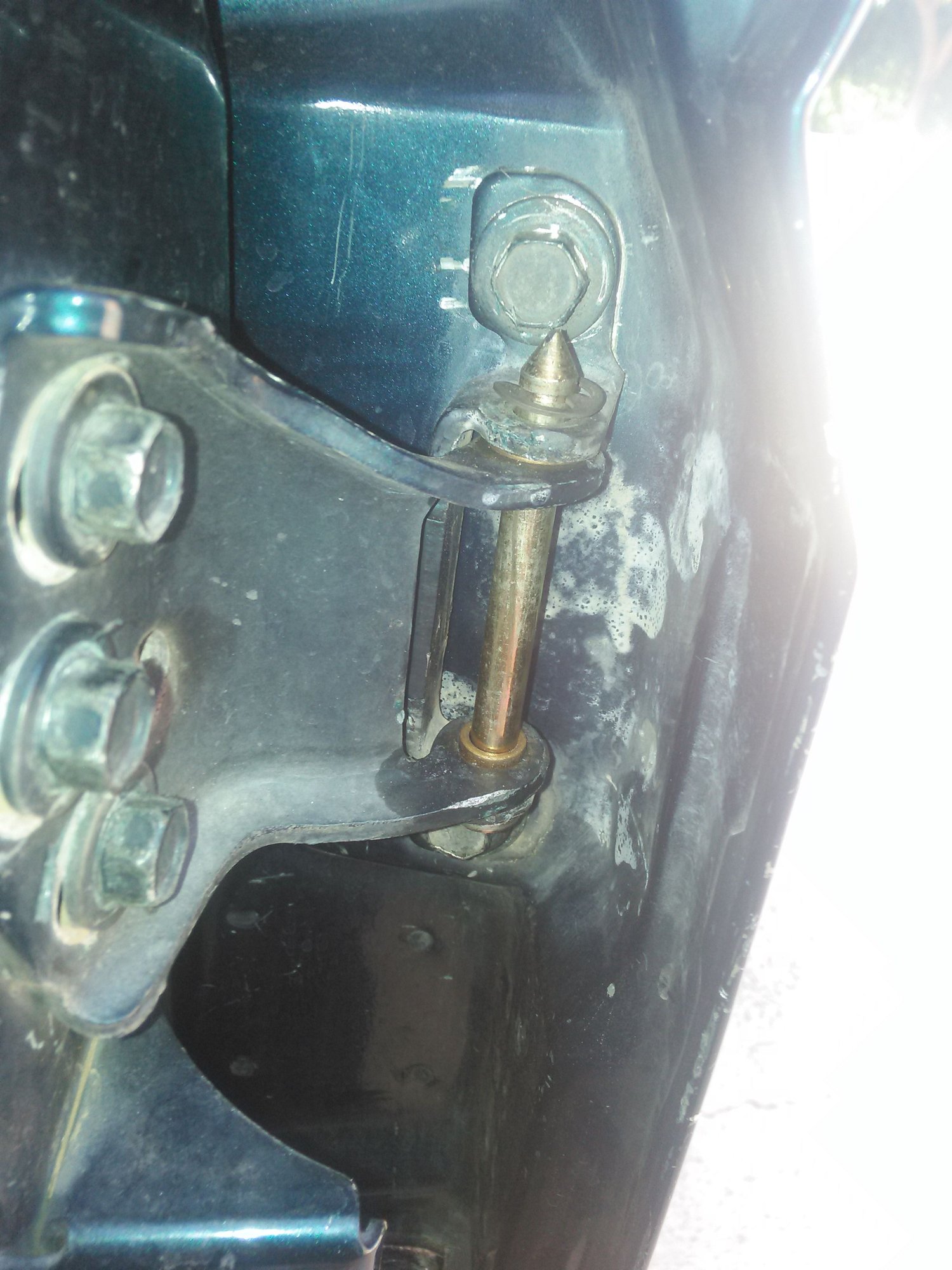

I never did post pics so here they are
Both driver front and rear pins and bushings were replaced.
