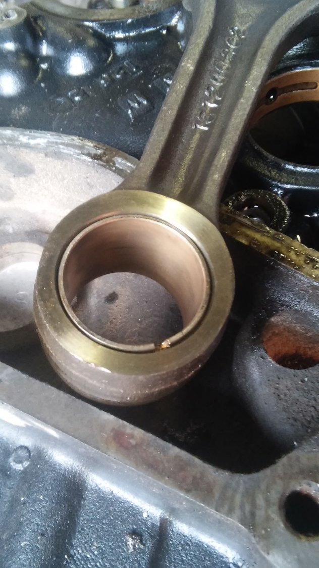

Ok just came back from the machine shop, and my machinest said that the bushing on the rods are in perfect shape and said they can be re-use but recomended me changing them anyway, where can I buy them?
Heres the pic of the bushing wrist pin and the piston that caused the problem
All of the bushings looked like that and he said the tolorences were dead on

Clay has them on his site for 52 bucks
