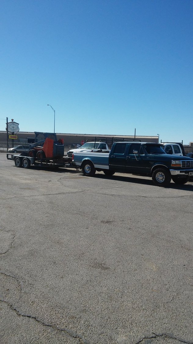

Yup, stock air with an SPX wheel those egts went down 150° towing on a 6% grade heres a pic of the mule towing iirc 10k maybe?
I was on my hot tune towing this and my egts were in the 1180° iirc.
