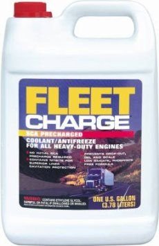

Ok came back from the machine shop, good news heads are done and those new valves look nice and have alot of meat on them compared to the old ones. He starts on the block somewhere this week.
I notice that the rebuild kit did not have injector cups? I need to buy some
Now for some questions.
What kind of antifrezze can I run with new OEM injector cups?
Is the break in process the same as a gasser?
The oil jet look great with no stress cracks or anything. Can I just get away with using the same ones? Or do I have them weld the oil jets?
Decision made on what color im going with stay tunned for more updates on the Mule.

So its the same break in process as with a gasser. Thanks mike any input on tje coolant I should use with the new injector cups? They all have part #'s
Old Mar 22, 2016 | 10:04 PM
  #343
fordpride's Avatar
fordpride
Joined: Dec 2009
Posts: 15,505
Likes: 18
From: Livoina,La
Fleet charge.... It has the sca additive in it.
I'd also do the first oil change at 100 miles then another at 1k with some cheap oil the start using whatever it is you plan on using

Good tip on the oil Mike, I thought I read somewhere that the later 7.3 only took elc due to the injector cups.
Old Mar 22, 2016 | 10:28 PM
  #345
fordpride's Avatar
fordpride
Joined: Dec 2009
Posts: 15,505
Likes: 18
From: Livoina,La
I've run this in my other truck for 4 years without any issues
