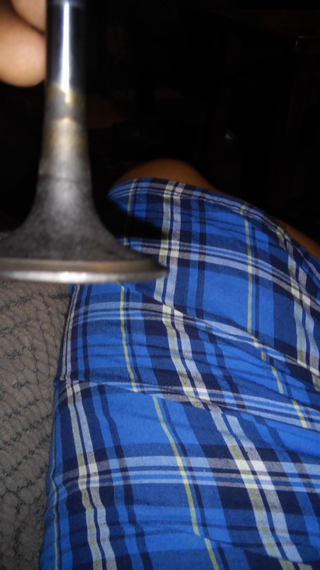

Got a call from the machine shop, he found me new oem IH valves 8 intake 8 exhaust for $100, he told me they were left behind after no one came to claim them 2 years ago, I got lucky and he told me he had some but had to look for them. Score

Heres the intake and exhaust in order
Theres no saving those, they will become shop ornaments and so will the pistons.

He said he can still work with what the head had, the compromised cylinders left alot of carbon deposite making it look like it was pitted.
That is a good thing valve seats are not cheap to install.
Did the machinist think these carbon deposits were normal or what would cause it to be so bad? What do think the cause?
Or is it just from too many miles and poor compression?
