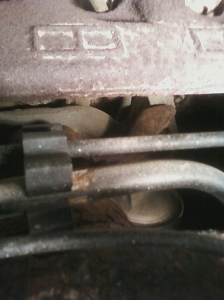

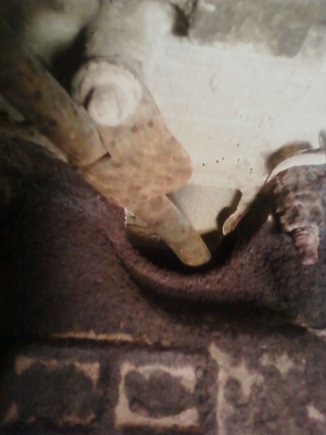

Originally Posted by wizkid00104
Matt, could you get me a photo of where the dipstick goes in the block before you remove it? I've never seen a good photo of it and I know it is trick to replace with the engine in the truck.
I'll get you a pic tomorrow, I have my wheelwells out so I can get a good side view..
I didnt get to take pics till after dark but here is where it is above the exhaust manafold
Here is where it is below the exhaust manifold
Assuming it goes straight into the pan from there but tomorrow if you need it I will take a pic under at the pan

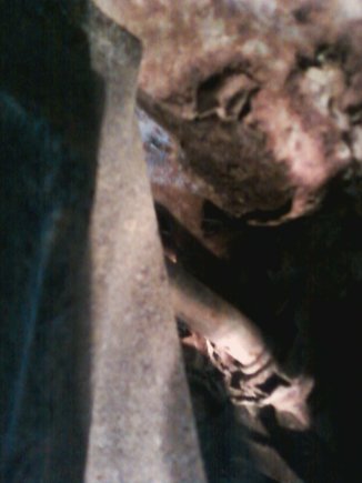

Wizkid00104 here ya go!!
