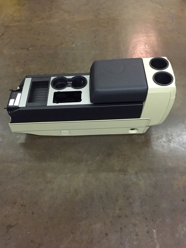

1) What do you all think about swapping in an expedition console instead of trying to make a complete one from scratch or shelling out the major cash for an SD one? I can obviously make all the measurements and hell even test fit once i figure out how to remove the one in my Expy. I could make a few filler pieces instead and fill the gaps where there might be some. I figured this will allow me to use my Mustang shifter since the hole is the same dimensions as the expy one and i can easily have space for my fuse panel to make a door on the side to access it if need be. My thoughts are it is a solid base to go off of for much cheaper than an SD console which i still may even have to modify some to get to work properly. Thoughts on this???
A custom one will be nicer however if the expy one looks good then go for it. I forgot what color interior do you have?

I'd need pictures to give input on the center console.

As fro the console below is a pic that i found on Google that i felt suited the profile well. My plan was to basically make a filler piece for the sides and then if there is a gap on the top par then there as well and i would make a door on the side for the fuse panel. The shifter i got fits right in there with no issues since the base is identical to all of fords floor shifters with a rectangle base lol.

I like that console. It looks like it would be nice in your, but I'd have to see it in the truck to be certain. I think a test fit will be in order.... Start ripping the Expy apart :-)

Haha i agree about the test fit i was planning on reusing the 08 console mounts because the 08 console is going to go in the F150 once i swap it out. I will take a few measurements from the Expy before i make a move on anything, i think it will match nicely because the Expy and 08+ dashes are similar in design.

That looks like the console in the new 10 f150 minus it has wood grain not silver trim since it is a lariat.

Console looks like a cool idea. However I do like the Super Duty Consoles as is. Gives a nice OEM+ touch.

Yesh its just the SD consoles go for 800-2k on average and i think obe of these should match well and fits my shifter and everything stock.

Thought you already had a 08+ console.
