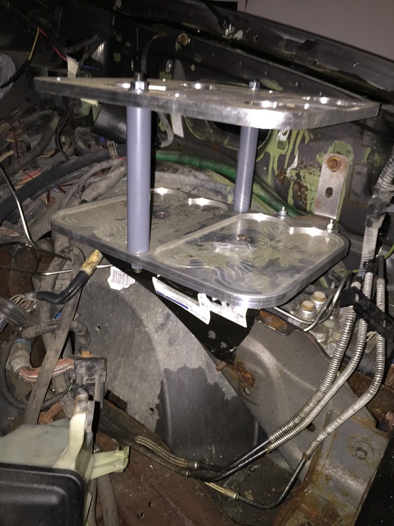

Last night i received a 6.0l driver side battery tray, i needed one to mount my Destroked dual battery tray on the drivers side. They dont state that anywhere but i figured it out really quickly lol.
The tray came with two bolts which you can see in the bottom of the tray here:
These hold the dual trad to the 6.0l driver side tray and give it a sturdy mounting place.
There is a second mount that give it side to side rigidity that moutns right into the inner fender well:
I still have to unbolt everything for POR so i didnt bother mounting up the battery tray just yet but here you can see it has the same mounting position in a 5.4l as it would in a power stroke:
The tray is much more sturday and i am thinking about building a small plate that will sandwhich between the two trays and coul dserve as a mounting place for my fuse panel and wiring.
I am going to utilize the old 5.4l passenger side battery tray to make a mounting plate for my Aux fuse box and AMP steps. I will shorten my amplifier cables and run them directly off the batteries and then i can run a wire over the the fuse panel and it will really tidy up the engine bay a boat load. I am so excited! hate how cluttered engine compartments are so this really makes me feel good lol.
