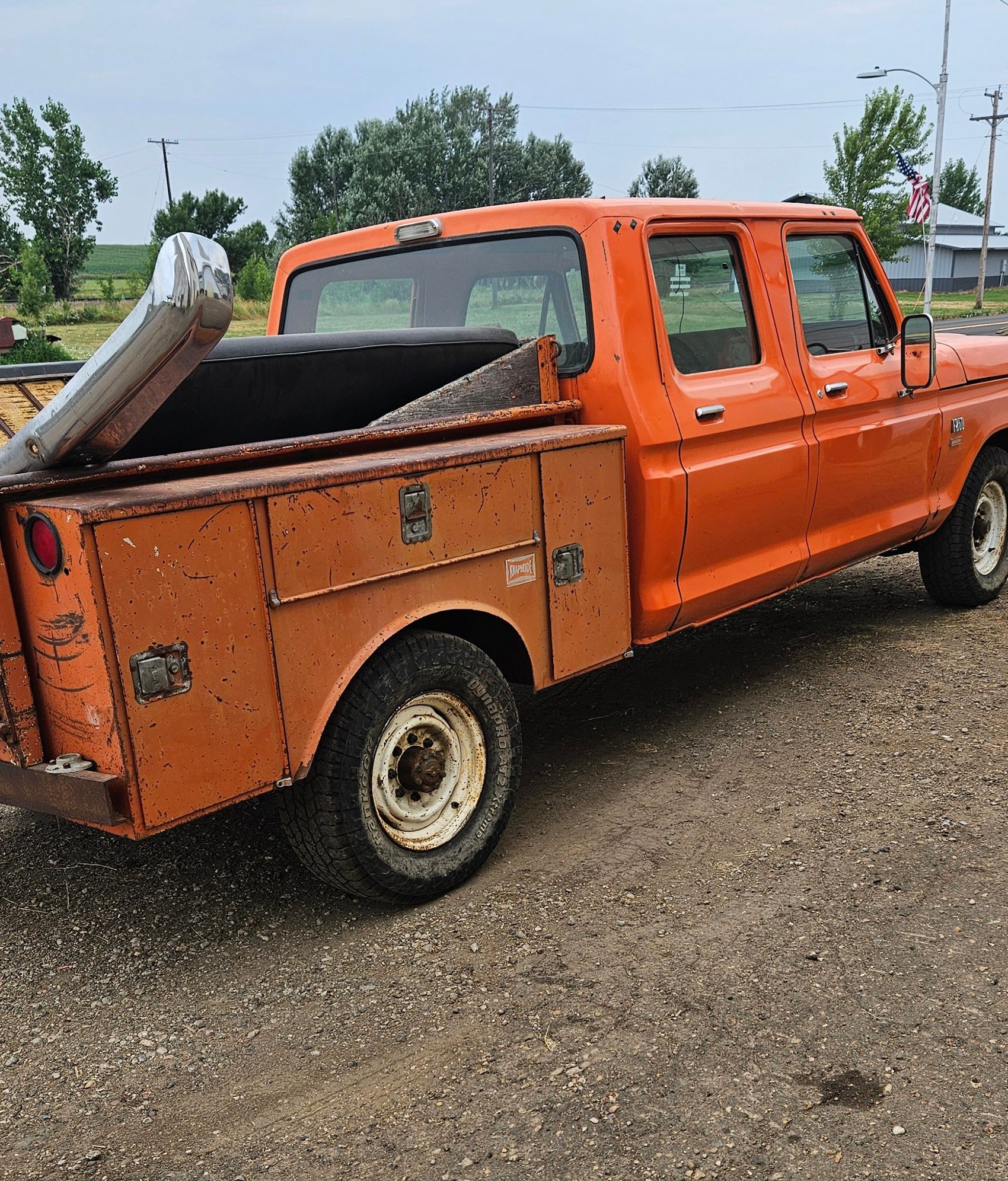

75 with old knapheide box?
My old 75 crew that I purchased came with this box. It's a f27 shortbox, so 2wd. Marti report says it was a cab and chassis from factory. Does anyone know of any other dentsides with a box like this on it? It's currently in very rough shape, unfortunately!

I used to drive a '65 F-100 for the school district (light blue over bright yellow [former US Navy vehicle?]) with the same box.
Mine had a pipe rack welded to the top corners of the boxes, with a vice mounted on the bumper where your pipe flange is located.
These service bodies are surprisingly easy to work out of; if l recall, the middle doors open flat to provide a nice portable work surface.
If you are thinking of replacing it, a nice flatbed would look great on your orange '75 until you can find a factory short box.

Haha, I've been looking for a factory short box for 2 years!

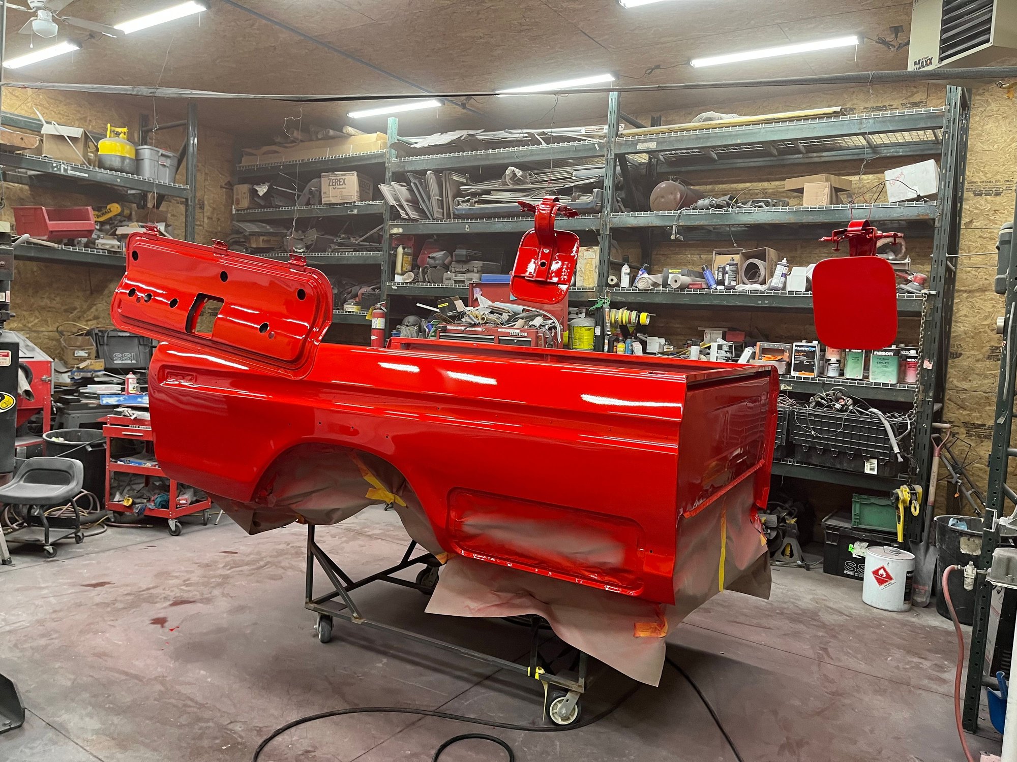

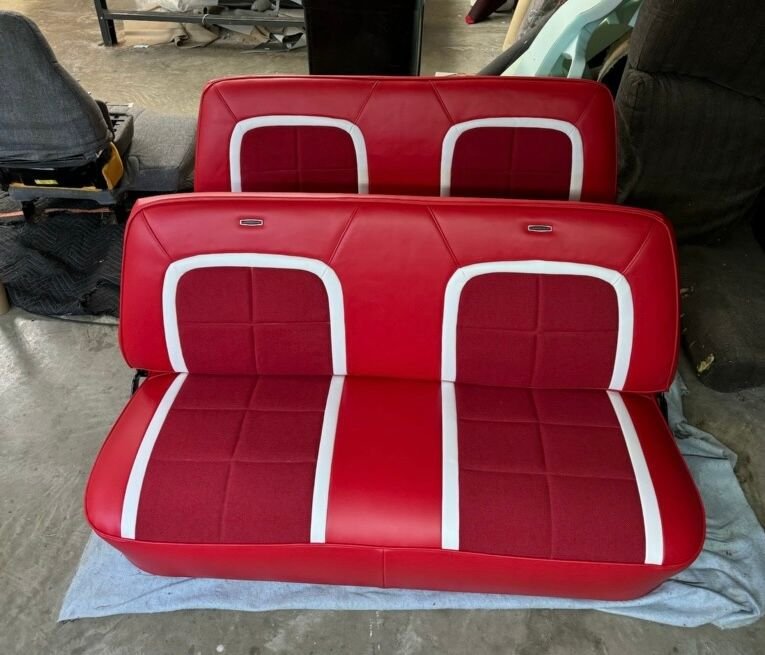

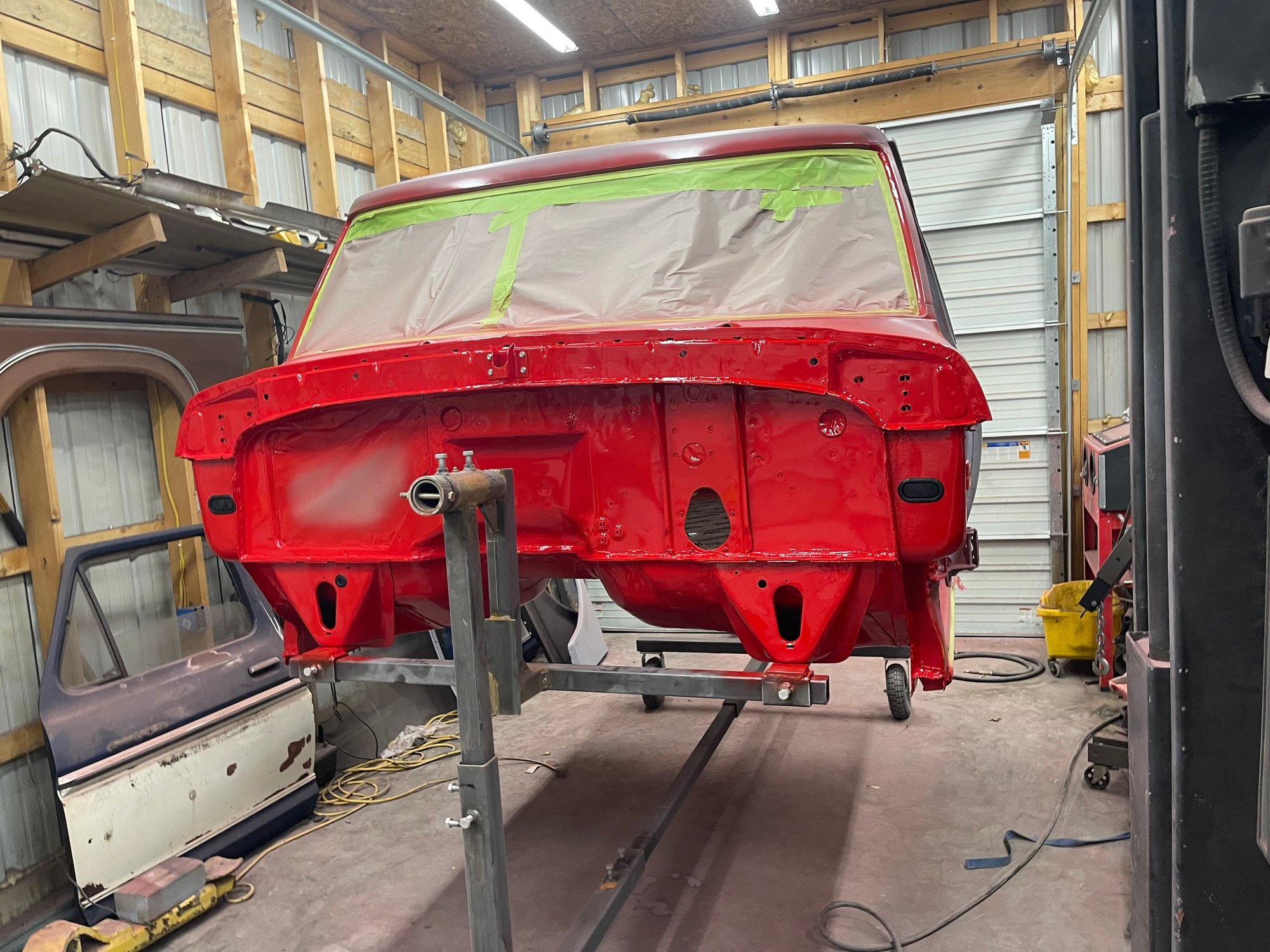

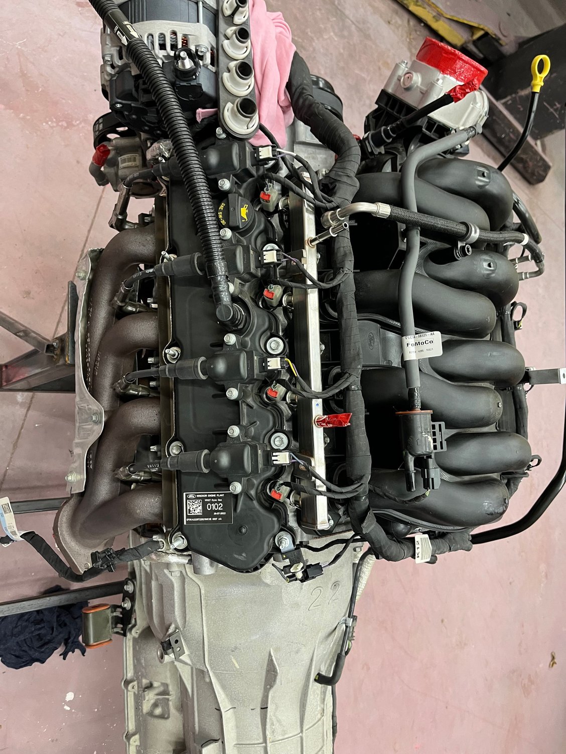

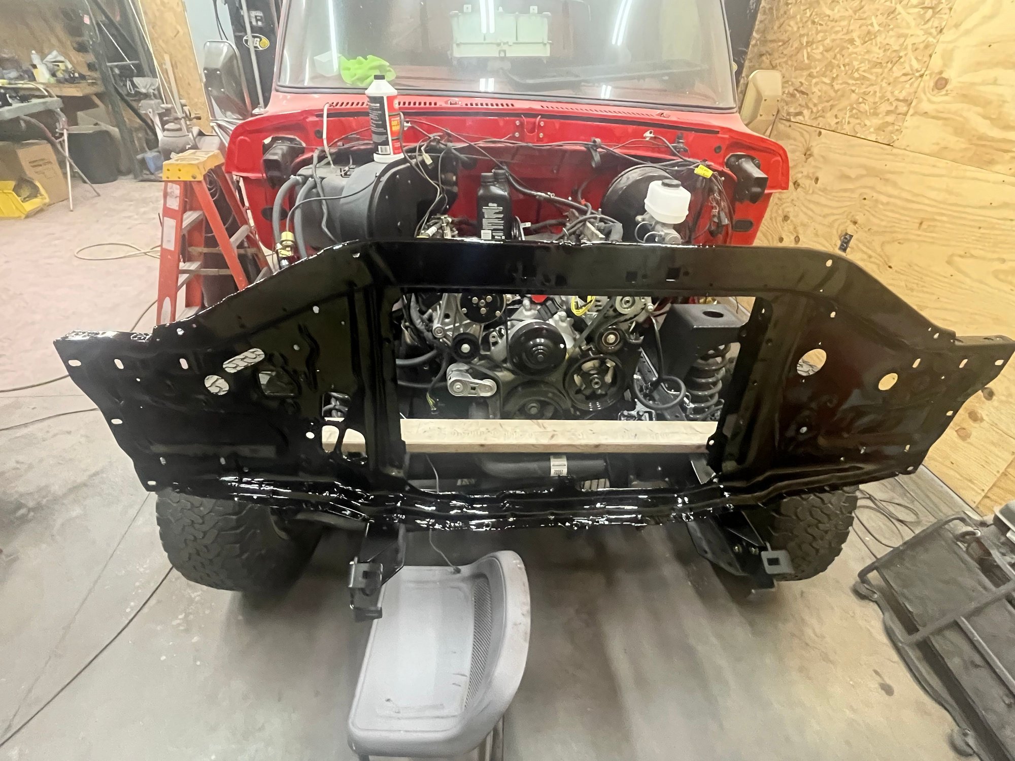

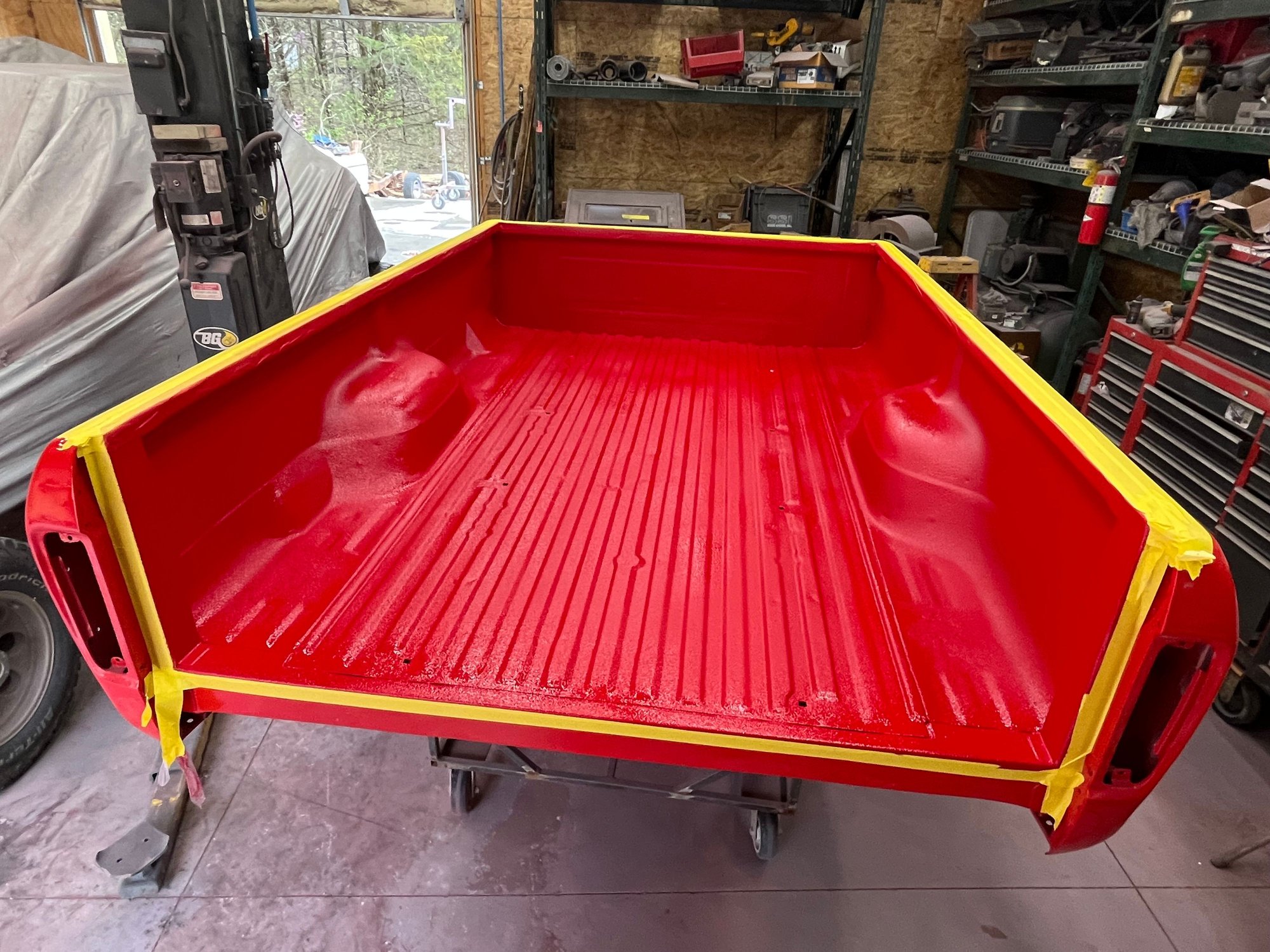

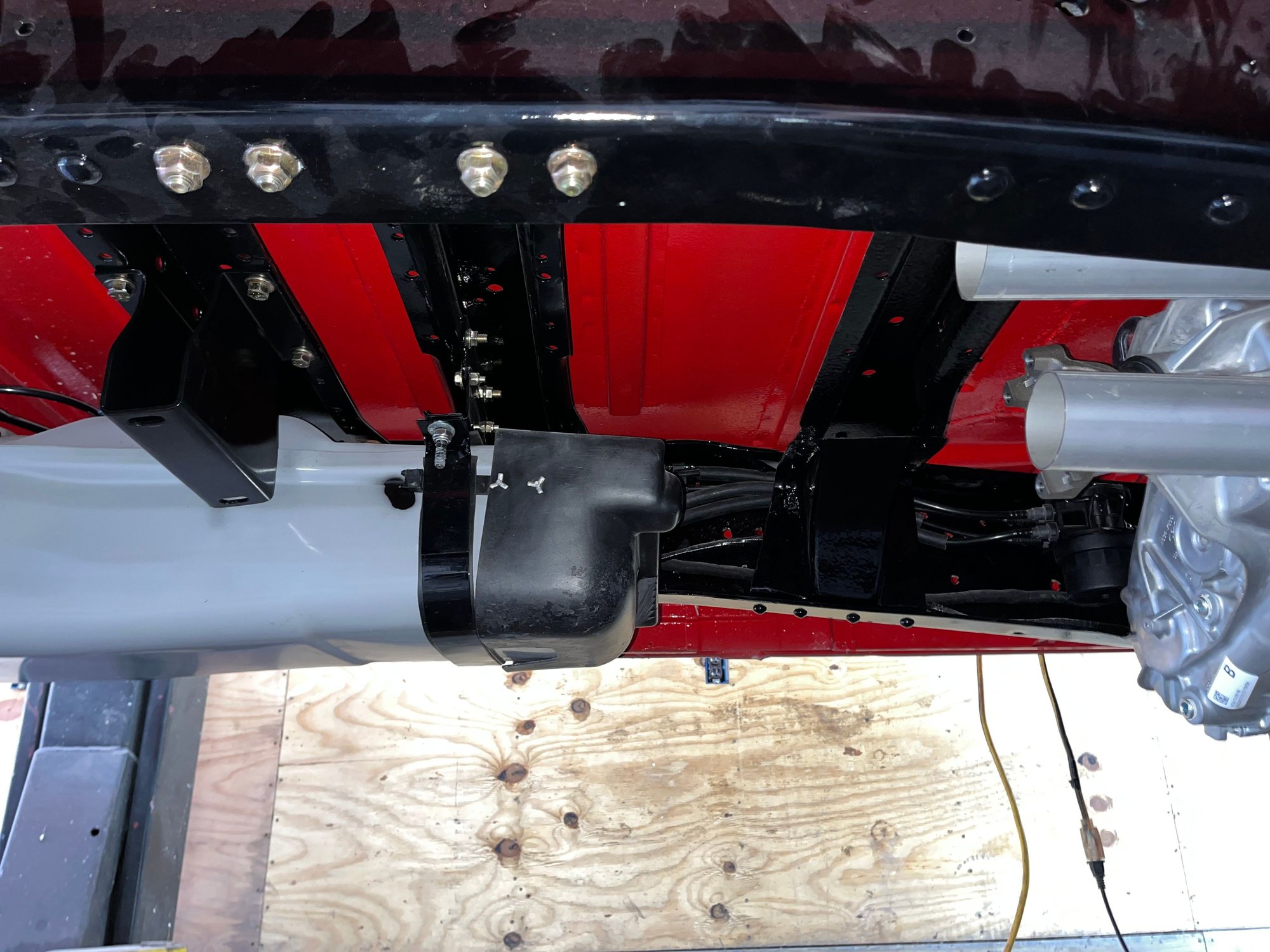

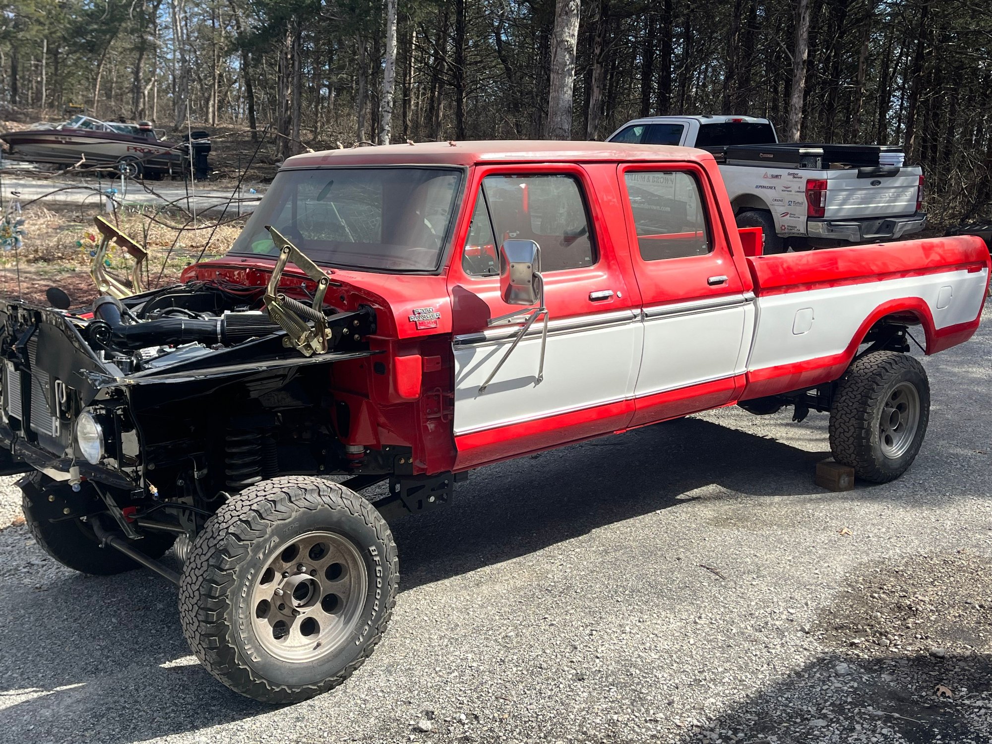

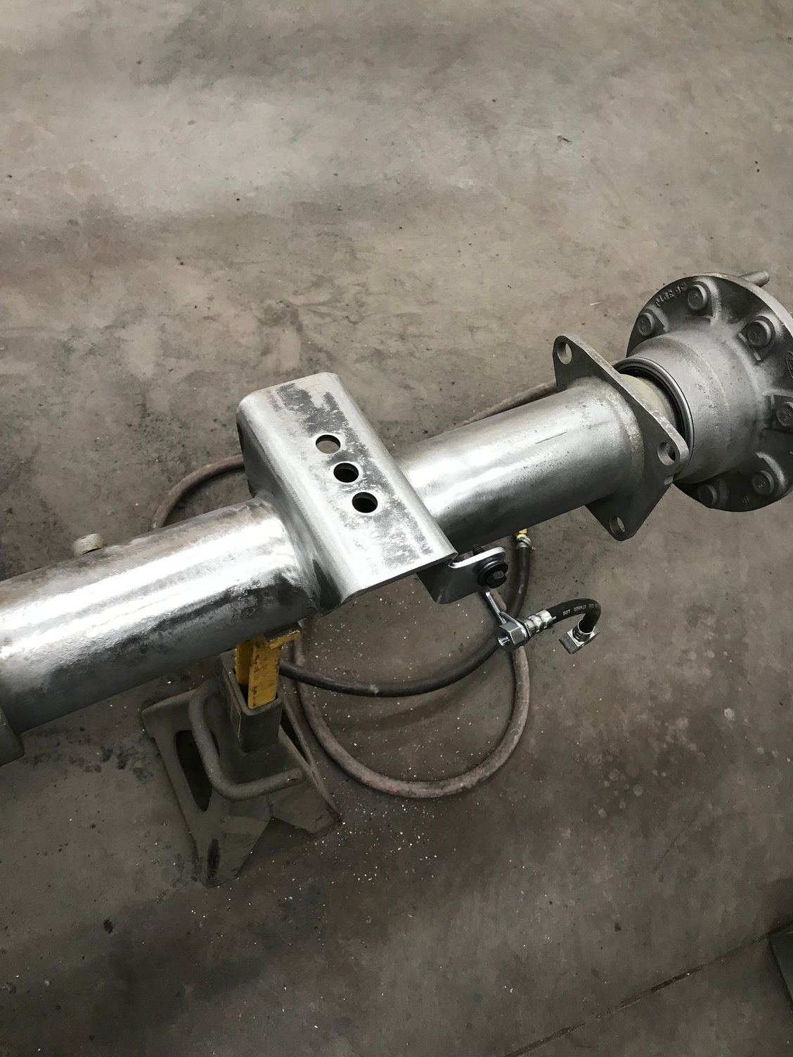

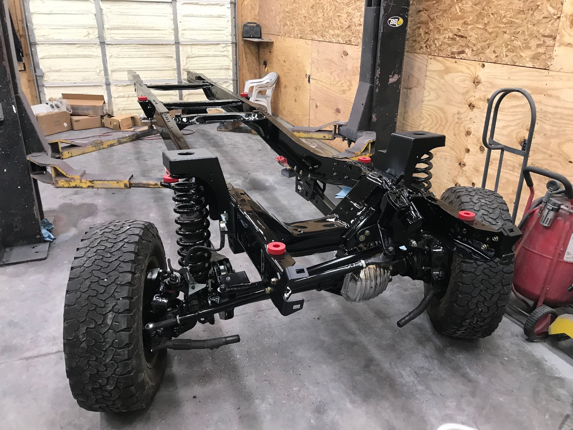

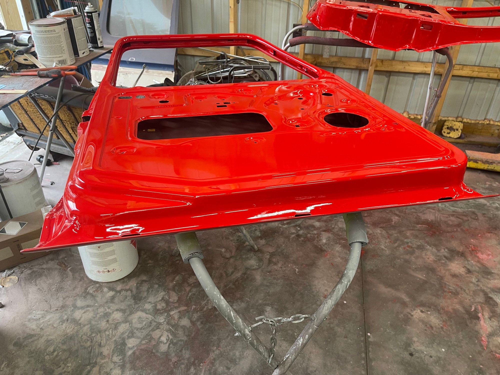

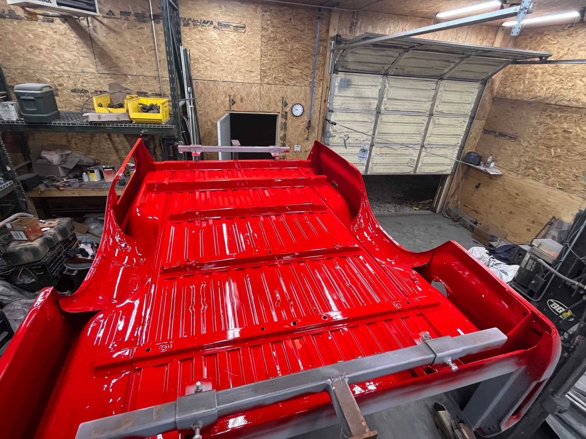

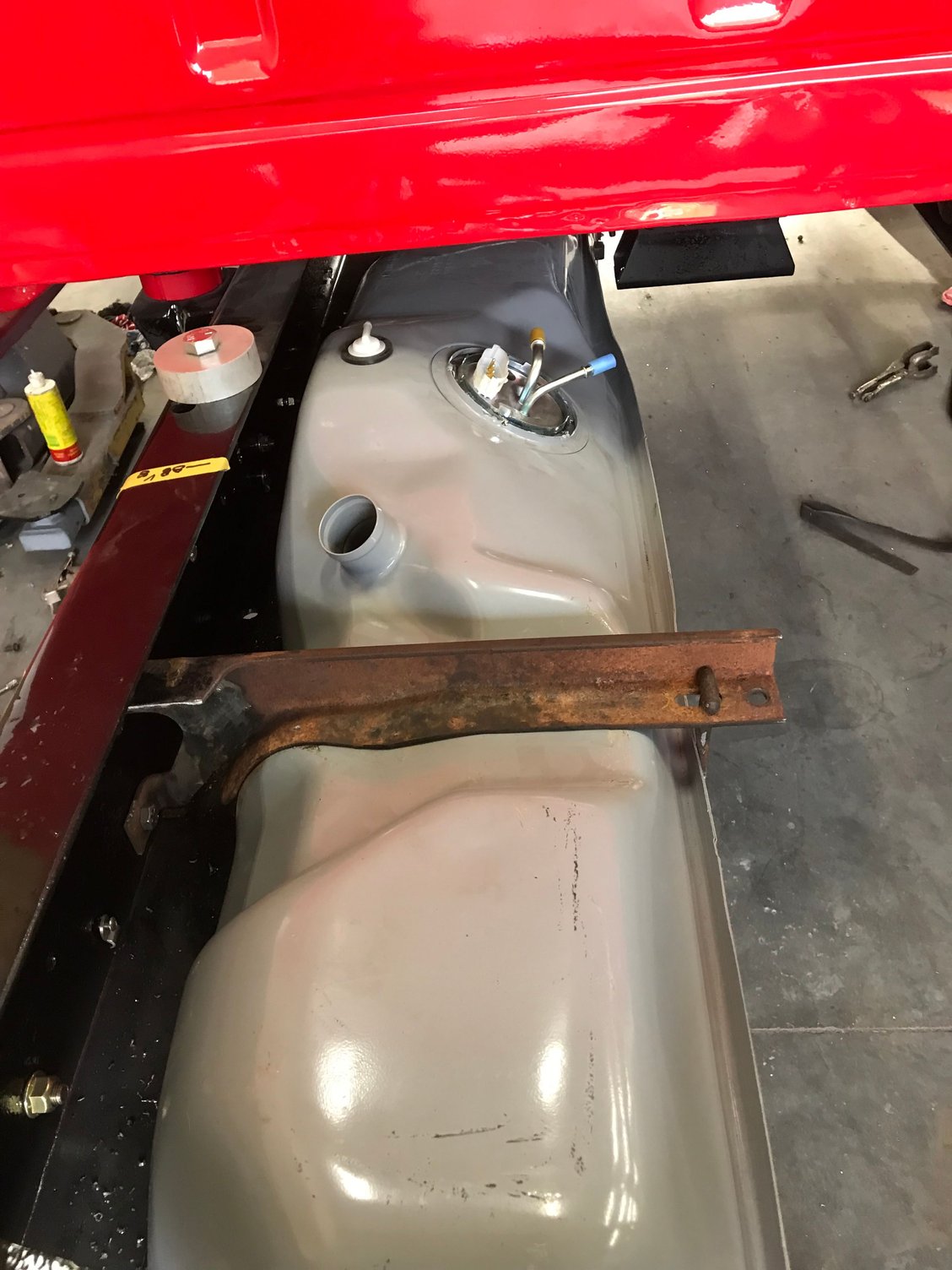

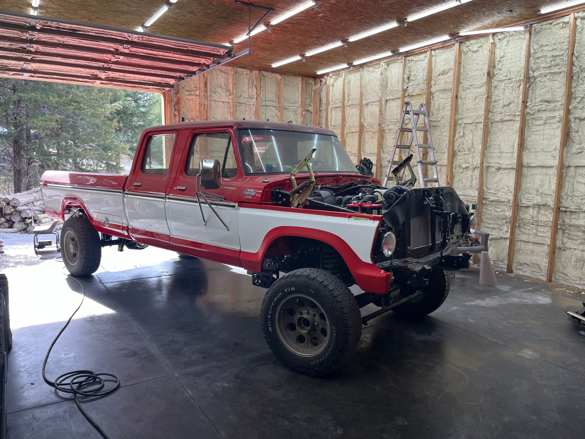

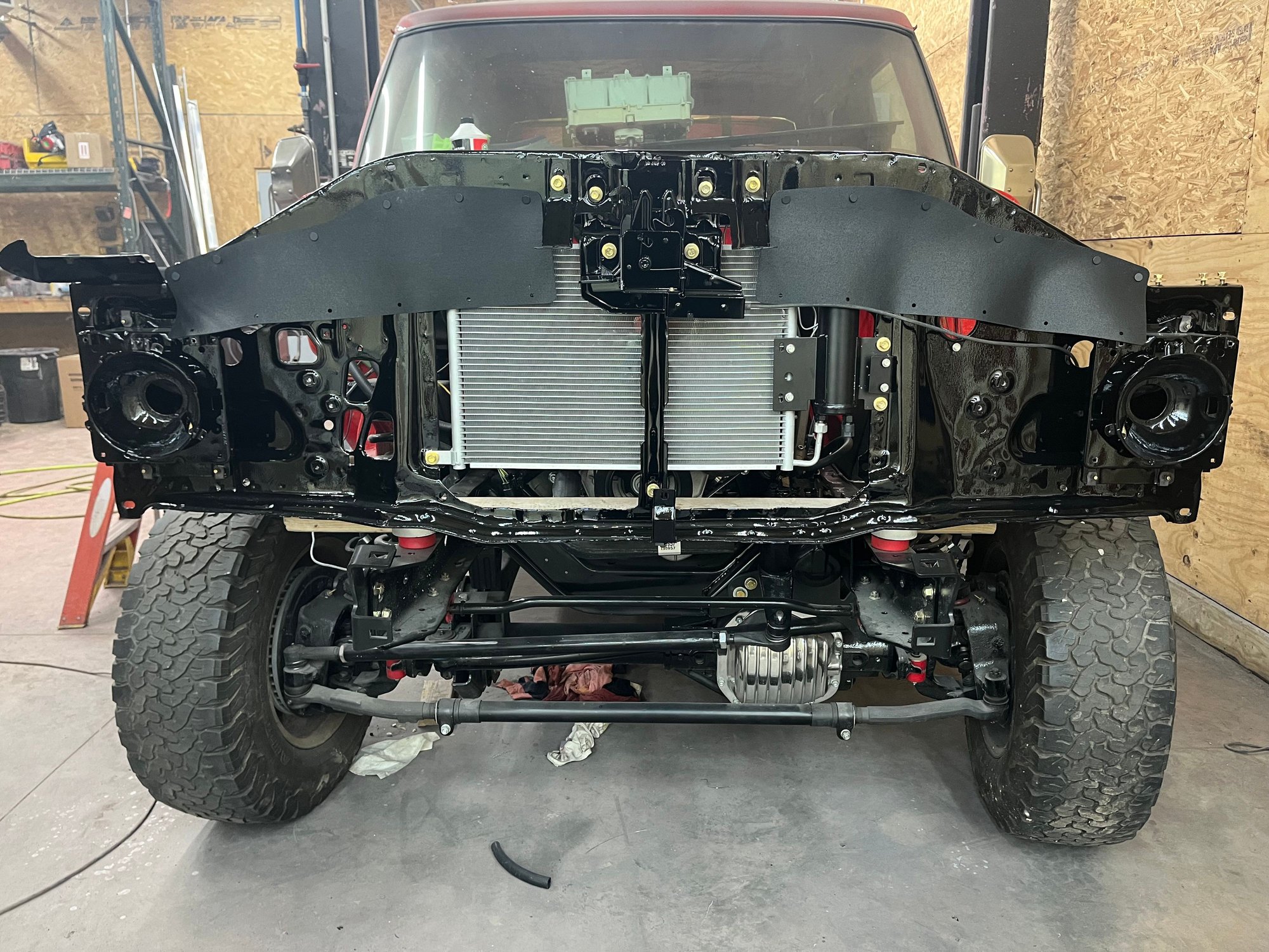

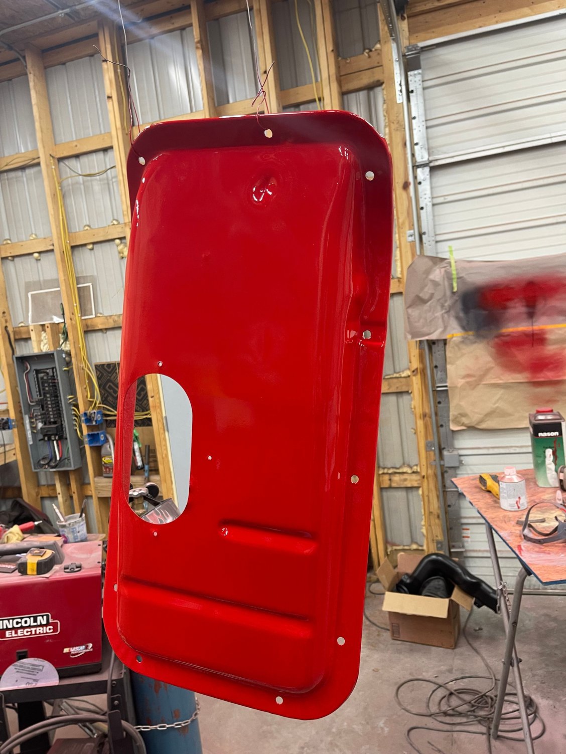

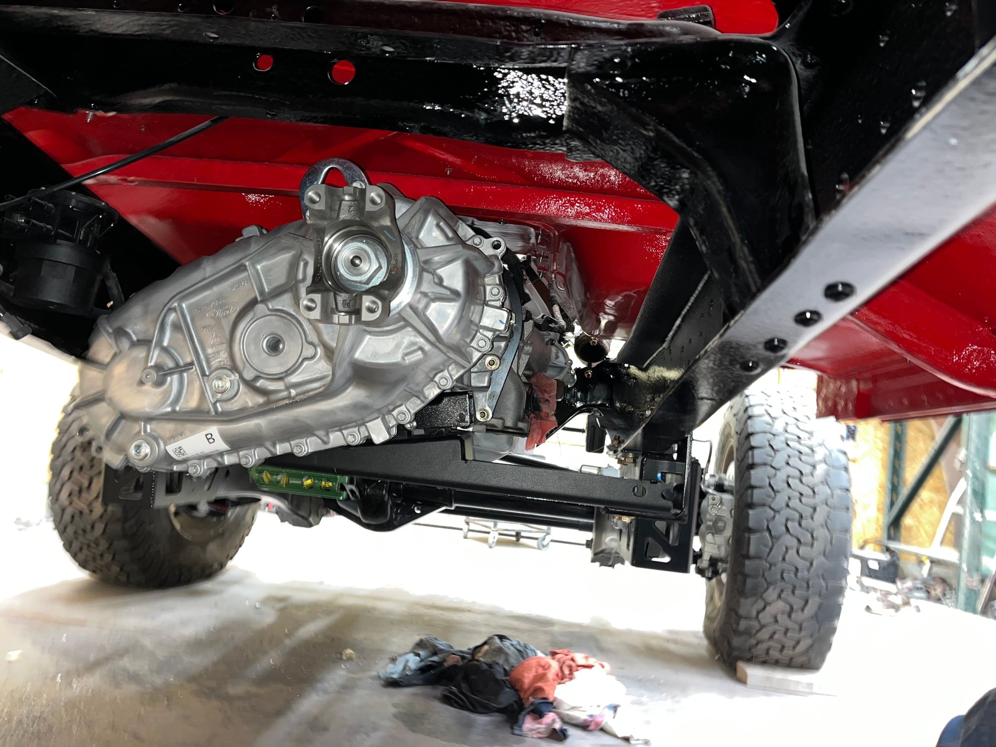

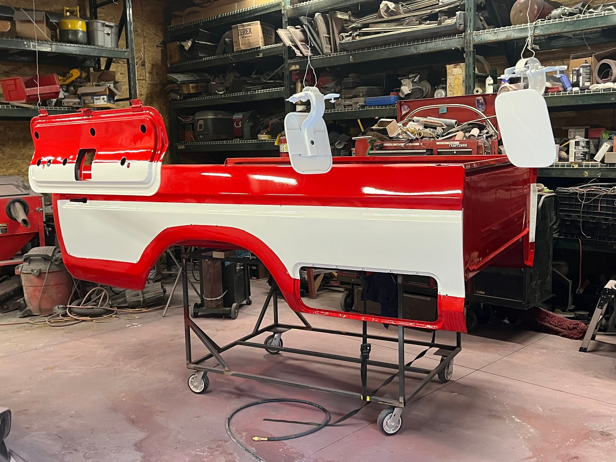

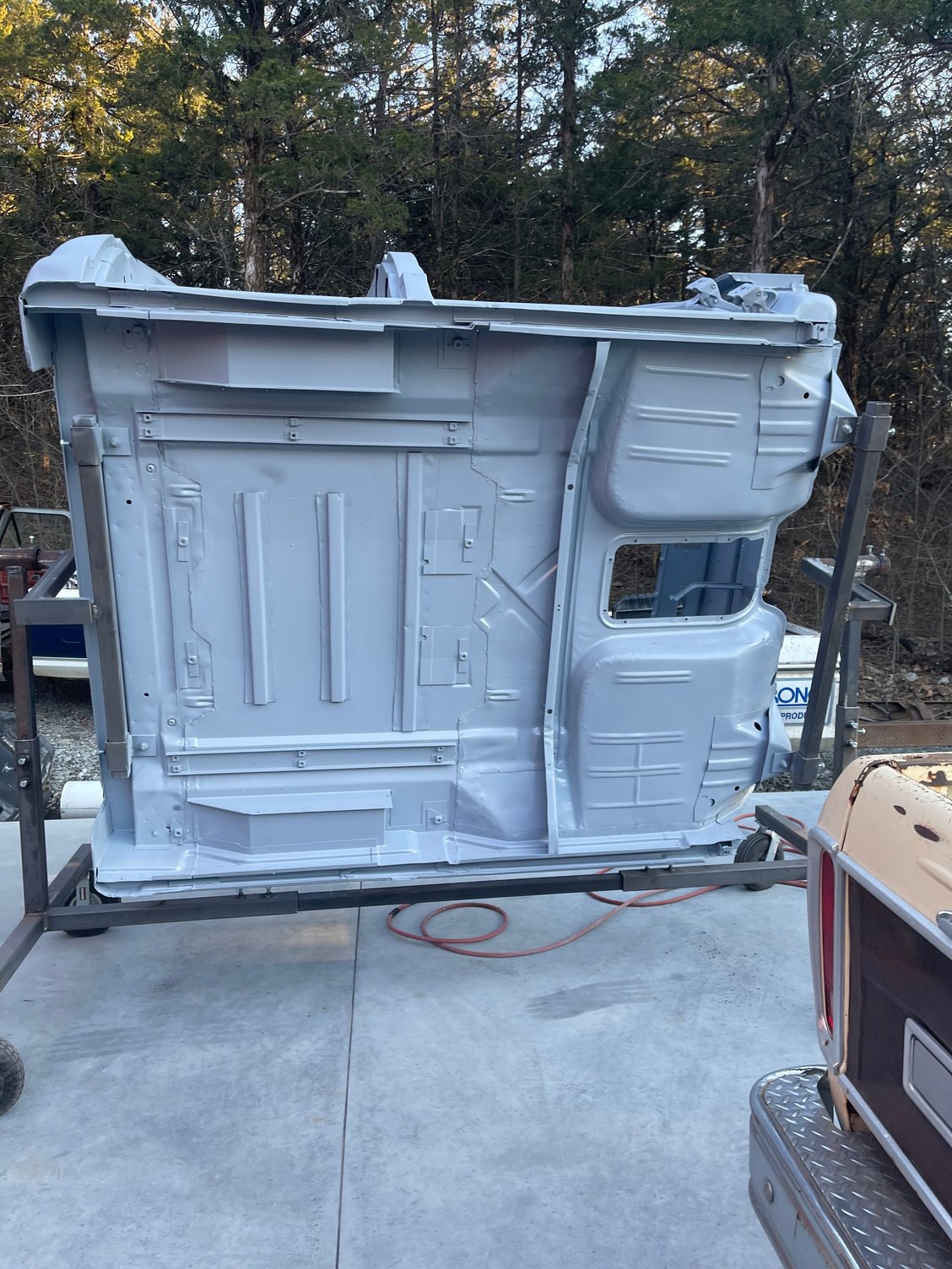

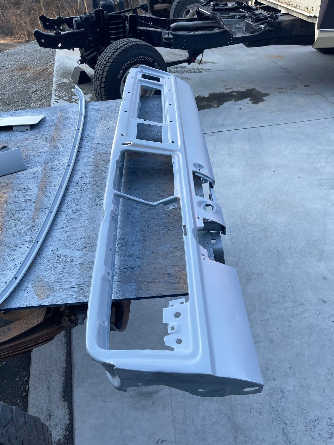

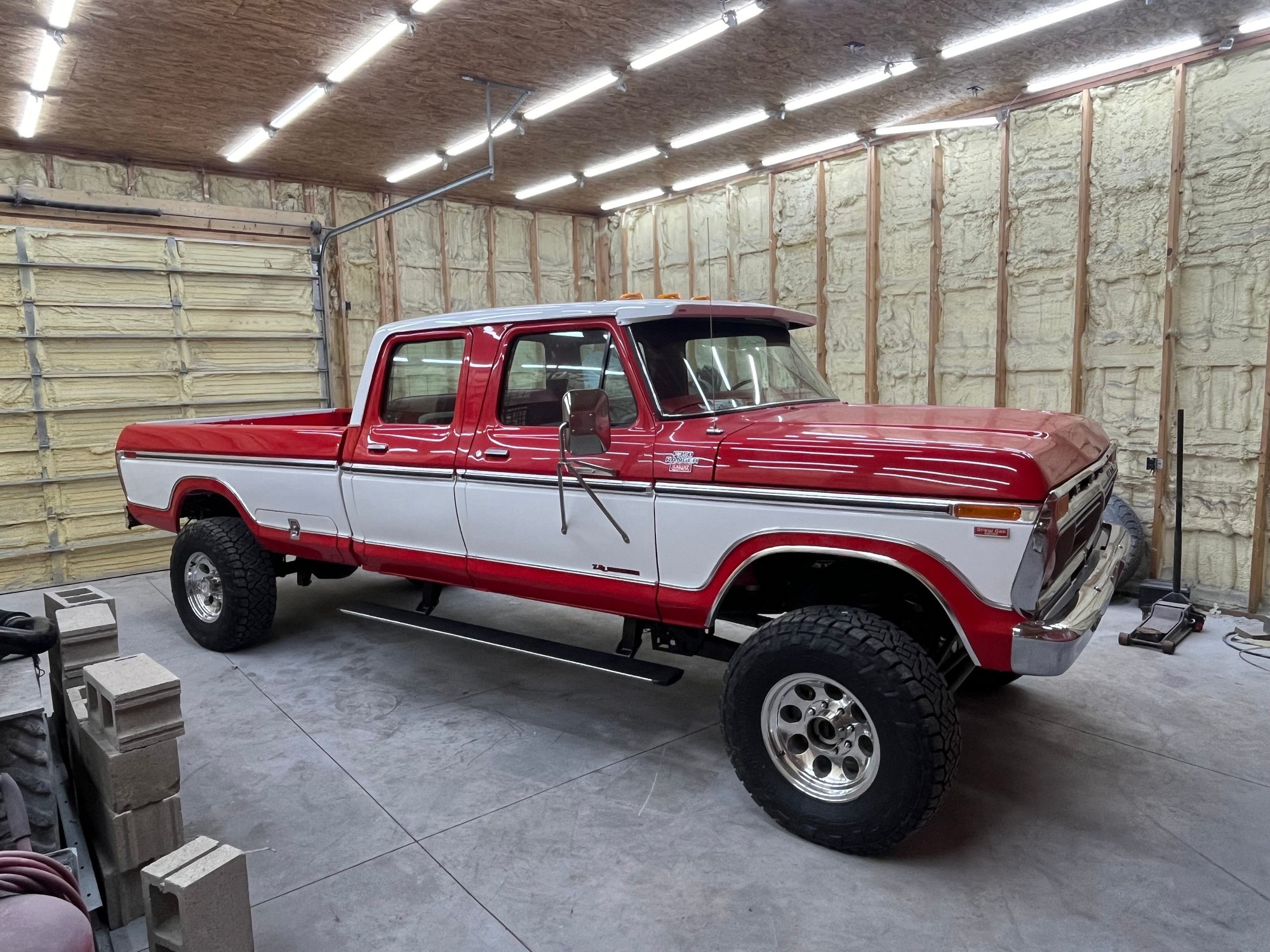

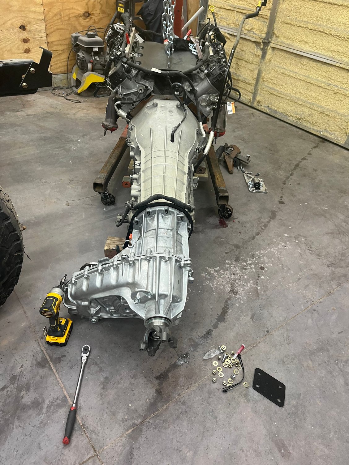

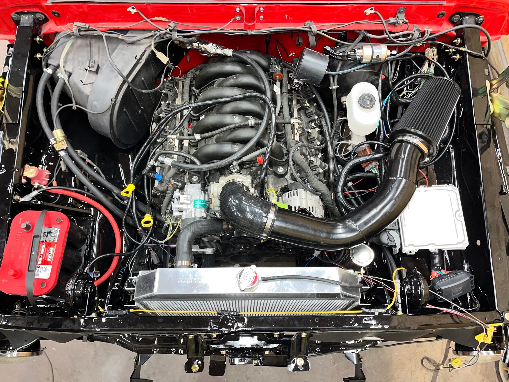

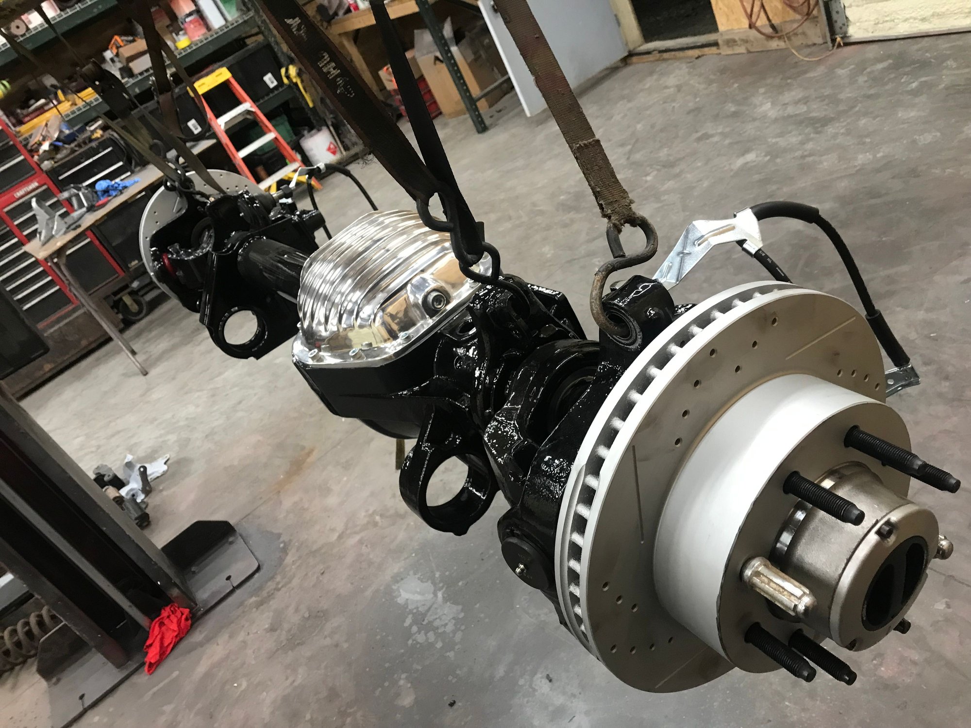

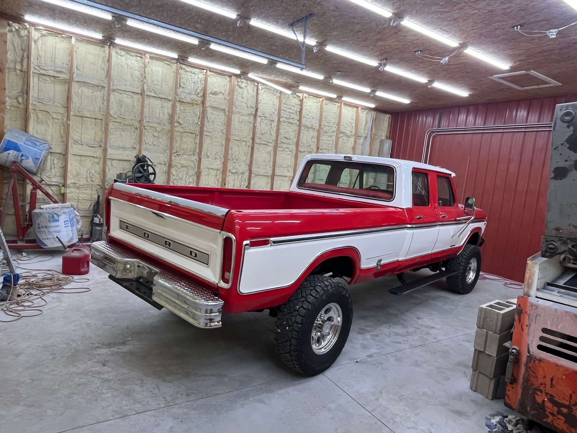

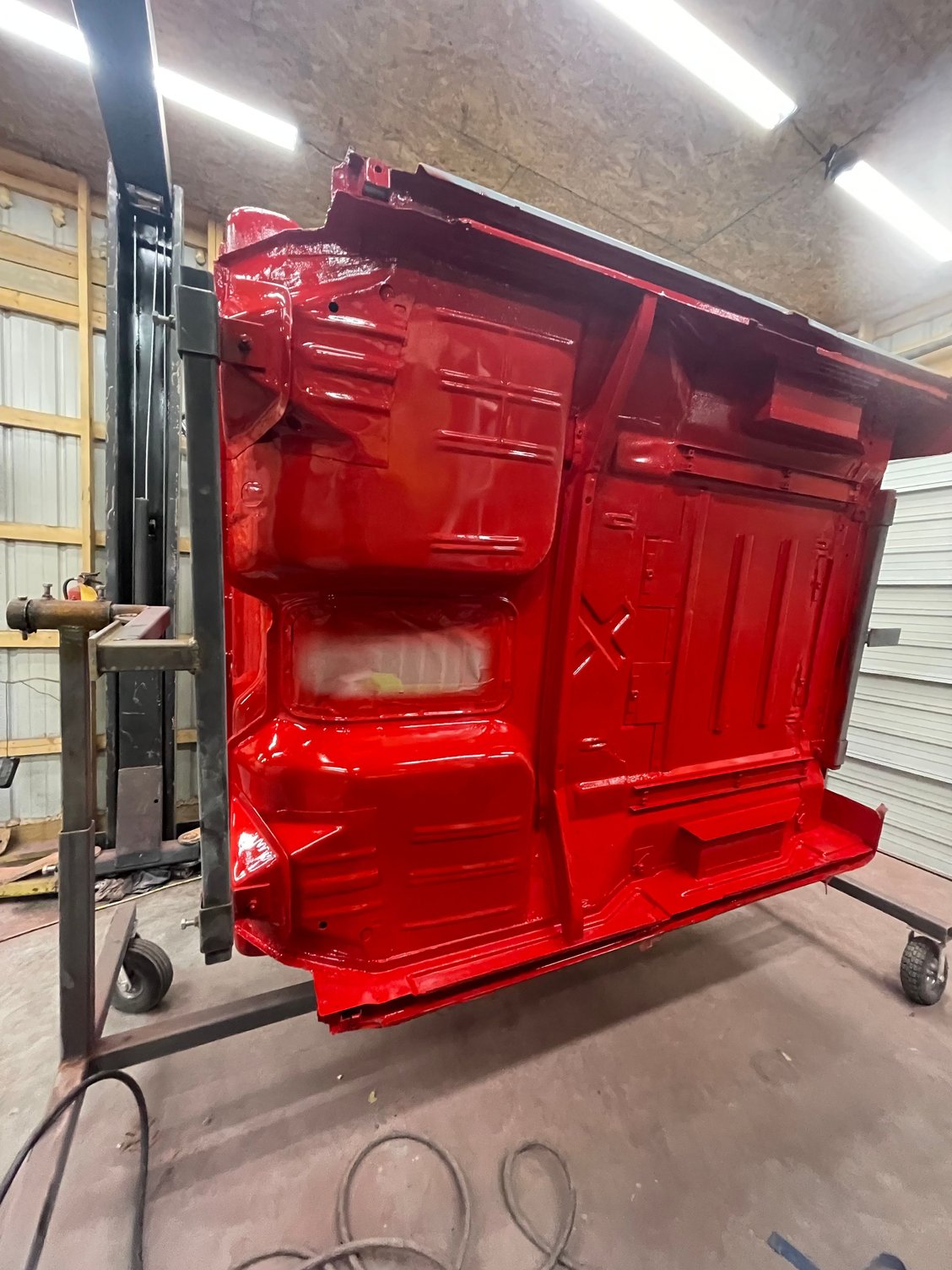

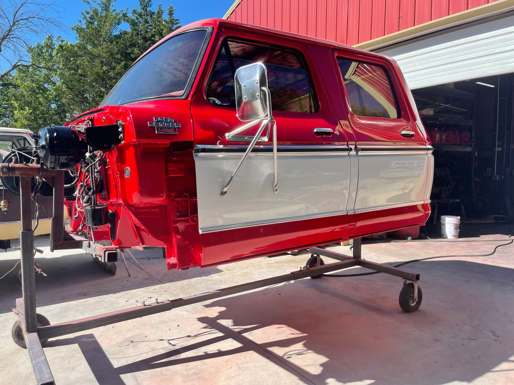

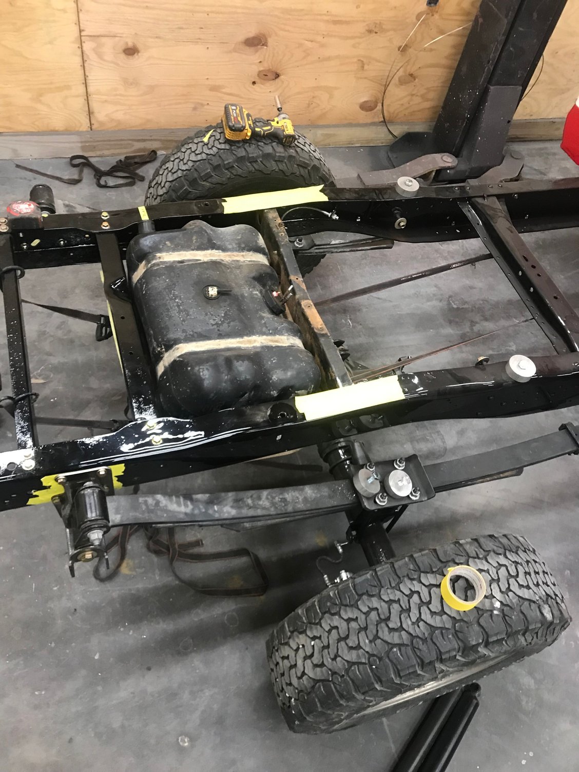

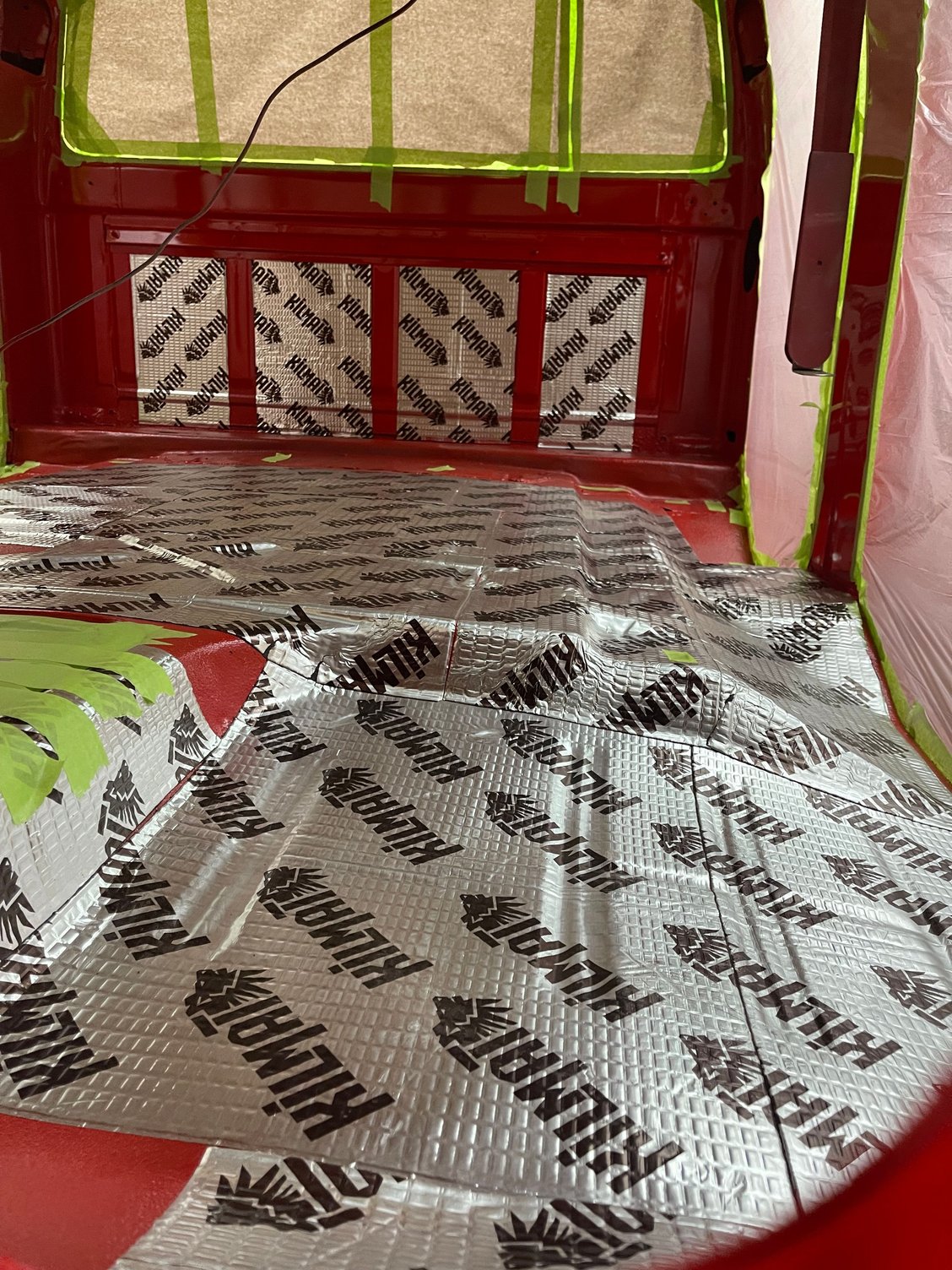

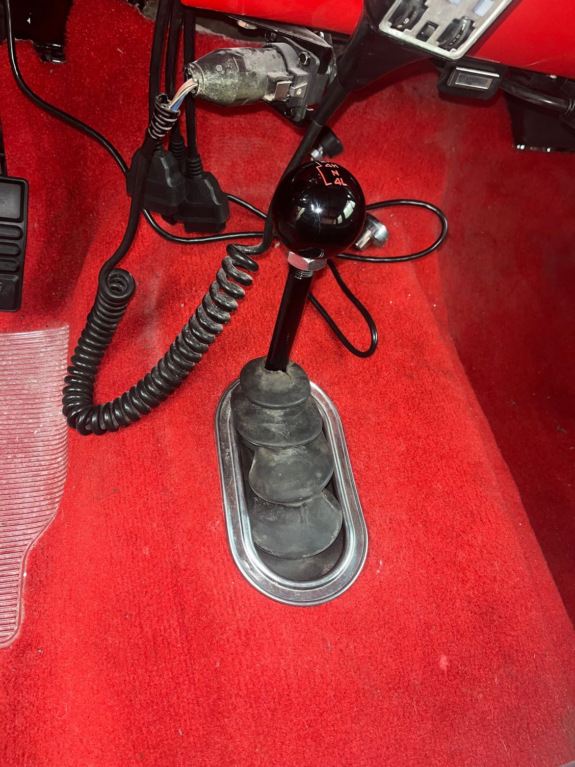

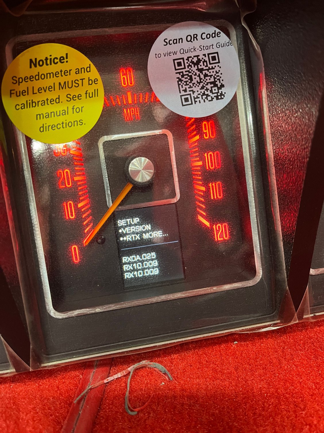

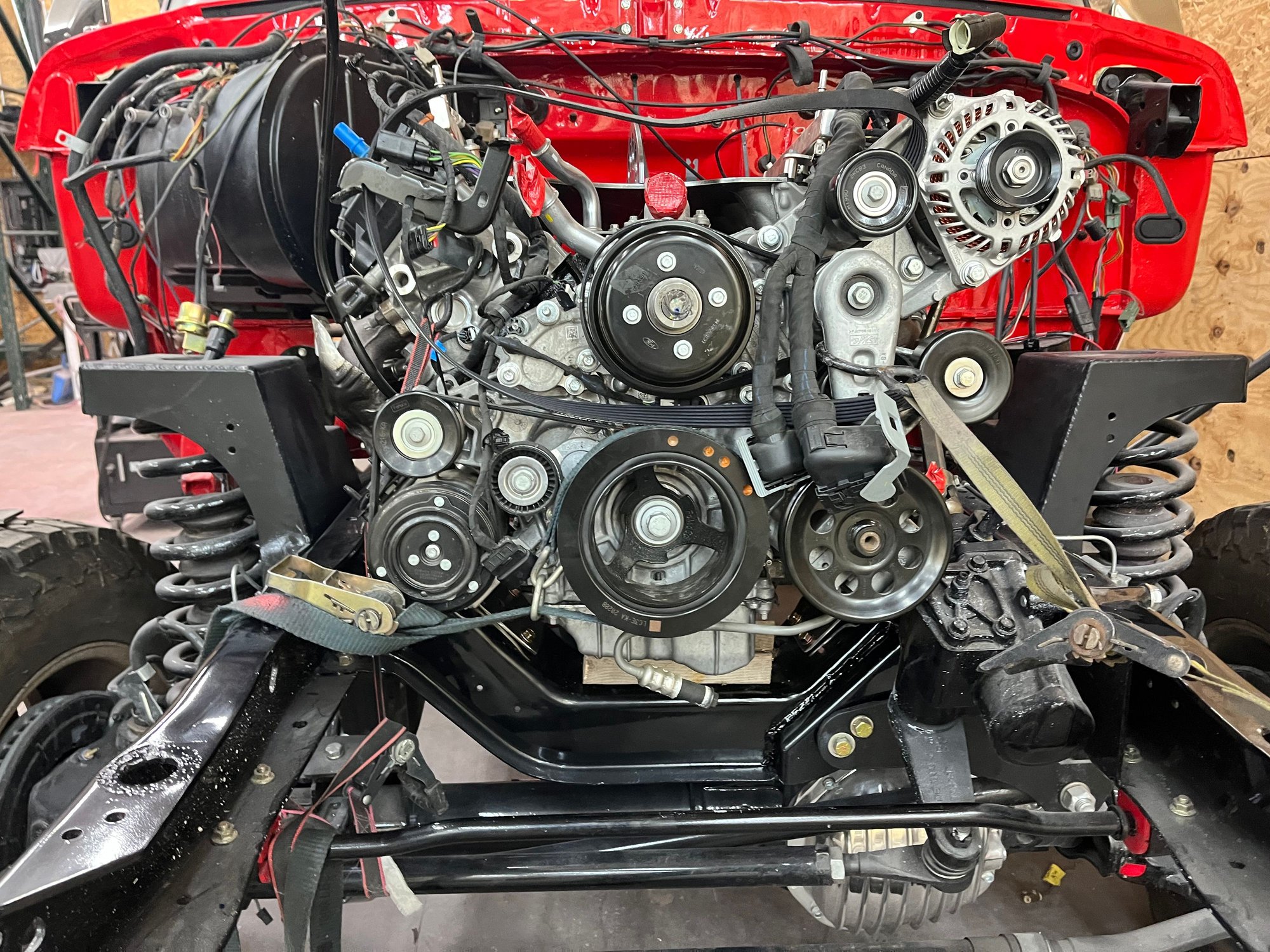

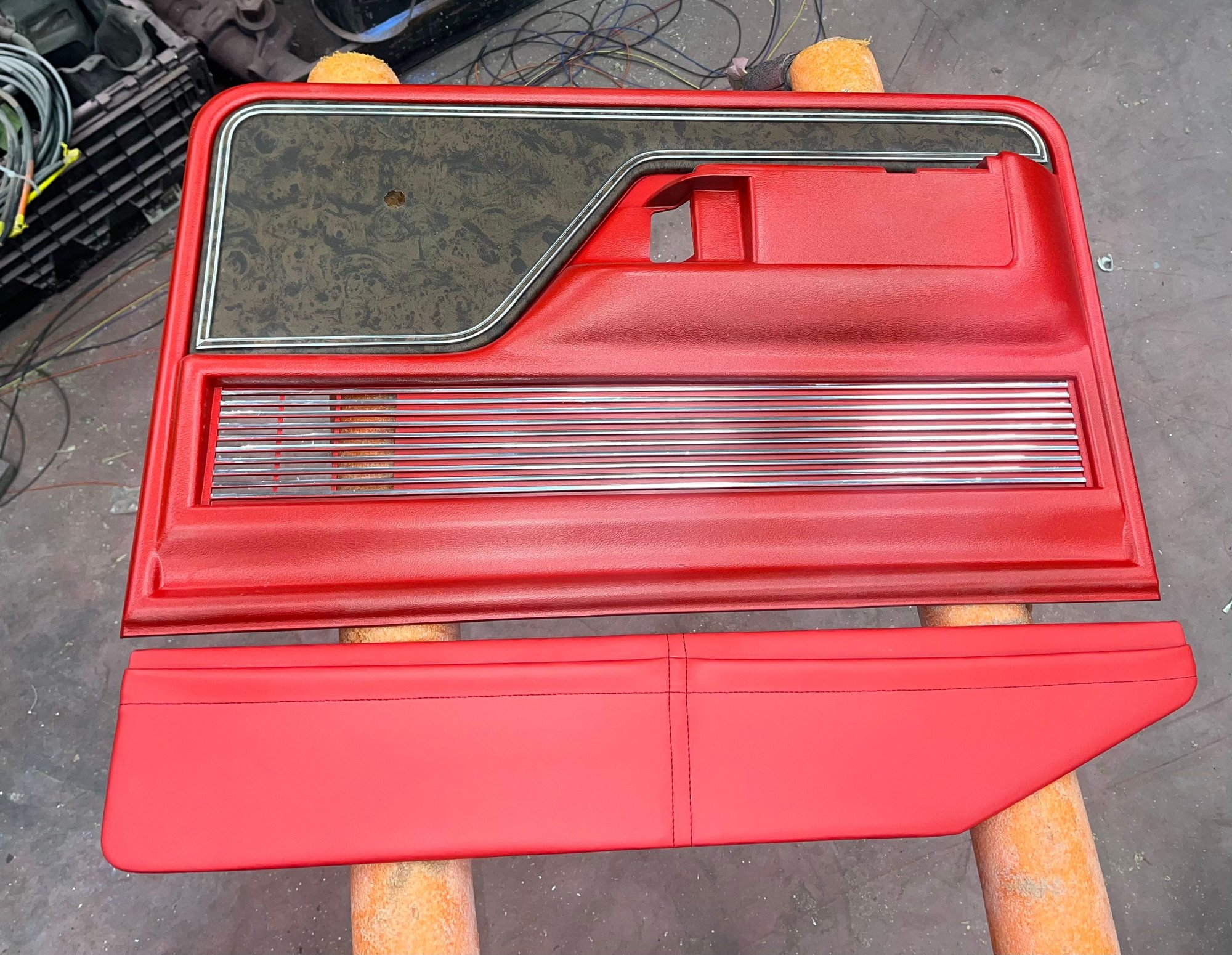

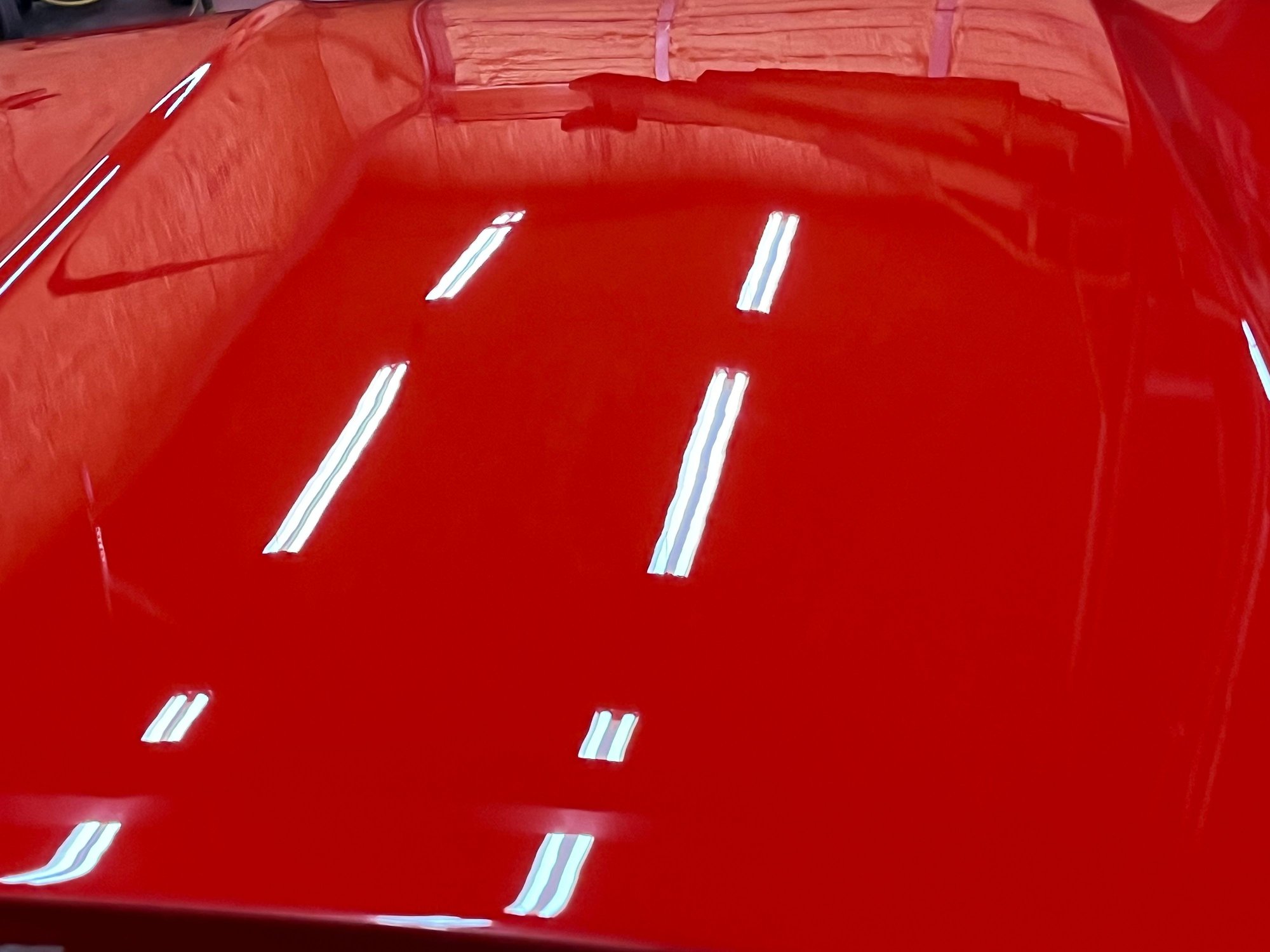

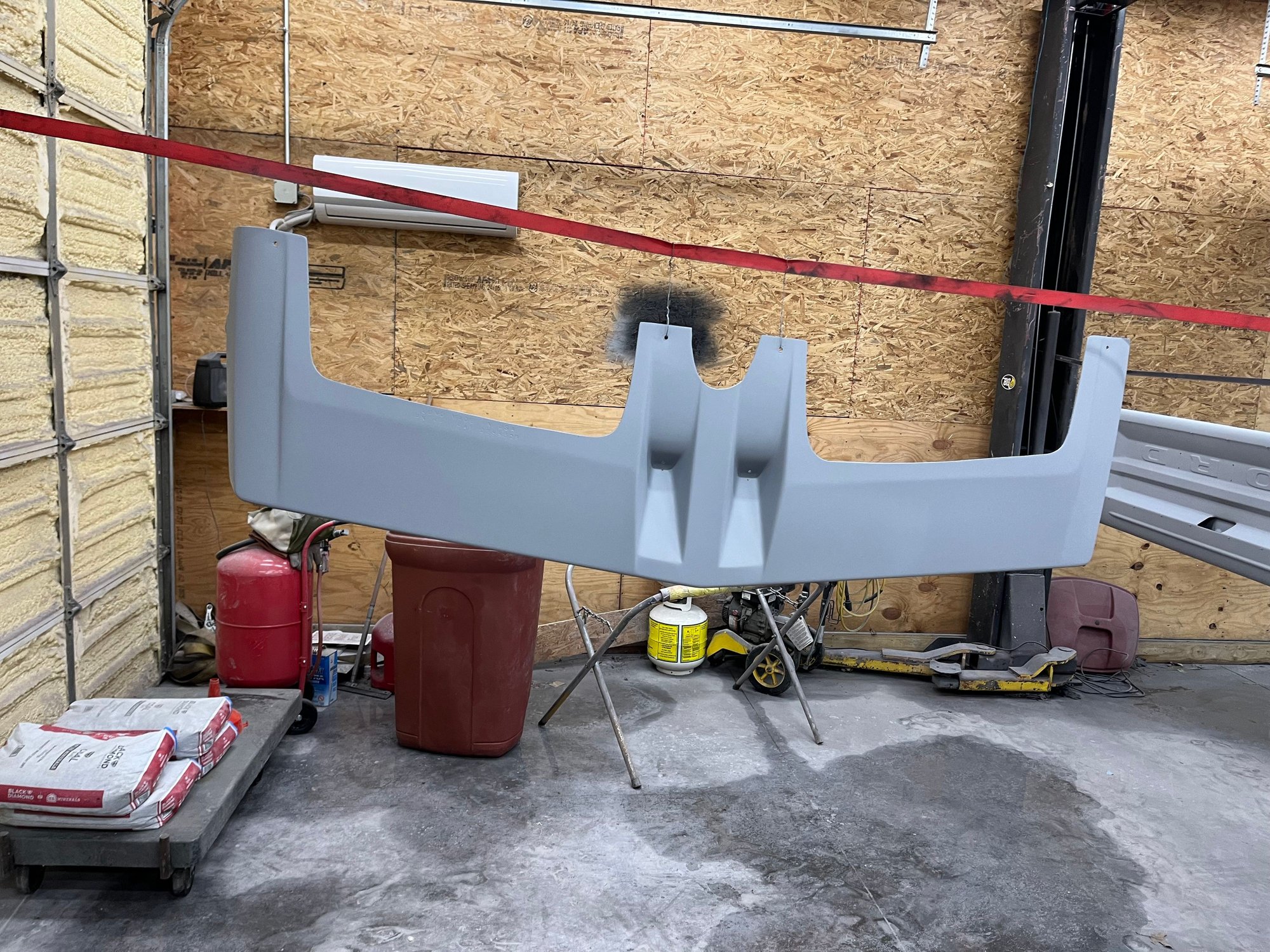

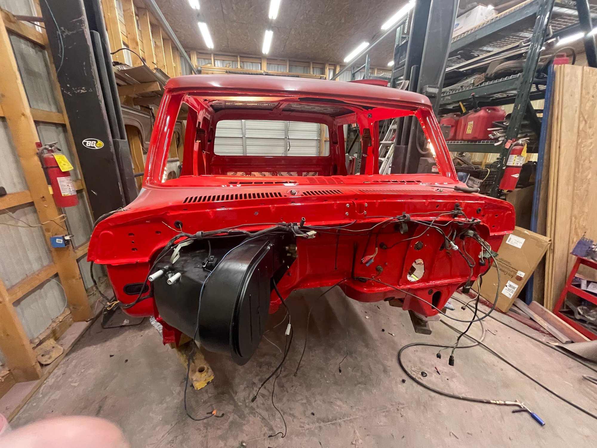

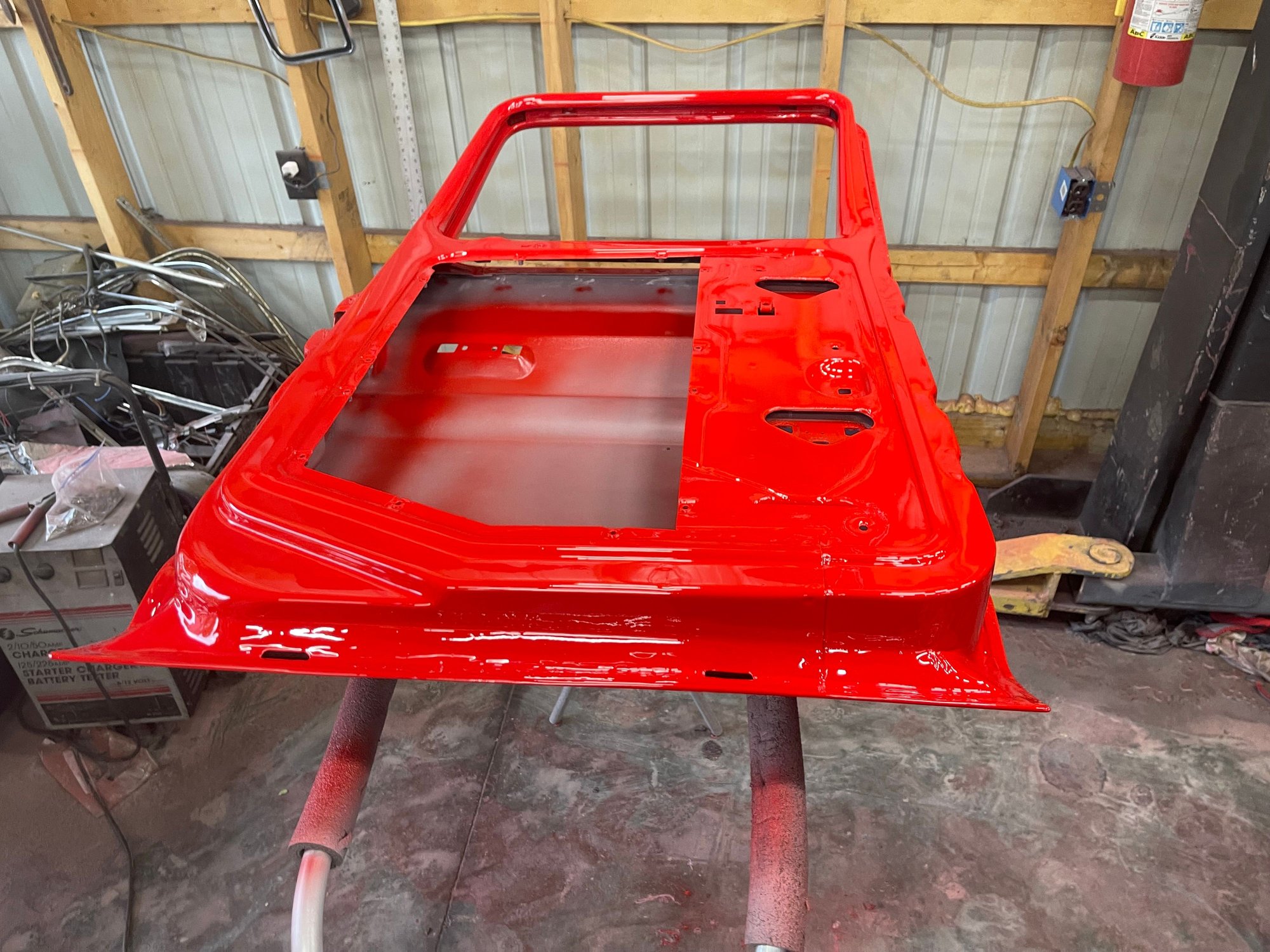

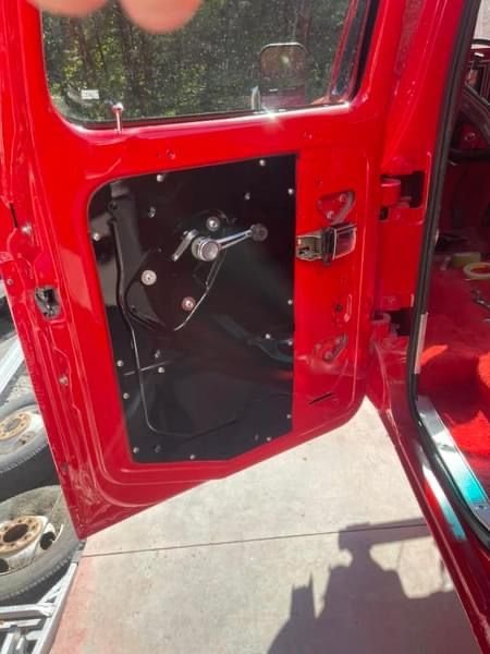

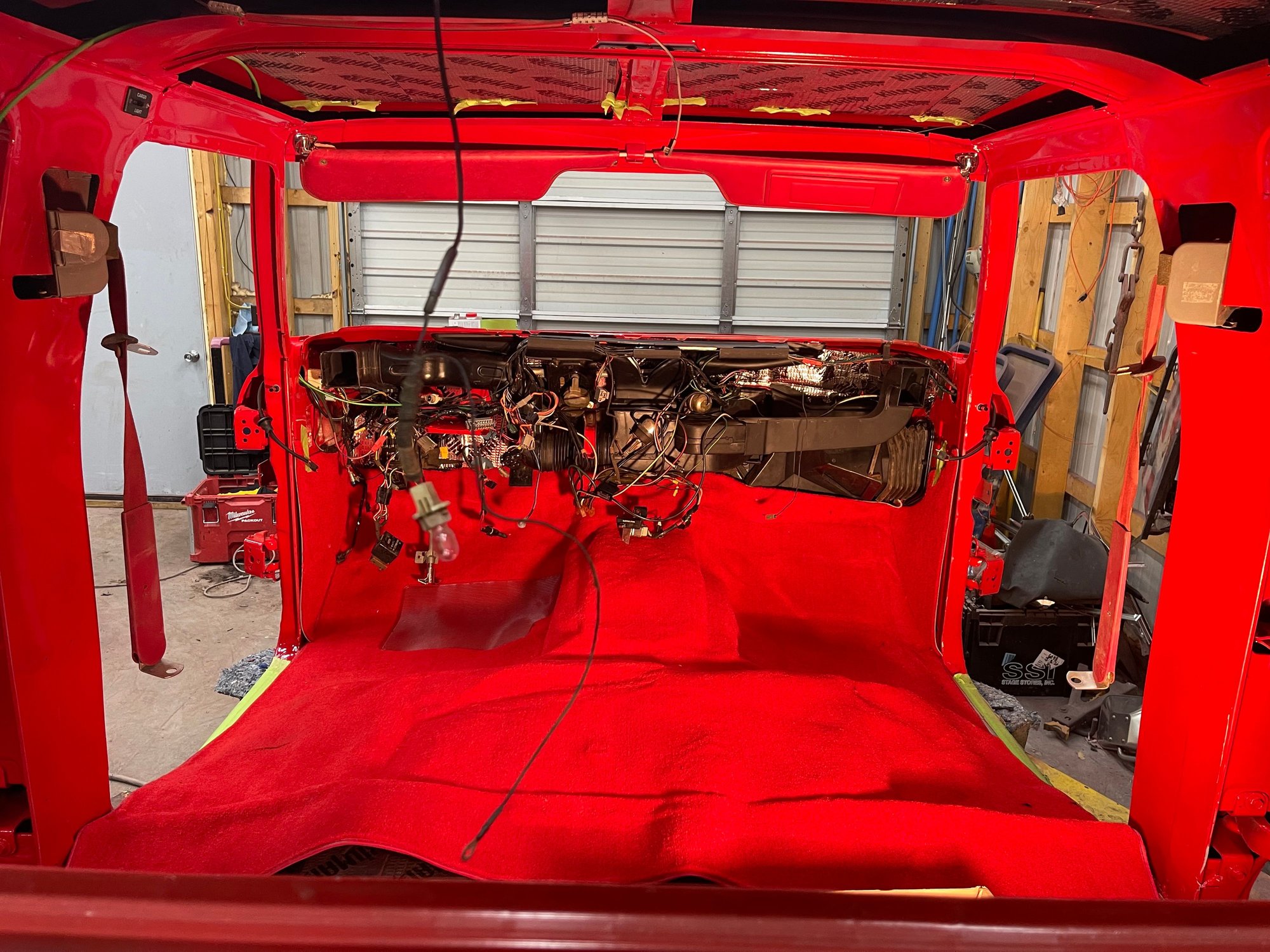

Hadn’t been on in awhile. Build is coming to a close hopefully by spring. Still looking for a few hard to find parts.
Figured I would post some of the progress I have made.
The rundown on the build.
2023 Ford 7.3 Godzilla with upgrades-6/R140. New takeout.
ECM PATS deleted and wiring pack from Mars.
New OEM manual shift transfer case for 2019 Superduty
BattleBorn front 4x4 conversion and rear long spring conversion.
Late model F350 axles/steering/suspension
88 F350 cab and chassis rear plastic fuel tank/crossmembers. New steel 1991 F350 front tank with modified supports.
Custom driveshafts

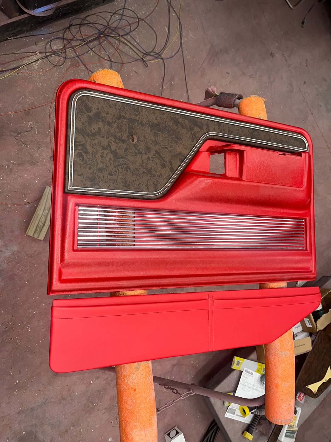

Tilt/Cruise/ security group/ lighting group/ Factory 1978 CB radio,Factory AM/FM stereo, factory rear window defrost. Lariat converted door panels and headliner.
Dakota Dash
2023 Supeduty new take off power deployed running board.
Power windows/power locks
2020 super duty brake booster/master
Working on keyless entry/remote start and communication for running boards.

what engine mount kit did you use with your 7.3?
