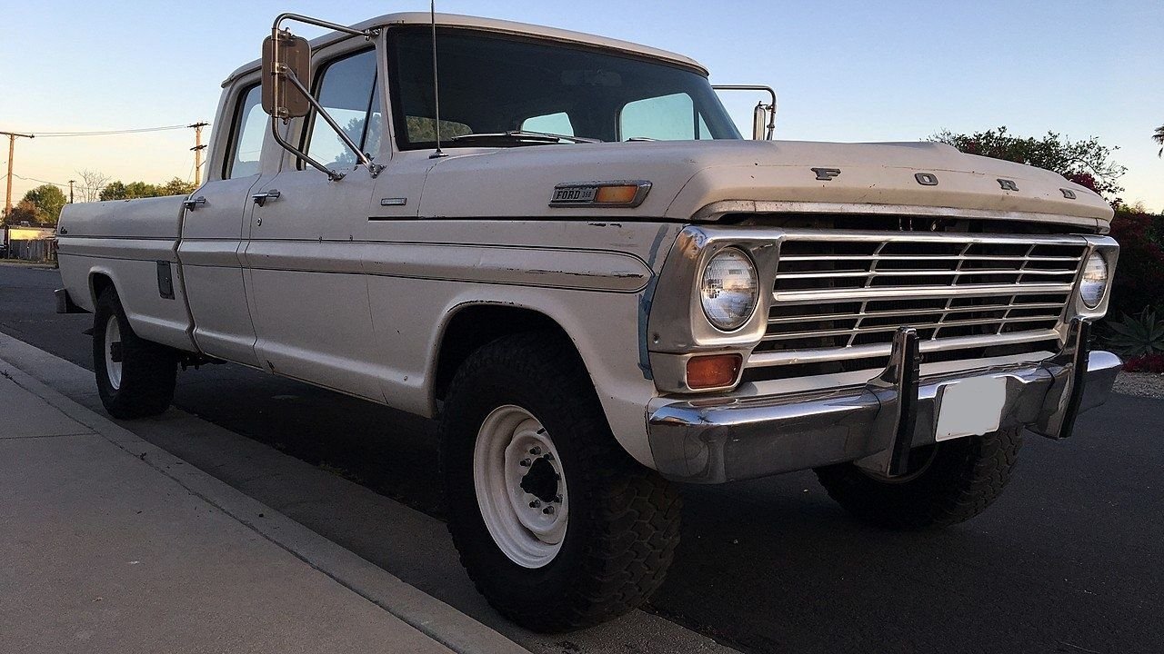

I've been looking for a SuperCab or Crew and just saw a 1970 Crew 2WD that appears to be in excellent survivor/original condition. I am not up to speed on this year as much as I am on '78-'79 non-crew so can't really judge value very well or know what to look for specifically. Is $15K crazy? I am thrown-off by these values out there.
Any help/opinions to share? Pics attached.

1970 is a good year, don't see many. My 78 crew 4x4 short bed cost $5,000. It's at the complete opposite spectrum as yours, that 70 might be a one owner truck and mine has been owned by too many to count. It seemed to me that the prices are $5,000 for a good project or $15,000 for a nice restored runner or one owner original like that 70. If you don't buy that some one will due to how original it is, most have been converted to 4x4.
Thanks Myrtlehead. I can probably buy it for $12K-$13K. So tough to know since this is the first one I've seen. I've had one guy on the forum have a strong take that even $12K is too much...but in the end, it's worth what someone will pay.
I think I'll go look at it next week...

Just looking at the number, yes it seems high. But go try to find a few 70 crew cabs that nice to compare it to. That could take years.
