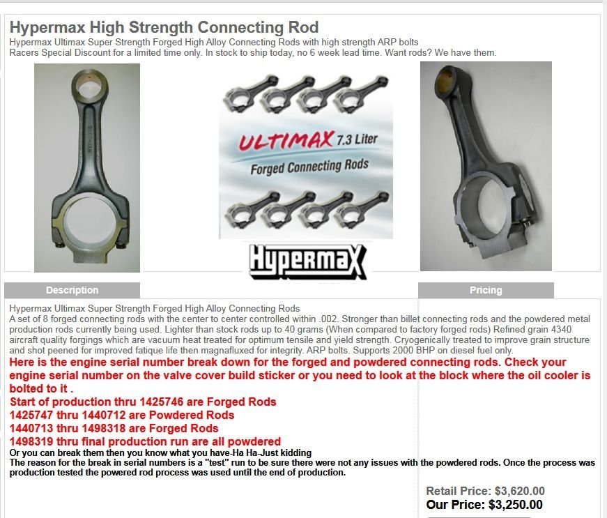

Some "info"

Originally Posted by FinnishStroker
Some "info"
Reading this made me dig up this graph from @Peixinho I've saved away
The green line is pretty similar in many respects to this build in terms of injector size and turbo. Peak torque exceeds 1000ft-lb and does so at ~2060 RPM. I think billet rods are probably a cheap insurance given this high torque at low RPM situation, especially if I want this build to endure for like 5-10 years. Anyone have input on this?

There is nothing cheap about billet rods.
Nor are they easy to get ahold of right now.
They would be WAY overkill for your build. Unless you plan to always tow heavy in an all out tune like that that graph shows.
