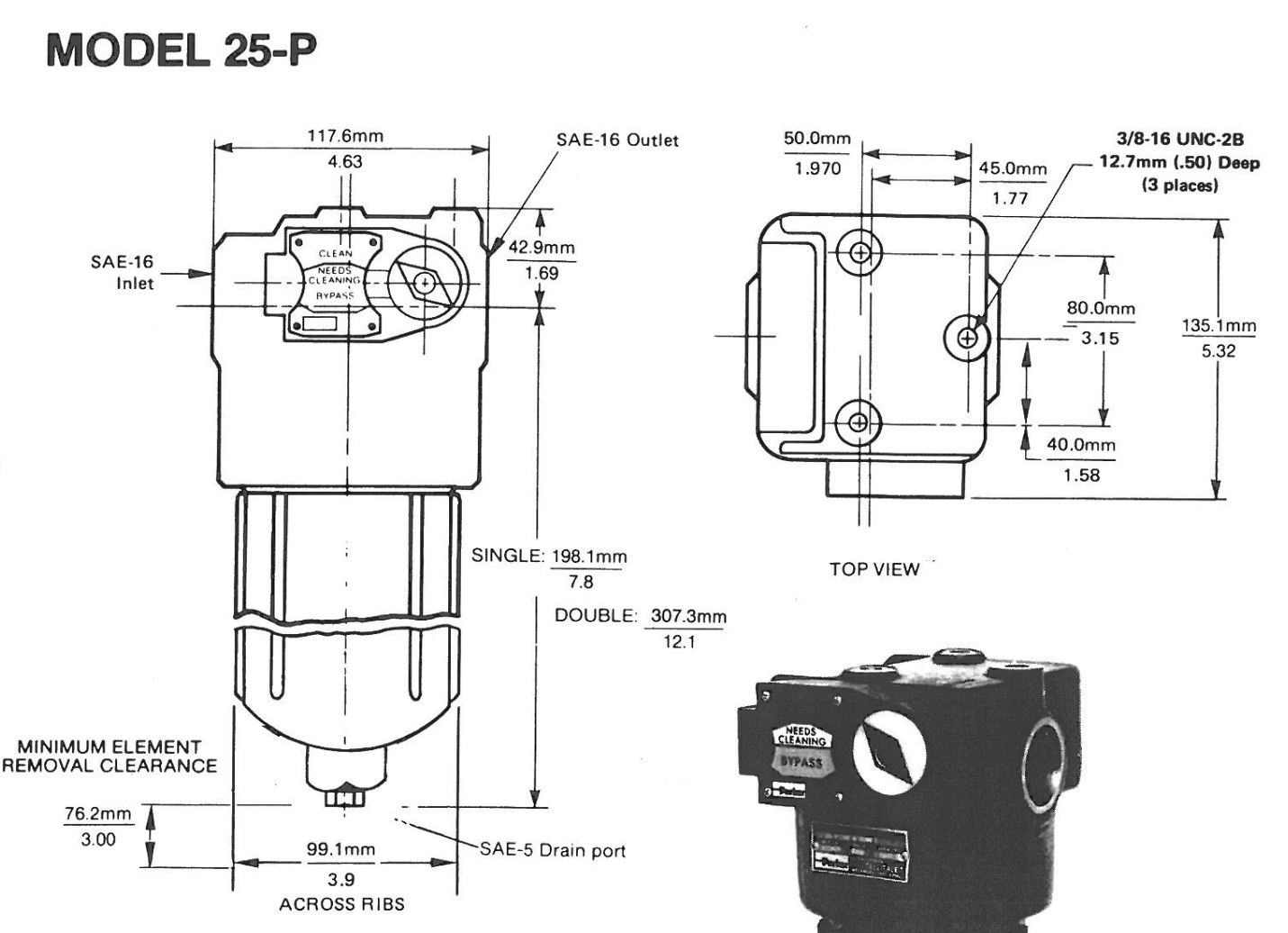

After doing a bunch of reading on the CAT engines, and how it's typical to install a post-HPOP filter to protect injectors, I think I'll go the same route. Dove through the Parker catalog and found a solution that fits the flow and pressure needs (and is affordable on the secondary market). The filter is 2 micron so will help keep larger soot clusters away from the injectors as well.

Not entirely sure. It's about 4in diameter by 7in so not very big, so I'm sure I can find the space. It would be between the HPOP and oil rails.

This is the one I went with:

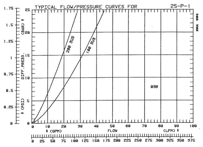

If I'm reading the pressure delta chart correctly, should be a negligible drop as our pumps flow, at max rpm and rounded up, ~20 LPM. Also has an electronic bypass switch which I'll eventually hook up to a cab light.

How many ports does it have? Only saw 3 in the picture, maybe I'm missing one. Does it require a splitter for one of the oil lines coming from the hpop or to the injectors?It's laughable but sounds like your building a 6.7. Pump parts with questionable quality that may or may not randomly grenade. Reminds me of the Disaster Prevention Kit for the 6.7, except on the oil side. I wonder if it vibrates or pulses when it's running. The DPK for the 6.7 pulsates quite a bit and has to be isolated. Cool concept but adds too many high pressure lines for my liking.

I was looking at it wrong, I now see the ports are on either side of the housing, not on the top. Going to run a T-fitting on each side with two hoses going to/from each? Suppose there are a few ways to do it.
