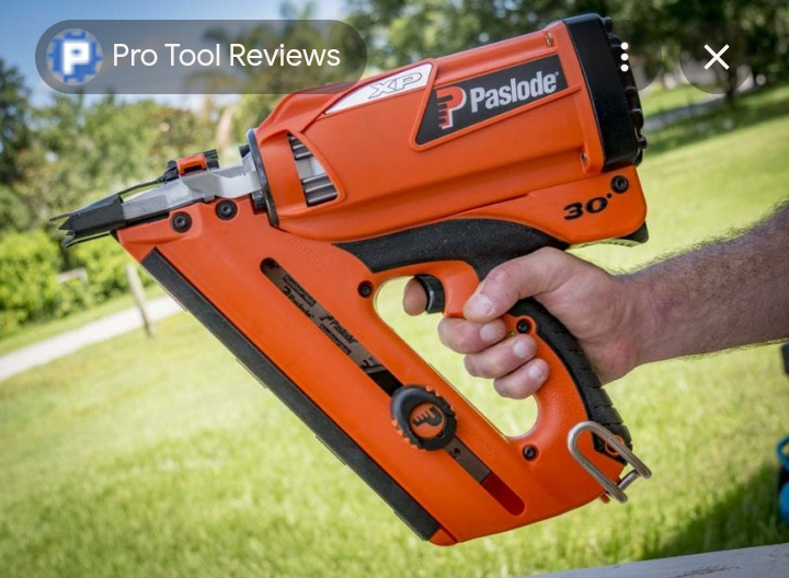

Got tired of dragging hose around construction site so, I got this bad boy in the arsenal
