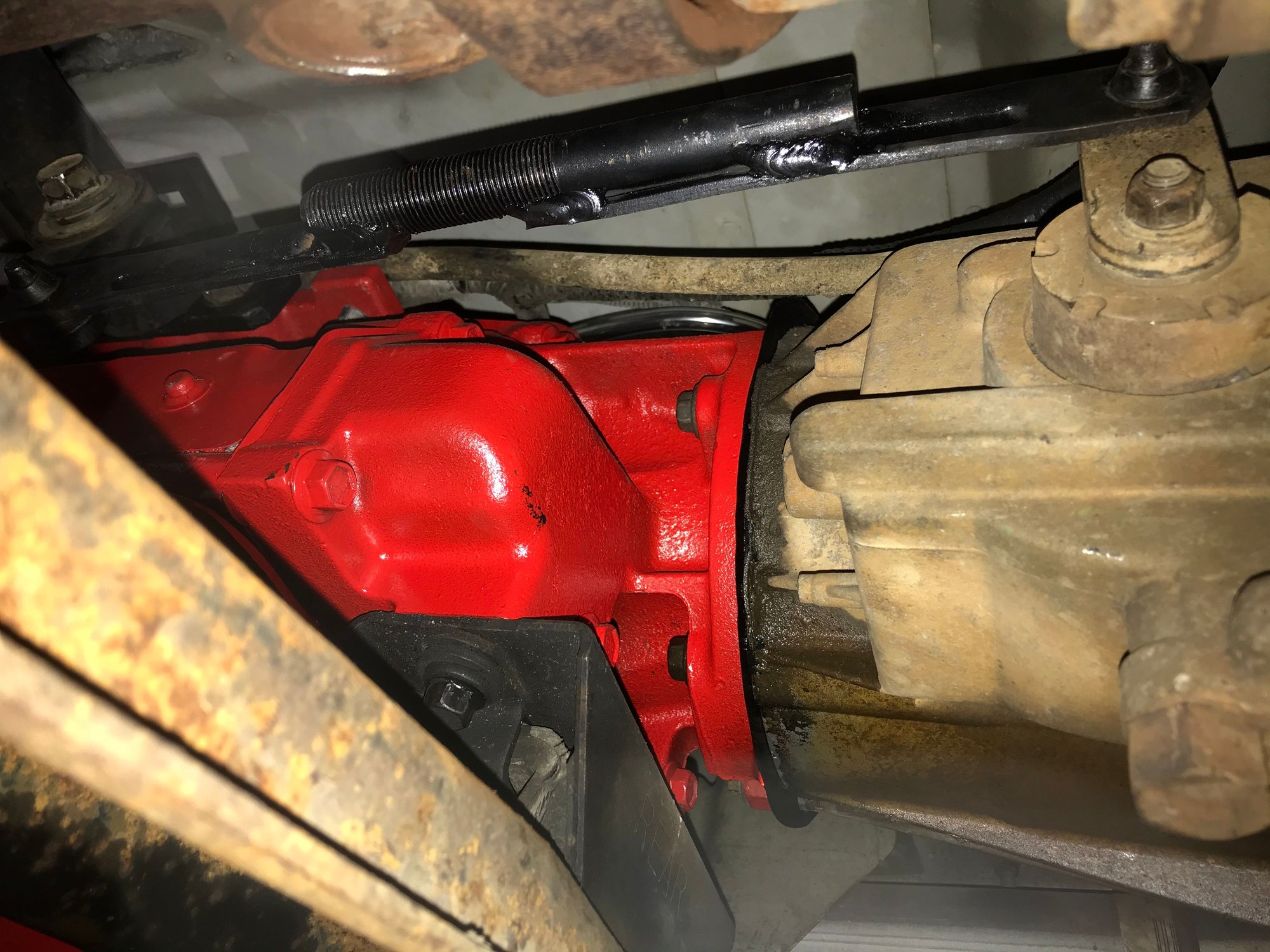

Ok, my driveshaft guy finally got to my project this week - so I banged out the last few details on this 4wd conversion.
I used a gas engine (5.4) truck for many of the parts for this swap. One of the differences between this and a 7.3 truck is the bracket/linkage for the manual transfer case shifter. The gasser bracket only has (2) holes and the linkage is shorter.
I added a piece of material to the bracket and made the linkage longer using pieces of steel from the scrap bin.
