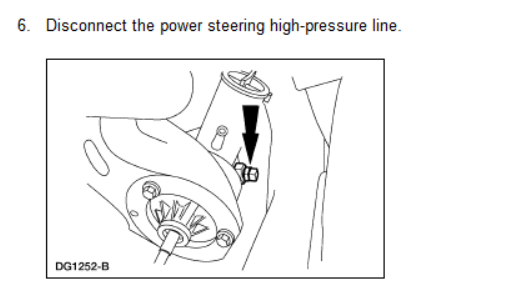

Referring back to section 211-02 I see the details in the wording about the teflon ring may not be referring to the high pressure hose to pump fitting, but it might. The only time the high pressure line is mentioned is in step 6 as noted below.
Although, I was/am pretty sure there is a teflon ring at that fitting. I recalled a thread by AKCooper9 a while back where he was looking for a definitive answer. Here is his thread: https://www.ford-trucks.com/forums/1...-or-oring.html
There is in fact a teflon ring there at the pump to hose fitting based on what I see in the FSM and in AKCooper9's thread.

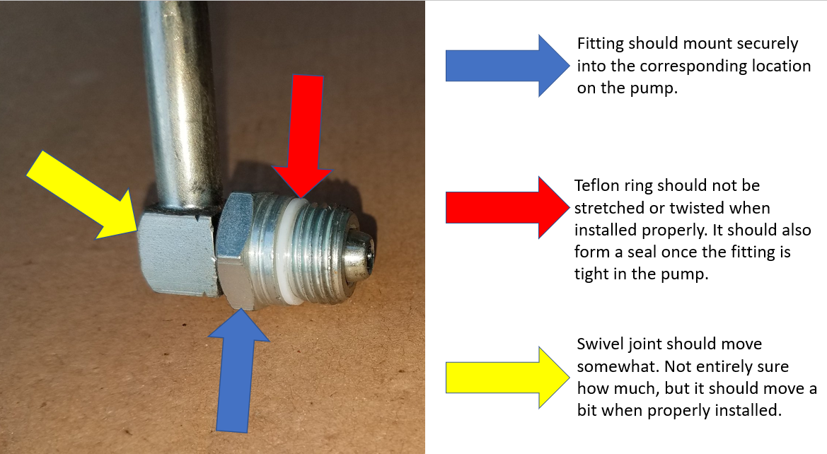

I may be wrong but I thought that fitting would swivel even after tightening.
Isn’t that one sort of like a banjo bolt with internal sealing orings (I assume) to allow it to swivel? I can’t remember how it sealed to the pump.
Maybe so. All of the ones that are sold at the auto stores have a Teflon sealing ring on the threads as stated by Sous. Even if it is supposed to swivel, it feels way too loose. It almost feels like it's not even screwed in. The swivel joint that is. It is free moving quite literally. Here's a picture of a fitting I found on Google. Not sure what the right fitting is for but you get the gist. I don't know to be honest. I figured it would tighten up and not swivel anymore. Maybe someone else can clear it up for us!🤣

Tristan, when you remove the fitting/hose next time, take a look into the pump threads and make sure there is no debris, teflon ring or anything that would obstruct a clean and sealed fitting. The rubber o-rings on the gear side of the hoses are notorious for this. Think of it like an oil filter that leaves the o-ring on the sealing surface of the engine. Once you install the new oil filter with the new o-ring attached, that seal point/location is no longer a seal.
Worst case scenario is you remove the pump and put the hose on the pump outside of the truck where you can see what is going on easily. I don't think it will come to that, but that is a possibility.

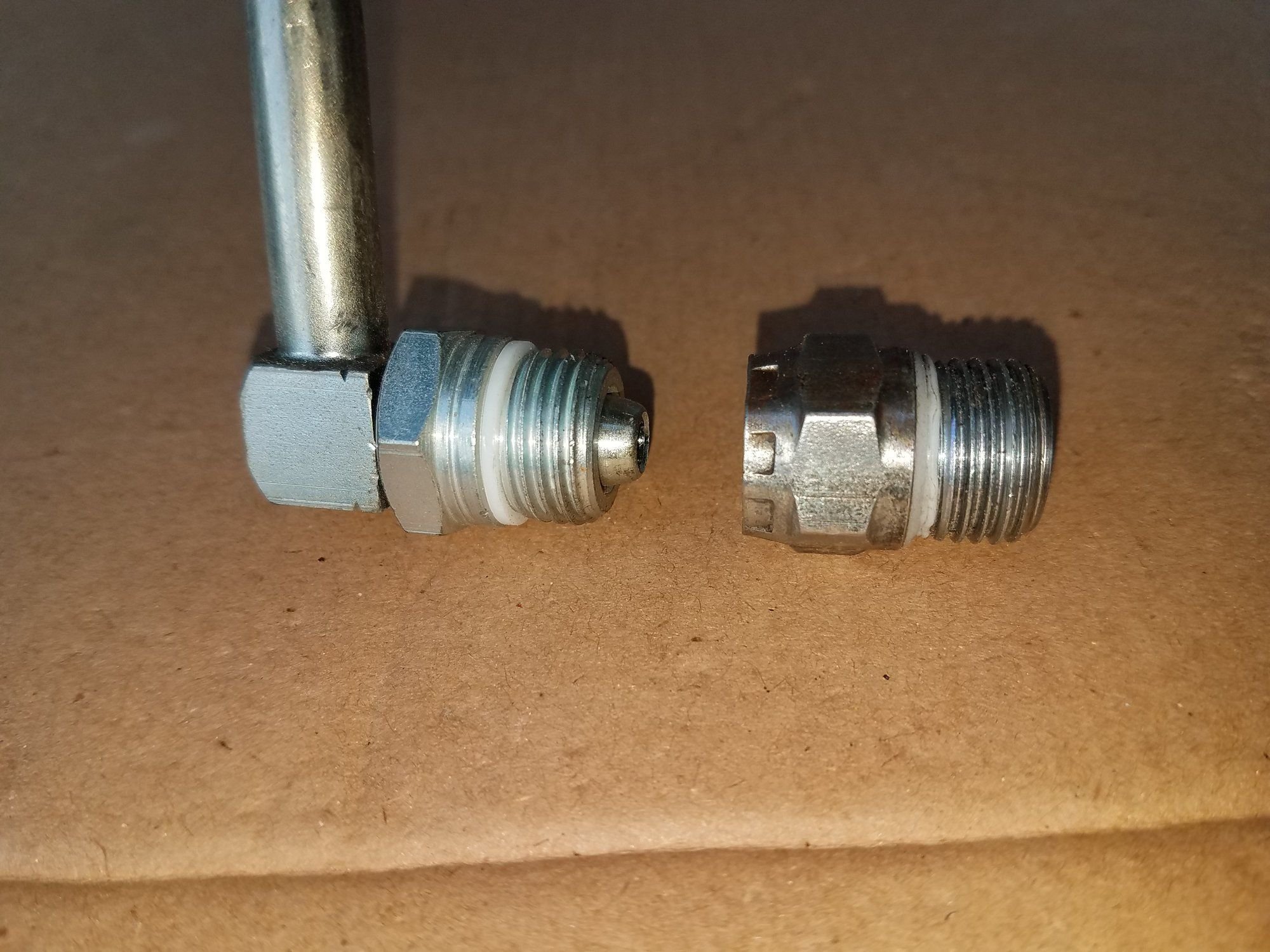

Here's what I found. The o ring that was on there was completely screwed up. Definitely leaking from right there. I got the Teflon ring kit from doorman that you recommended but, I am having a time trying to get it to fit over the fitting.
The bigger of the two, I cannot get to fit on the fitting for the life of me.

Put it in warm water for a minute then slip it on carefully

I got it on using my fingernails working it down slowly. I also took my passenger side boost tube off while I was in here and fixed the bend that I put in it by installing the clamp wrong a while back.

I used a plastic 90° pick, like a dental pick after the teflon ring had been warmed up for a bit. Something like a toothpick might be helpful to you. Just be sure the material of whatever tool you use is softer than the metal threads.

I got er done and put back together. Bled the system for a bit. Going for a ride to see if we hold fluid! I don't see anymore active leaking! Thanks for all the tips! I've never messed with Teflon rings before!
