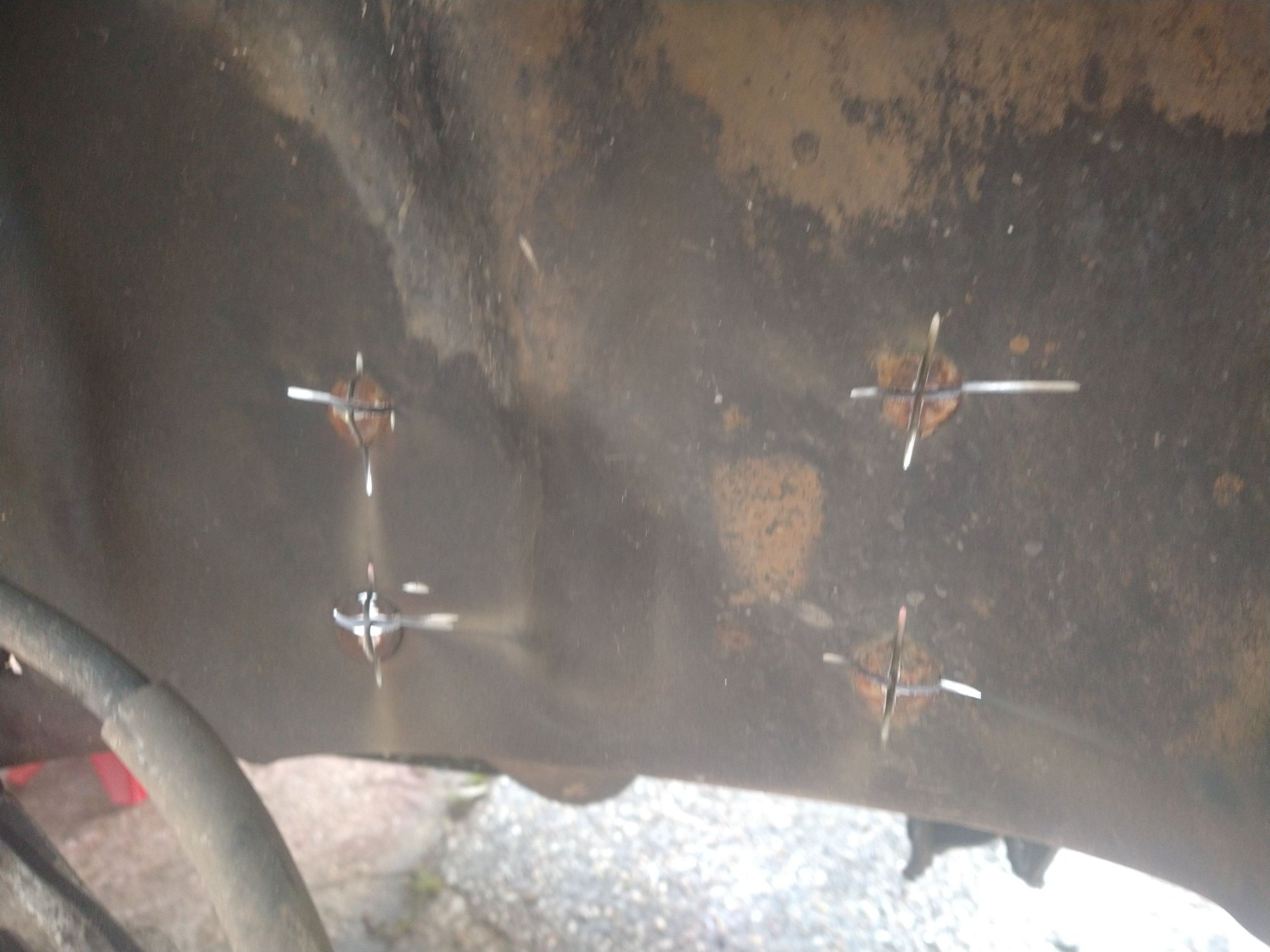

Front end is off! Getting ready to take off the coil buckets! It's taking me a little while because, it has been freezing rain and 20 to 30° all morning. I have been going in and out in and out of the rain doing what I can when I can. Couldn't really time it because of how much stop and go I was doing.

grinding A X In the rivets and knocking the heads off with the air chisel works really well. I just don't have a big enough air compressor to keep up with it so it's taking a minute.
I just about got the coil buckets off.

So unfortunately, my brother who came to hang out and help me do my swap if I needed it, ended up having his water pump bearings go out. On the way up here he said it sounded like there was a bucket of bolts rattling all over the place. So I helped him change the water pump out on his vehicle and it took up some time so I didn't get as much done today as I thought I would but, I'm still happy with what I got done.
Full progress: sway bar removed, pitman arm removed, steering gear resealed again, brake hoses changed out, brake hose mounting brackets installed, coil buckets removed, full front end removed and bumper removed. First thing tomorrow I am going to clean the frame where all of the two wheel drive stuff was, it is filthy as some of you may have seen in the pictures. Then, I'm going to start bolting leaf spring shackles and shock mounts to the truck.
