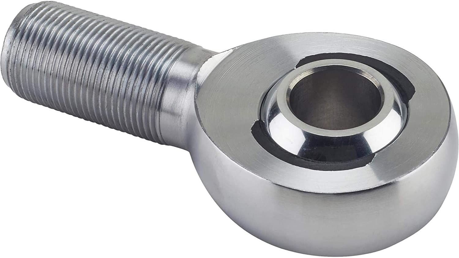

Forgive me for I am young but what is a heim joint?
And also how would I know exactly which one I need? Measure the diameter of my track bar eyelet hole?
This is a heim joint.
I was joking really. Heim joints do not muffle road noise from the suspension to the cab and the higher quality ones that provide reasonable longevity in a street vehicle are mucho dinero. They are typically used on vehicles where precision positioning of articulating components is valued over ride comfort i.e. race cars and airplanes.
Oh I know what that is! I just don't know it by that name! To me it's a spinny ball end with a hole!

If you really want to use heim joints, a 4-link conversion is a good reason to use them.
I was envisioning a seedy place where jack boot wearing blondes meet for a few half liters...
I know those as Spherical rod ends from my CNC equipment repair days.

I keed I keed. There are many names for them. Rose joint and rod end bearing being others.

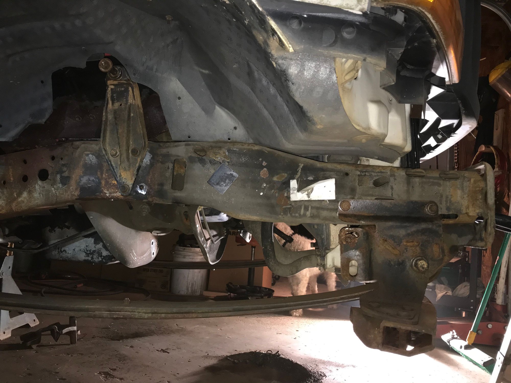

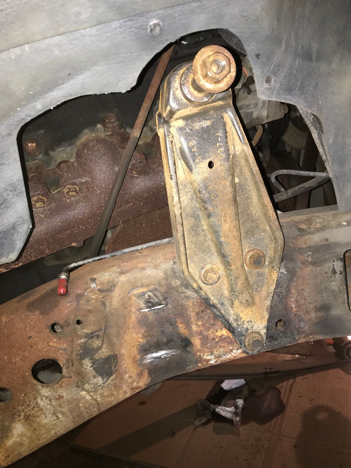

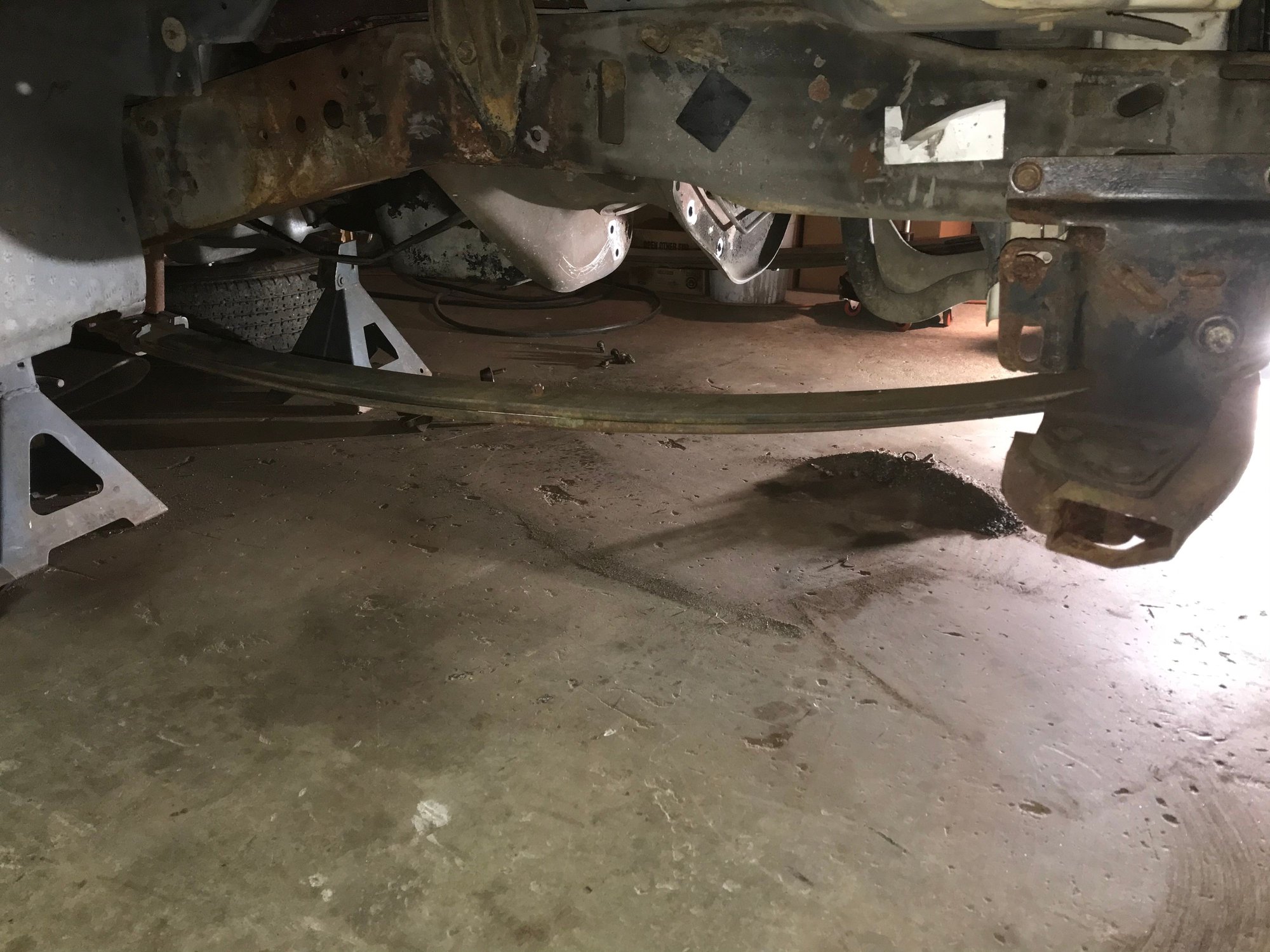

Only had a couple hours to work on this yesterday, but it’s ready to receive the front axle now.
Swapped steering gear, installed shackle and spring hangers, shock towers, frame bracket for track bar and leaf springs.
