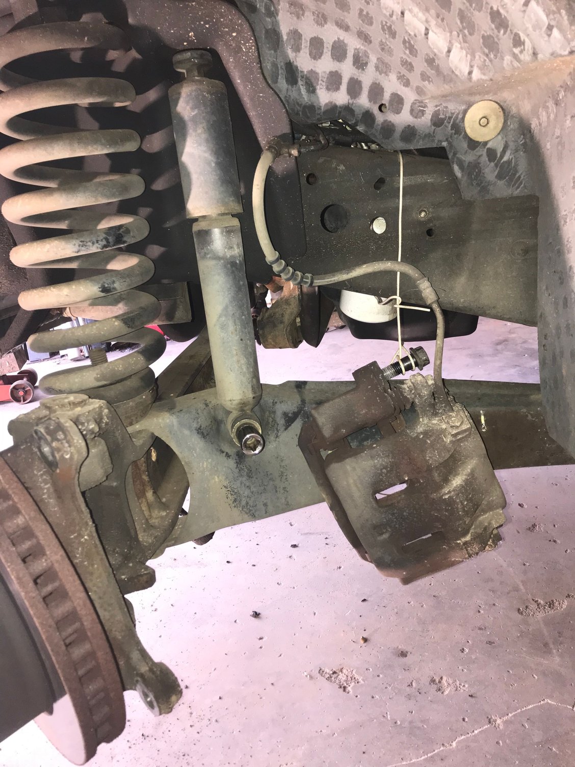

Took about 1.5hrs to remove all of the 2wd stuff. I’ve still got to remove coil buckets, but needed new brake hoses first. I forgot the 2wd hoses go through the coil buckets....
I didn't even think about the brake hoses going through the coil buckets. I got the brackets off of Joel's truck where they mounted to the frame instead of through the coil bucket. What exactly do you need to change / replace? The main brake hoses going down from the master cylinder? Or would having the bracket off of the 4x4 hoses work? I would think having these would fix the problem wouldn't it?

You are holding the 4wd brake hoses. That bracket attaches to the frame. The metal brake lines are the same on 2wd/4wd.
Ahhh okay. I was unsure what you were talking about when you said you need a new brake lines. I thought you already had the new soft lines. Just a misunderstanding!

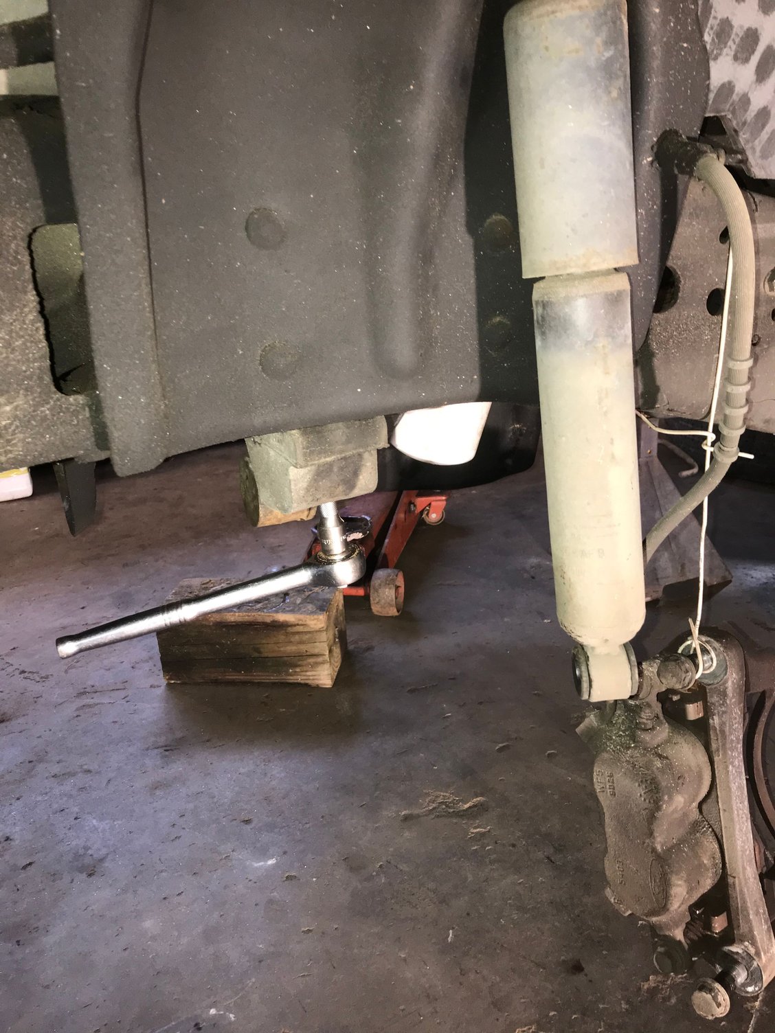

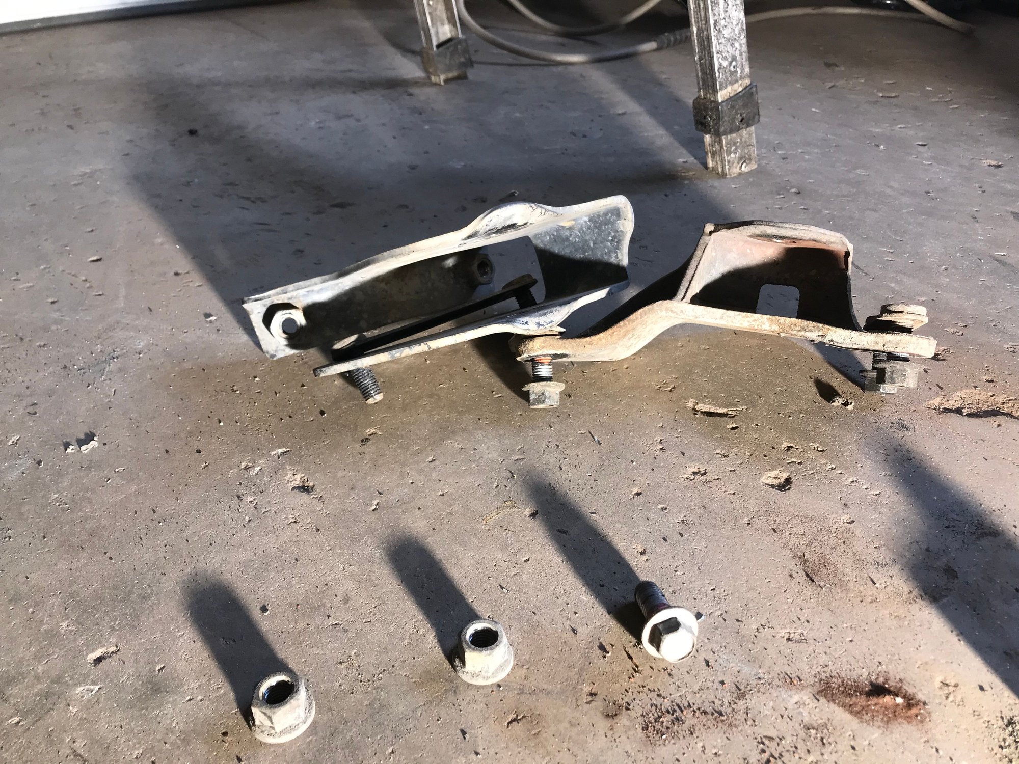

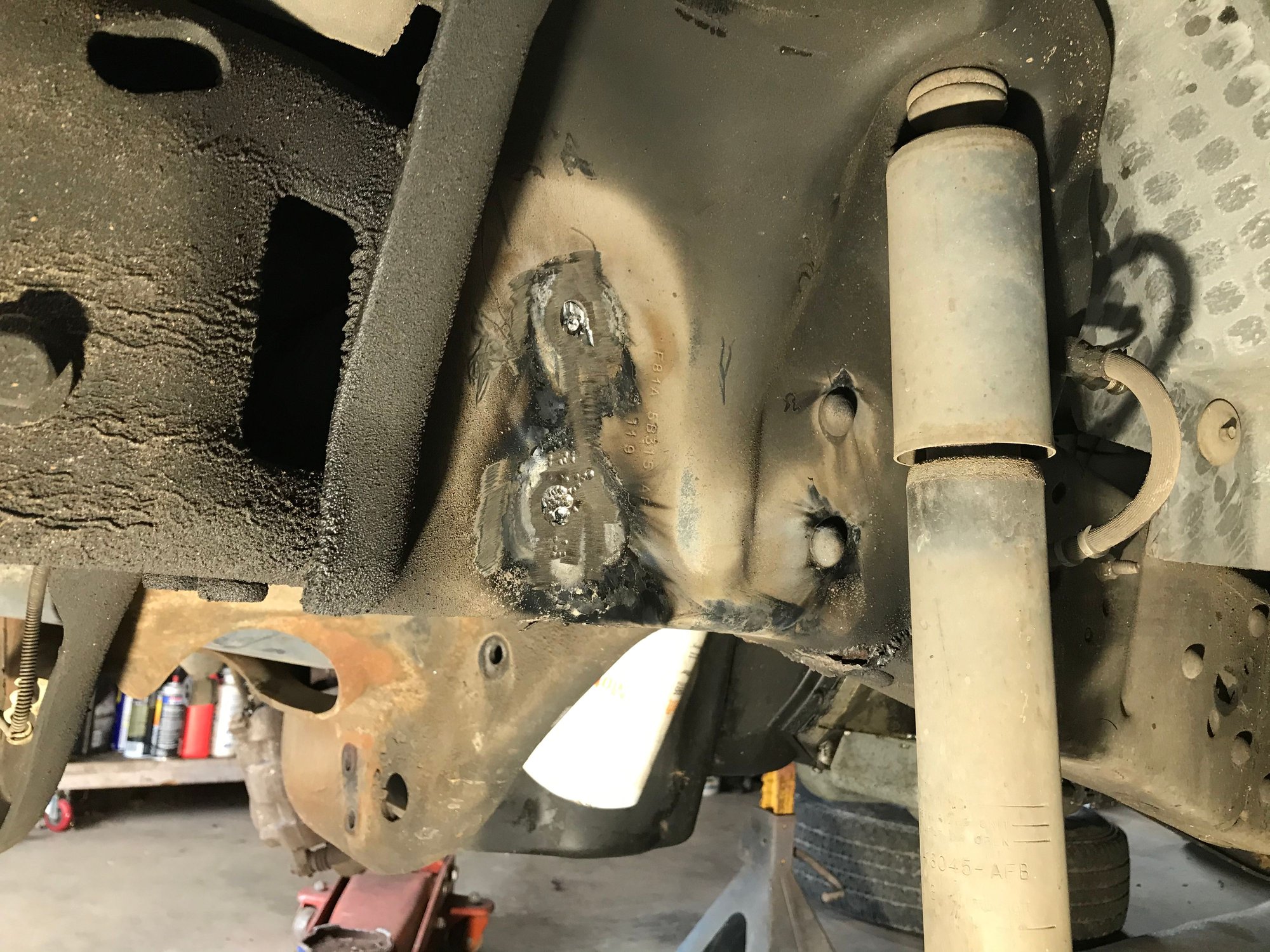

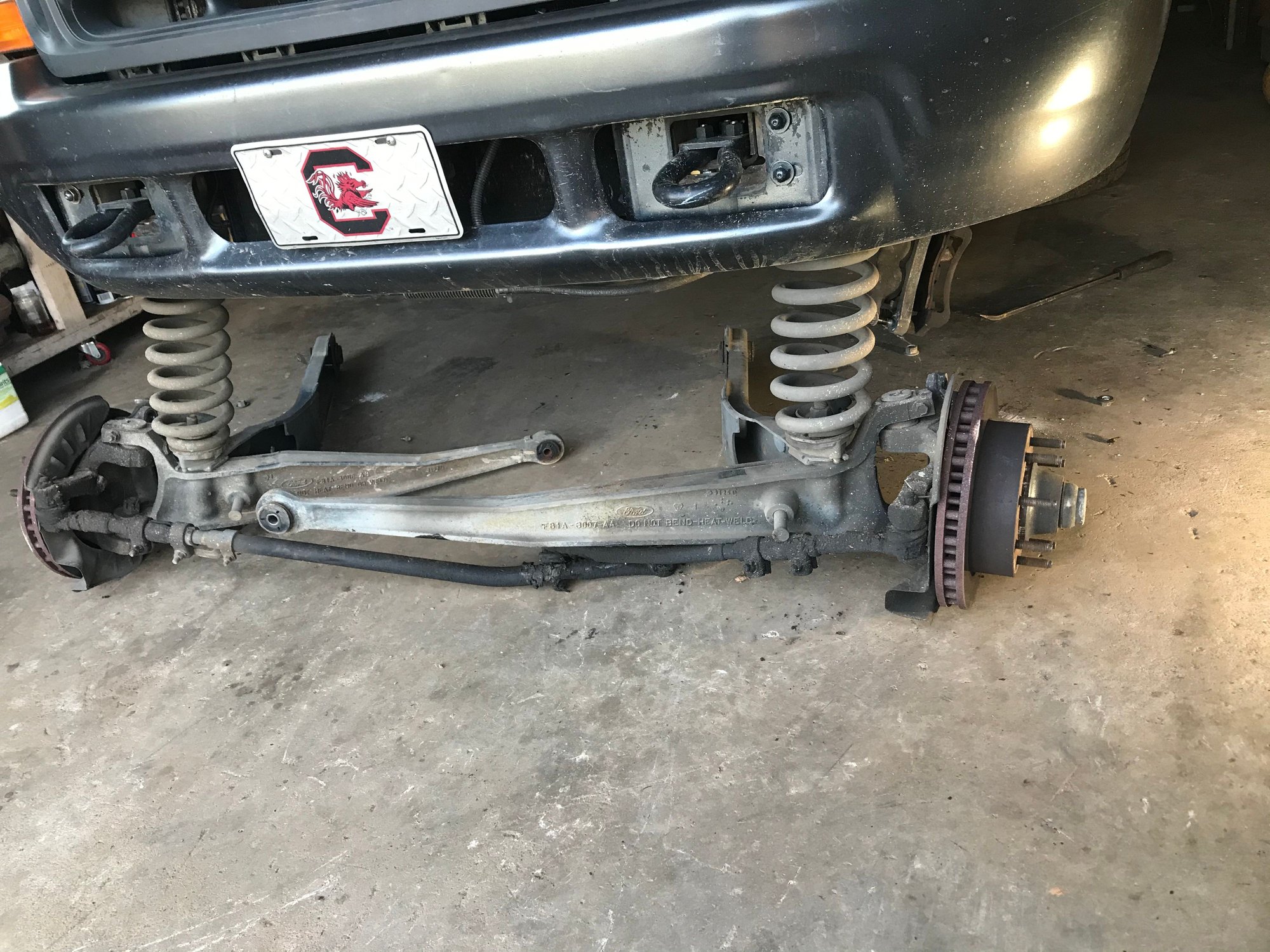

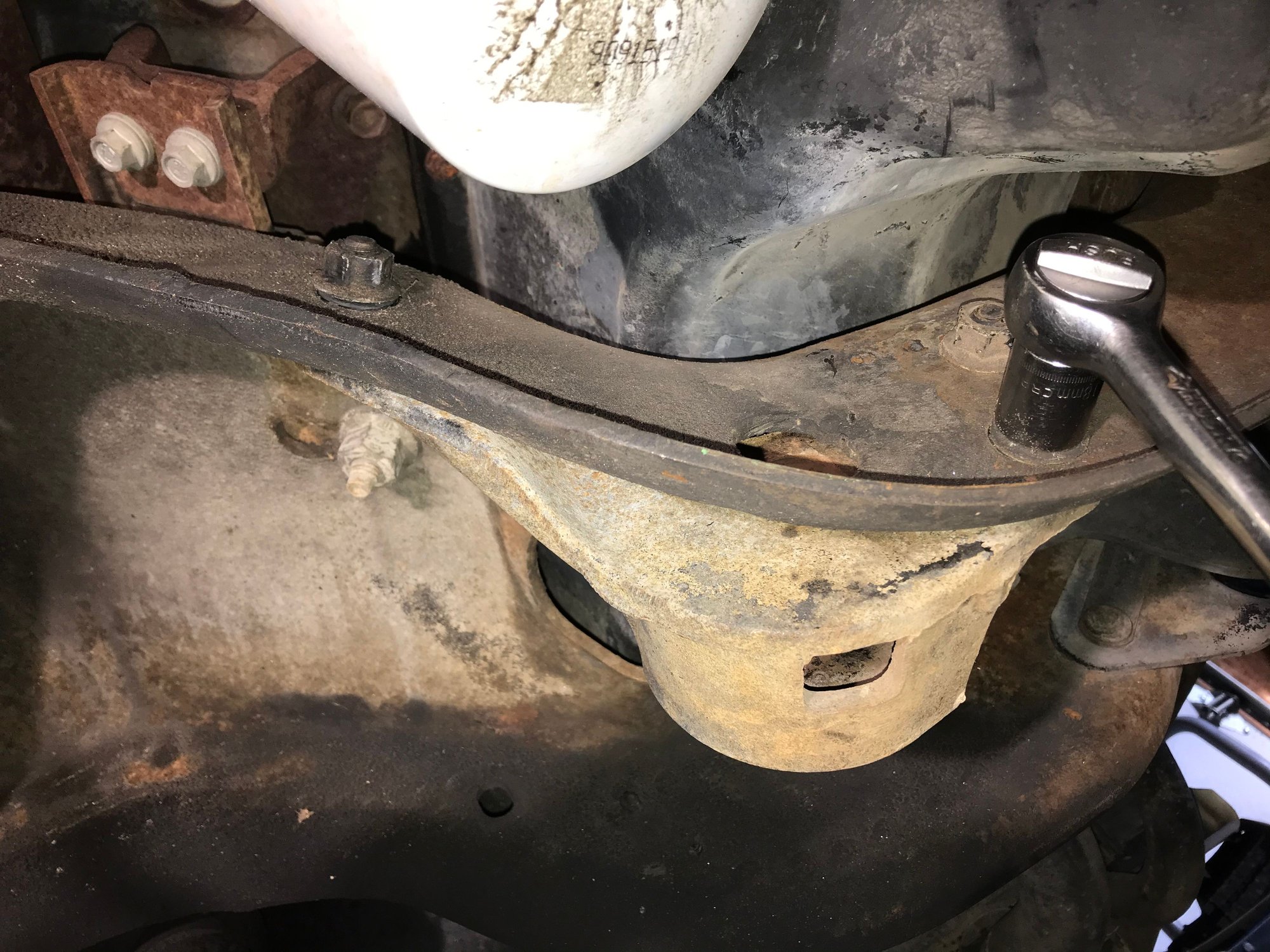

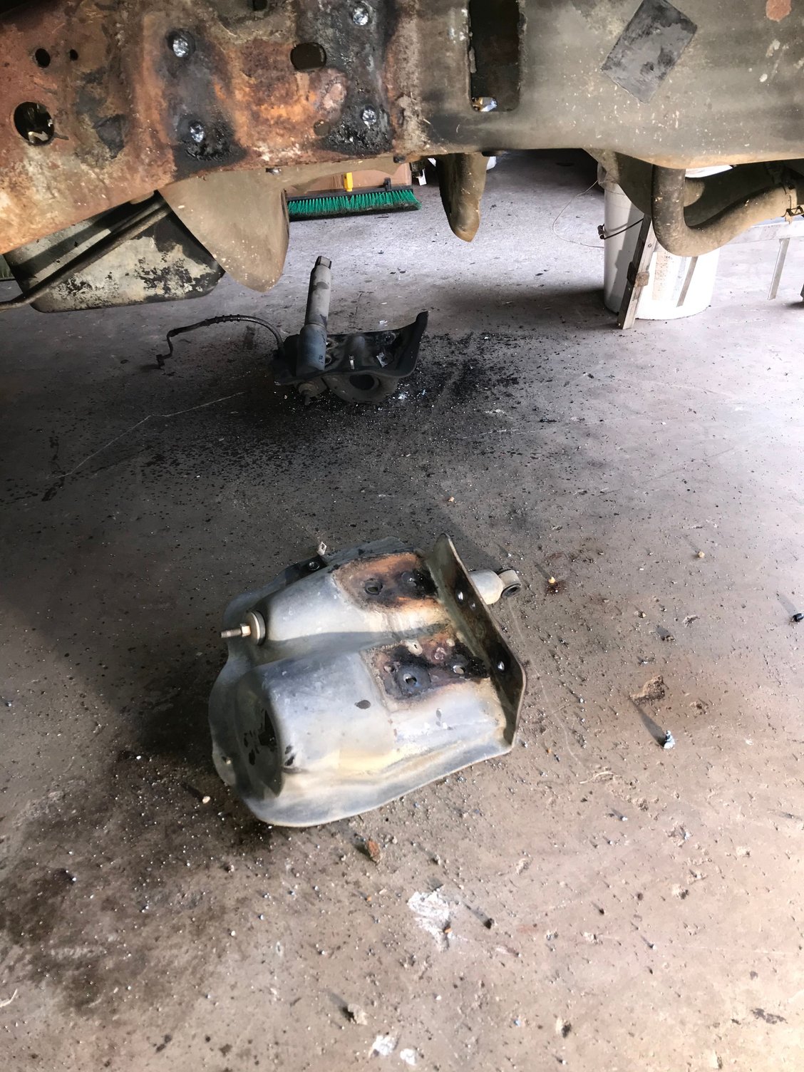

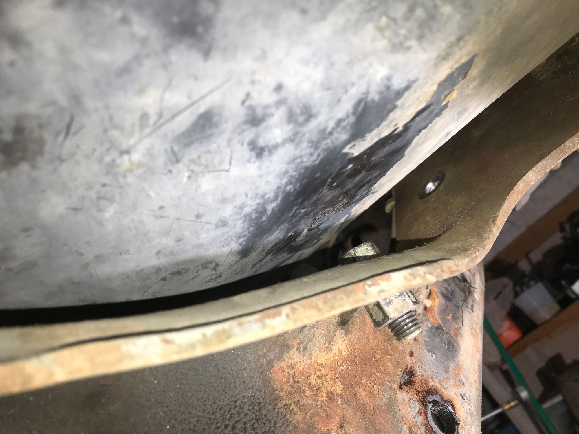

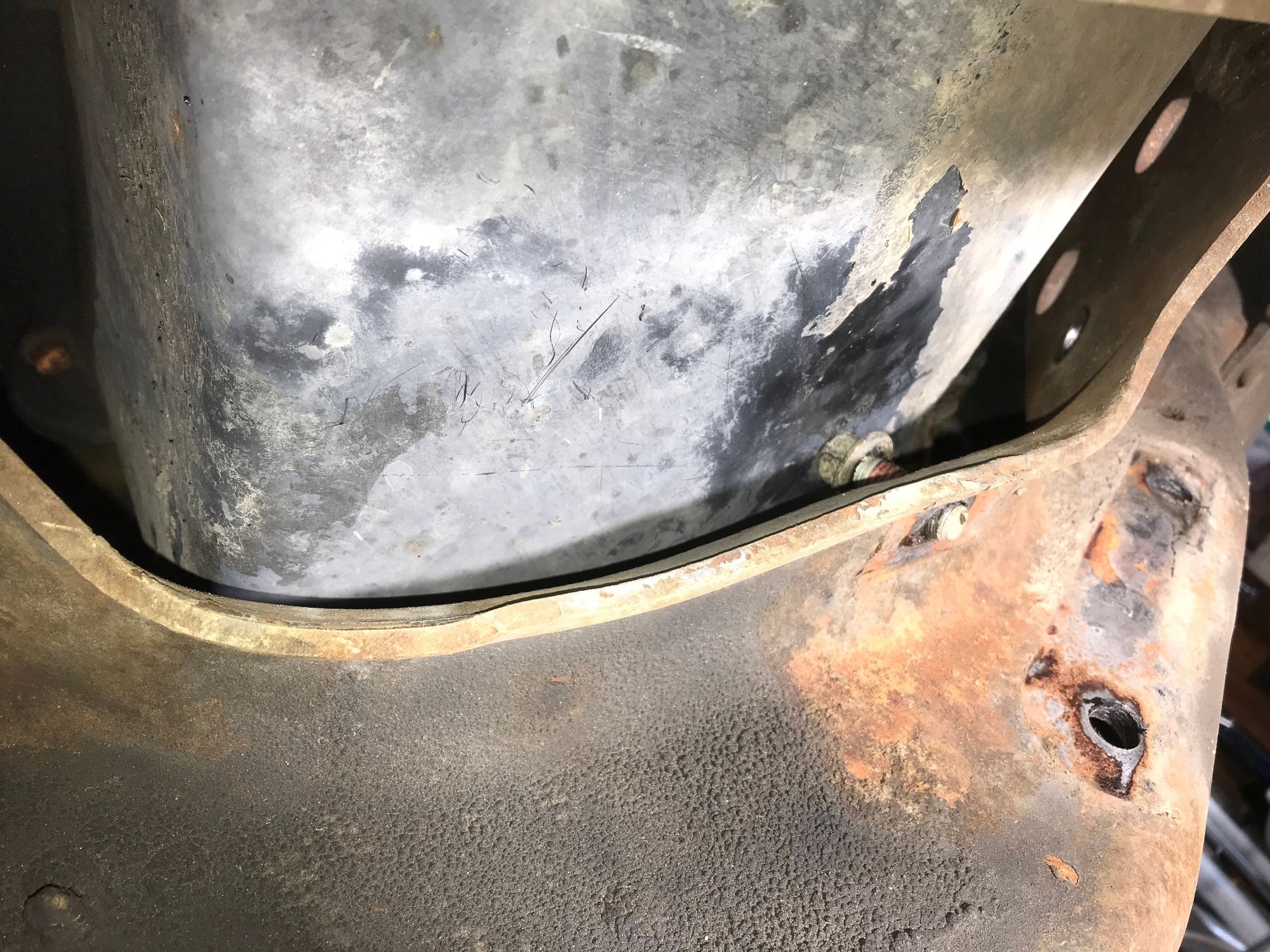

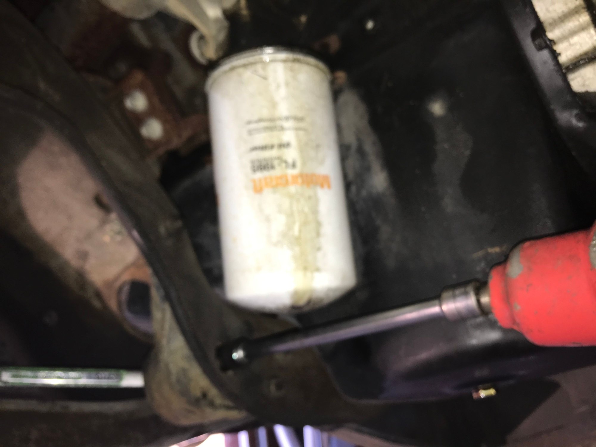

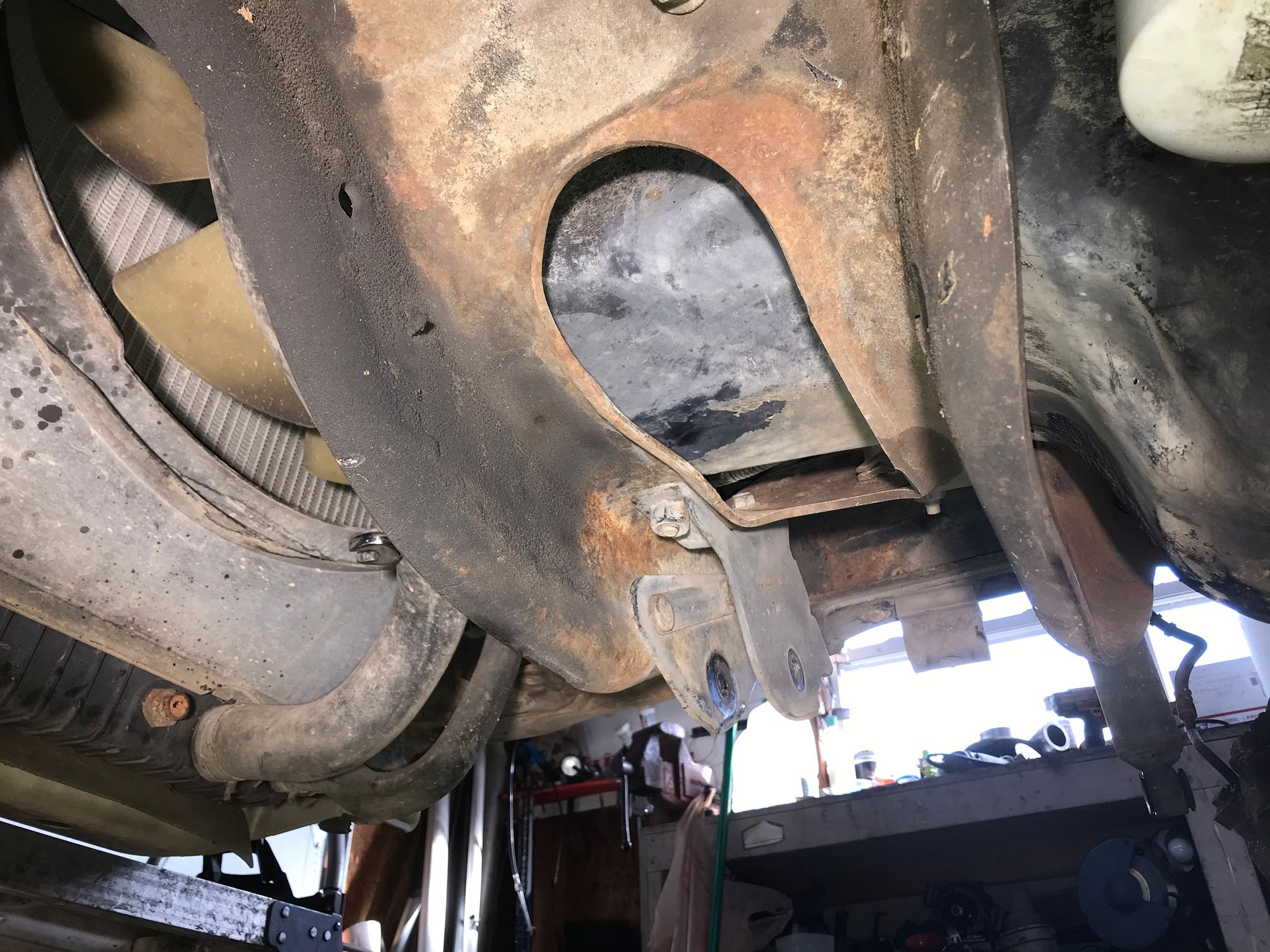

I removed the bump stops to avoid setting them on fire in the next step.
Here, I’m removing the brackets for I-beams.
Uh oh, this bolt won’t come out! It hits the oil pan first.
You can either cut it off so you can pull it out, or put a nut on it from the other bracket bolts like this.

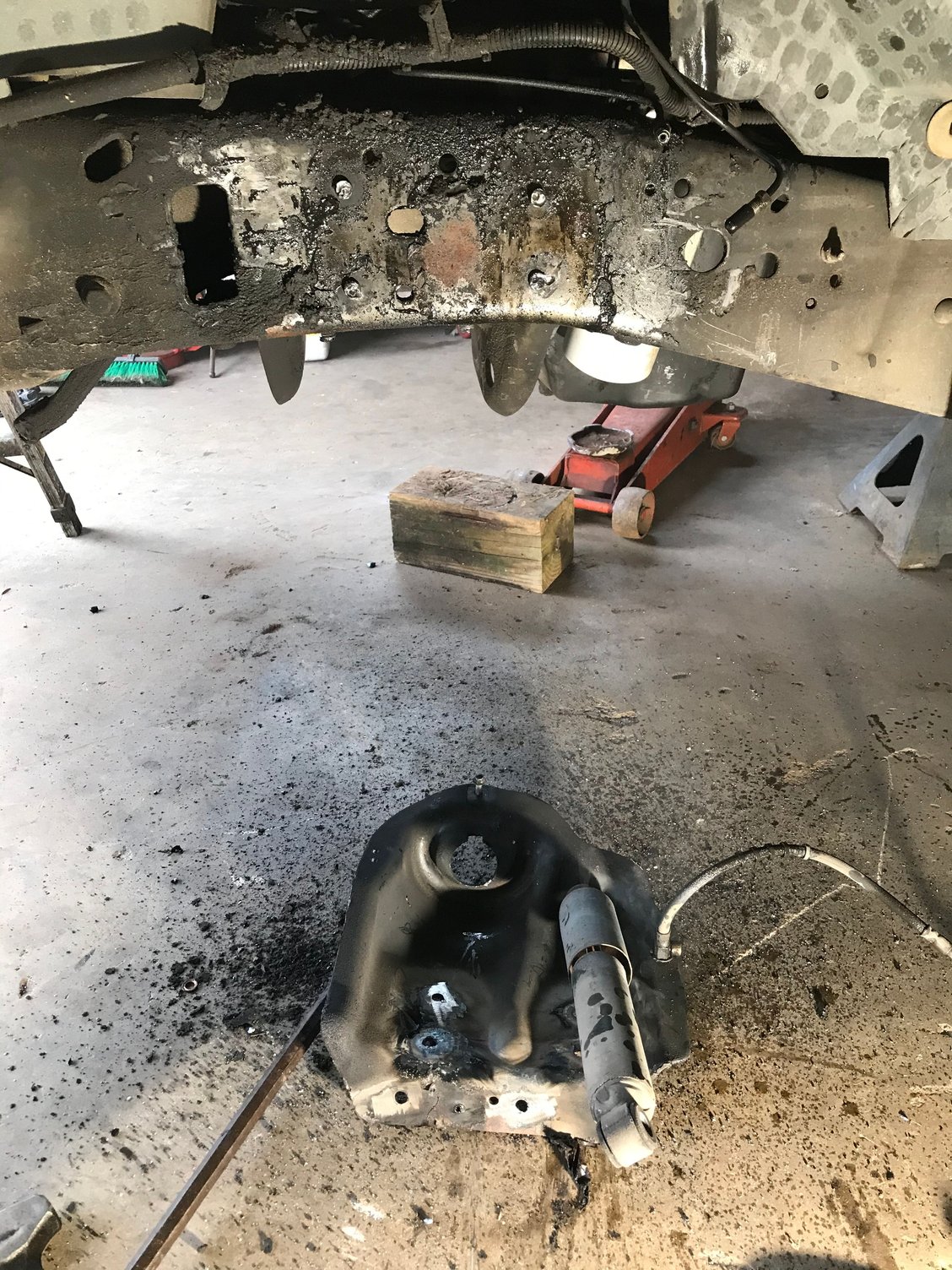

The ‘blue wrench’ easily removed the rivet heads on coil buckets.
As long as there aren’t a million other distractions, (again) I’ll bolt up the 4wd axle and drive this out of the shop this AM.

That’s a bad case of death wobble ya got there buddy. The wheels have fallen off and all.
Im sure a steering stabilizer will fix it

I hope so!!! 🤞

I know what's wrong with it! It ain't got no gas in it!
​​​​​​You're moving right on along Jason! I agree. A steering stabilizer should fix it!
