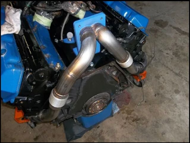

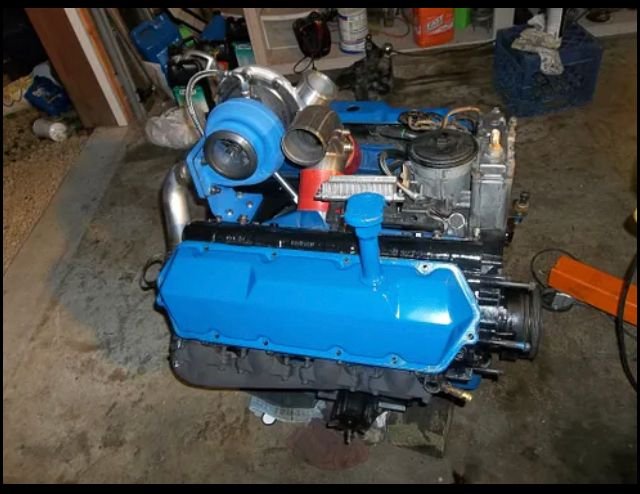

Interesting use of a hard line for the oil feed. Angling the turbo like that might have solved my vane actuator cowl clearance issue also. I wonder if this makes it look enough like a factory system for the CA guys to pass inspection.
Not if the inspector is looking for Garrett, red/green vacuum lines and the OEM wastegate.

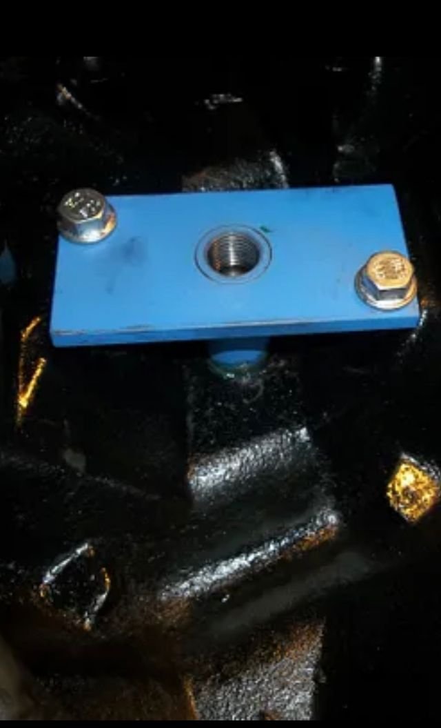

My IDP oil return is a hard line from bottom of turbo to center of the valley. Installing it is a PITFA. I have said I’m going to have a flex hose built to replace it next time my turbo is out.

Ssj, how is the irate oil return a pia? I installed my 363 yesterday, it took me 30 seconds at most to align and tighten the Irate drain line, I find it easier then csd.
I think the design has changed.
This hard line and base that bolts in valley are not fun.

Same as mine, I will have to teach you a trick :-)

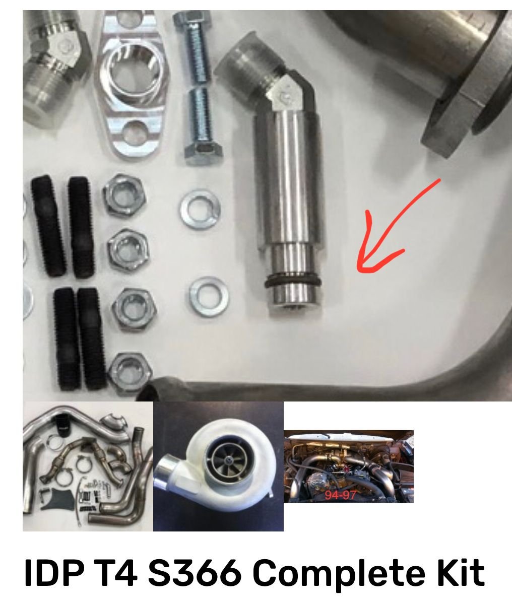

I’m pretty sure Irate has updated the fitting to no longer bolt down. Just pulled this from the Irate site.
Old May 5, 2021 | 05:15 PM
ESwift's Avatar
ESwift
CNCFAB
Joined: Apr 2020
Posts: 4,875
Likes: 2,006
Maybe Irate did away with the bolt plate. Per Irate the piece was never designed to be bolted "down" the 2 bolts were to line it up and hold it from spining while assembling. They say to leave the bolts loose so it has some vertical movement. Leave the turbo to turbine housing bolts slightly loose so you can rotate the center section, rotate bottom of housing towards rear of engine, hold the drain tube, and rotate the center section forward as you do so the drain tube will slip right in between the mount on bottom of center section and the mount in the valley, at this point start threading the fittings but dont snug, now do final tightening of the bolts holding center section to turbine housing to hold it, your oil feed should be nearly vertical on the top of the center section. From the tighten the drain tube, first to fitting on center section outlet, then to valley fitting, if needed lightly pry or push the vally mount up before tightening drain tube to it. Now, if desired, feel free to thread the two anti rotate bolts till they touch the braket, but do not snug them and pull the bracket down. If you are ocd like myself you can remove the 2 bolts side appropriate thickness washers under bracket and then be able to snug the 2 bolts tight. If you ever swap turbo those bolts can stay in place and oil drain line can quickly be removed and replaced/reinstalled in a matter of seconds by simply loosening each end of the drain tube and rotating the center section. I actually really like this design.

I don’t think the bolts are in my plate after engine swap. They would not work.
