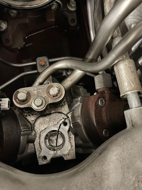

Photo of a destroyed CP4.2
I talked to one of the mechanics at my buddy's shop. He is a Ford tech also. I asked him about CP4.2 failures. He said that he himself has not seen a lot but the majority of them when they happen, are caused by owner error of adding gasoline or DEF where it shouldn't be. But this is a pic of a 17 I believe where water in the fuel split the pump. He said the owner had a WIF light and he kept on driving essentially ignoring it until it 86ed the HPFP. It sounds like this owner could have prevented this but just kept driving the truck. Just thought I'd post for FYI.
I guess fuel was everywhere.

I think I see the problem! I see lots of glitter paint in there too.
My cousin is a long time Ford diesel tech since '94 and at his shop they rarely see a pump fail for no reason. He also said he is not pressured by Ford motor company to void the warranty when no fuel contamination was found.

Absolutely not... But he doesn't see the DEF contamination like he did years ago. Interesting thing is if a truck comes in because of DEF contamination, the pumps don't always automatically grenade and they have gotten by only flushing the fuel system out and driving it some or just change out the pump. Not sure how long the fuel system lasts after that type of repair.
