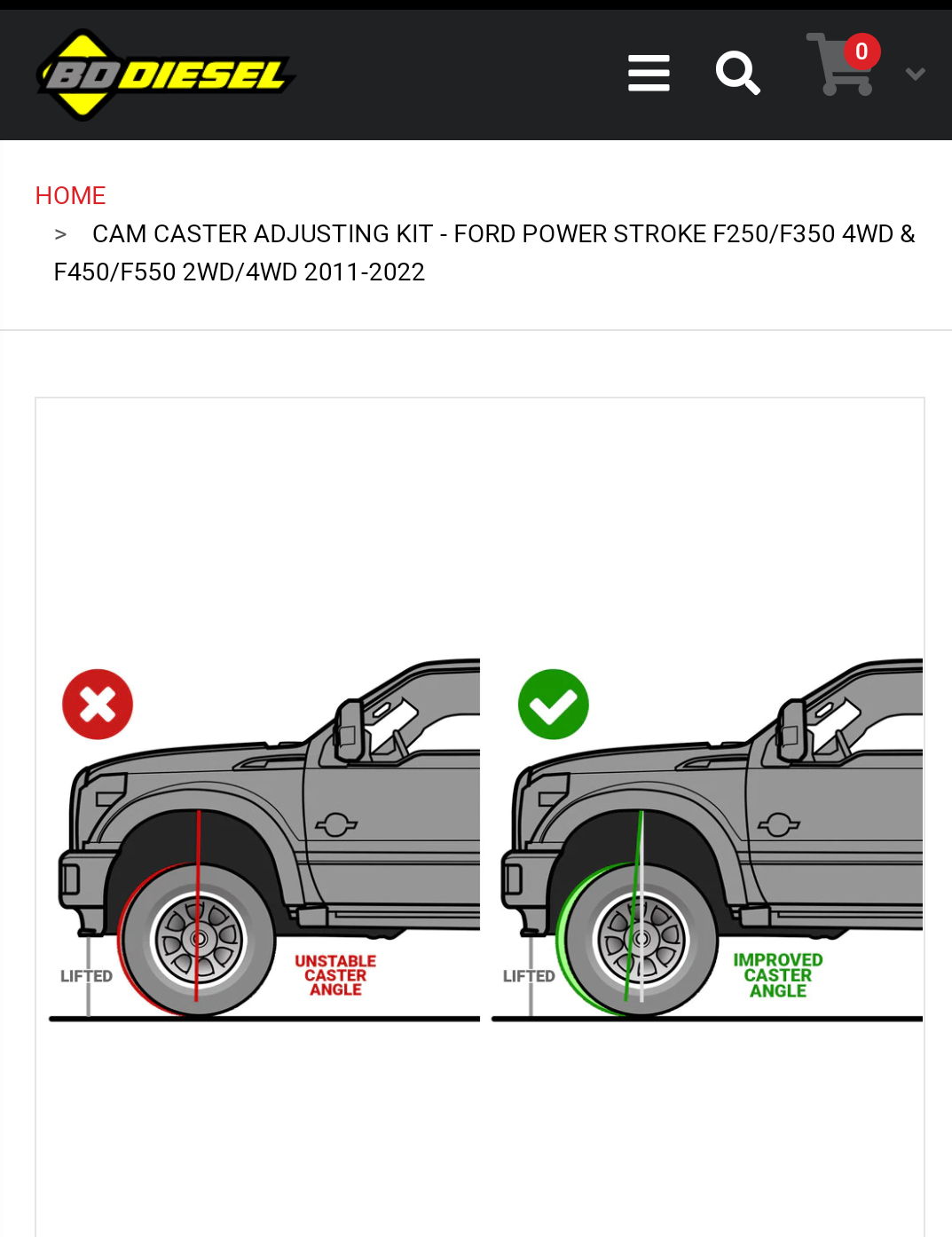

Cam caster adjusting kit 2011 to 2022 F250-F550 2wd 4wd
I just came across this in my email in the Diesel Army newsletter. Might be of interest for you lifted guys.
https://us.bddiesel.com/products/cam...31285815836741

If memory serves me correctly Bill with Powerstroke Help once said the cause of death wobble was the lack of caster angle. The super duty trucks don't have an adjustment to get to the magic caster number that will prevent death wobble. And I don't remember what his solution was, possibly a custom component in that area. Looks like this kit address that issue.

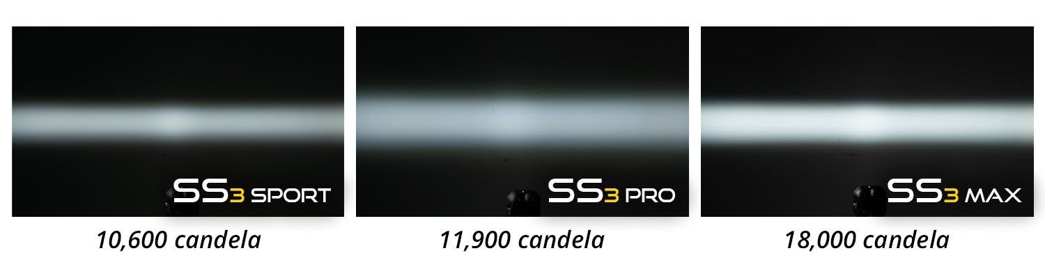

Diode Dynamics SS3 LED Fog Light Kit for 2011-2016 Ford Super
https://www.diodedynamics.com/ss3-le...250-f-350.html
I finally ordered a set of these in Yellow SAE/DOT Fog in the Max power level. I've wanted them for quite some time now. They should be coming in this week. I chose the yellow light because the hills I climb have a lot of fog and during winter, the snow blows up on top due to the winds. Since yellow is supposed to cut through that stuff to increase visibility, I went with them. When I get them installed, I'll post up pics. I'll have to get some before shots so these can be compared to stock fog lights.
I like that they are assembled here and have an 8 year warranty.
Since I drive where there's not a lot of street lights and tons of deer. I bought these in the Max level so I can see the deer before they decide to bolt out from the ditches and across the road.
Stay posted peeps.

They used bushings on the upper ball joint which seems like a simpler solution to me than the BD kit.

i bought some bushings and could never get the old ones out.
i installed an arm drop kit and it was easy peasy

Some judicious application of heat, and I think they should pop right out.
In this video, they install the bushings in another truck:

The upper ball joint has rubber seals…if I heat the bushing enough to get it out….it will clobber the rubber seals.
i think in recent years they pressed these in..I say that becuase almost everyone is surprised that they don’t just fall out. Could be a death wobble improvement.

Did you install the BD kit?
