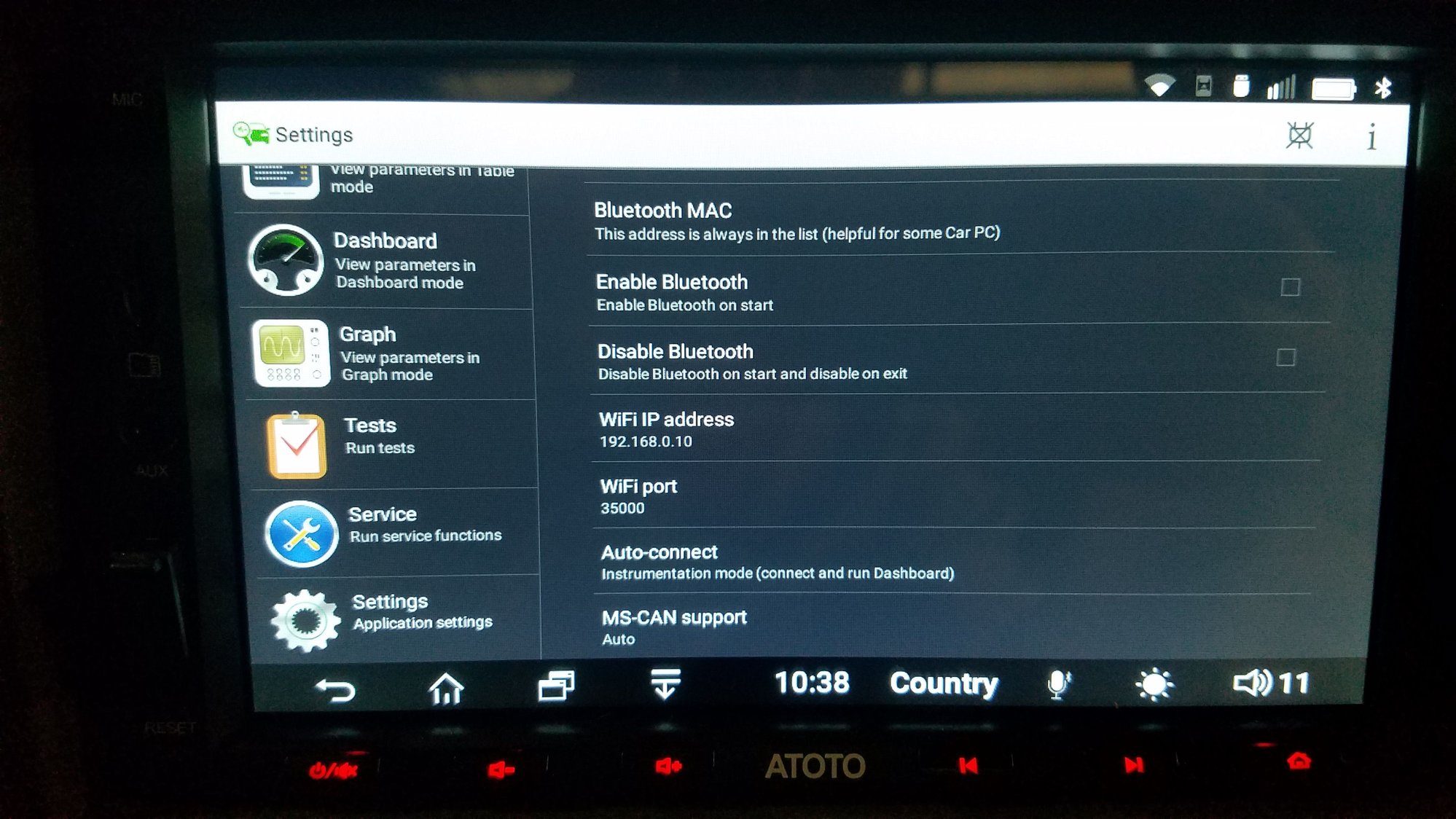

I could not successfully get the existing profile from my tablet transferred over to the Android head unit. Really, I could not figure out how to load a profile from a file folder in FORScan Lite. Maybe Jeff can tell how that is accomplished if he has time in his schedule in the future. I will hold onto the pictures and screenshots I took during the transfer process for a while.
Below are a couple of pictures of the finished product with the side pieces installed from the VX7020 installation kit. I trimmed them up a bit and think they finish the look quite nicely.
Now for the FORScan app running on the head unit. It took me a moment to remember what settings needed to be and this was my first time using the FSL app and a USB cable. I had always used the OBDLink MX in the past, so I scratched my head a moment and figured it out.
The setting I used was "USB FTDI". There were several other USB types, but I could not get the others to work.
I also turned the Auto-connect feature to "connect when app is opened" after first having it set to "connect and run dashboard" as seen in the image below.
If you want FSL to connect and start each time you start the truck, then simply set the Auto-connect to "connect and run dashboard" and it will do that. I do not need FSL each time I start the truck and may only run it every once in a while to log data or just because I feel like it.
The head unit boots up to the main page within 1 second of turning on the ignition and by the time I turn the ignition from start to on, is ready to go for a command or task. Once I push the FSL app button on the main page which is the second button from the right in the screen shot of the home screen below...

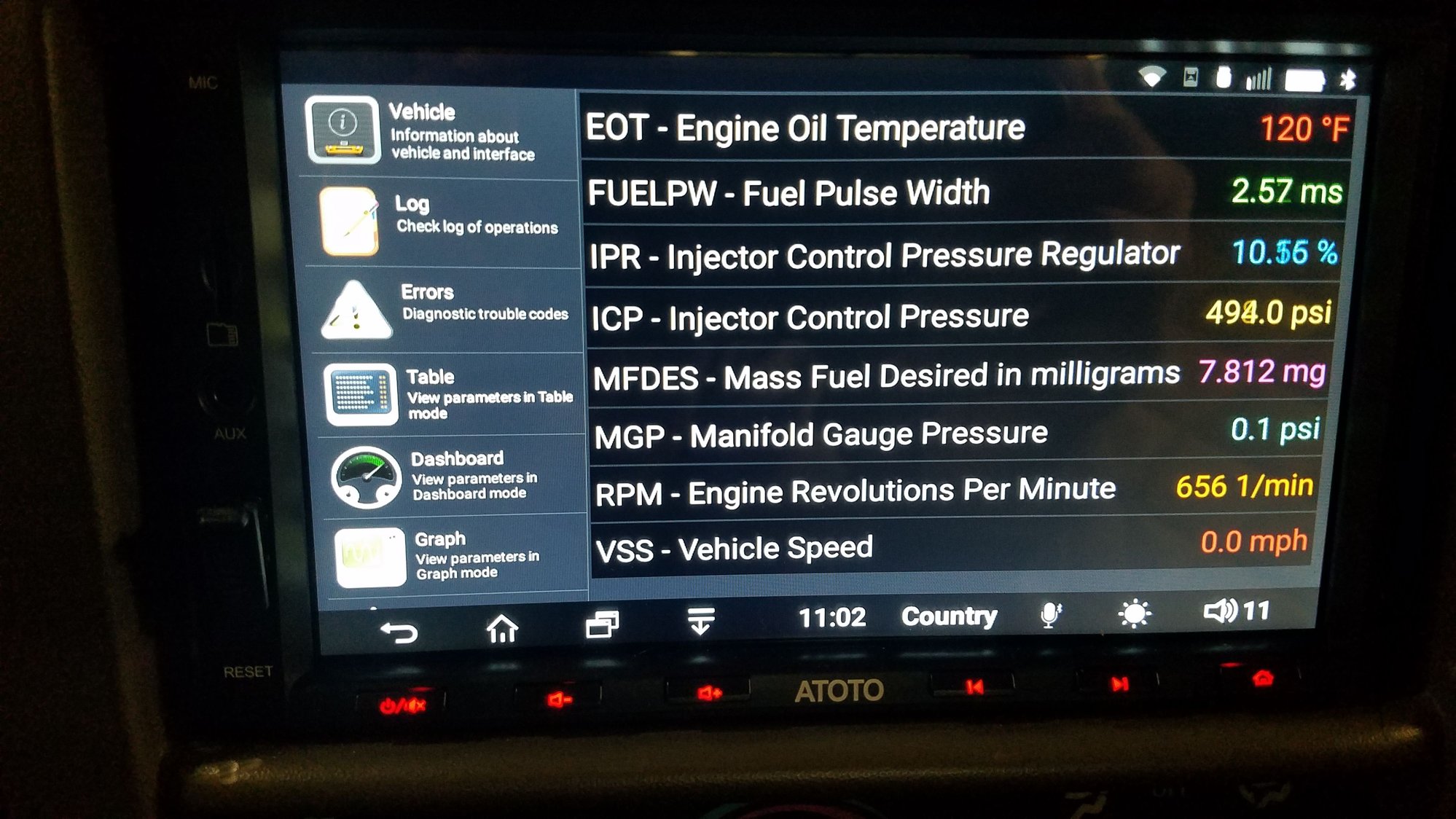

The FSL app almost instantly brings up the vehicle information screen as seen below.
From there, I can select dashboard or table based on how I would like to view the PID's I have selected. I trimmed down my list of PID's because I don't need some of the ones I was logging. I also zoomed in a bit which put the less viewed PID's at the bottom of the screen and requires a swipe up. I put MPH and RPM down there. The images below show all of the PID's I am monitoring at the moment for the sake of this post.
I can zoom in and out just like on a smartphone and the interface is very quick to respond, just as it is on a tablet or smartphone.
