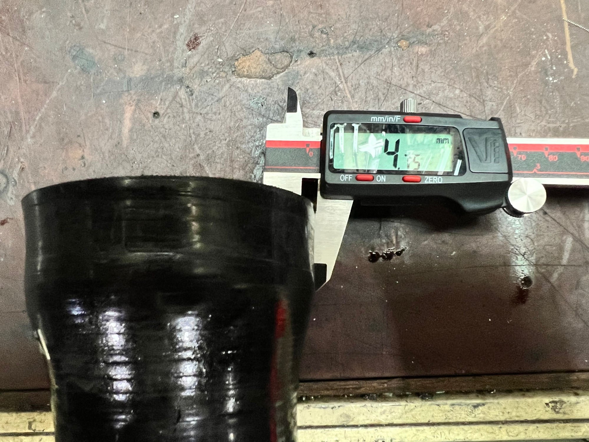

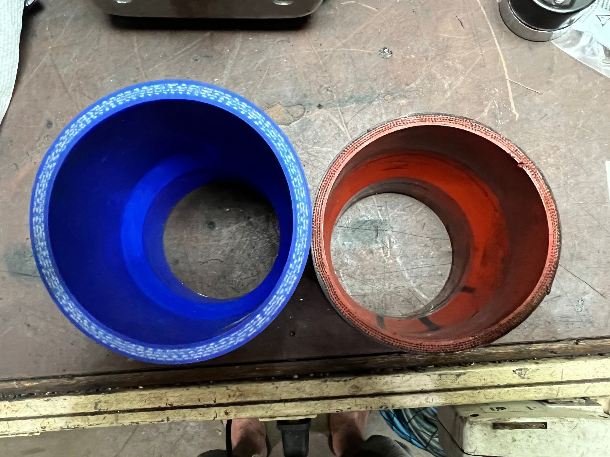

As some of you might have read in the Morning Coffee thread, I had an issue with the turbo to hot side CAC pipe boot. The wimpy Vibrant transition boot kept burping a lip out from under the clamp. I replaced it with a beefier transition boot today.
Both of them are 2-1/2" to 3" transition boots. Original Vibrant boot on the right, new Pegasus Racing boot on the left.
Vibrant boot wall is way thinner than...
... the Pegasus Racing boot. Wall thickness measurements are in millimeters. The wall of the new boot is almost an entire millimeter thicker.
The thicker walls made it a bitch to shoehorn the CAC pipe into the boot. I hope this one holds up or I'm going all Adel Wiggins on this joint.

I'm interested in how this works for you, but I question your choice of measurement units.

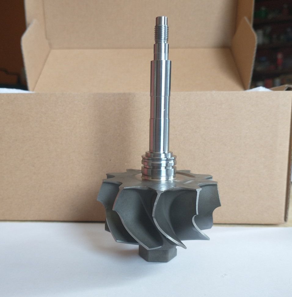

Have you thought about swapping out the 73mm turbine for a 68mm turbine? Easy swap, and relatively cheap compared to other options. After all you are just battling an incorrectly sized turbo, at 2100rpm that thing should sound like it is about to come out of the hood. An S364.5/68/.91 (or.83) will move enough air to keep EGTs down below 2100rpm. My S363/68 has no problem pushing 30psi at 2100rpm with egts around 1000.
Also remember that "Real" VGT turbos have much thicker turbine blades that can handle the extra abuse that a VGT puts them through. SXE turbines are much thinner in comparison.

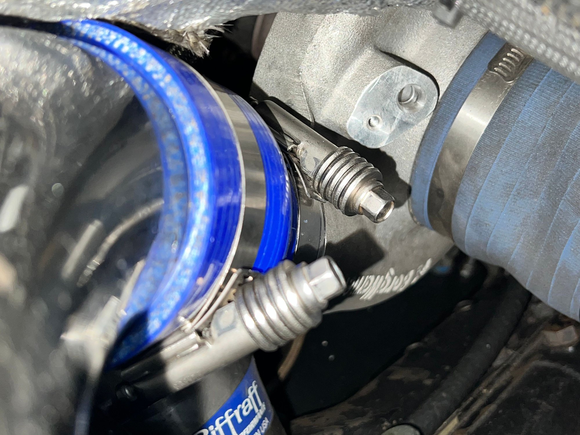

What kind of clamps are those? Any reason you used them over T-bolt clamps?

When the vanes of a VGT close, hot, pressurized, high velocity gas is forced directly into the blades of the turbine. This causes an area of concentrated heat and pressure on the blade tip. VGT turbine wheels take this into account so they are made heavier and thicker than a non-VGT turbine to handle the abuse.
Here is a 10 blade turbine for a 2016 Powerstroke VGT turbo. You can see the thickness throughout the entire turbine.
Swapping the turbine wheels from 73 to 68mm is pretty easy. If your turbo is in great shape you may not even need to rebuild it, when I swapped to 68mm I didnt rebuild. The turbine wheels are also component balanced so balancing is not a necessity.
Simply unbolt the compressor wheel and remove it. The old turbine will slide right out of the turbo. Carefully transfer the oil seal from the old turbine onto the new with a dab of oil. Slide the 68mm into the housing making sure to seat the oil seal. Reinstall the compressor wheel, tighten until snug then ~1/4 turn more. Reinstall into the appropriate sized .91 housing
sorry, I’m not trying to derail the thread last question here! Lol
do you have a link of turbine wheels?
I know the diesel world is infatuated with billet but I’d be curious if a billet wheel or titanium wheel would hold up to the added abuse
Those are the ones that came in the CSD kit and I'm too cheap to swap them for t-bolt clamps since they still seem to work.
