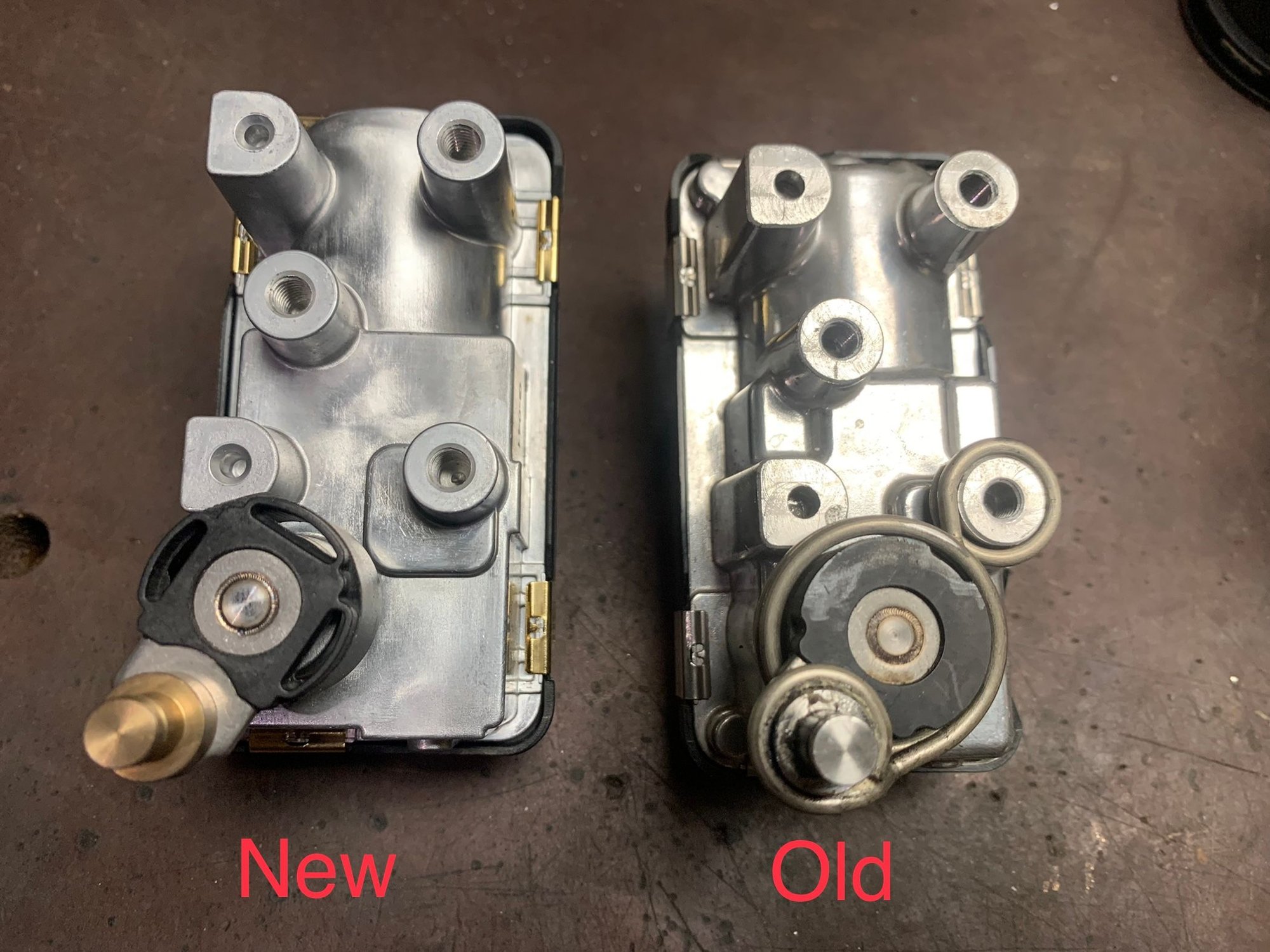

Swapping the old actuator for new was easier than expected. The spring got moved over to the new actuator too.
Data logging tomorrow.
At least a couple of design changes even if it is not the HD version.
Was the weight and were the exterior features roughly the same?

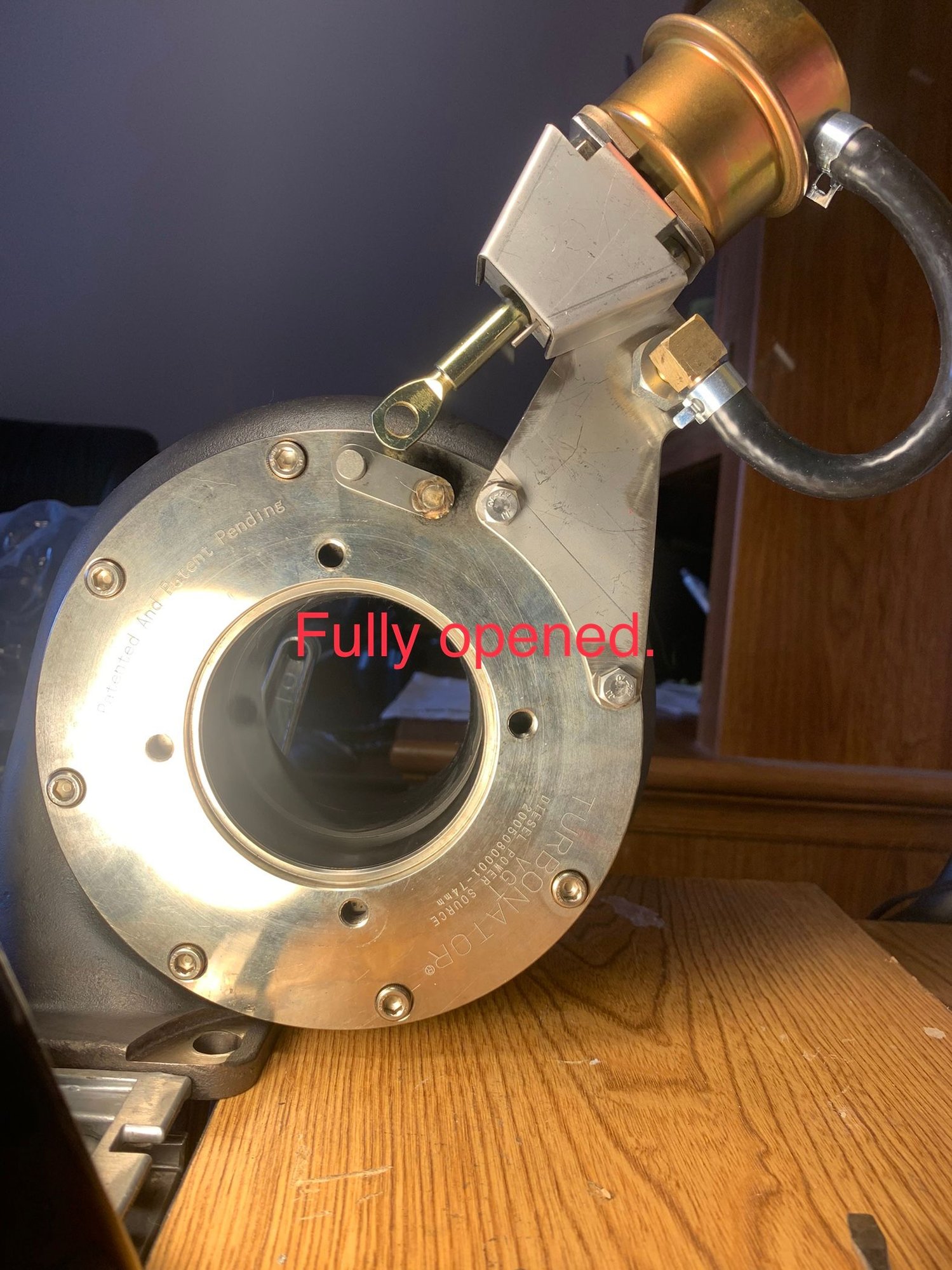

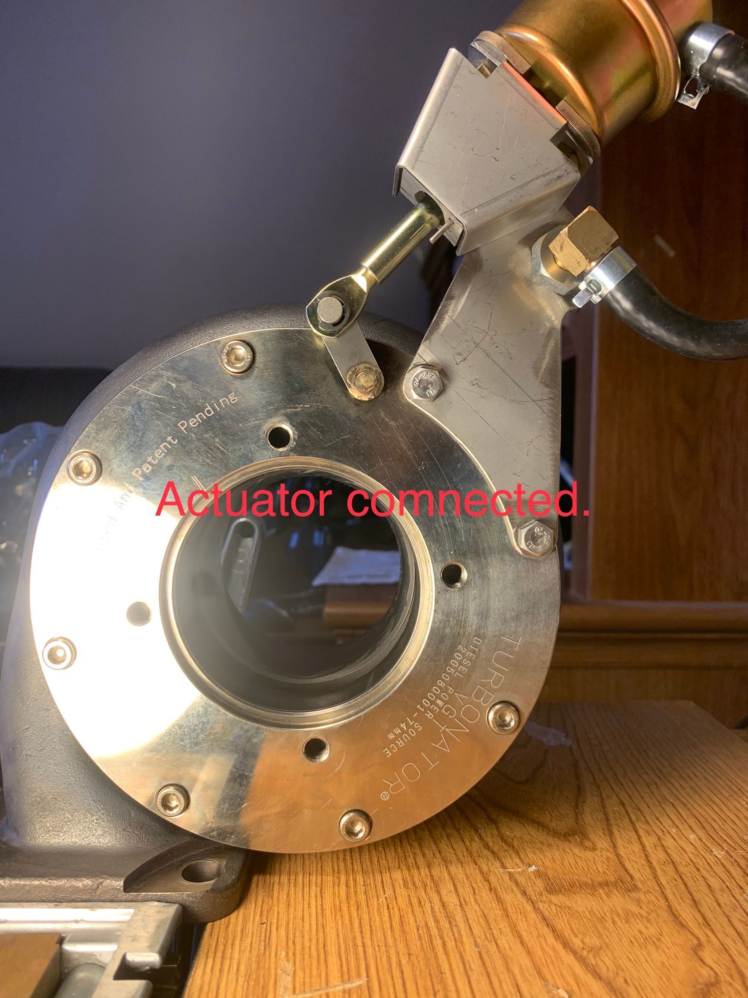

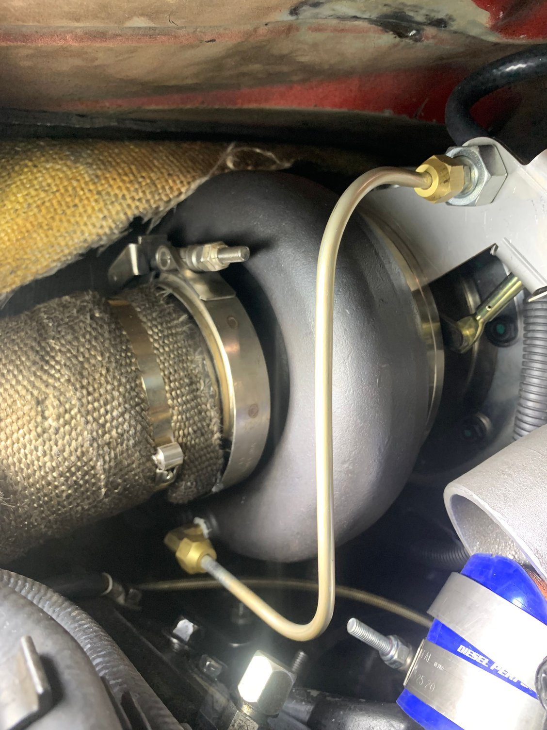

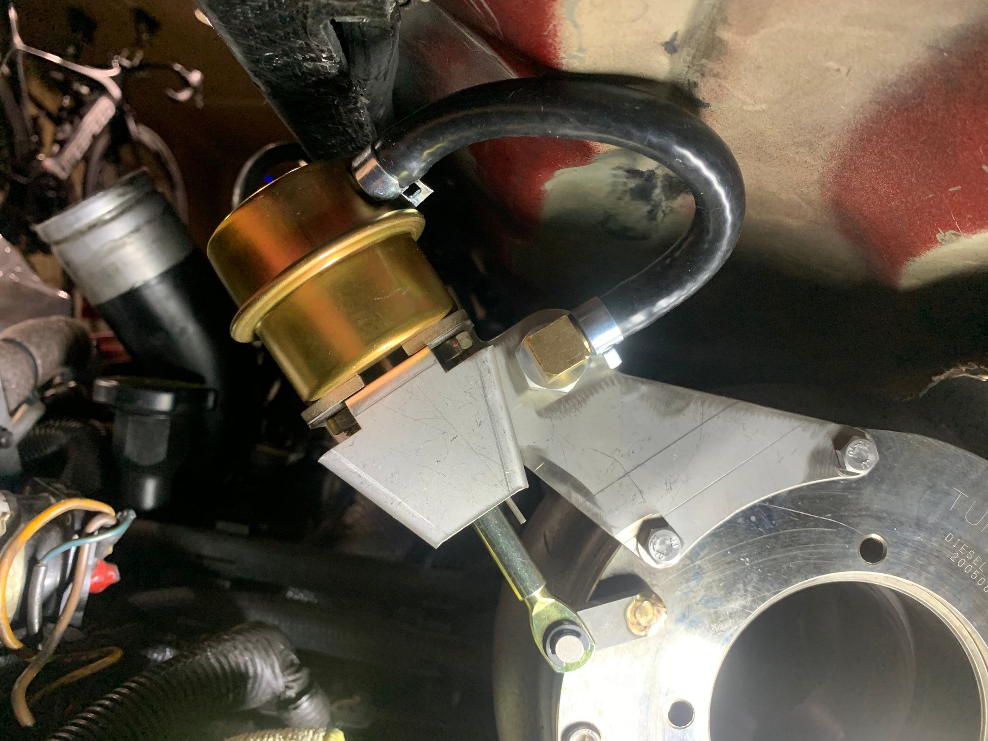

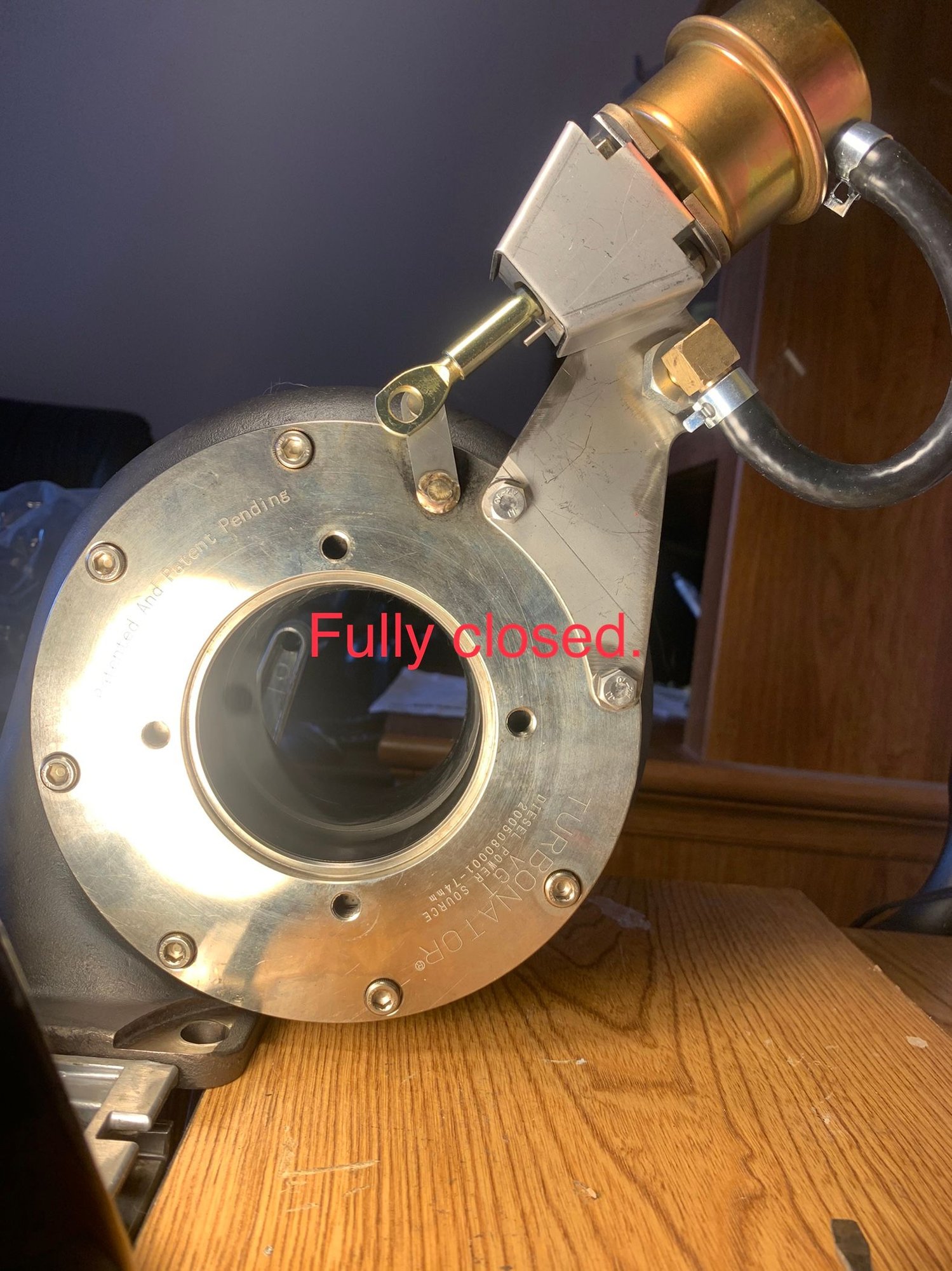

The truck is up and running again, albeit with an interim mechanical vane actuator instead of the electrical actuator. It appears DPS calibrated the mechanical actuator to match my original starting position with the electrical actuator.
While the turbo was out, I decided to make some improvements to the CSD y-pipe brace.
The mechanical actuator has better cowl clearance than the electrical one. This bodes well for the new HD electrical actuator which is similarly shaped and mounted.
The truck now has reasonable EBP when I'm getting on the go pedal again. With the mechanical actuator, boost response is not quite as good down low and maximum boost is lower. This is not unexpected. Video and data logging to follow.
