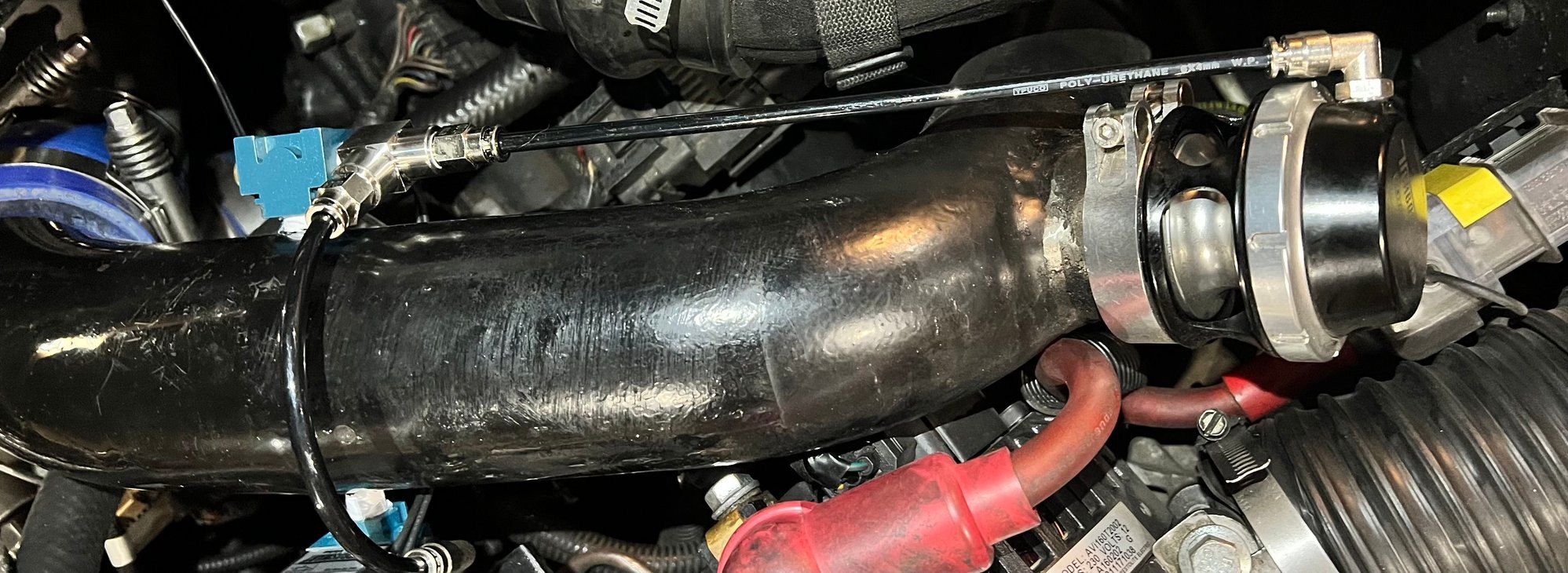

One step closer to shift-activated BOV. Additional solenoid valve for the RPM-drop sensing controller to activate. Accelerator pedal-activated solenoid valve still works.

Dumb, curious question.
Why drill and tap a second hole in the CAC instead of just mounting both solenoids on a Tee off the original hole?

Because that thought had not occurred to me.
