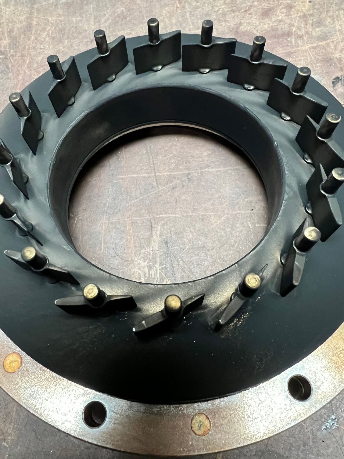

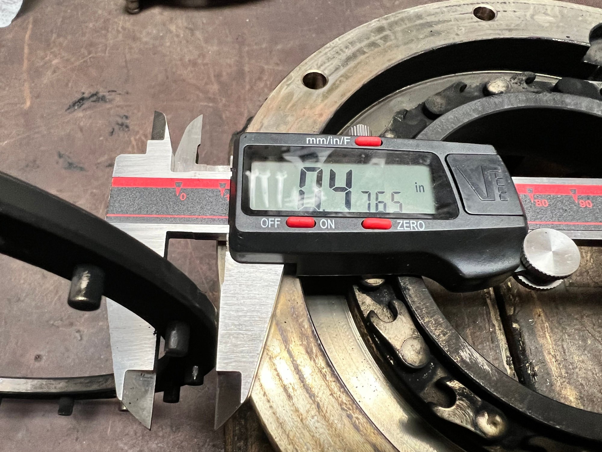

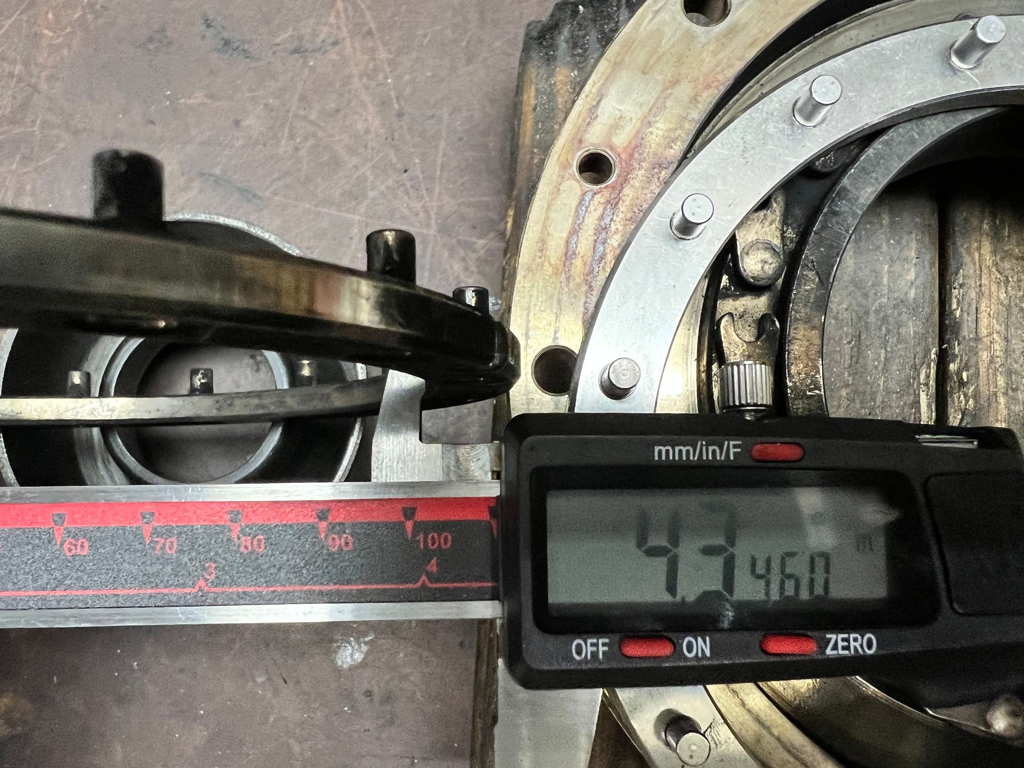

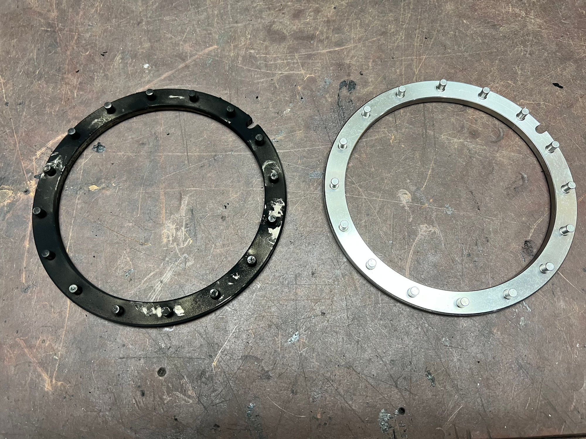

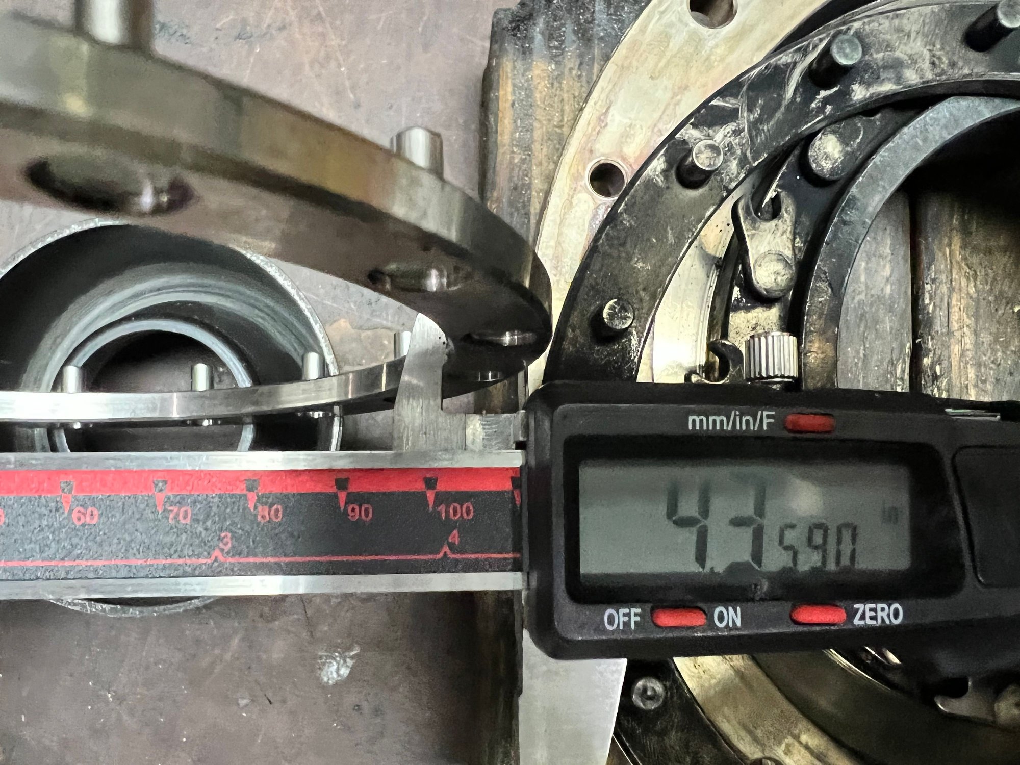

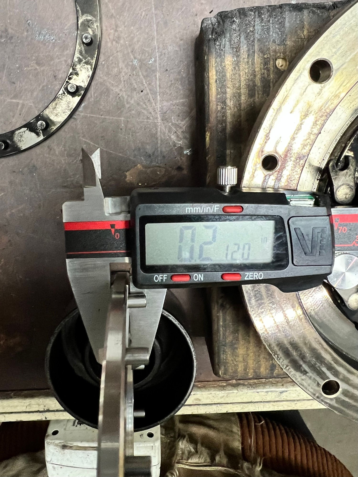

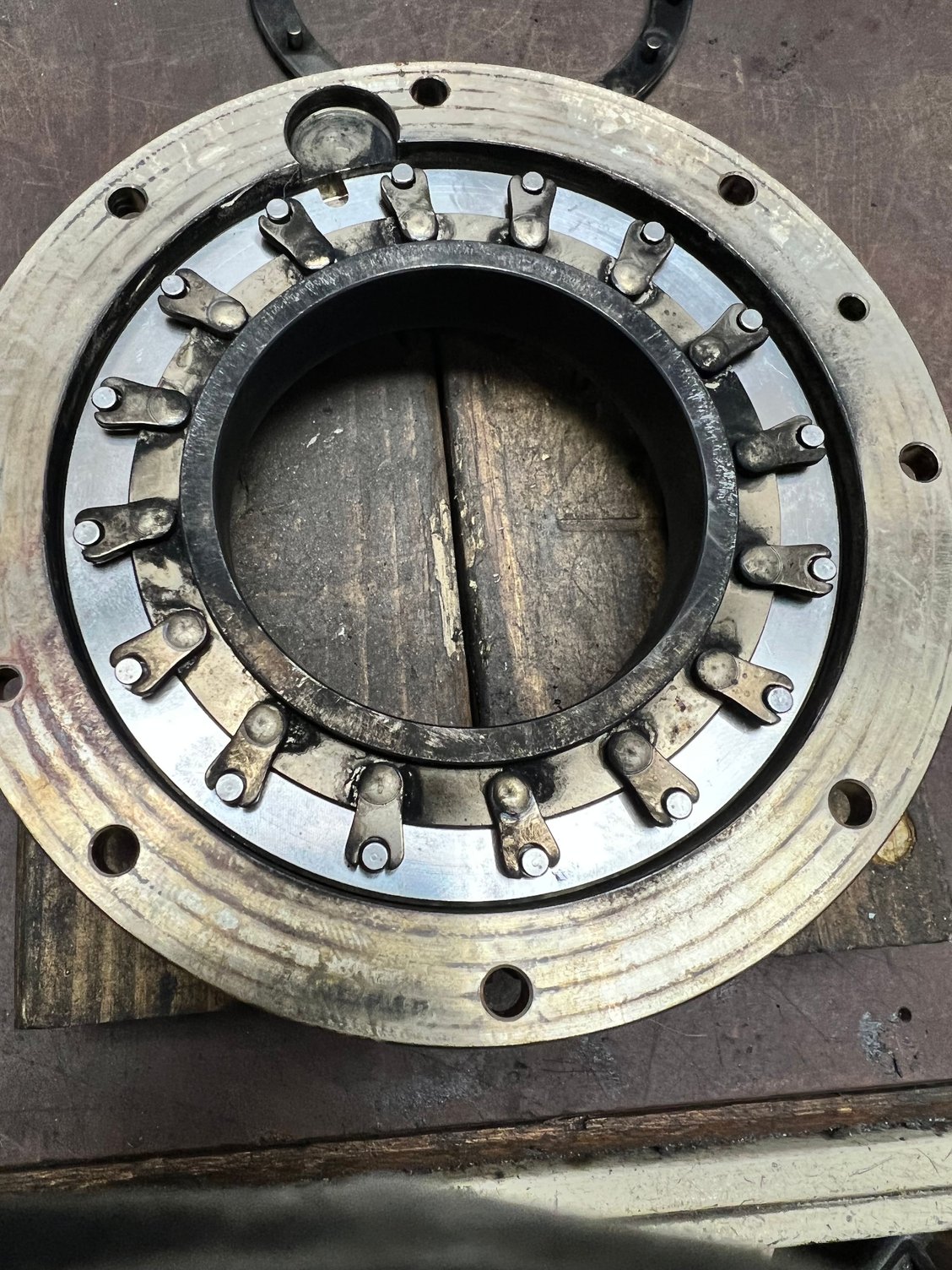

I finally got around to swapping out the unison ring today. Took some measurements while I was at it. It appears they changed clearances a little to account for thermal expansion.
