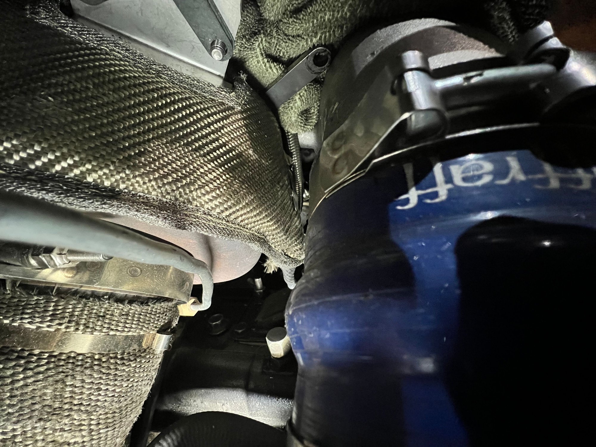

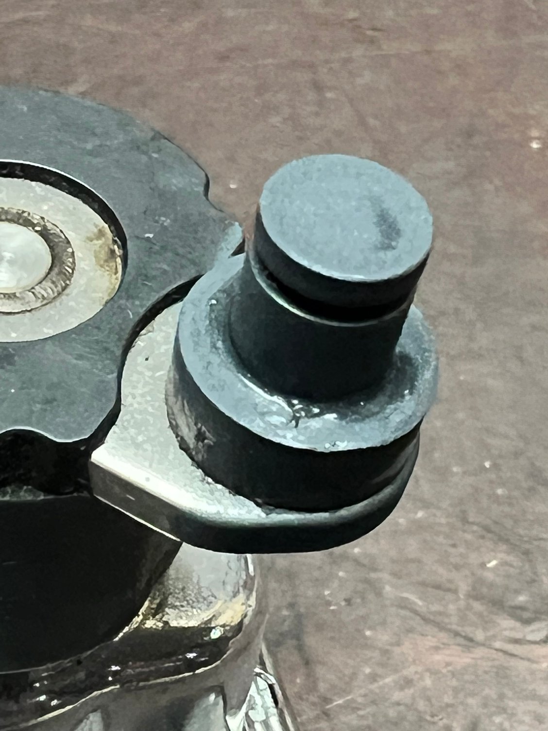

During the actuator swap today, I also reconfigured the heatshield to not wrap around the actuator as tight.
The pin on the actuator that the link slides over got a spritz of WS2 dry lube.
The vanes manipulated manually via the link felt free and moved easily.
