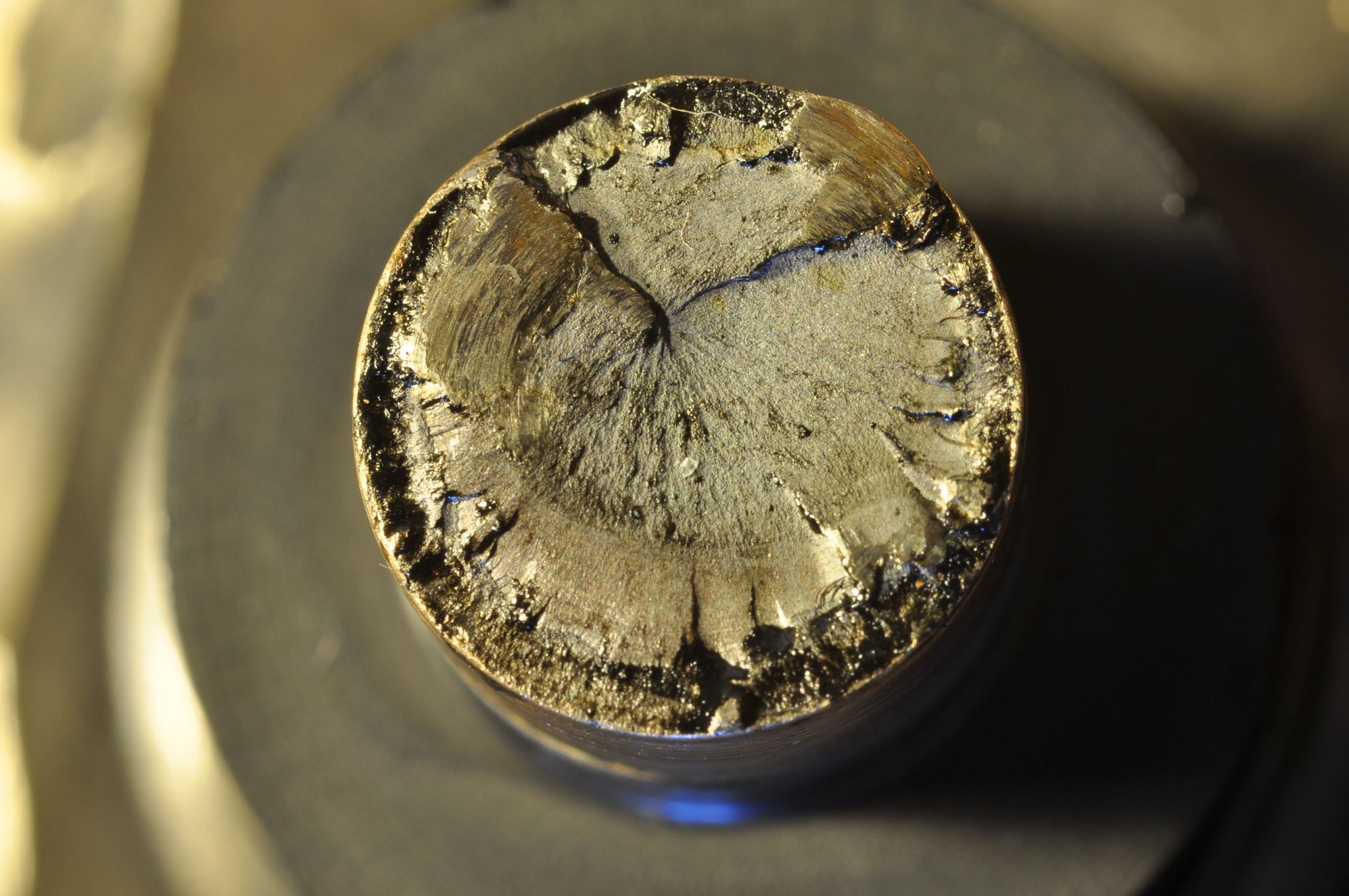

All right all you metallurgists. What are your opinions of the failure mode of the turbine shaft?
Was it clean where it sheared when it came out?
Old Mar 19, 2021 | 05:47 PM
  #834
FordTruckNoob's Avatar
FordTruckNoob
Joined: Jan 2005
Posts: 13,137
Likes: 4,732
From: Henderson, NV
What do you mean by clean?

Joined: Jun 2013
Posts: 5,648
Likes: 894
Been a LONG time for me on metallurgy. It does look like a case hardened shaft. Note the thin "crust". Case hardened would make sense...hard OD with a tough core..
Old Mar 19, 2021 | 06:08 PM
  #836
BA86f250's Avatar
BA86f250
Joined: Jun 2017
Posts: 156
It looks sooty, almost as if it had been cracked right there for a bit then finally gave out. Its hard to say though because it was hanging out in the turbine housing after it broke. Makes sense what Dan said about being case hardened, either that or some sort of coating. Maybe chrome or nickasil.
Oh. Well, there’s an oil passage where it broke and then the turbine with that stub of shaft popped itself out of the center section and wedged itself in the Turbonator as oil flowed around it and out the exhaust so no, it was definitely not clean. I was lucky and close to home so I made it home before I lost all me oil. What you see in the pictures is after much scrubbing with soap. Hard to say whether the soot got there before or after it popped out of the center section.
Yup, I agree it looks case hardened. It looks like multiple fractures to my eyes which says fatigue failure to me.
Looks like at least 2 events for sure, first the brittle case cracks under torsion load then getting cut off in traffic is enough to twist off the inner portion.

It looks like a lack of greta tears to me
in all seriousness i sent to two of my engineering buddies for their opinion. Alot going on there.
maybe post here?https://www.eng-tips.com/threadminder.cfm?pid=330
ill post it on irate4x4 too if you want, some pretty smart guys on there. I dont have much to offer, it looks like slow break
