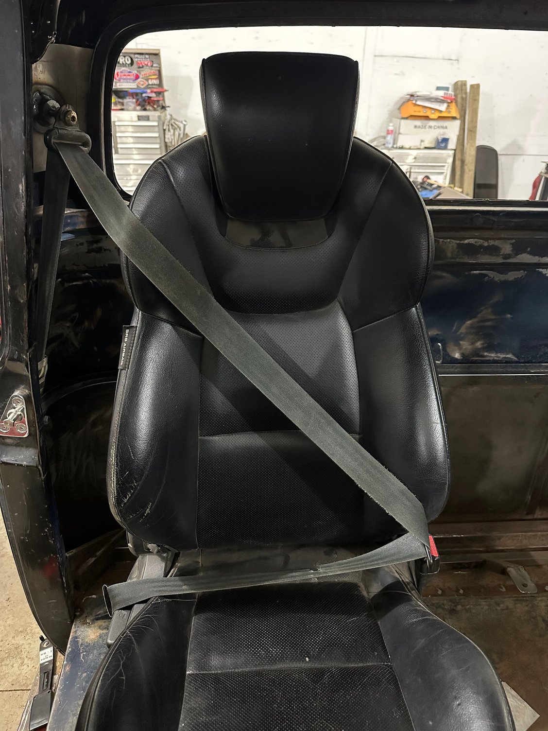

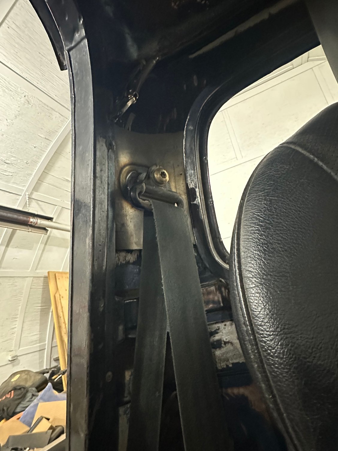

Ok. So that way they don’t intrude on the back panel at all

They don't interfere at all. These are similar to the ones I've used other than the colour, ones I have also have the webbing rather than the cable
Amazon has choices to choose from

I like how the retractor is covered.

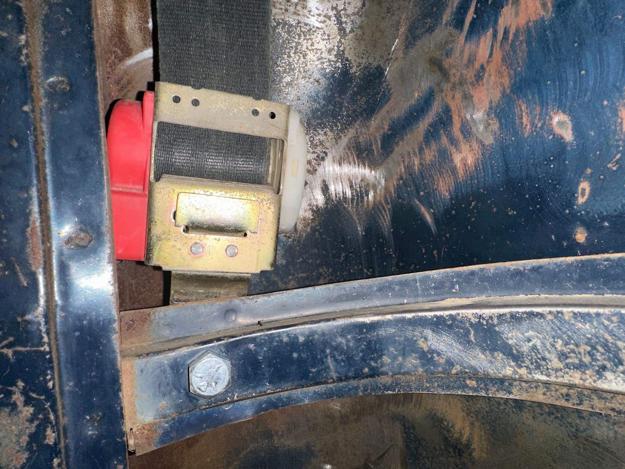

I think I’m gonna try this for now. It’s tucked in there. I think the ABS panel will cover it. I will just have to cut a slot for the belt to come through.

I'm not sure that I'd rely on that as a good anchor point, plus there only looks as though there is one spot weld holding the brace to the post. I thick you'd be better anchoring it through the floor with the heavy flat washers that come in the kits or make a washer or use a piece of flat bar on the underside of the cab floor....

Yeah I see what your talking about

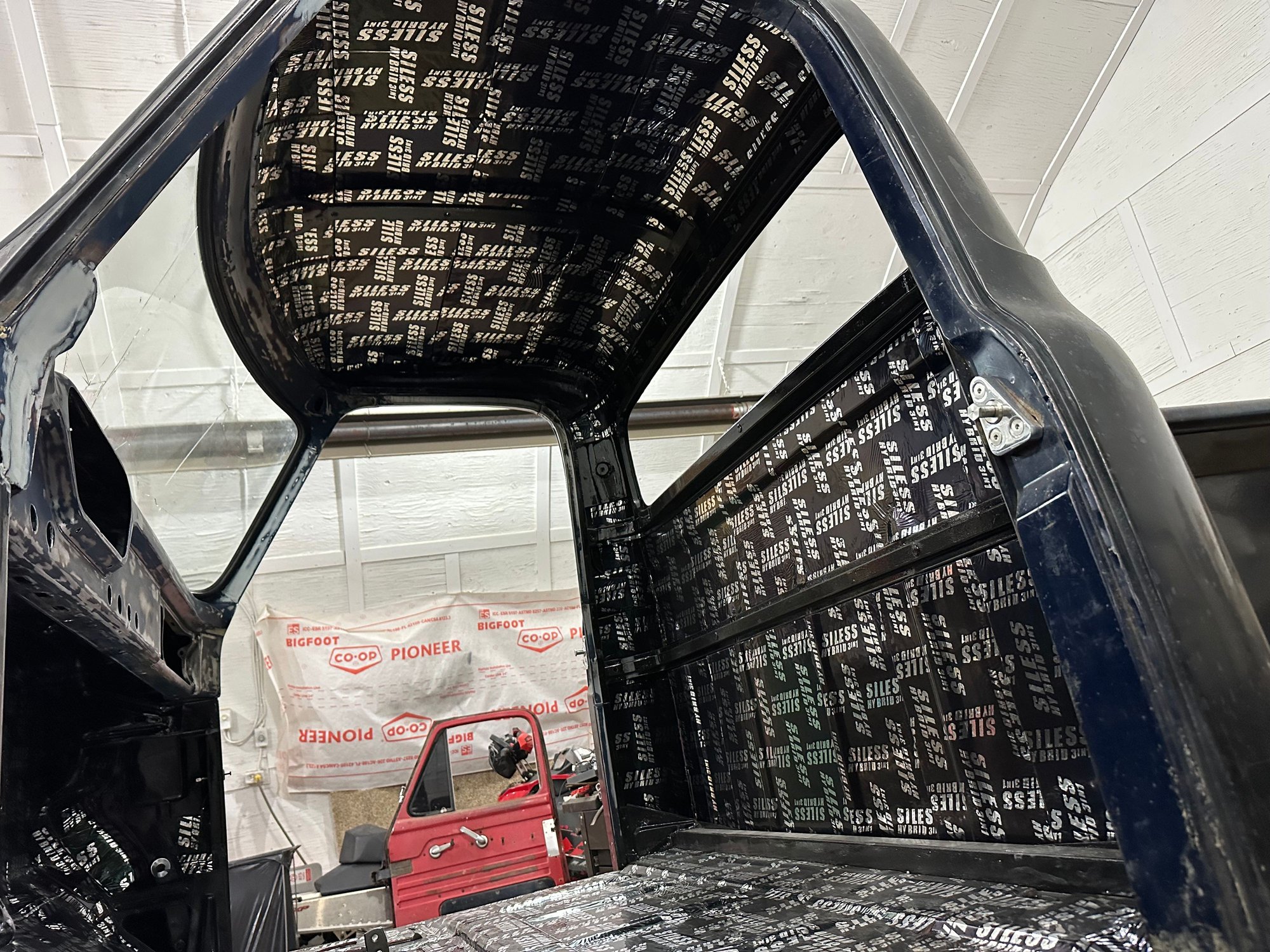

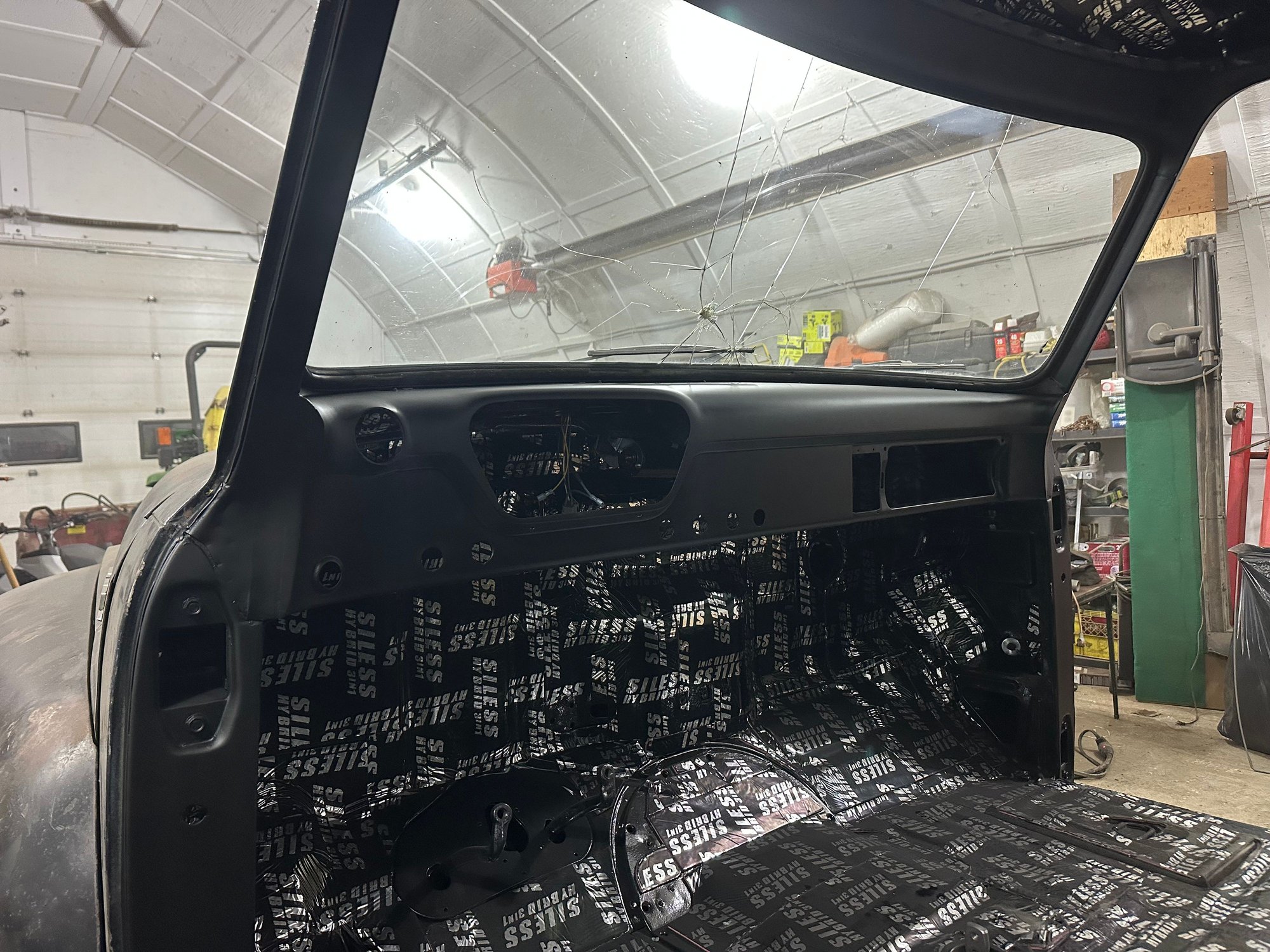

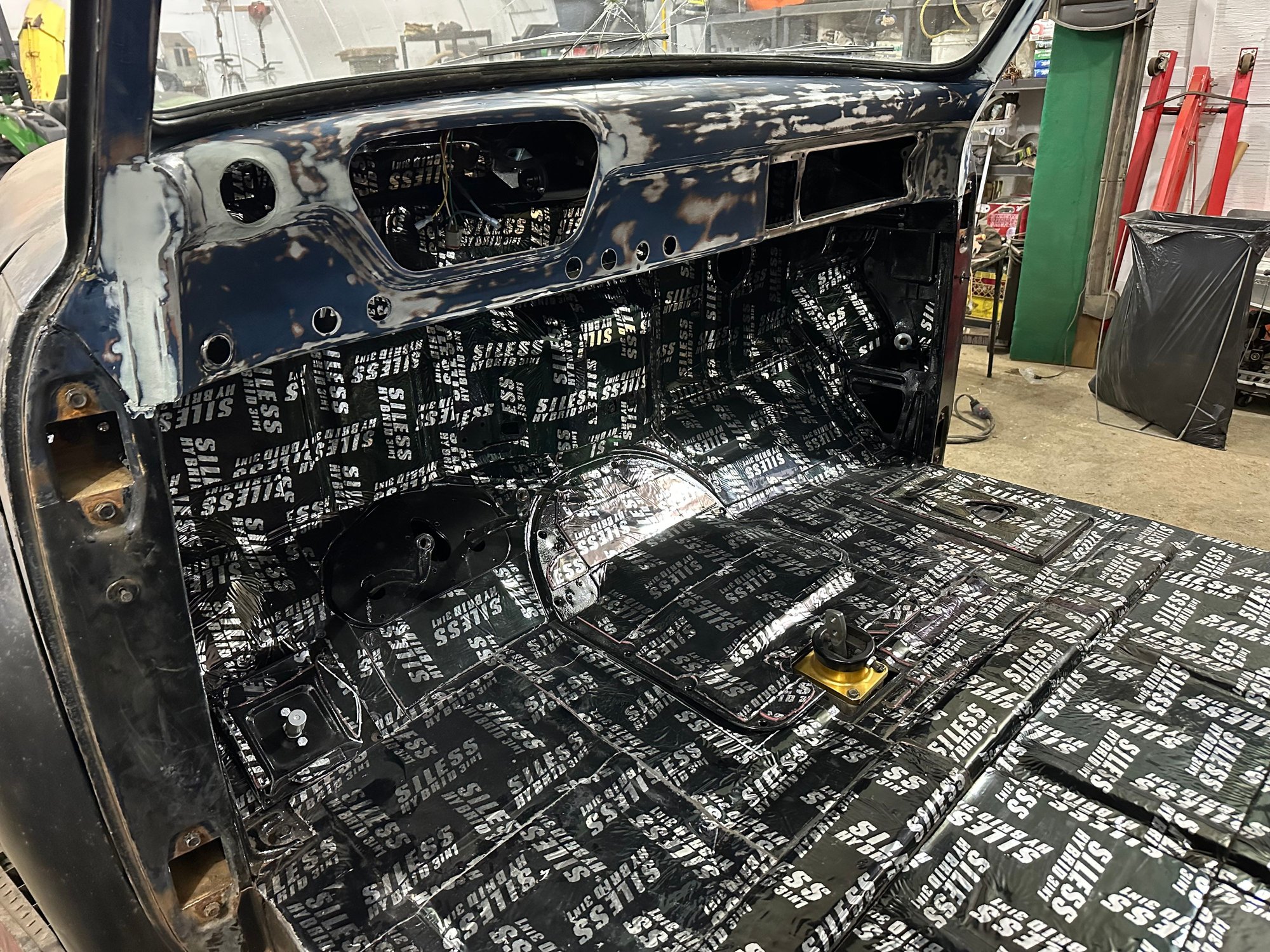

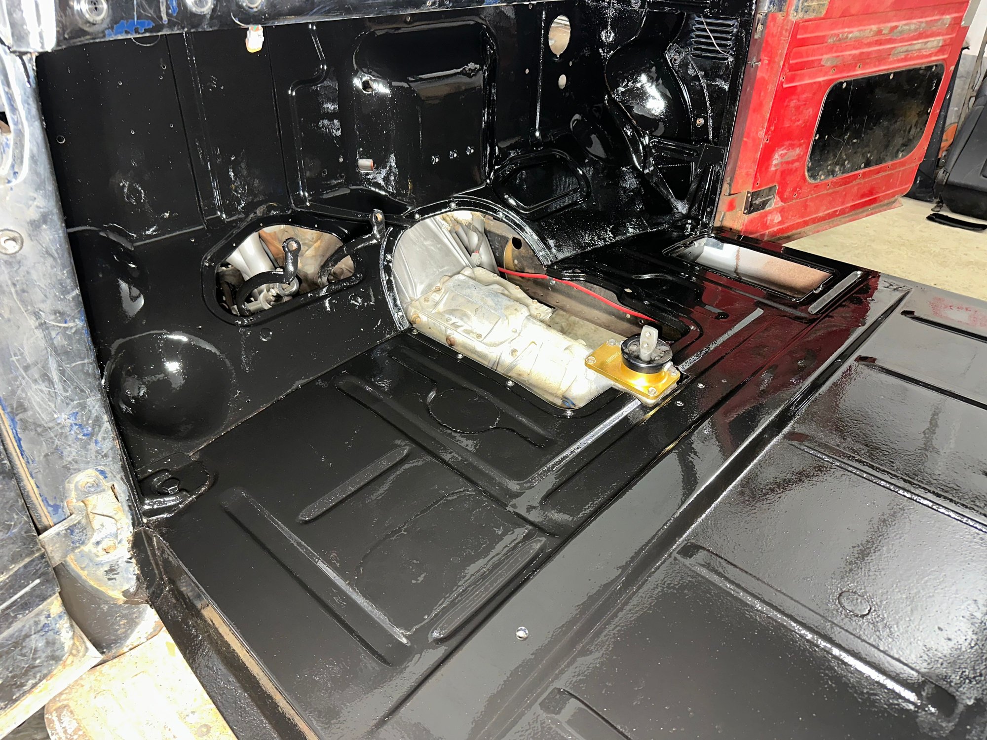

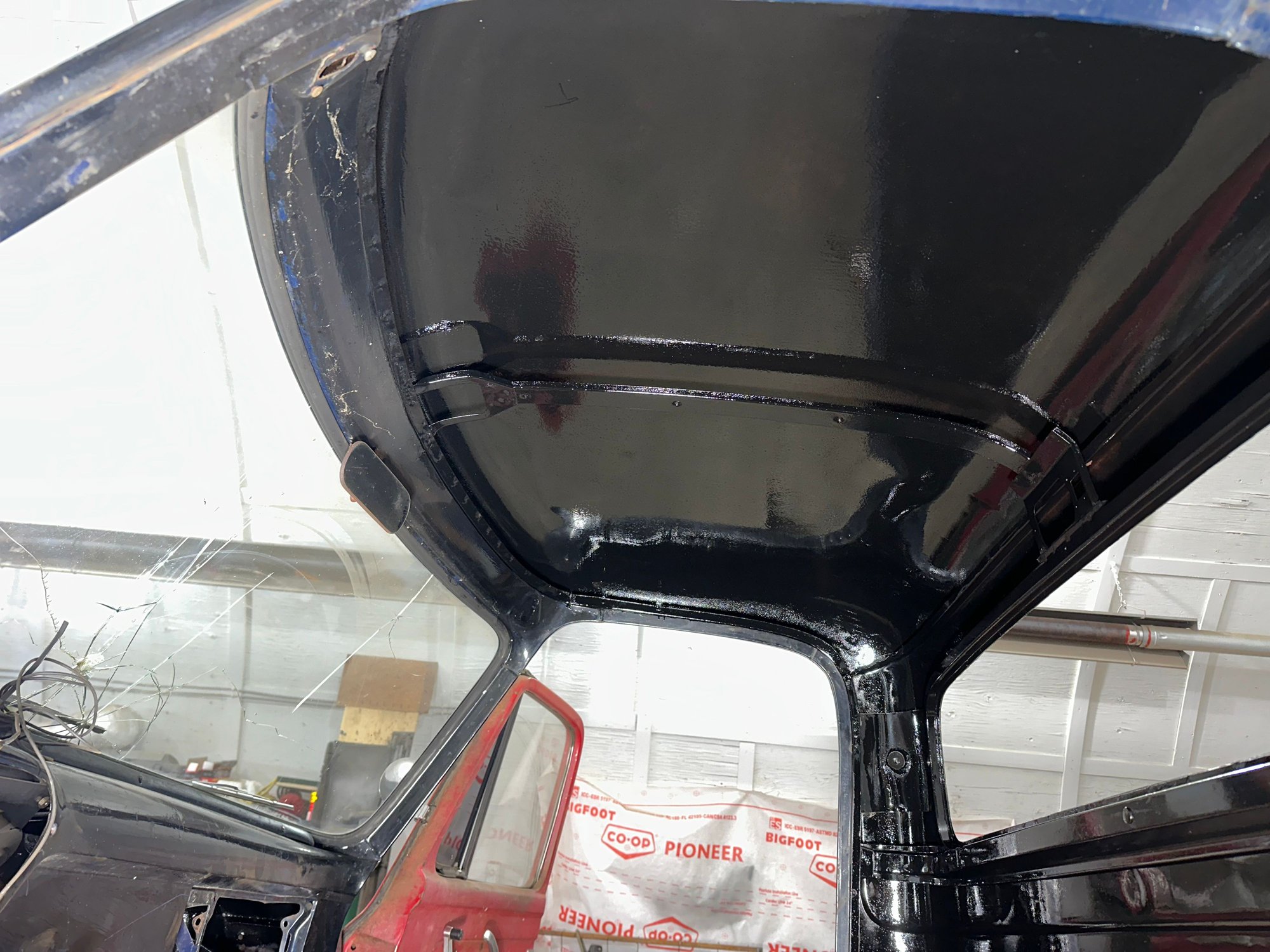

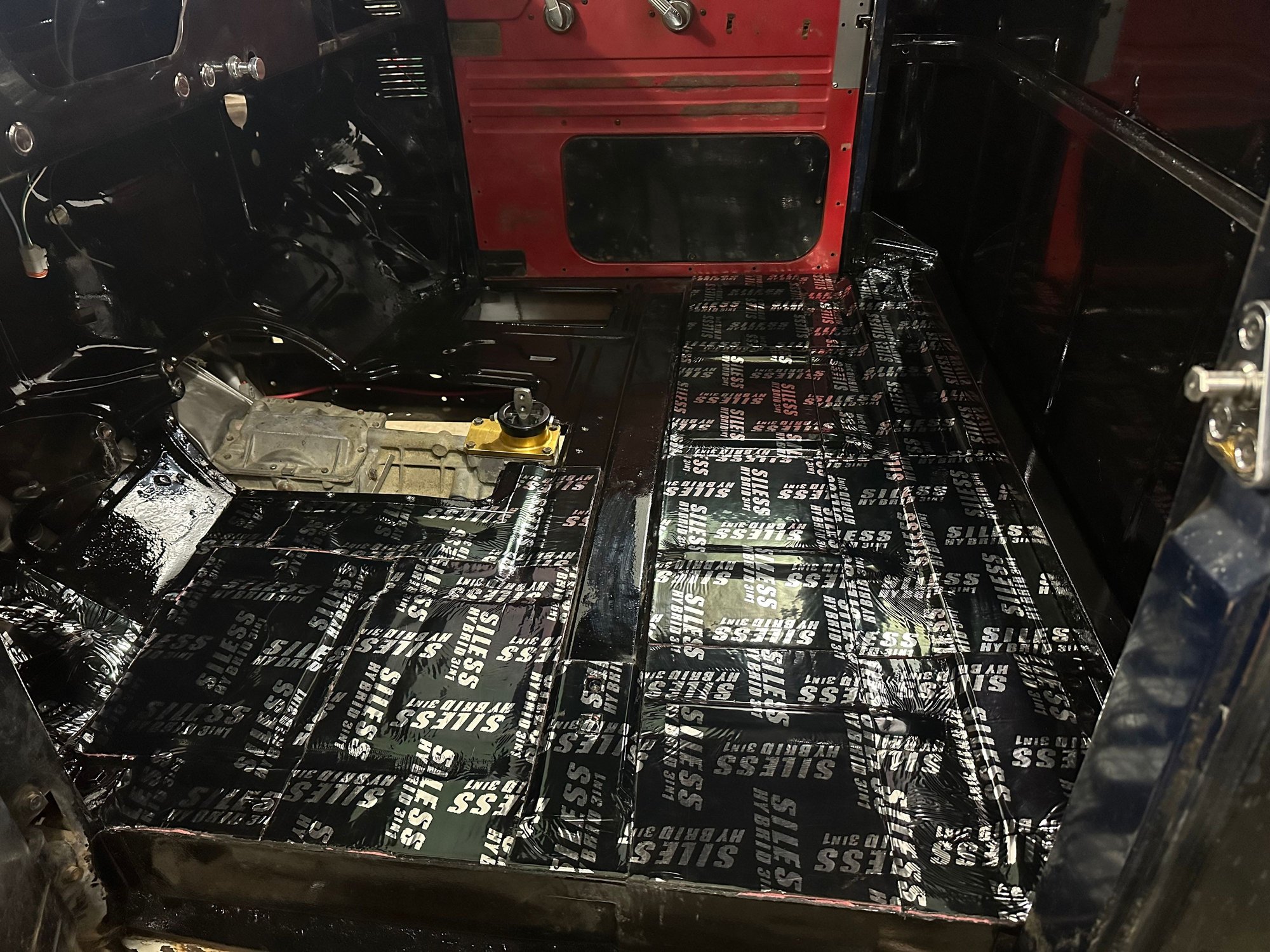

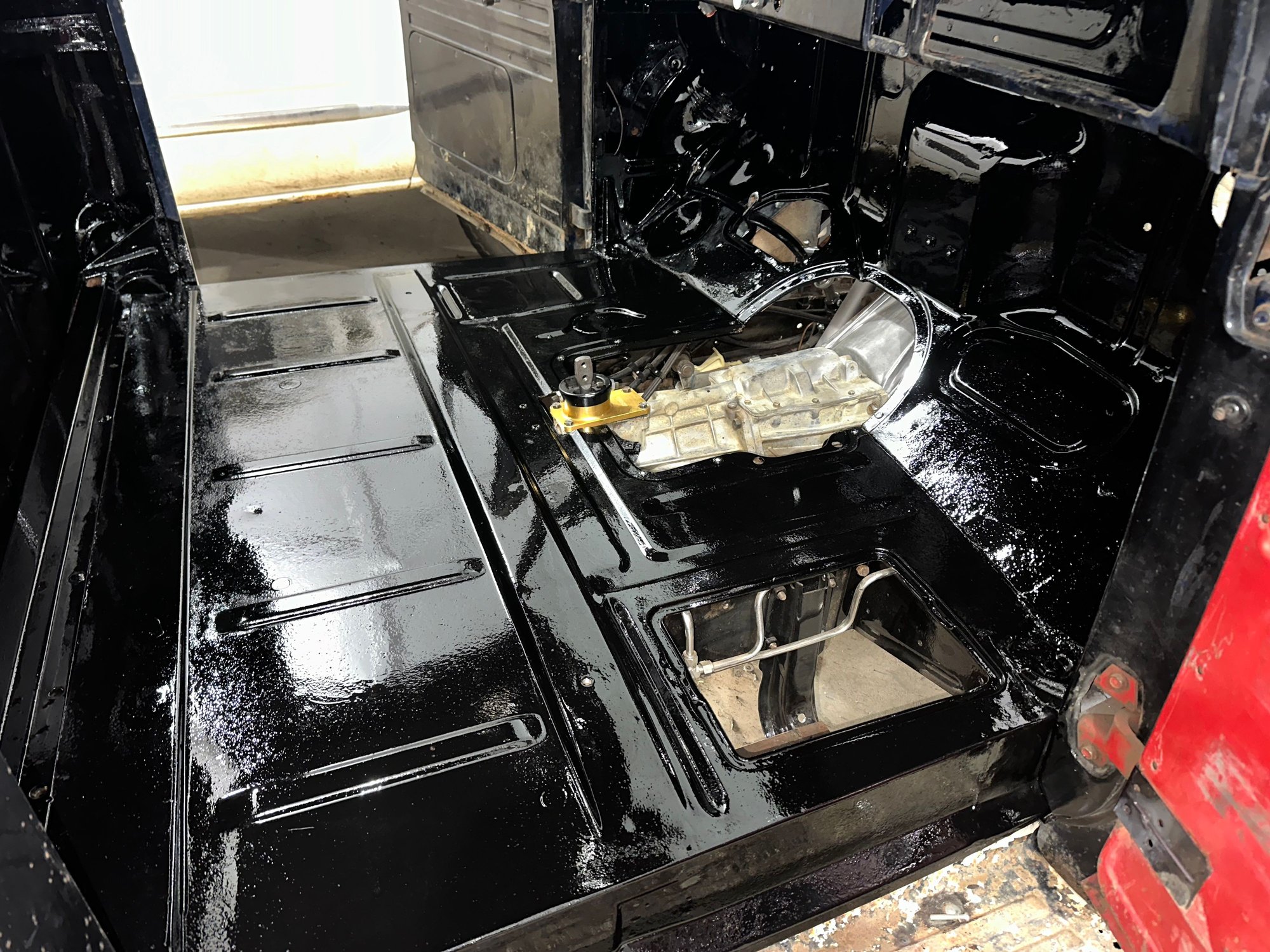

Slow going. Painted the inside of the cab with POR 15 and laid down some sound deadener. Need to order another box to finish. What a difference this stuff makes.

Cab is finished for sound deadener. Just need to do the doors now.

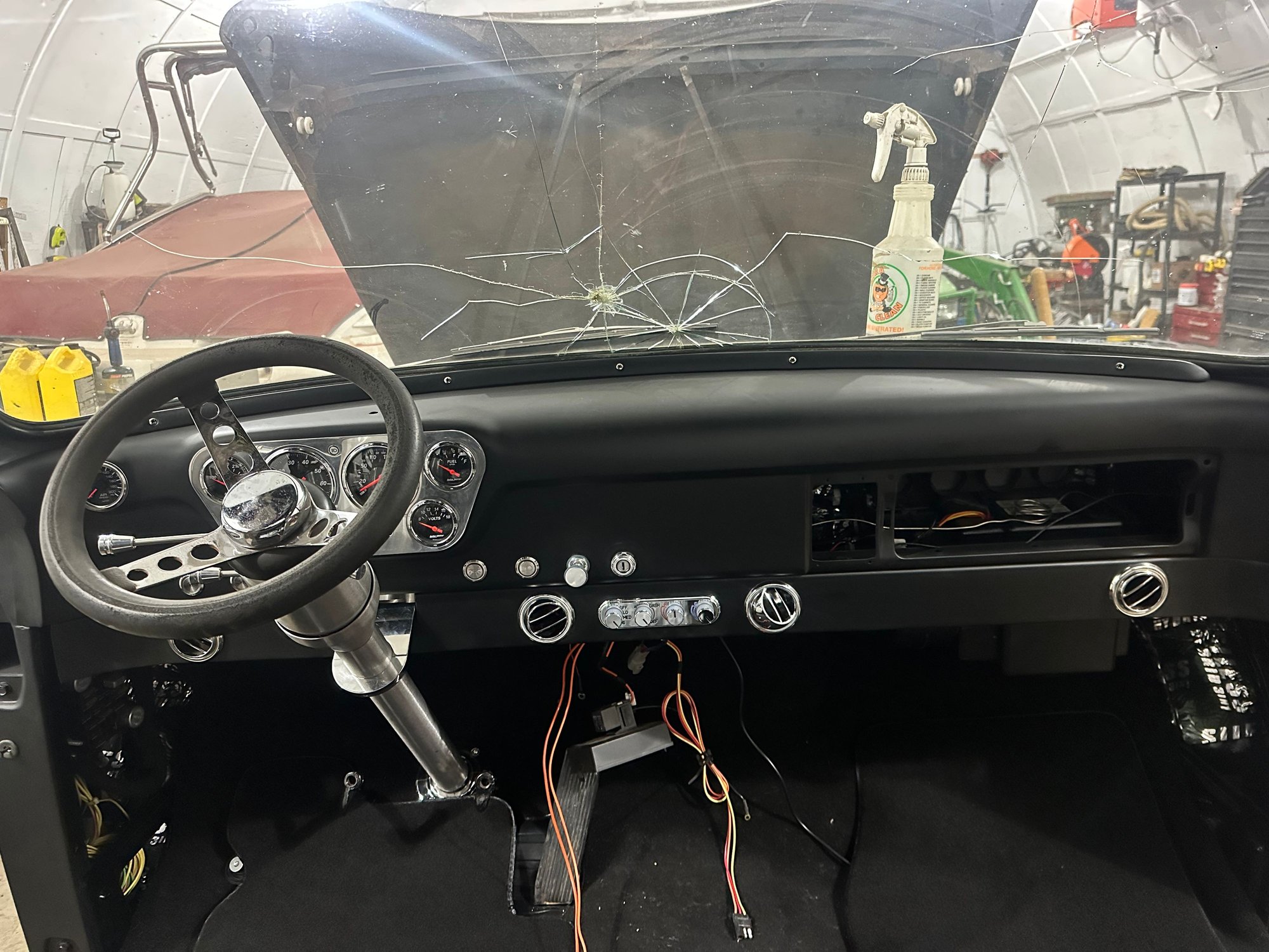

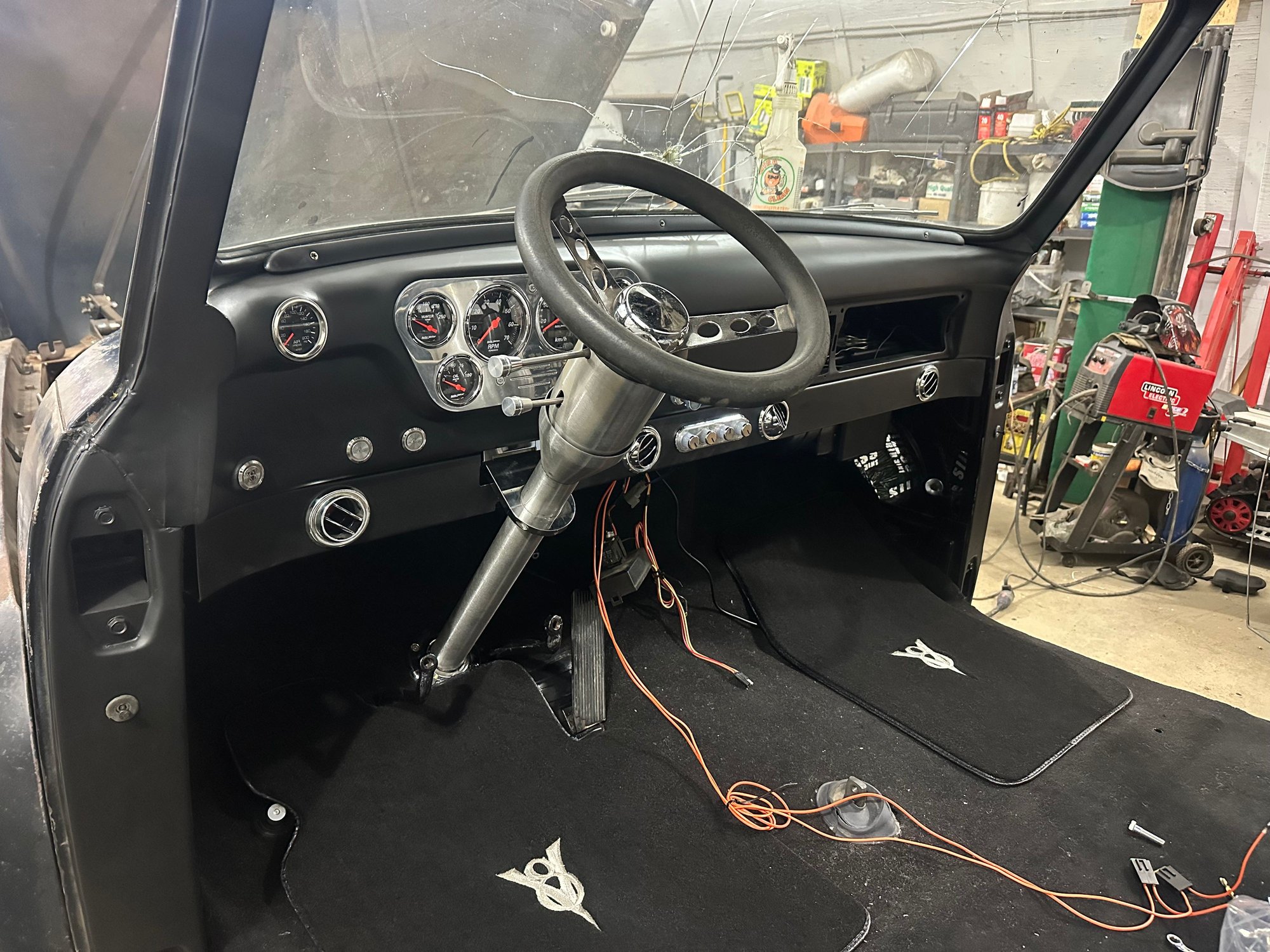

Finally got the flat black dash done. Now I can reinstall my wiring harness, dash extension, carpet, seats. And hopefully get a new windshield

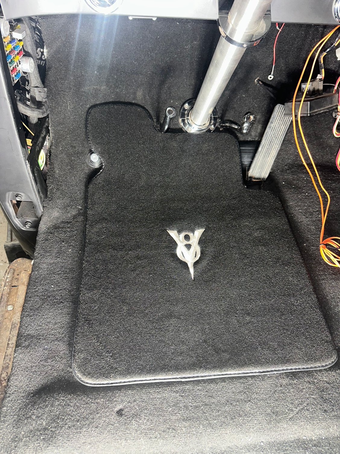

Slowly progressing. Took a week off to go to Germany and then a long weekend to go ice fishing. Back at it when I can.

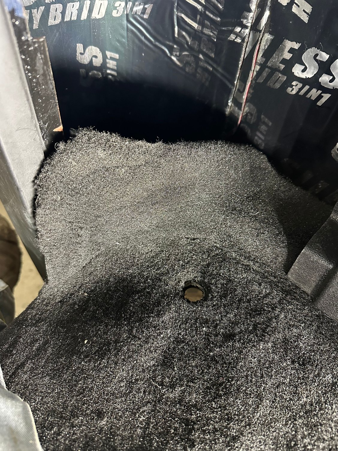

Fitting the carpet, and all the other interior stuff trying to put it all back together now. Need to find some door sill plate to hold the carpet edge down. maybe something around the pedals at the carpet to make it look nicer. And I’d like to get new pedal pads.
Waiting to hear back from ACC about the driver floor mat as it doesn’t fit.

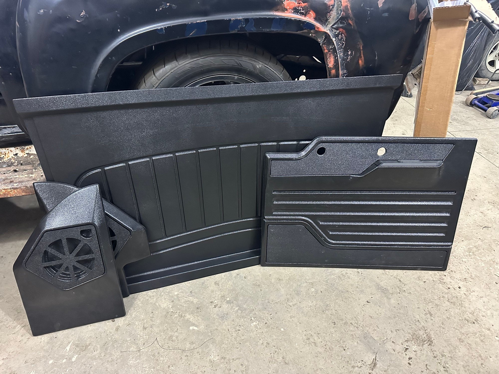

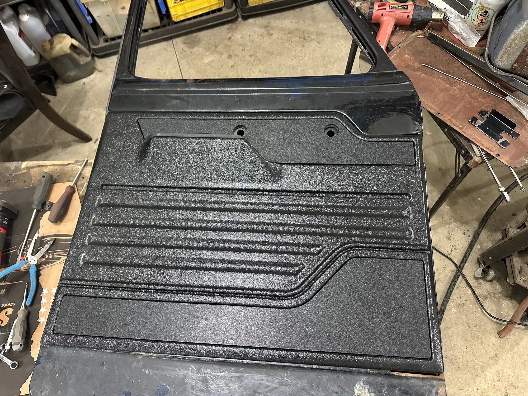

My parents finally made it back from Arizona and they drop back with them my rod doors, headliner, and back panel, and Sew Cal rods door and kick panels
Nice looking door panels, are the plain ABS panels any better priced than their upholstered panels..?
Old Mar 20, 2026 | 02:20 PM
  #374
fullyford's Avatar
fullyford
Joined: Aug 2003
Posts: 427
Likes: 141
Yeah there’s a big difference in price from plain to upholstered. Even just playing ABS they’re still fairly expensive compared to Rod doors, but they’re completely different style and they have a built-in grab handle which I kind of wanted.
