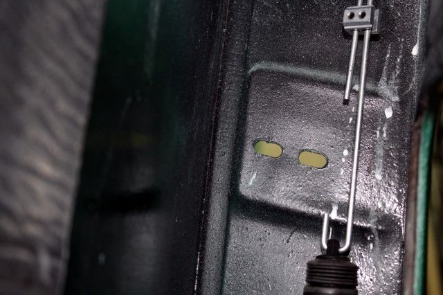

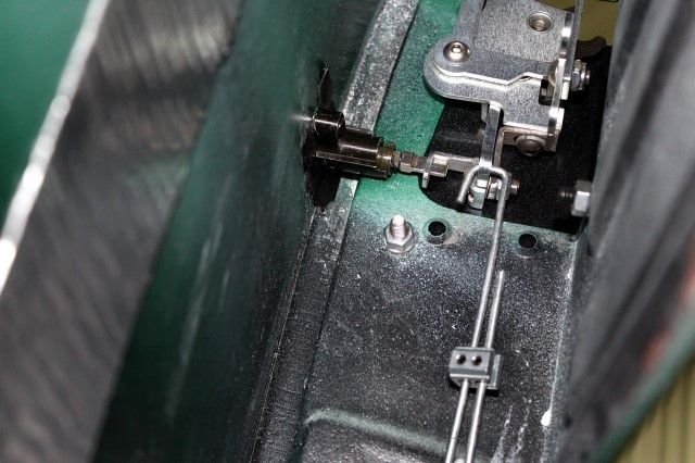

I figured since I have the doors off right now it’d be a good time to try and install these power door locks to go with the Altman easy latch. Has anybody done this before?
The throw for the lock switch on the latch is very very short compared to the throw on the actuator. Just wondering how you guys installed these

To bad you hadn't posted this earlier ,I had the Altman latch with the actuator out yesterday because the latch wasn't functioning properly but here are some pictures of when I put them in my pickup..
They work perfectly fine. I used the Watson's Street Works remote system which has a very strong signal..https://watsons-streetworks.com/prod...emote-control/

Is there any issues with the longer throw of the solenoid compared to the very short throw of the Altman lock switch
it looks really simple and straightforward.
how did you route the wires through the doors.

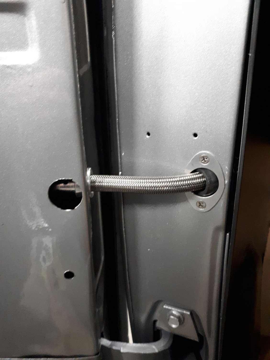

No issues regarding the throw of the actuator and the lock switch..
I used these SS braided wire looms to route the wires .I'll take some pics of the finished results
https://www.julianos.com/SS-Braided-Wire-Looms-for-Suicide-Doors-p/ju94202.htm?srsltid=AfmBOoo5k_XNjPyaNkvFrZFkKAW1Tm 0FfThlmMO_coJRlqY1a_zNbyUv
