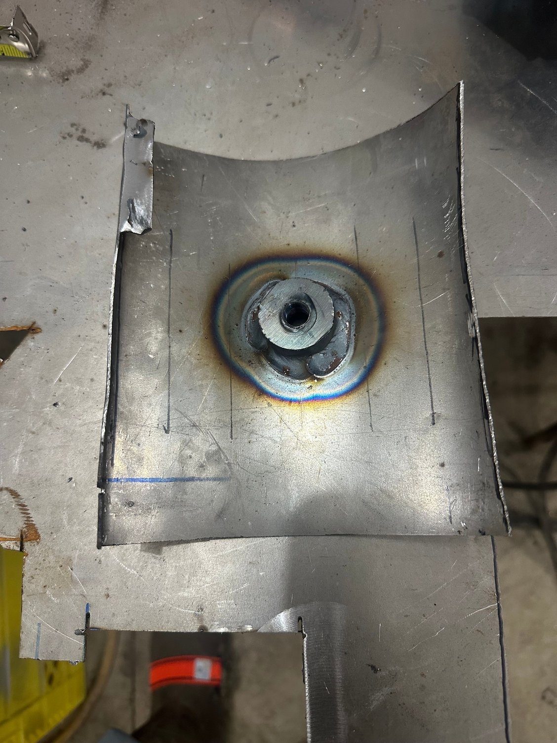

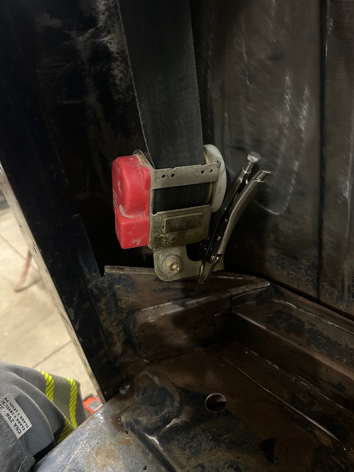

I figured before I put the sound deadener on the floor. I should maybe do some seatbelts. I kind of copy John’s design a little bit, they are a little smaller than the ones that you would buy. I’m not sure where to mount the lower retractor because I would like to purchase the ABS back wall cover and not sure how that’s gonna factor in
That’s one option going on that lower brace
The other option I was thinking was halfway up the wall on this brace
Old Jan 15, 2026 | 09:40 PM
  #358
56panelford's Avatar
56panelford
Posts: 283,968
Likes: 8,394
From: northwestern Ontario
I mounted mine on the floor in the corner in my pickup and the one I'm doing now..the pickup has the Rod Door interior
Old Jan 15, 2026 | 10:04 PM
  #359
fullyford's Avatar
fullyford
Joined: Aug 2003
Posts: 427
Likes: 141
Wouldn’t happen to have picture. I pulled these belts out of the Mustang parts car, so the retractors have no cover kinda ugly lol. Not sure what I’ll do about that.

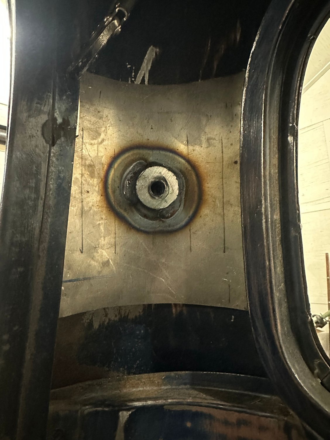

I've been looking but haven't found one yet..you can see the anchors on the one I'm doing now in this picture..
