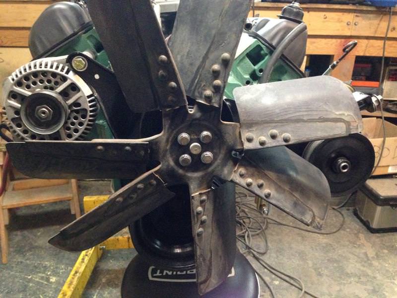

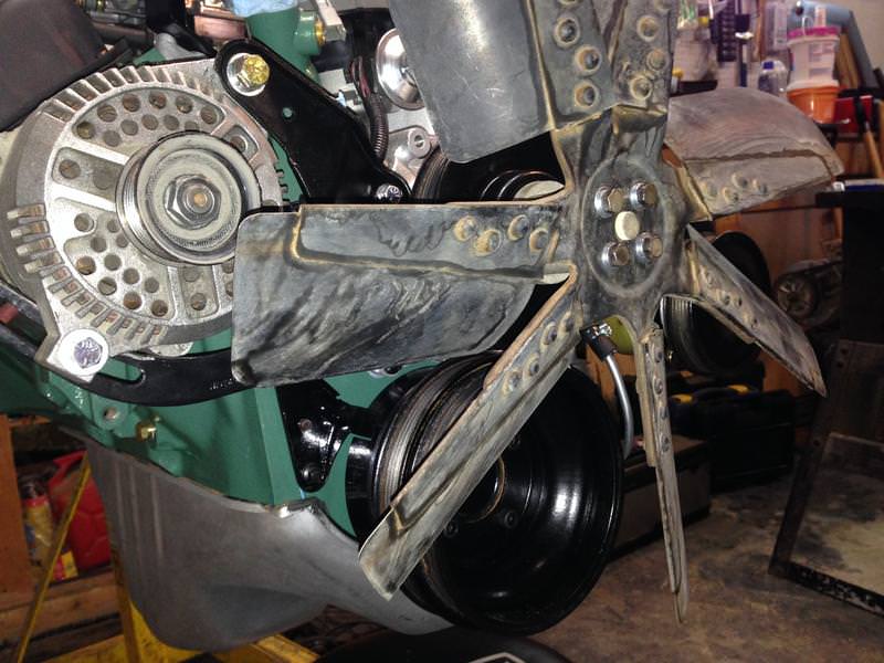

Mocked up the last of the items... The only dirty part on my motor is the fan - LOL my eye is almost twitching as I write this.
Attachment 285574
Someone requested what the pulleys and serp set-up looks like. Here ya go!
Attachment 285575

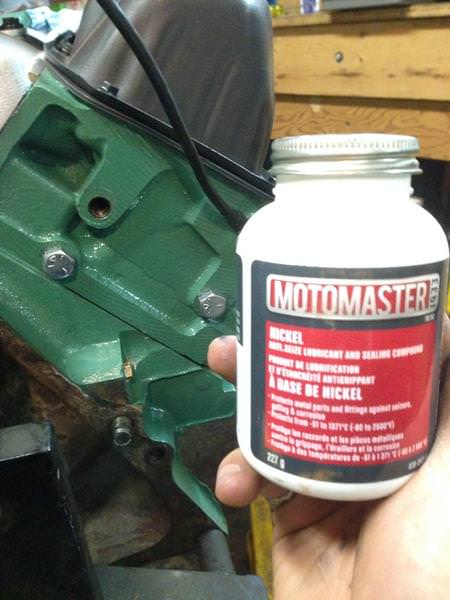

Chased the remaining unused threads on the block with my 7/16 tap. Nickel anti-seize used on all of the blind holes + a short bolt to keep crud out. Preservation of my work

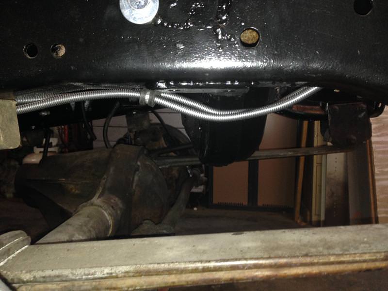

Tossed some rock-guard onto my transmission lines. Stainless steel 5/16" lines, and also stainless steel 3/16" for the brake lines (not shown).

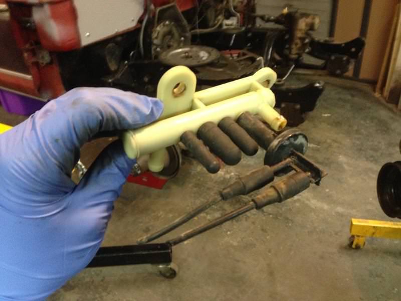

Found this gem at the junkyard and thought I'd give it a go. It's a firewall mounted vacuum tree. Easier access and cleaner mounting than the old vacuum tree. It's off the same 1984 Crown Vic that I stole all my pulleys off

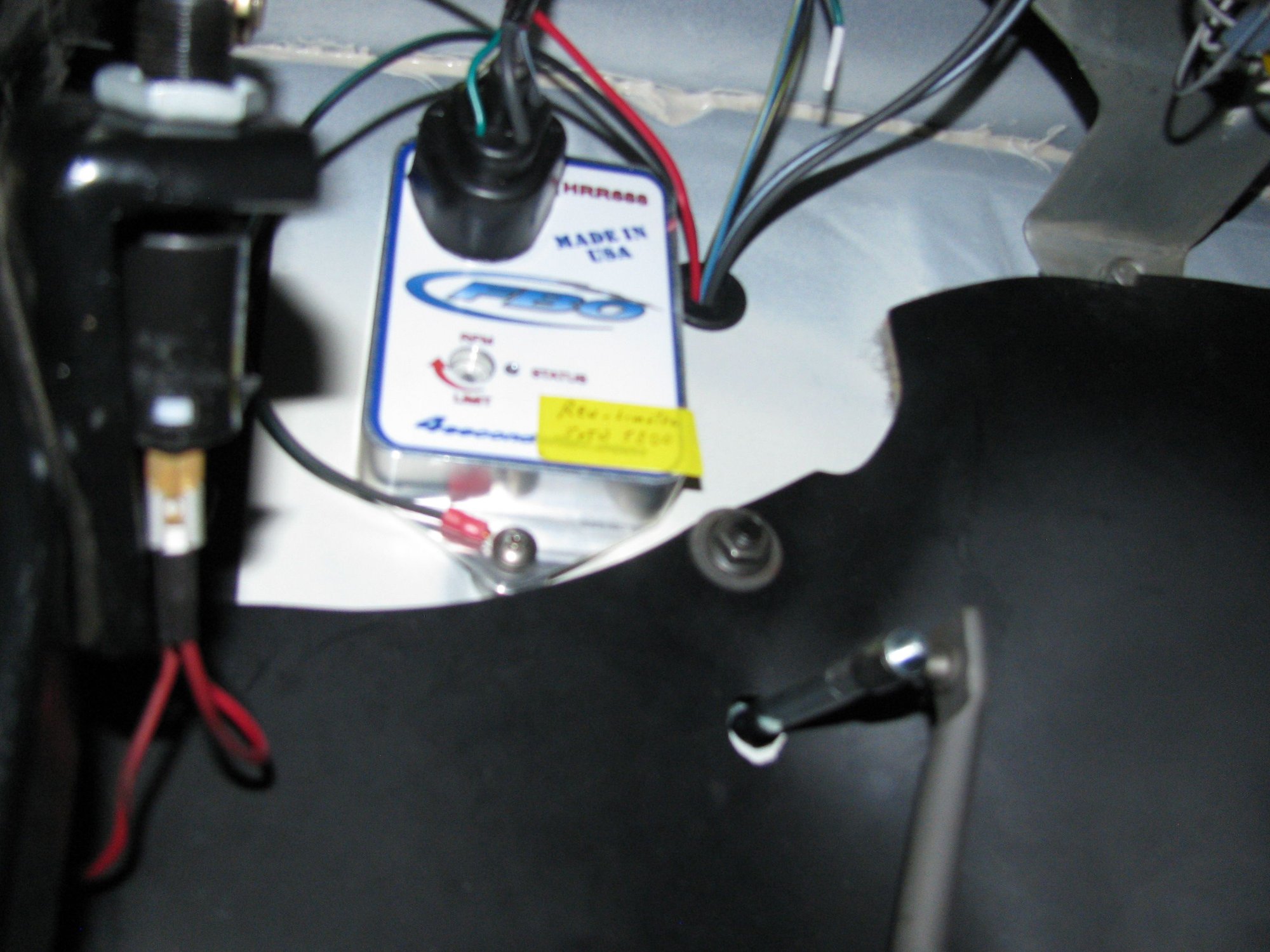

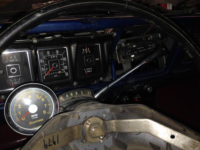

Got an old Accurtronic tach for $2 at a garage sale. Drove off laughing like I stole the darn thing lol.

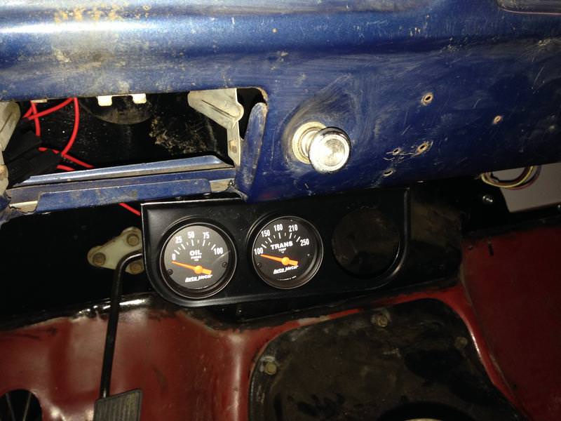

Oil pressure and trans temp mounted, wired, and ready for start-up. It's all fused, but I'm still figuring out the backlight wiring... Any suggestions on where to tap into the headlight switch is appreciated.
Attachment 285580

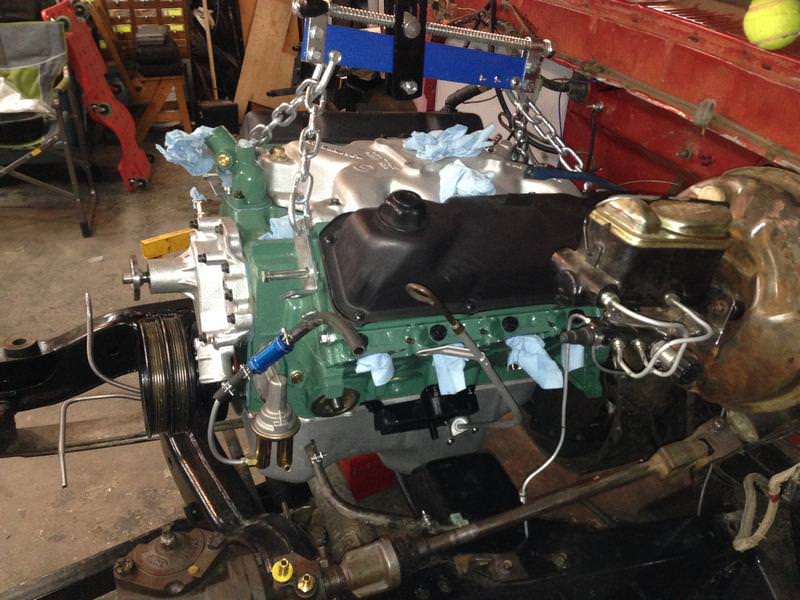

Pulled all the stuff off the motor and prepped the frame for accepting the 408
In, but I had some issues that are unresolved. Driver side of the trans won't accept the block 100% flush... maybe some crud in one of the dowel holes? Need to investigate further.
Attachment 285573
Attachment 285581
Getting closer!!!! More to come.

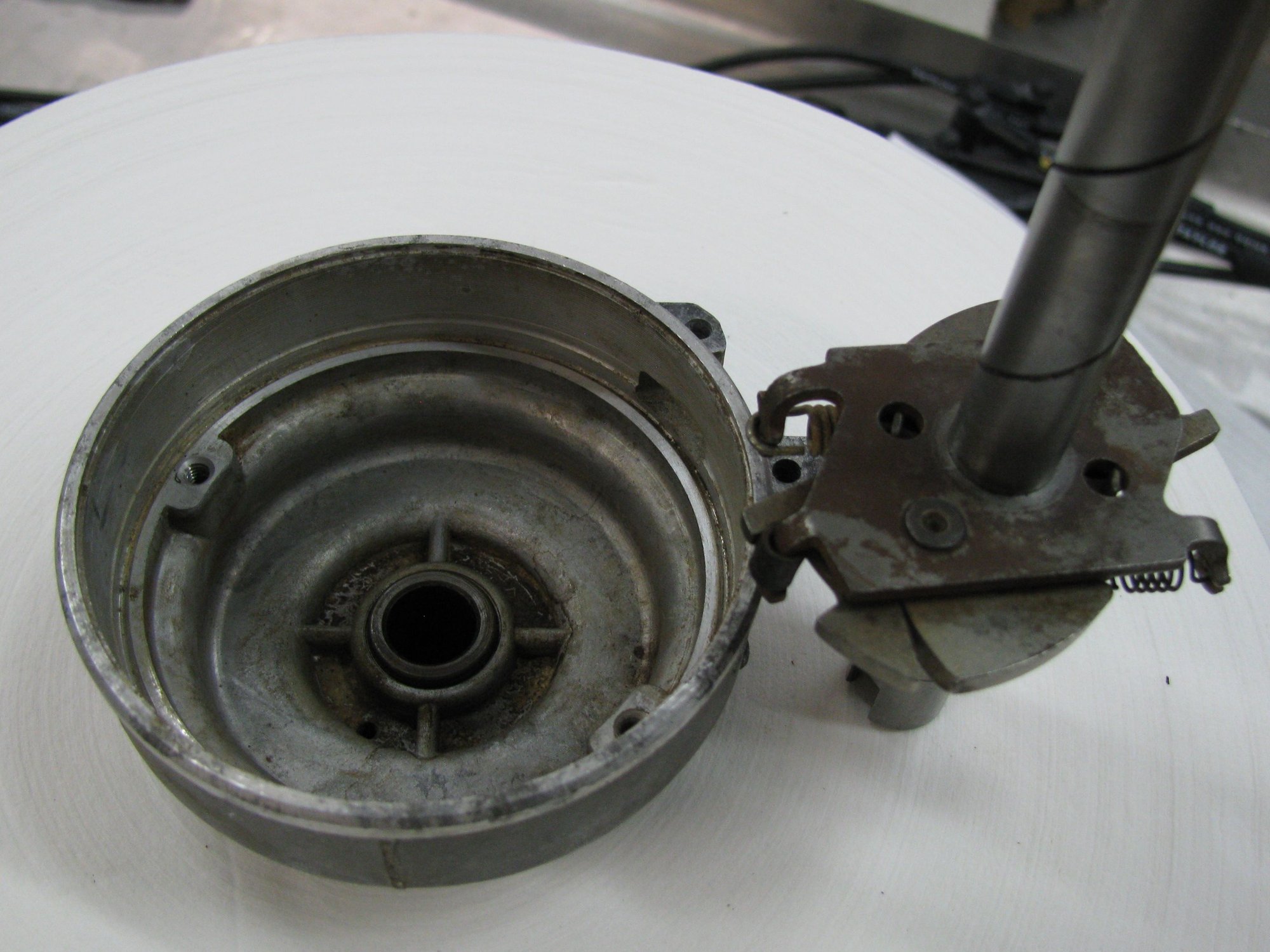

EDIT: Checked the clearance on my distributor gear - thanks for posting that Crop Duster!
Clearance showed 4.026" when fully elongated. It doesn't meet the 4.031" (minimum) measurement shown by Crop Duster... but I'm not so sure that I really care about 0.005" of difference. To eat up that difference, I would have to put in a TON of work getting the pins punched out and adjustments made to the dizzy... all for a hair width. What do you guys think? I should be fine... right?

You'll be fine with the distributor. That 0.005" is perfect to allow oil to get under/around the gear. Lateral gear movement should be at a minimum, and you'll still have some play. Hope you put a dollop of good goop all over the gear - top and bottom, too - before you stabbed it.
Not to worry.
You're doing a great job on your engine and it seems you have been very careful to get things just right. And now you are going to use a Chinese distributor that is not made correctly? Here is a picture to show what's going to happen with that gear on too short. The distributor shaft is going to pull down hard against the bushing in the housing because that bushing is now having to do the job that the pad in the block is supposed to do. Those shafts don't get much lubrication in the best of times that's why they have those spiral grooves in them. If it sealed of at one end you won't get any oil up there at all. Like I said before I gave up on all that Chinese, Mexico stuff just for that reason. I know it's a lot more difficult for you guys in Canada to get what we can get easily down here but before you run that give this guy a call. I run his ECU instead of the Duraspark. In fact I've been using Mopar boxes with my Durasparks for the last 25 years. They are primarily Mopar but they do Fords also. FBO Performance Ignition for all Makes, Muscle Cars, Street Rods, Race Engines. Specializing in Mopar Ignition Products, Distributors to Computer control ECU's. Home of the HRR688
Very interesting stuff.
So you're running a Duraspark II dizzy with this guy's ignition box and this coil. Plug and play? Or did you have to do a bunch of other things as well?
Just as a side note - I'm not sure how running a Duraspark II with this guy's box and coil will solve the problem of having less clearance than needed based on Ford specs

I'm not saying his ECU will solve your problem. But he and a lot of other folks in the distributor business can put a distributor together for you that will be curved to suit your engine and be within the correct specifications. I don't know what he charges for a complete ready to run distributor, but I'm pretty sure he charges $100 to recurve a distributor to suit a persons particular engine, cam, headers, carb, compression etc.
The Mopar ECU's aside from being better than the Duraspark are compact and only require one plug. I mount mine inside the vehicle on the cowl, no heat, no moisture.

That tachometer is going to pay for itself when you are running in the cam. And the install looks good.
There should be light wiring going directly to the dash, which is nice 'n near to your gauges and tach, so you could tap into that one.
I have no idea of the wire colour, but it should be easy to determine.

Some progress on the weekend. Back hurts from all the up-down, but it was worth it.
Found my issue with installing the motor. Opps lol.

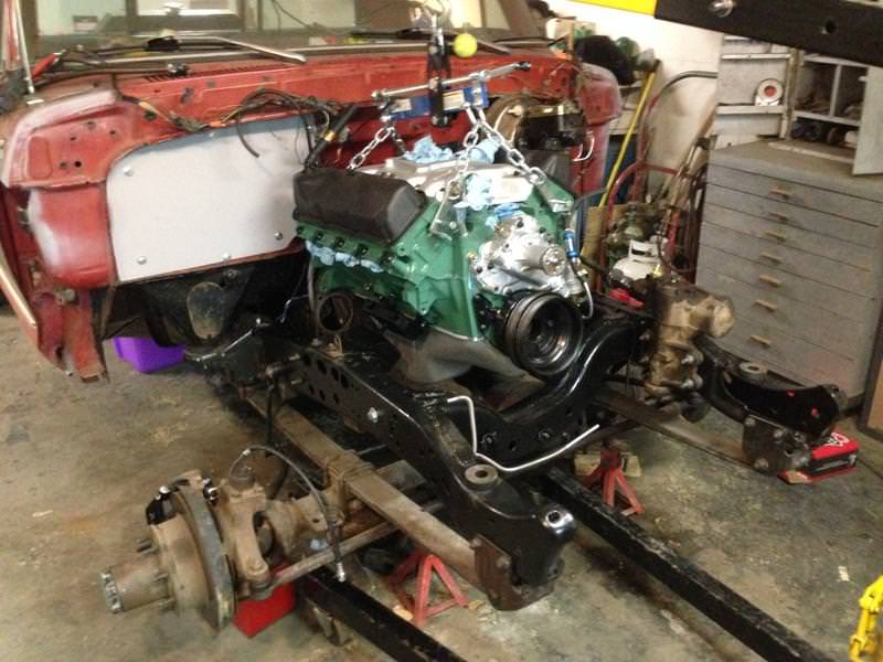

Motor put back to 13 BTDC after 2 full rotations (and my finger blew off #1 cylinder). That's the LAST time I'm turning that thing over by hand. Starter installed shortly after.
Distributor installed (back on its mark and lined up with #1 Cylinder). Carb installed. Pressure regulator installed. Ign coil installed. Headers mocked up, then installed with Nickel Anti-seize + Stage 8 stainless locking header bolts. Torqued to 22 ft-lbs. Driver side was a HUGE PITA with that dipstick tube and the brake lines and the steering shaft. Had a helper, so it went alright. Still lots of up-down from under the truck to get it all in place.
Attachment 285532
Passenger side was easy peezee lemony squeezy. Carb installed and other components, including my ign wire set.
