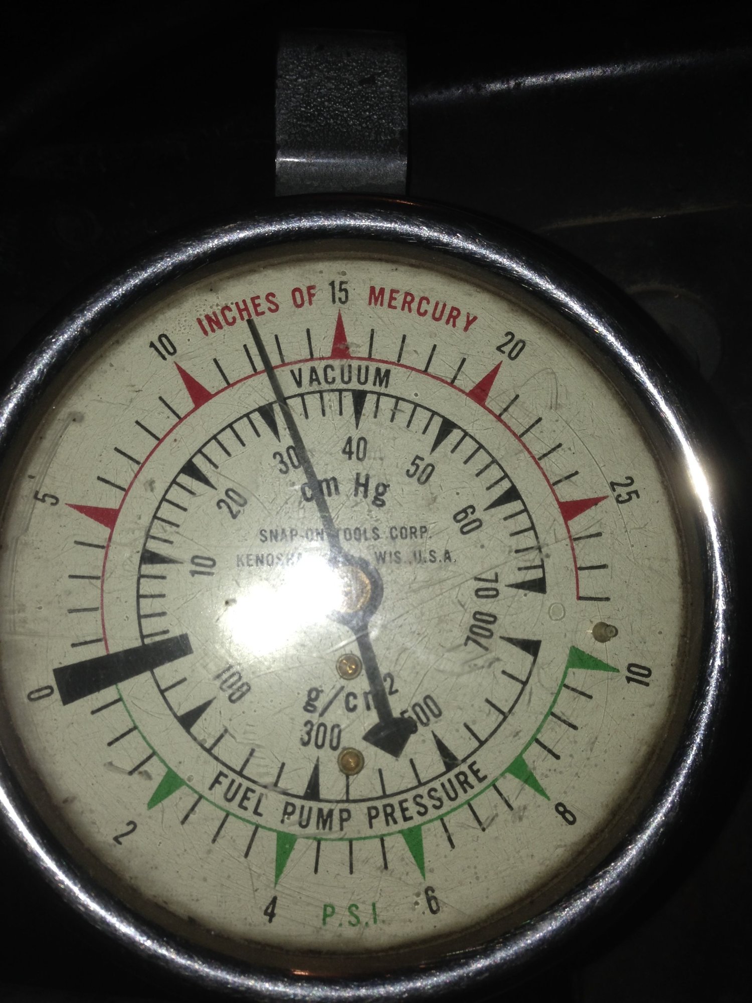

Checked vacuum, pulling 14 Hg now instead of 15.5... hmmmm....

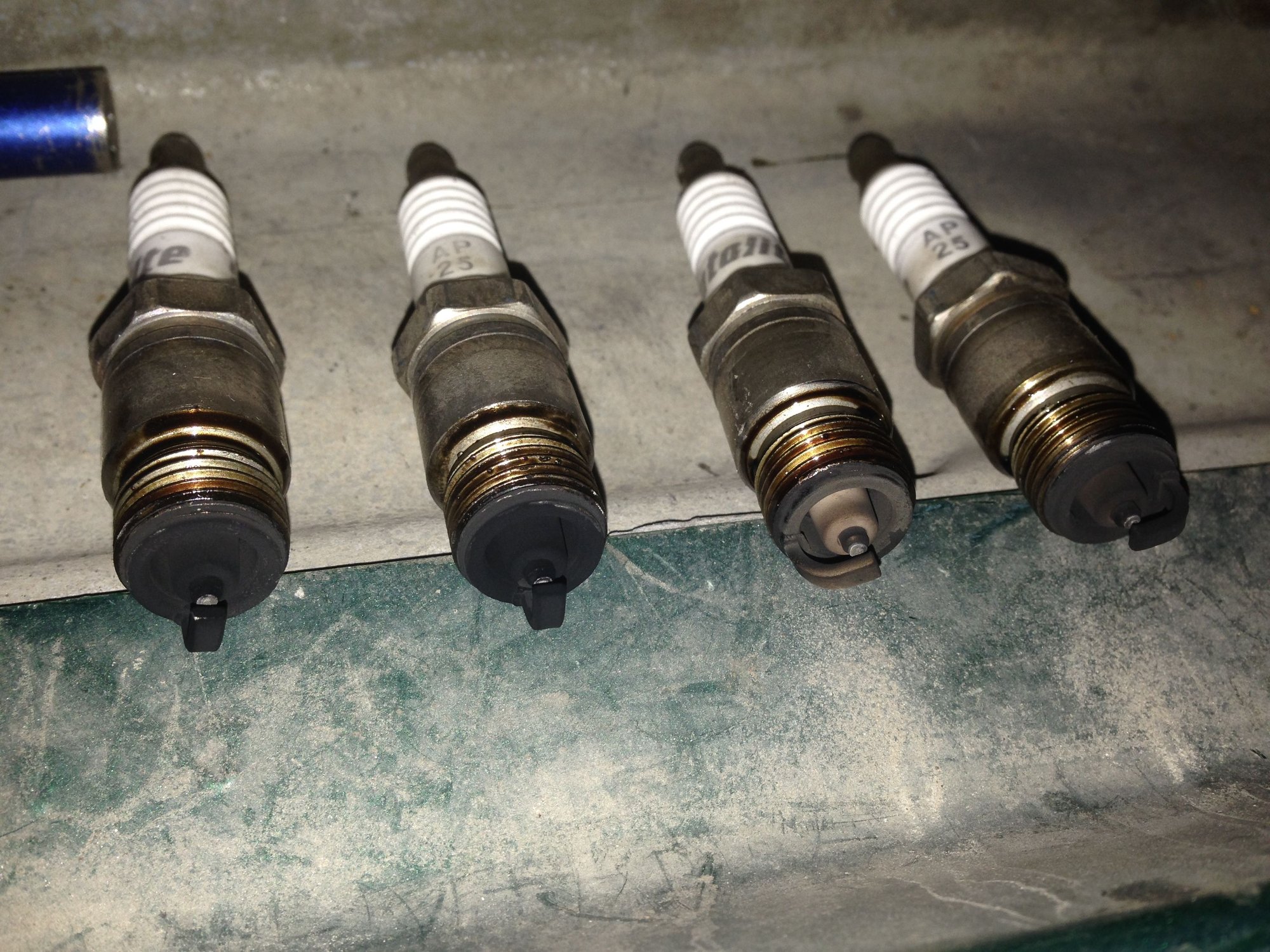

When I pulled the spark plugs... holy moly... 4 of 8 were solid black soot, the other 4 were showing signs of a better burn (pics coming tomorrow), but all of them were oily on the threads. Cleaned them up with a rag, threw on dielectric grease on the threads and reinstalled in all the same cylinders.

9) spark plugs should get replaced??? Once you see the photos you might agree with at least 4 of them lol.

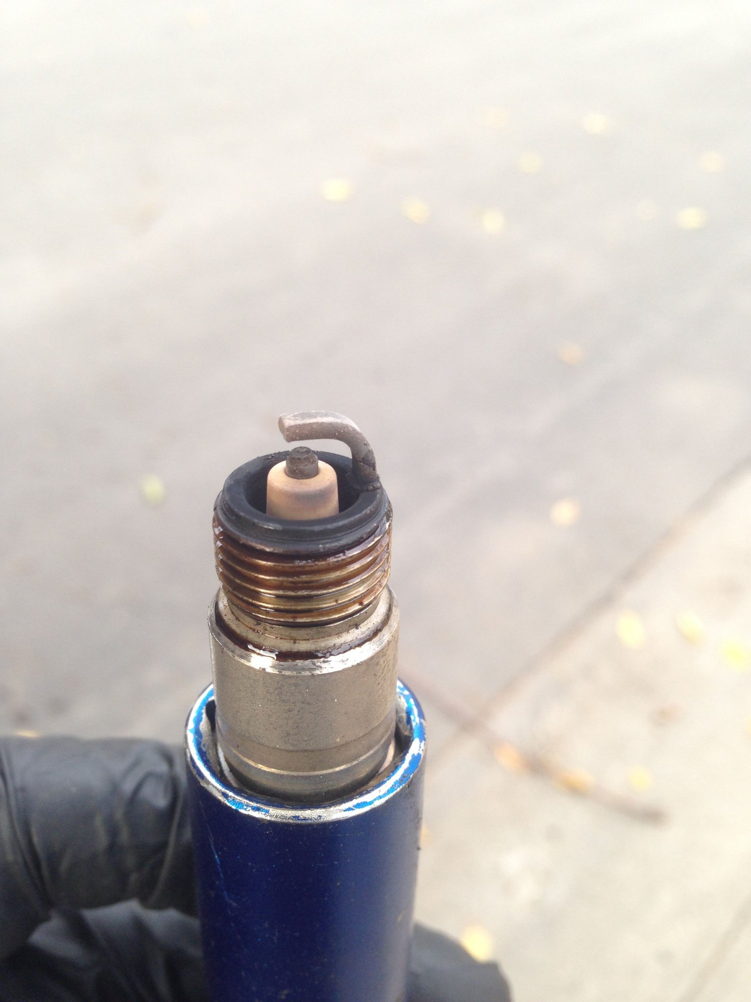

I forget what oil on plug threads means, but have a good look at your plugs.
If they have a washer (or something like that) they need to be torqued to a specific torque.
I never used to, I would hand tighten them, then 1/4 turn, or whatever it is, and it was about 1/2 turn too little compared to correct torquing !

What was the vacuum gauge needle behaviour like ?

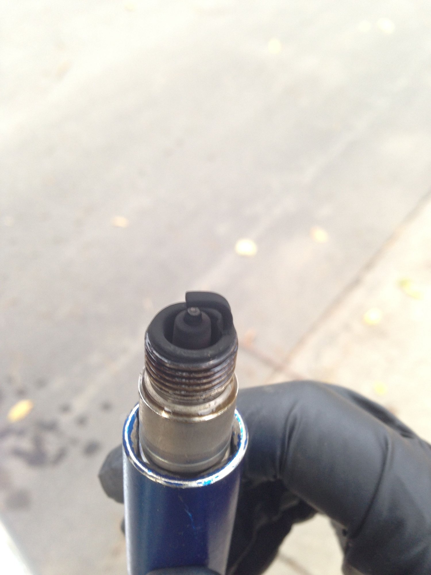

I have not pulled the plugs at all since I broken in the motor (they have no washer, so I just tighten by feel) - overheating, playing with timing, and having a stooopidly rich mixture is likely the cause of the plugs looking like this (time for new plugs methinks? What does youthinks? Lol):
Cylinder #1
Cylinder #2 - surprisingly looks normal even though this is the same cylinder with the "tick"
Cylinder #3 - looks even better than 2. No tick from what I can tell.
Cylinder #4 - black and sooty.
Here are Cylinders 5 through 8 (left to right).
Pulling roughly 12" of mercury.... Needle was VERY Steady. Every 20 seconds or so, it would move a hair left then a hair back to where it was. Any movement the needle DID have was not constant or consistent - overall it was basically dead steady.
Gauges - oil pressure sitting at roughly 37.5 psi at hot idle. Temp gauge was at 130*F on the water pump, and below the "N" in "NORMAL" on the factory gauge.

I had recognised that you had leaned out the carb, as was evident with the vacuum drop.
But the plugs say otherwise !
To be honest, reading them at idle is not a fair reading.
What did you mean by this? I leaned out the carb because the exhaust stunk SOOOOOO badly that there was no way I wasn't running rich. When I pulled the plugs, it confirmed that I was running VERY rich (black soot).
Leaning out the carb will give a vacuum drop, but by 2*??
I use dielectric grease on the plug tips where the cap clips onto, but not on the threads (not needed).
If I were to use anything on the threads, it would be copper slip (anti seize).

Initially I thought that you had set the carb to a lean idle, and 'assumed' (oops) it had been lean for a while, so didn't expect to see 'too rich' plugs.
I didn't realise the extent of the rich mix until you mentioned the strong tell tale smell.
Ok, the plug colours are probably misleading at this stage as they reflect the end of a rich mixture and the start of a leaner mixture.
That said, don't get new plugs just yet as several of the ones in the pictures show heat range issues. (No surprise at all, and predicted in post 136 or 141.)
Let's say you used to tighten the plug finger tight, and then give it 1/8 turn.
Do that again with a plug, then torque it. It might end up at something like finger tight, + 1/8 turn, + an additional 1/2 turn.
Not being torqued might be the reason for the oil on the threads.
You'd mentioned crud in the plug holes in post 130.
I assumed these were thoroughly cleaned. Hmmm, yet another assumption. LOL

Since I had all the spark plugs out, I put them back in with a torque wrench this time. WOW, I WAYYYYYYYY over-tightened them last time. With a torque wrench, it's basically equivalent to finger tight + 1/32 of a turn. I was doing finger tight + 1/2 a turn... Whooops!
Fired her up and I gained back some vacuum where it now sits at 15 inches of mercury (was at 12).. still not high enough... Needle is still dead steady on the vacuum gauge.
I leaned out the carb some more, found that I was still roughly 1 turn out too far on both A/F screws.... Followed the Eddy Carb Manual to the T and I think I finally achieved the best "lean idle state":
