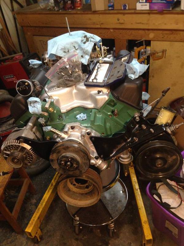

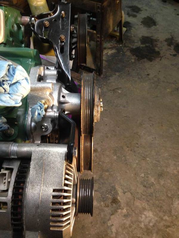

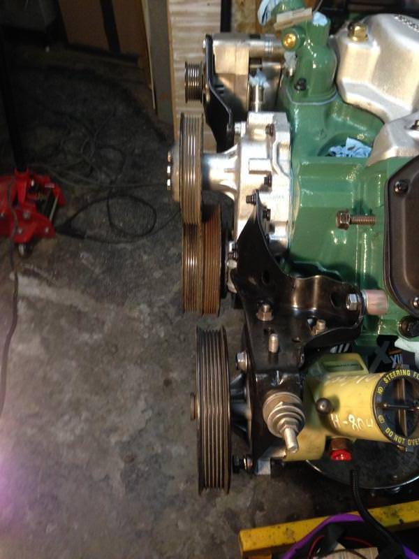

Can't help but give a small update. Nothing is finished, but I haven't started cutting, grinding or measuring anything just yet.
I wanted to do a detailed write-up with part numbers, pulley diameters, assumed operating speeds, measurements, the tools I used to get the job done, etc...
The big question I wanted some opinions on.... does anyone see an issue with running serpentine belts without tensioner pulleys or idler pulleys?
Front.
Attachment 285952
Passenger side.
Attachment 285953
Driver side.
Attachment 285954
Power steering system is out of alignment, but it'll be straight when I'm done. Don't worry about the stacked washers, or the alignment issues for now. What I'm more interested in is how running a dual serpentine belt system without tensioners and idlers will affect the performance/quality of the system.
Old Mar 8, 2018 | 12:36 PM
  #180
Filthy Beast's Avatar
Filthy Beast
Joined: Mar 2011
Posts: 2,698
From: Taxachusetts
Hey Aaron...
I applaud your desire to record stuff to the last detail....
The serpentine belt question: Will you still have the ability to adjust the tension on the belt(s) the same as if you were running V belts? If so, I wouldn't worry about it. Those tensioners are there to do just that...keep tension on the belts when the pulleys, etc, are locked with no adjustment, as you well know.
