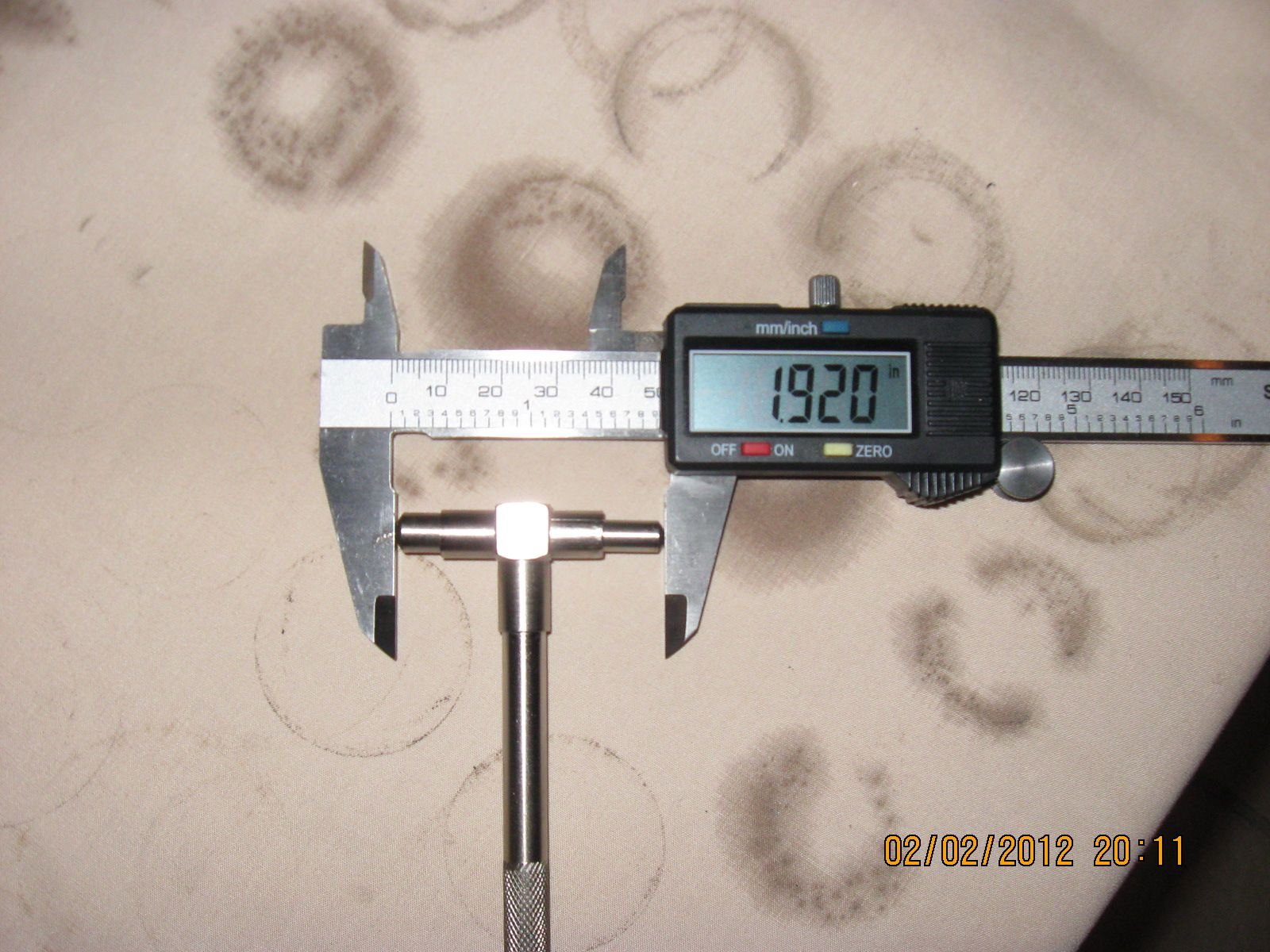

Checking spring settings is p$ss easy, so don't stress.
These 2 pics show how simple :

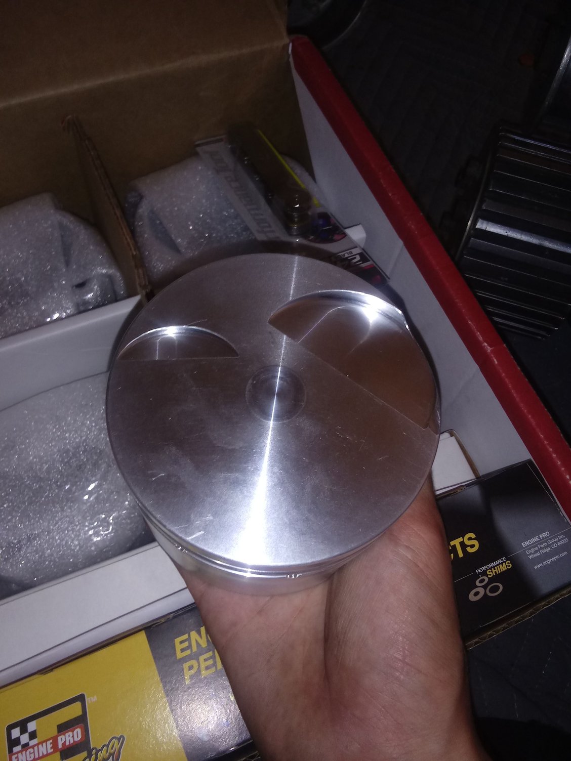

yes that's a hole in the head and a piece of a KB2347

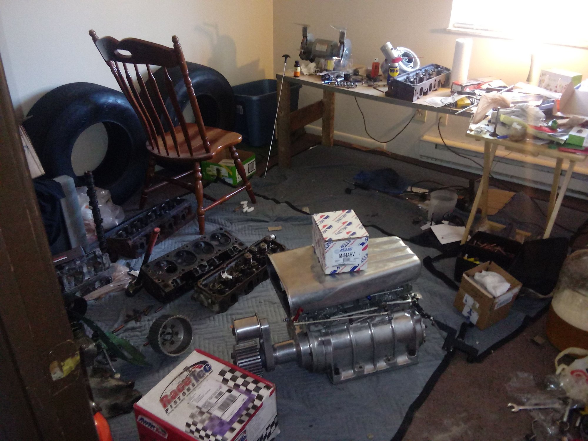

this is the current status of my build. Probably going on back burner as I'll be switching jobs soon
