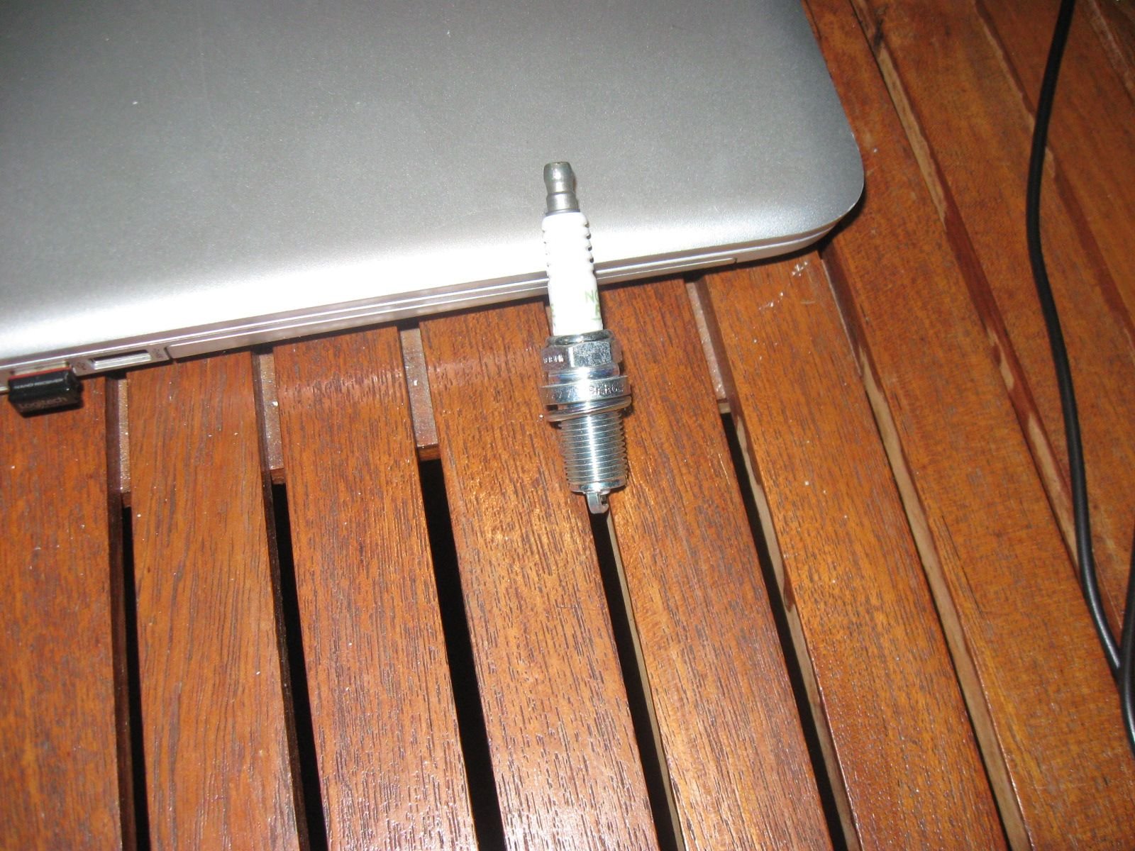

I didn't expect you to say that you'd been over tightening the plugs.
On that subject, here's a pic below of the NGK plug I use. Note the washer at the top of the thread.
I never reuse one of these plugs.
My plugs do not have a washer on them - the plugs I installed (and the ones that are still in there) are old-school Autolite 25's. I purchased a new set old-school Autolite 25's just in case I want to switch over once I figure all this vacuum crap out.
