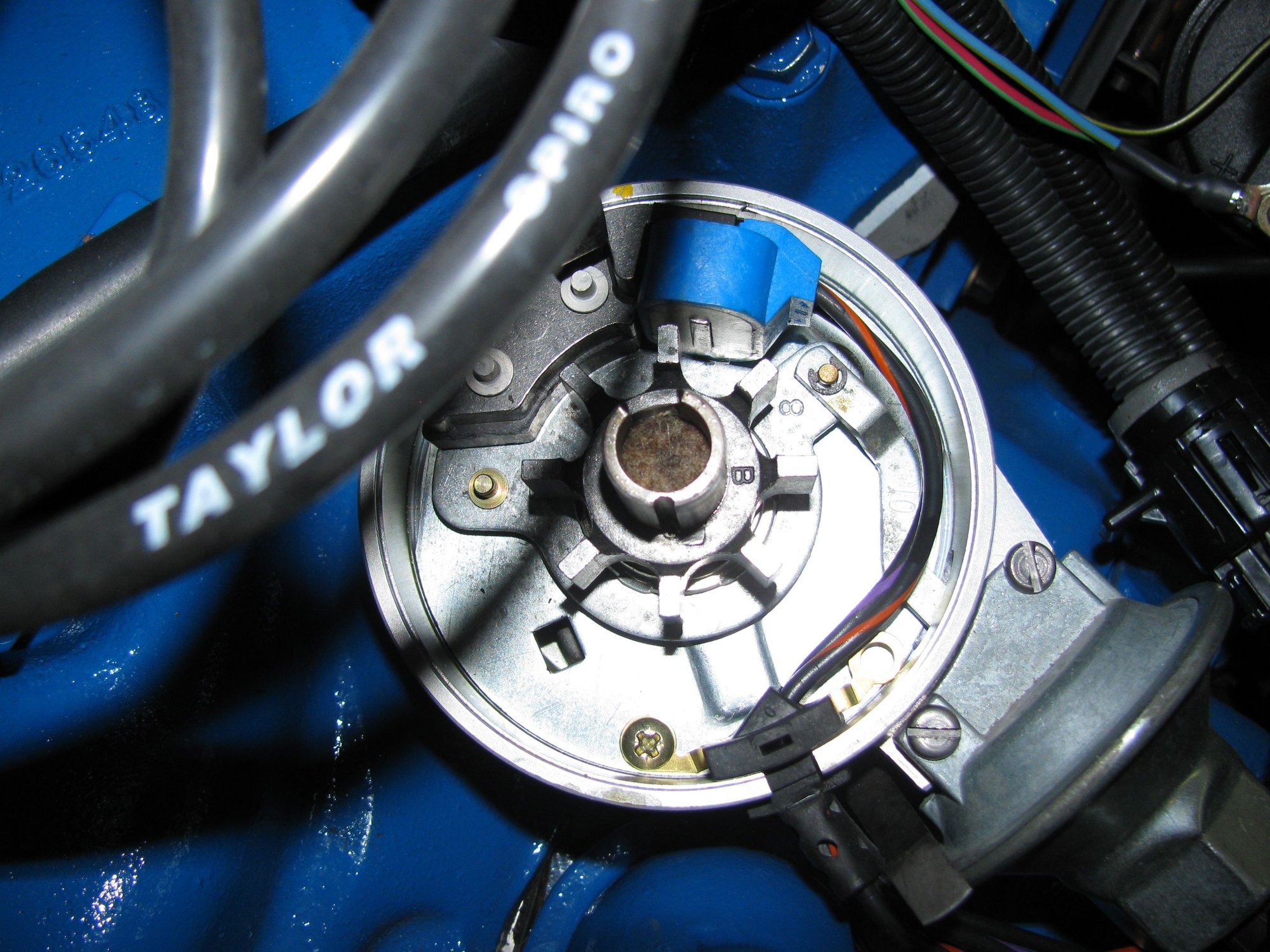

So I'm staring at my distributor last night and noticed something that seemed off.
I pulled the dizzy cap, and the reluctor wheel isn't 100% dead center with the magnetic pick-up. Approximately 50% of the reluctor arm width is in line with the pick-up, but the other 50% of the reluctor arm is sitting before (count-clockwise rotation) the magnetic pick-up.
If I have everything properly aligned (like in my last few posts), the motor is 13 degrees BTDC, Cylinder #1 is definitely on the compression stroke (blew my finger off when rotating by hand with spark plugs removed), and the rotor is pointed directly at Cylinder #1.... shouldn't the reluctor also be pointed directly (dead center to dead center) at the magnetic pick-up?
I never took a photo last night, but you can kinda see it in one of the previous ones I posted.
Dropped the distributor in and seated the oil pump drive shaft after some trial-and-error.
Remember I told you guys I have moments of anxiety? Lol! Bear with me here.

Ahhh, Aaron, don't over think this. You're fine!
The stator's (pick up coil) plate is moveable, controlled by the vacuum advance. If you move the breaker plate (where the stator sets on) it'll move quite a bit, back and forth. Hopefully, it moves easily.
The reluctor does't move...well, it does but in a circular motion with the disrtibutor's/cam gear.
If you want to "fix" it, or make it more pleasing to your anxious eyes, move the breaker plate such that the stator's magnet is in line with a reluctor tooth.....but it'll move back some due to the magnetic field around the tooth....even with the distributor stabbed in correctly.
If you're so inclined, you can measure the gap between a tooth and the magnet.....you'll want to see 0.018"...
Got insomnia yet?
Don't rush to get the engine in and fired up....it's good you're going over "stuff" but don't overthink it or second guess yourself....you're doing great with the picture, write-ups and whatnots.
Don't be afeared to ask these questions......'cause I have to come up with a sure fire win on a bet with FMJ......

Excellent info. Trying not to panic LOL.
From what I can tell, the magnetic pick-up being off by 1/2-a-tooth isn't a huge deal - and doesn't need to be tampered with?
I may undo the pick-up and see if I can wiggle it so it's in perfect alignment with the reluctor wheel... but then again, if it's not going to affect performance, I may just leave it alone too lol. "If it aint broke, don't fix it" mentality at this point. When I first saw how it was misaligned, I thought something was seriously wrong.

Duraspark
To set your mind at ease here are a couple of pictures. The first is my 351C set at 11 degrees advanced. The second is the same distributor with 15 inches of vacuum on the advance can. And when you start putting centrifugal advance in the mix they will be even father apart. To check the alignment of the armature and the stator you set the rotor at exact center of the contact on the cap then they should be perfectly aligned. I use an old cap with holes drilled in it to check that before I install the distributor.
