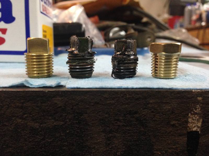

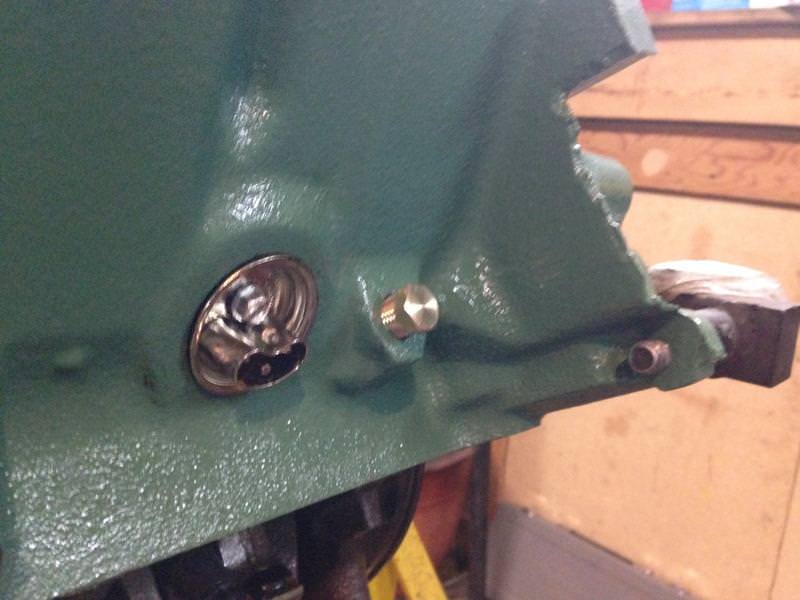

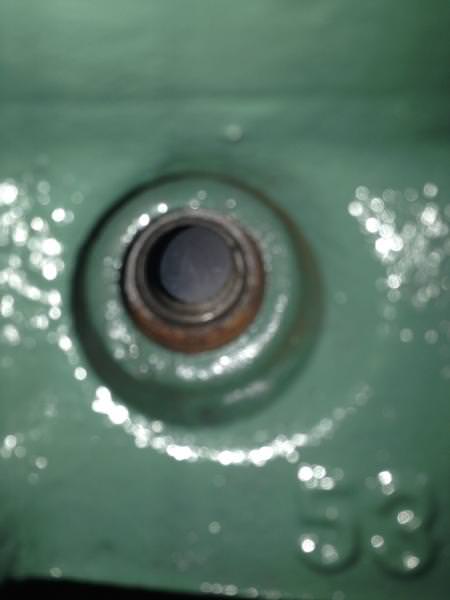

Coolant drain plugs?? Where??? Is that what the square-headed plug is down at the front/bottom of the block on the passenger side?
Old Feb 7, 2018 | 02:11 AM
  #123
FMJ.'s Avatar
FMJ.
Joined: Aug 2016
Posts: 723
From: Cape Town, South Africa
Yes, it's the square headed plugs, of which there are two.
The other one is near the rear of the block on the driver's side.

Ohhh man... I wish I would have known about those drain plugs earlier!
I gotta take those out and replace them with a new plug... Guessing there's a TON of crud in the bottom of the block too.
Magnetic drain plug is a solid idea. I should grab one while I have the chance.

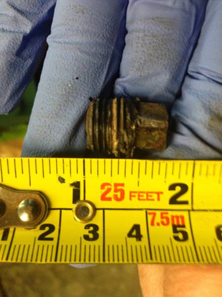

I need to ask a huge favour of you.
When you remove the plugs, can you measure the width and thread pitch and post up the numbers ?
I spent quite a bit of time with Mr Google, and I came up with either 1/4'' NPT or 3/8'' but nothing 'absolute'.
The Fumoto Oil drain valves have good write ups, and I see that one can get locking clips for them also. (As pictured in link below)

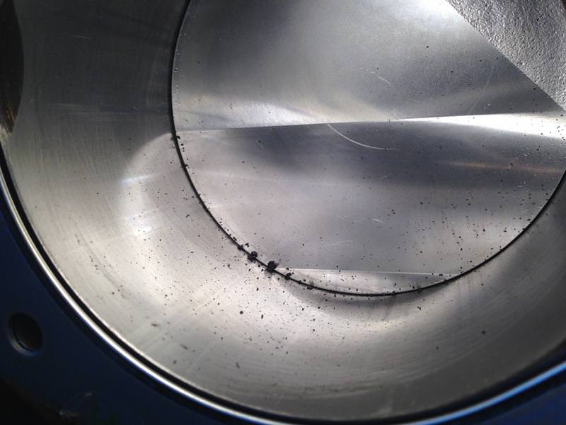

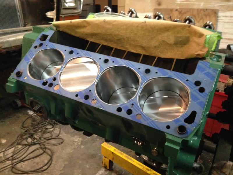

Looking at the pictures I wasn't entirely convinced that your block was thoroughly cleaned.
Hopefully pressure hosing the block via the thermostat hole and drain plug holes will suffice !!

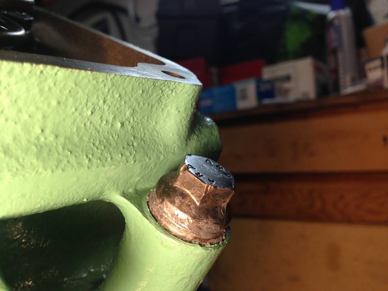

I will certainly post up the numbers when it's all said and done. Not so certain I should be doing it at this point though.
When I think about it, I should have tackled the drain plug(s) before I painted. To get those old plugs out it's likely that I'll need a LOT of heat and a lot of patience.
I'm guessing that if I tried to remove them cold right now I'd snap them off in their holes... Don't want to create problems for myself when I'm this far ahead and I have a fresh motor still open.
We'll see though. If I do tackle it, I'll post up my results.

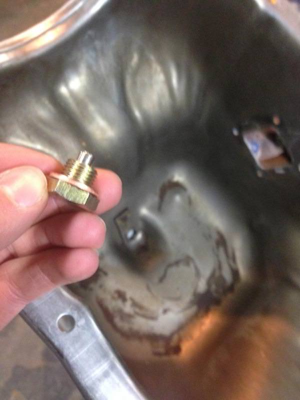

As for the oil drain plug... I'm in luck! I bought a Milodon 17000 1/2-20 magnetic drain plug for my trans pan but never installed it. So it'll go to good use in my oil pan

1/2-20 Straight National Coarse thread. Any standard 1/2-20 bolt could be used as an oil pan drain plug.
^^^ I need to confirm this tonight, but I'm 99% sure it's 1/2-20. Looked up replacement drain plugs for the 400/351M and they all came up 1/2-20.
I'm convinced it was cleaned on the insides... but the coolant passages and the outside I definitely agree. Bit disappointing at this point to be honest.
I'm going to go back through several of the bolts on the motor to make sure everything is torqued down properly.

With regard to your coolant drain plugs, I would sort them out now if it was my engine.
Yes you might ruin some paint, but that's easy to fix, and you'll be thankful in the future that you did them now !!!

Sorry that I'm being Mr Negative, but I don't trust your engine builder, and I'd hate to see you have a ton of sh$t in the future.

Those drain plugs can be a real pain! I had one I broke two easy-outs on, finally drilled it out then took my Dremel tool with a small carbide bit and cut most of the rest out. The last bit of it I had to use pliers and pull out of the threads like a piece of wire! Yep - do it now!

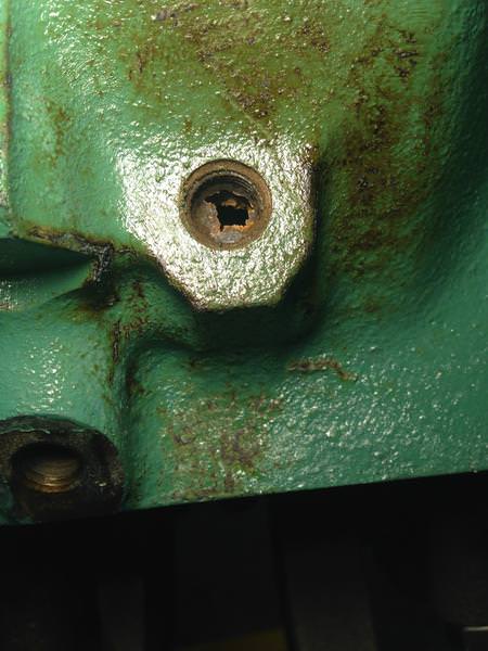

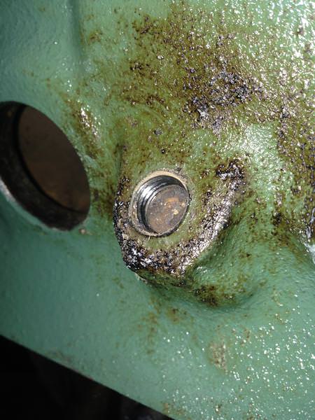

Yeah you're both probably right - I should deal with the drain plugs now... But I'm thinking I might leave them and save myself the stress of taking them out. We'll see tho. I'm looking into 8-point sockets as I write this lol.

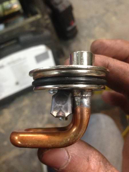

Those 2 block heaters can serve the same function as the block drains, but I would love to have a nice shiny new brass plug sitting there for when I drain the block next time.
I tried giving the block plugs several wacks with a BFH last night - Put a wrench on the plugs and they wouldn't budge at all... my wrench was flexing before anything else would...
Onto the 8-point socket set? Me thinks so. Fingers crossed I don't end up in the same spot as SDDL-UP.

So I caved... I HAD to get those block drain plugs out. May as well.. I'm here aren't I?

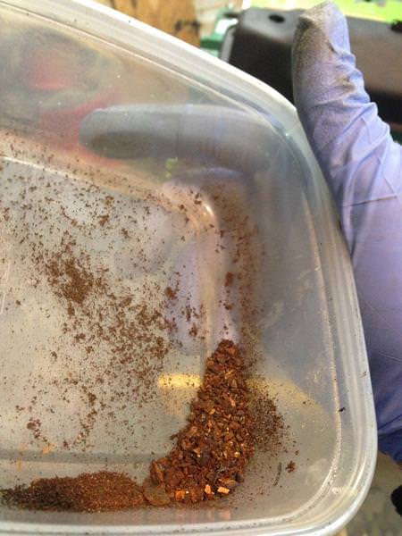

Driver side plug removed. PACKED with grit. So glad I did this.
Attachment 286039
Passenger side. Not so packed, but still lots in there. Pulled out the shop vac and my set of dental picks. Went to town.
Attachment 286040
Here's what came out... yeah...
Attachment 286041
So here's the two block coolant drain plugs / or drain bungs (whatever you call them) that came out. They're 3/8" square heads, 3/4" long, and have a 1/4" NPT thread -> That's pipe thread not straight thread like normal automotive stuff.
I got them both out by heating the crap out of the block with my MAP torch, then hammering a 6-point 10mm impact socket onto them. Grab the impact (electric), and let it work its magic. Out they came.
If you round the square head, hammer the next smallest impact socket on (9mm), and continue. Make sure they're still hot.
Attachment 286042
Attachment 286043
After some repainting, here's the finished product. 9/16" hex head, 3/4" long, 1/4NPT threads, just like the old one but with a modern hex head.
Attachment 286044

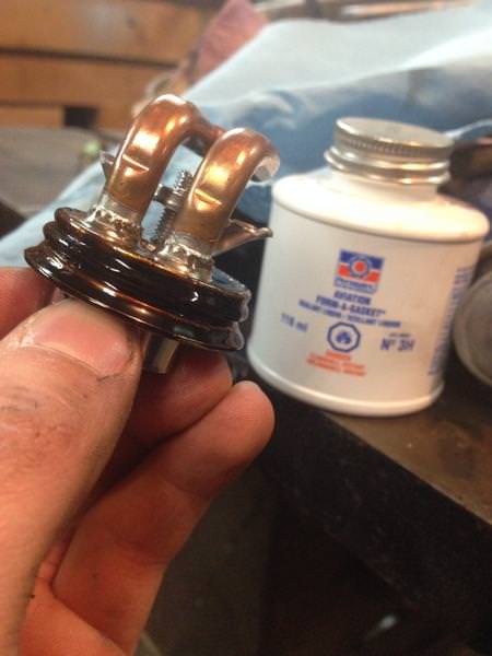

Threw the block heaters in.
Attachment 286045
Used some Permatex Form-a-gasket or Aviation Gasket (whatever you wanna call it). It's No. #03 on their website.
It's good to around 450 F and - 65 F, and stays tacky. It isn't affected by coolant or motor oils either. Should help that rubber o-ring seal nicely.
Attachment 286046

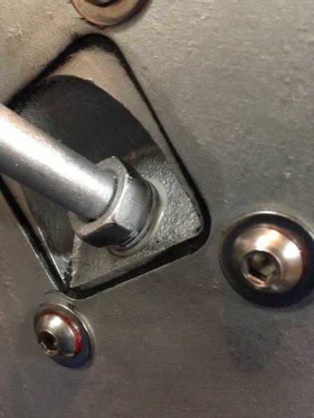

Masked + painted the oil dipstick tube retainer (name? Lol).

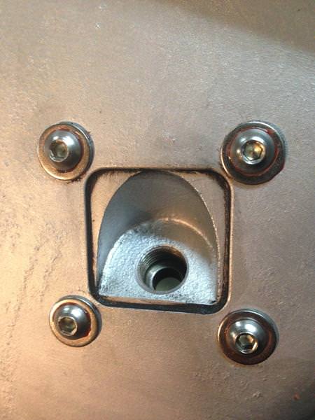

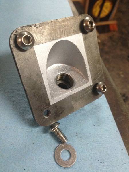

Attachment 286047
Tapped for 1/4-20 threads. Stainless hardware used to reinstall onto oil pan.
Attachment 286048
Permatex "The Right Stuff" used as gasket maker between pan and dipstick tube retainer.
Attachment 286049
Gave a pleasant "squish" feeling, with lots of oozing when torqued down.
Attachment 286050
Permatex RED thread locker used for stainless hardware, cleaned up the excess on the outside for looks

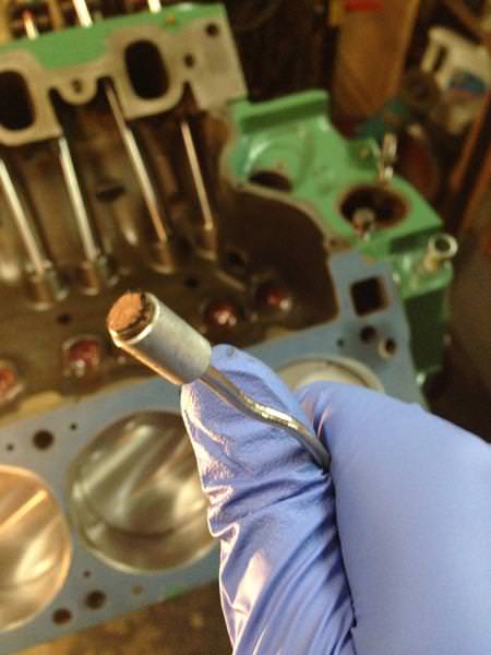

Moroso 17000 - 1/2-20 magnetic drain plug installed. Torqued to 20 ft-lbs.
Attachment 286052
Permatex High Temp Thread Sealant used on the dipstick. Should work perfectly without leaks!
Attachment 286053

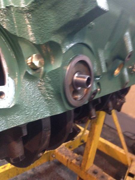

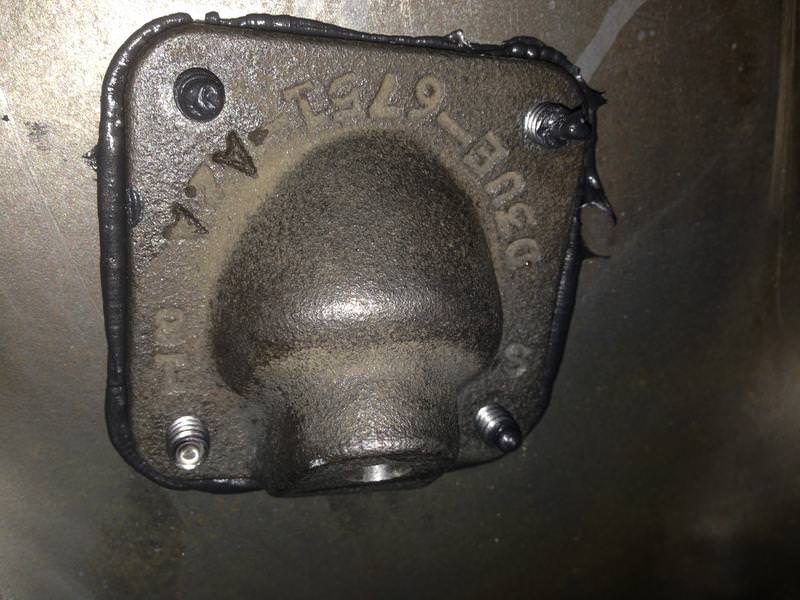

Threaded my block bung / block oil filter adapter on. Allstar 92003.
Attachment 286054
Says it's for a SBF (302-351W) - but it fits both the filter AND the block perfectly. They should update their info so it reads 351W / 351M / 351C / 400 under applications
Attachment 286055

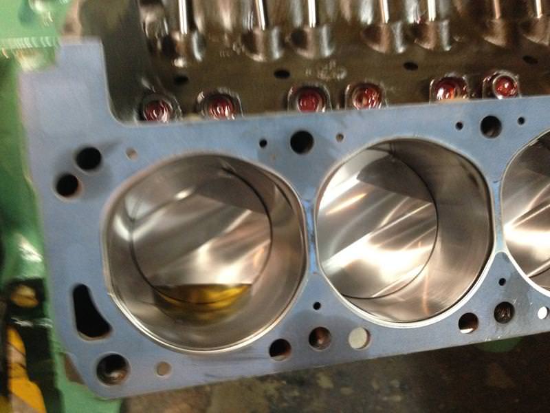

Now the back-tracking... YAY....

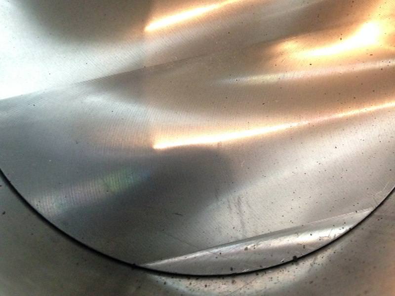

See the brown at the bottom of the spark plug hole? Yeah... that's all grit, dirt, and grime left over from when the shop cleaned the heads. Guess where it ended up?
Attachment 286056
In the cylinders of course...
Attachment 286057
Attachment 286058
So as you can tell... I pulled the heads. Cleaned everything up.
Attachment 286059
Here's the worst cylinder. Driver bank, cylinder #6.
Attachment 286057
Worst part... some of it is metallic! Threw a magnet down the cylinder to see if any of it would stick, yup! It does! Oh Joy!
A fresh motor with grit in the cylinders... Just what I ordered...
Attachment 286060

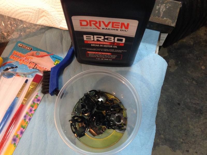

So I cleaned it all up with a clean nozzle on the shop vac. Grabbed lint free rags, and some break-in oil. I wiped down each cylinder until it was CLEAN.
Then re-oiled with BR-30 Break in oil that I'll be using. Made sure to coat all internal surfaces with BR-30 before buttoning back up.
Attachment 286061

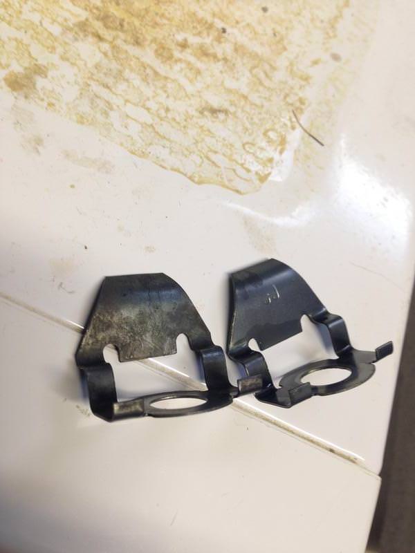

Threw these on (which the shop forgot about) on my way back up...
Had to clean them first. They were pretty dirty. Clean (right), dirty (left).
Attachment 286063

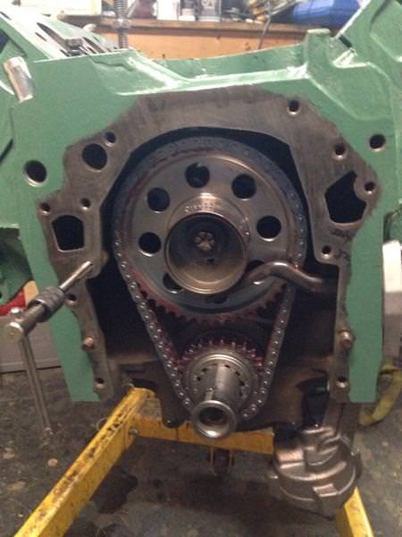

Notice on the shop towel? Figuring out exactly how to turn the motor over as little as possible to retorque while the valve is 100% closed.
Attachment 286064

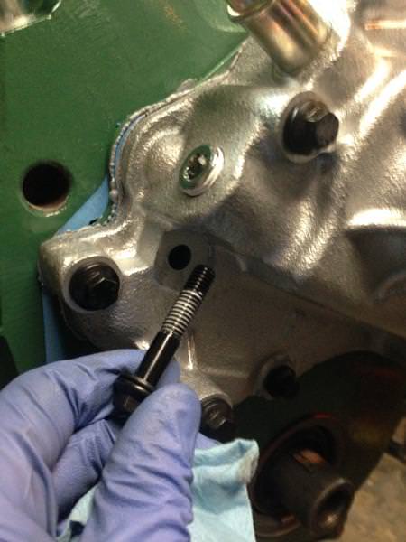

I referenced the Old 1979 Ford shop manuals, and it had a nice detailed write-up in there. Thankful I grabbed those manuals years ago

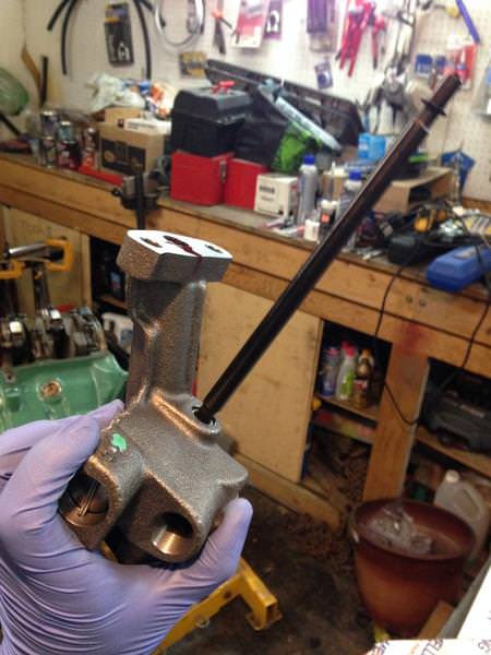

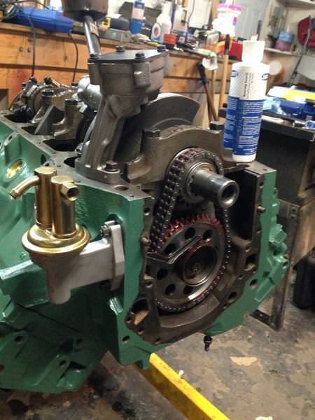

Installed the fuel pump and the oil pump. Don't want to forget the little things like the oil pump drive shaft either!
Attachment 286066
Oil pump primed by hand with Clevite assembly lube before getting torqued down to 25 ft-lbs.
Attachment 286067
Chased all the other threads on the block to ensure correct torque readings from my wrenches.
Attachment 286068

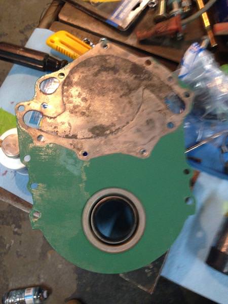

Got my timing cover all figured out. Paint + seal.
Attachment 286069

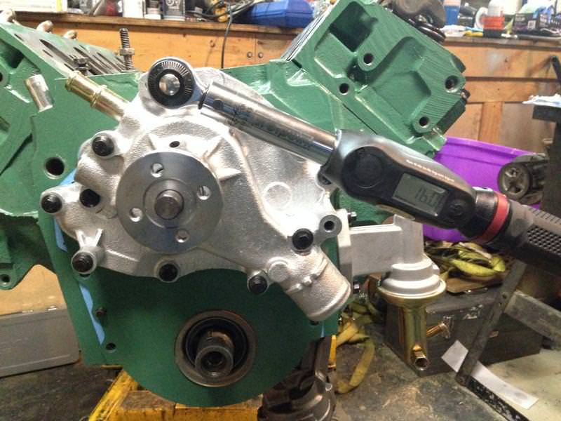

Water pump installed on timing cover before the assembly got installed on the block.
Torqued water pump bolts to 16 ft-lbs.
Attachment 286070
High temp thread sealer used where appropriate (water passages). ARP Torque lube used throughout everywhere else (where water/coolant isn't present).
Bought Permatex High Temp Water / Coolant RTV for the water pump passages. You can see the grey oozing out in the photo. Wiped up the excess for looks
Attachment 286071

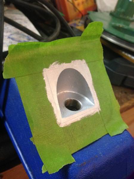

Tossed the intake on temporarily. Had to do a lot of grinding on the front of the intake to get the Water Neck to fit right. Couldn't get a socket onto the bolt!
Attachment 286037
