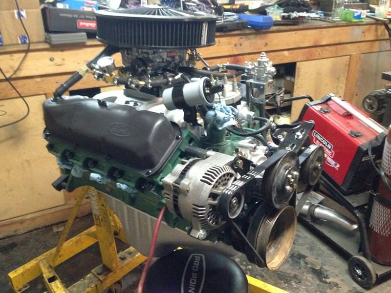

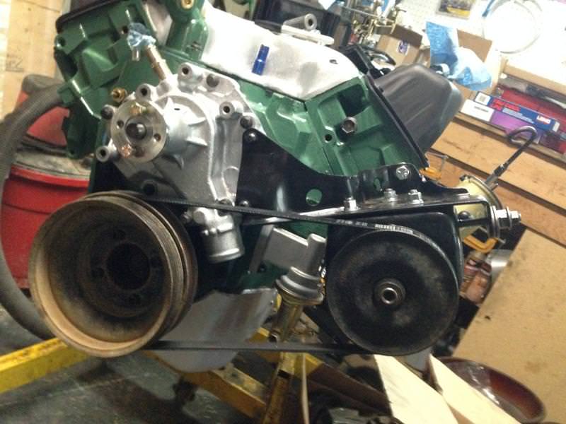

Update time. I've been hard at work, just have no time to post. Still need to check my end-play with the distributor. Thanks for the suggestion Crop Duster.

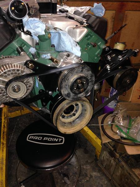

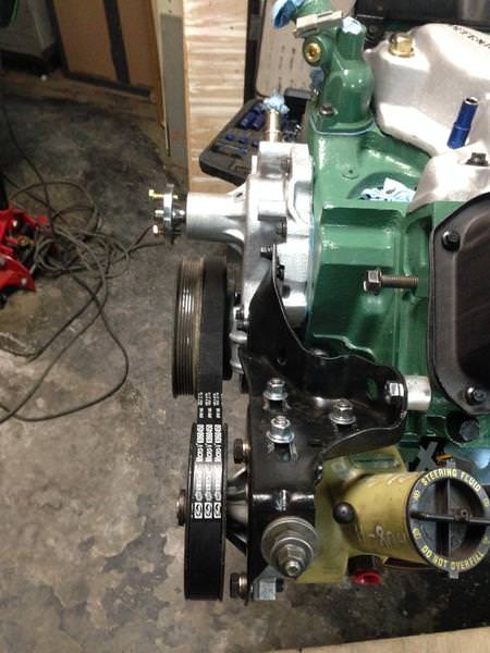

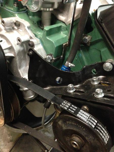

Serpentine system is finished.
In my research, I've found that this exact set-up was done before but was not well-documented. I plan to do a write-up for everything I did. Just need more time to do it.
Attachment 285703
Belts all line up nicely.
Attachment 285704
Attachment 285705

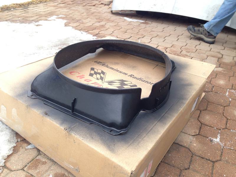

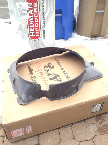

Painted the radiator shroud. Before.
Attachment 285706
After - with Color Bond 42-0750 Vinyl, Plastic, Leather Paint.

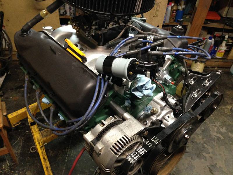

Went through all my spark plugs and wires. Cleaned everything, gapped them, and checked resistance ranges. All was good.
Attachment 285708
After cleaning/gapping.
Attachment 285709

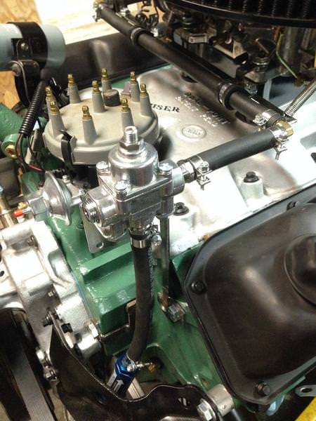

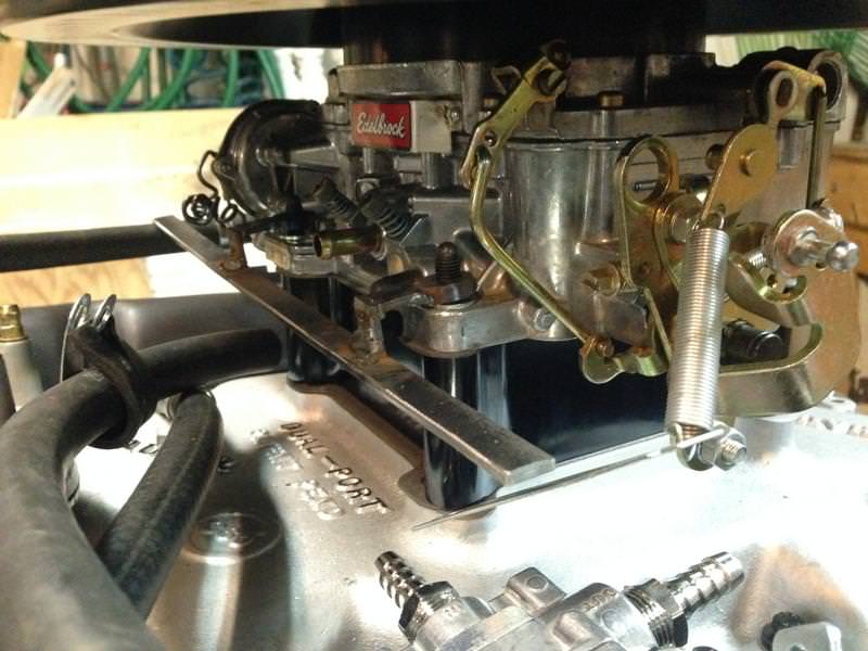

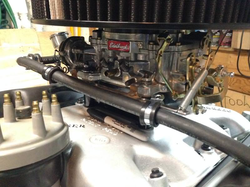

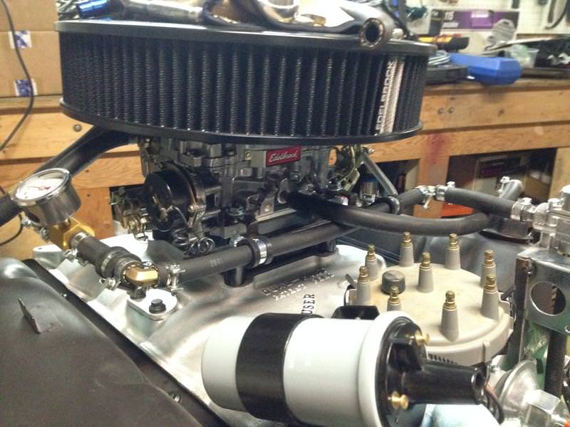

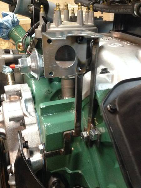

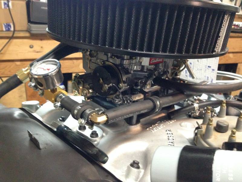

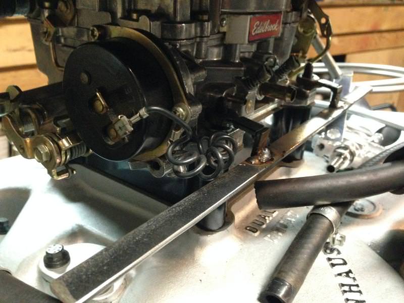

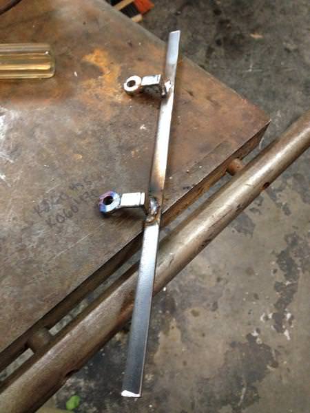

Stole this idea from tbear863. Carb mounting plate for fuel lines.
Attachment 285710
Hangs off the protuding carb studs to help keep my stuff organized.
Attachment 285711
Attachment 285712

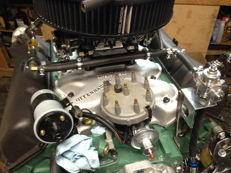

Mounted all my fuel line, pressure gauge, and 3/4" electrical cable holders to keep it all steady. She's solid.
Attachment 285713
I even made a slot for my return spring. Much more sturdy than that flimsy piece of aluminum Edlebrock gives you.
Attachment 285714
Birds-eye view of routing. I know it's ugly, but it's functional.
Attachment 285715

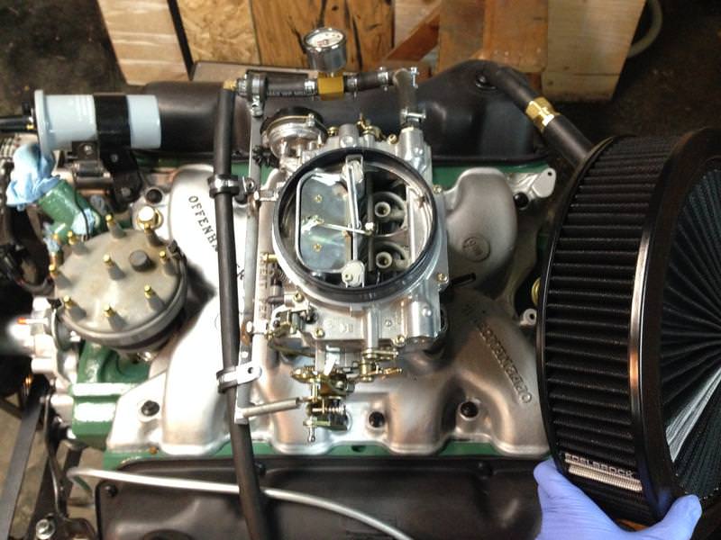

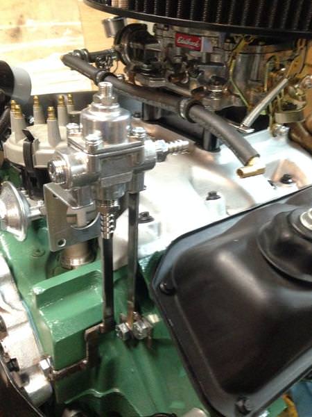

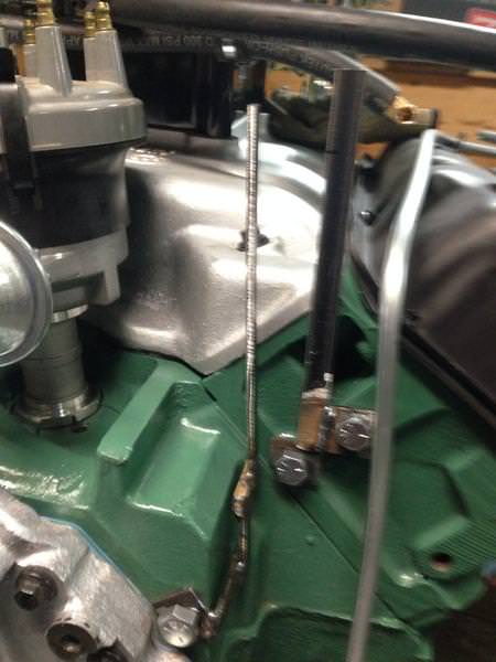

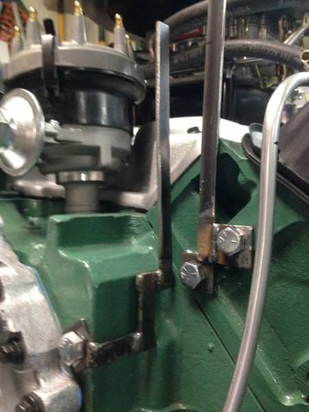

Needed somewhere to put the fuel filter and the pressure regulator that had easy access, but was removable if I didn't like it. This is what I ended up with.
Attachment 285716
Attachment 285717
Attachment 285718
More ugly on top of my motor, but it's very sturdy and very functional. Adjusting everything will be very easy.
Attachment 285719
Hid my Earl's Performance fuel filter behind the power steering bracket. Didn't fit the theme of the engine lol.
Attachment 285720
Attachment 285721
Fuel system is ready to go. Just some minor cutting on that bracket that was welded together for the regulator. Everything comes off by removing 2 nuts, 3 bolts, and 2 hose clamps. Easy.
Attachment 285722
Attachment 285723

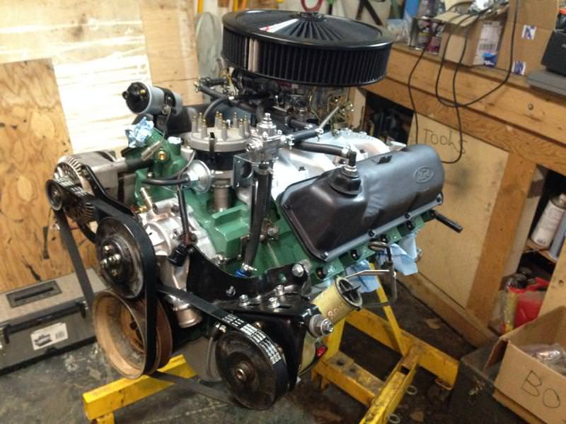

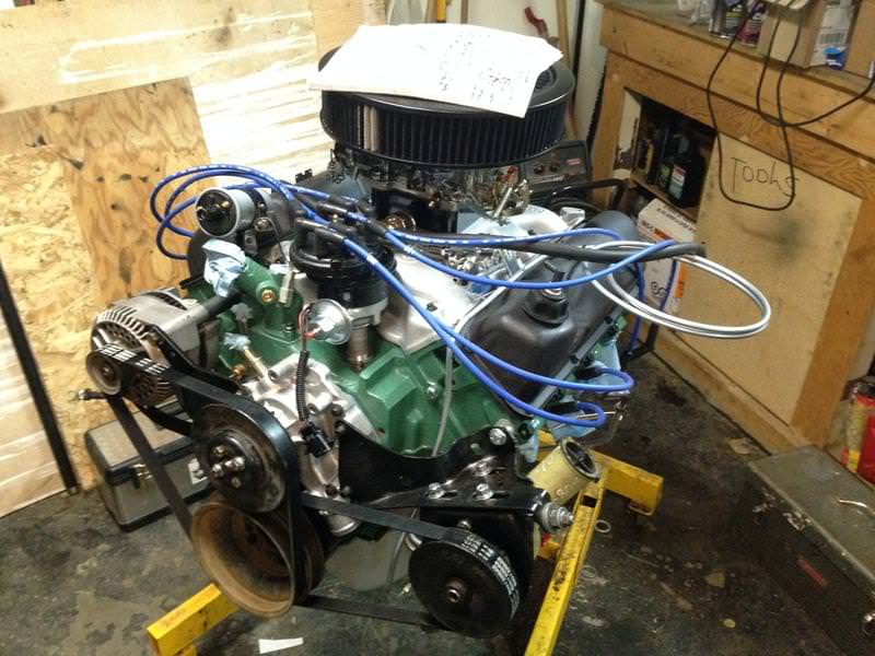

The motor as it stands. Very little left to do before tossing it in!
Attachment 285701
Attachment 285702

Mebbe it's the picture angle....but are you going to have enough room between the coil and radiator hose?
Old Mar 29, 2018 | 09:25 AM
  #209
Aaron-71's Avatar
Aaron-71
Joined: May 2010
Posts: 4,436
Likes: 19
From: Regina, Saskatchewan
Originally Posted by KubotaOrange76
Looks really good nice work
Thanks! I appreciate the compliment cause I thought it looked kinda ugly lol.
Originally Posted by Filthy Beast
Movin' right along......looks good!
Thanks
I slid the coil forward to have more room between the fuel lines and the back of the coil. Kept hitting my hand against stuff while I was working. I can slid the coil back if needed, no biggy.
