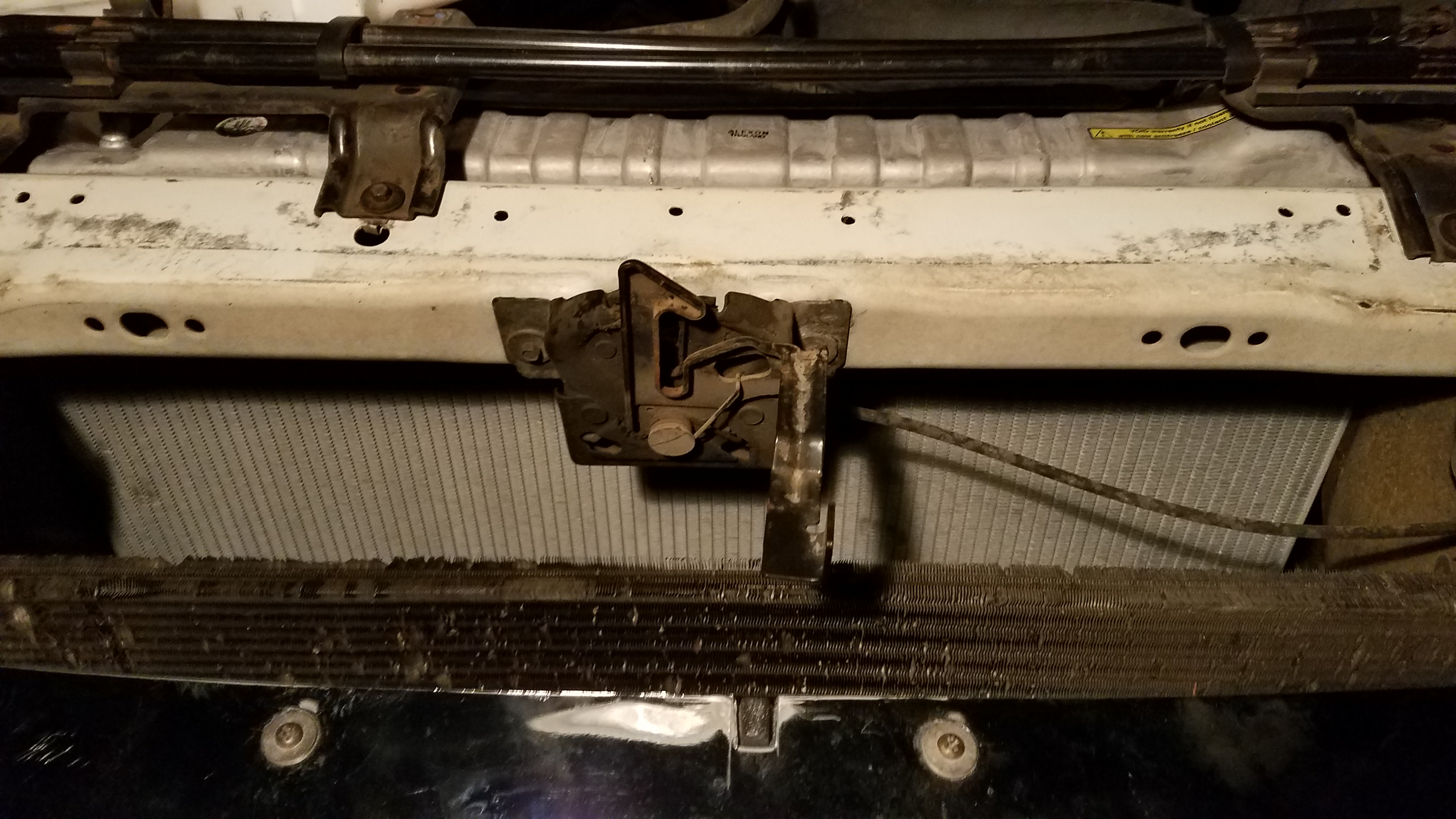

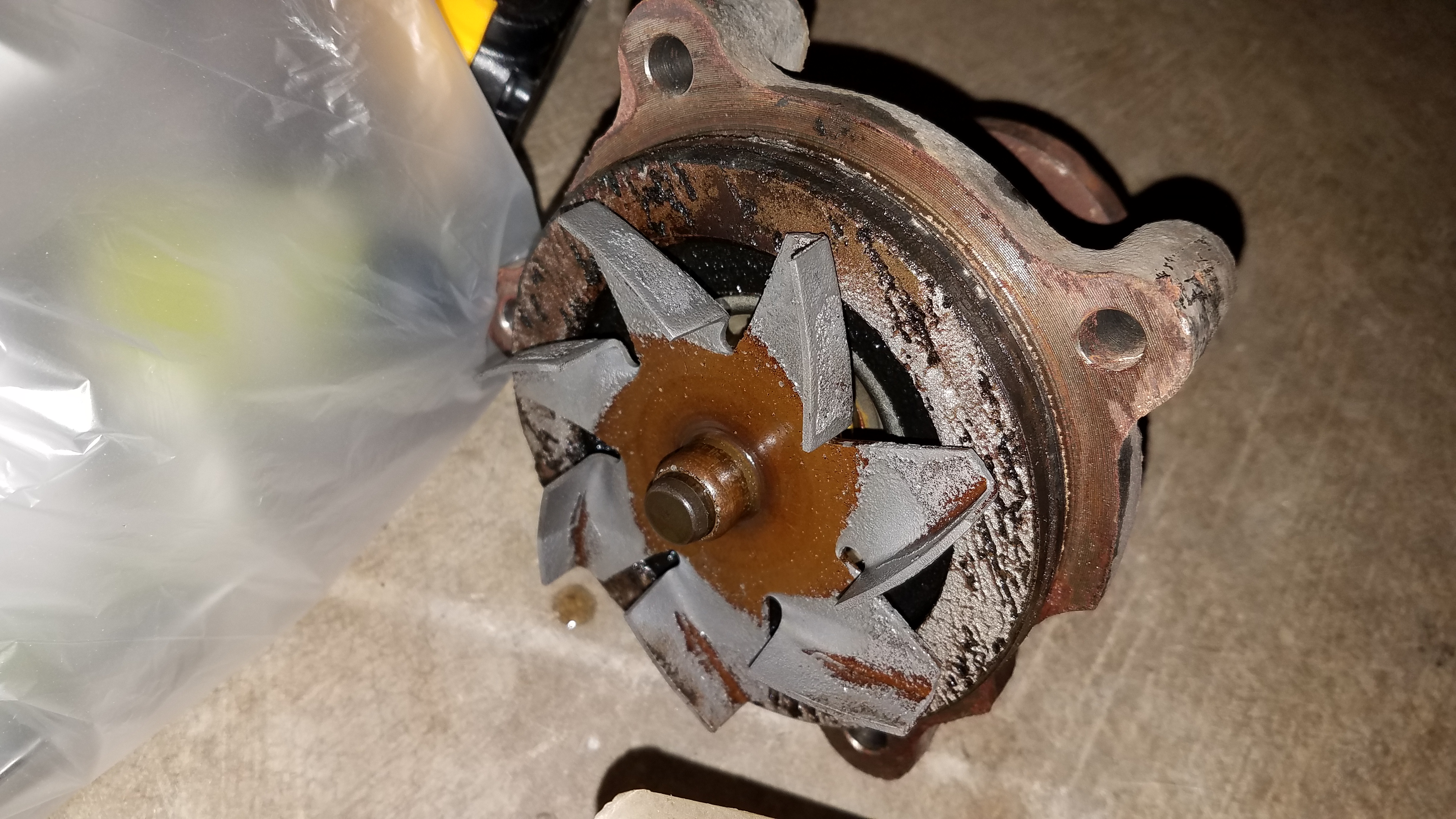

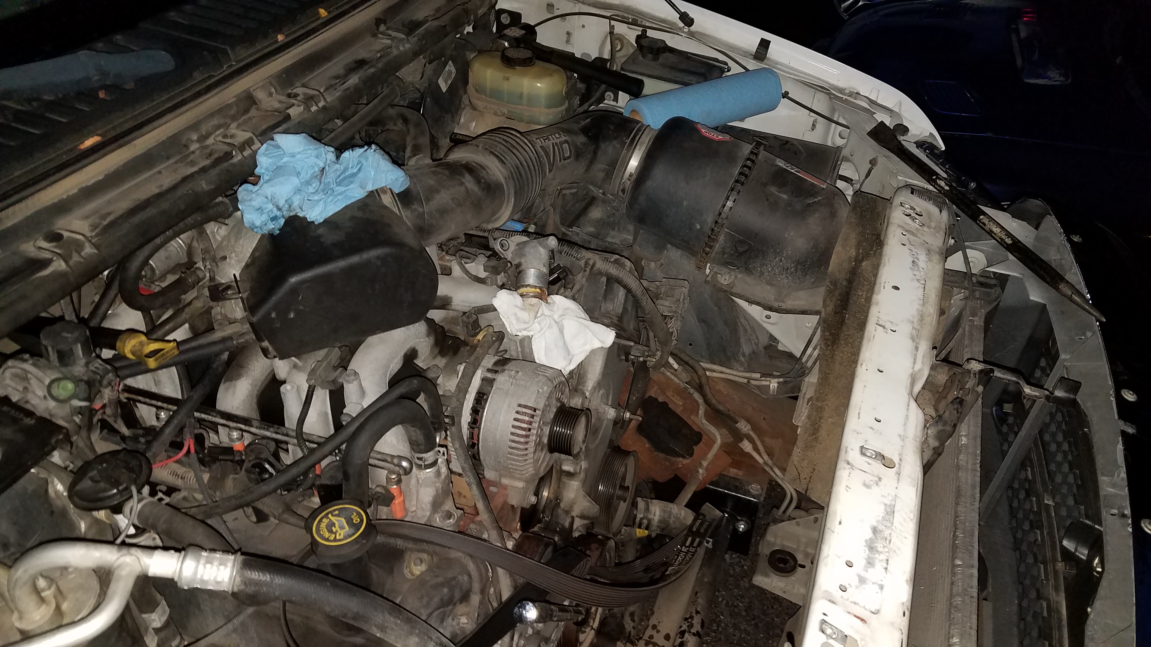

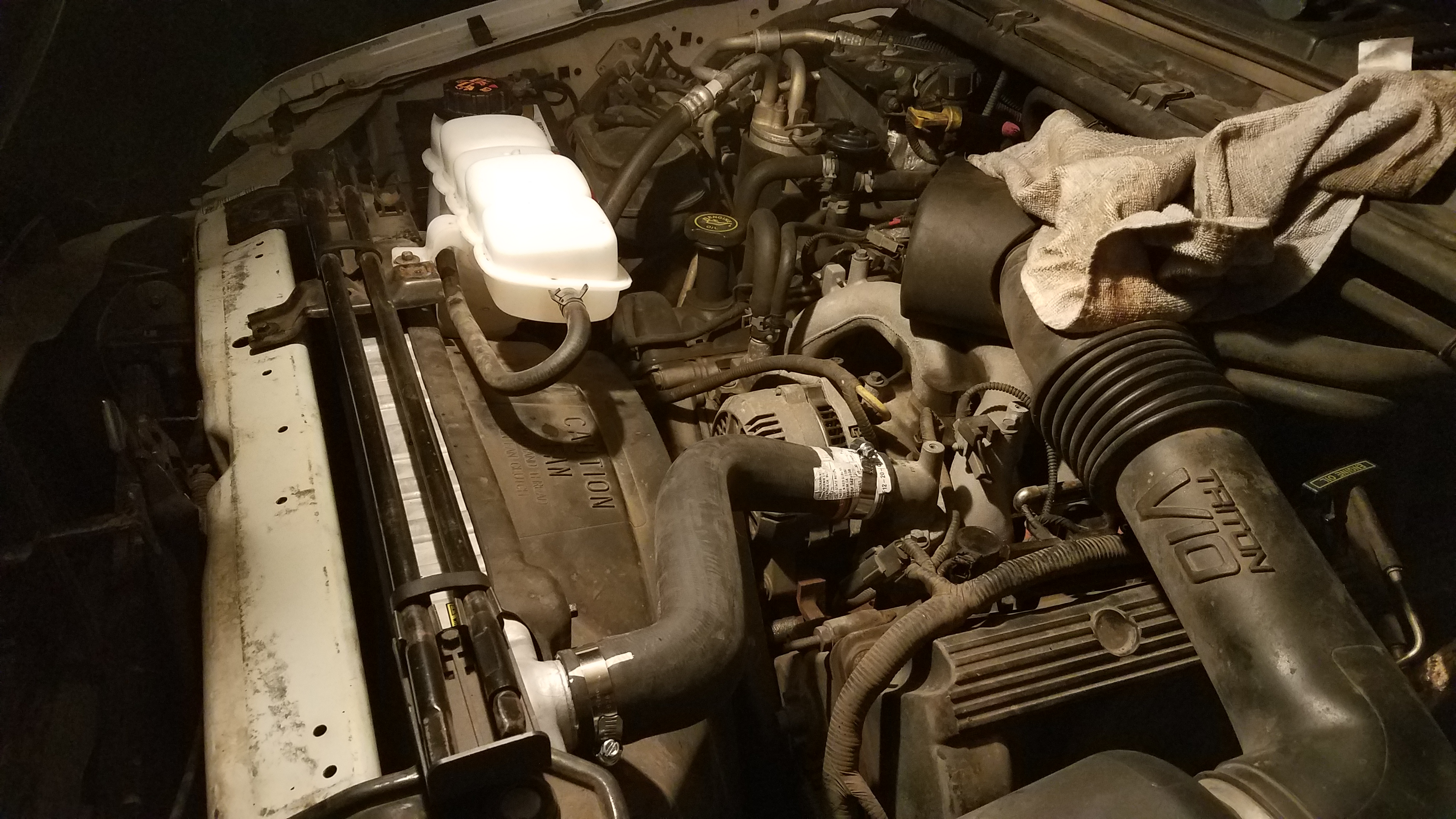

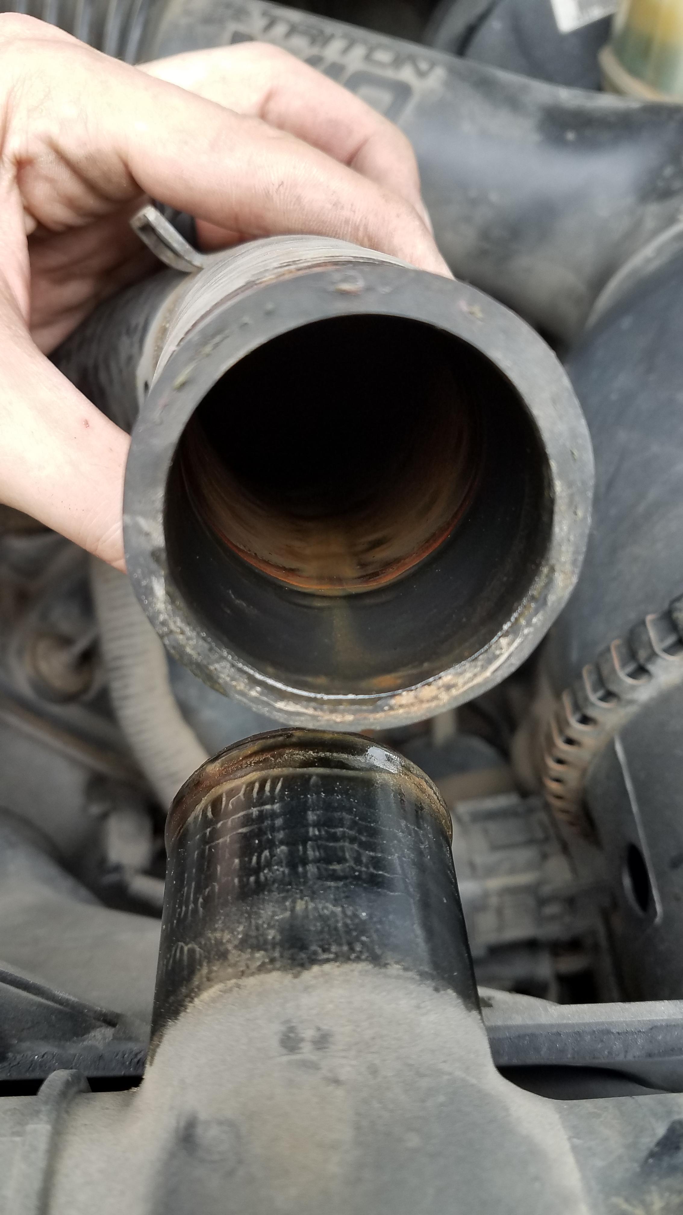

Pics of job
Attachment 287609
Attachment 287610
Attachment 287611

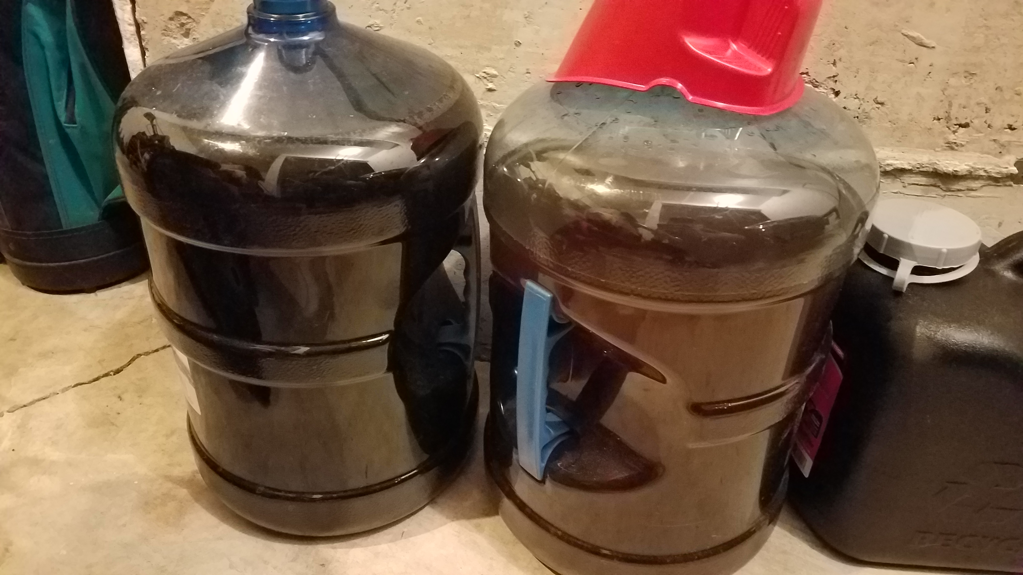

Jug on left is from last flush, jug on right is only 6 month old coolant...
Attachment 287612
Burnin the midnight oil
Attachment 287613
new water pump
Attachment 287614

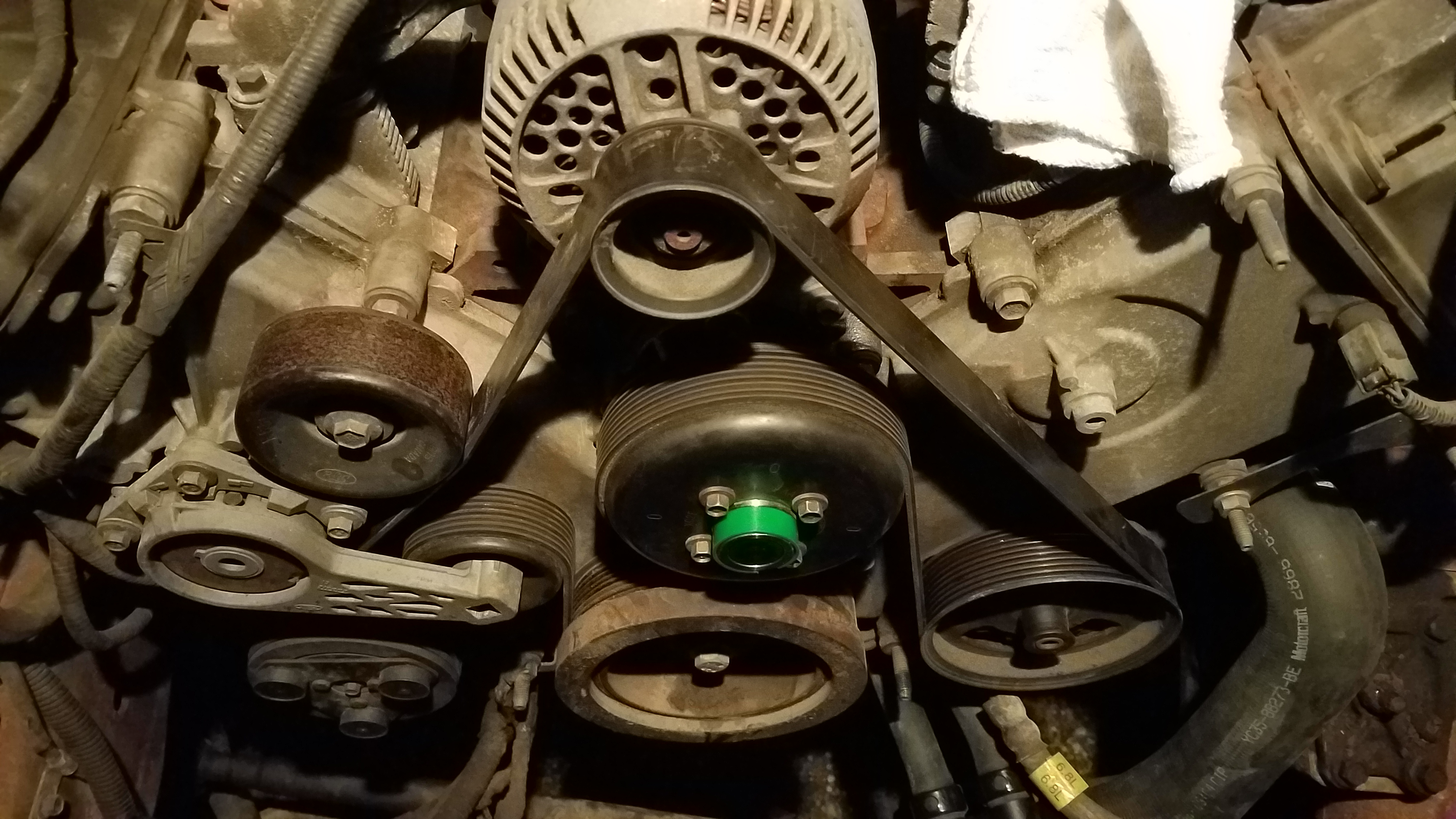

put back together
Attachment 287615
Attachment 287616
Attachment 287617
Attachment 287618
Attachment 287619

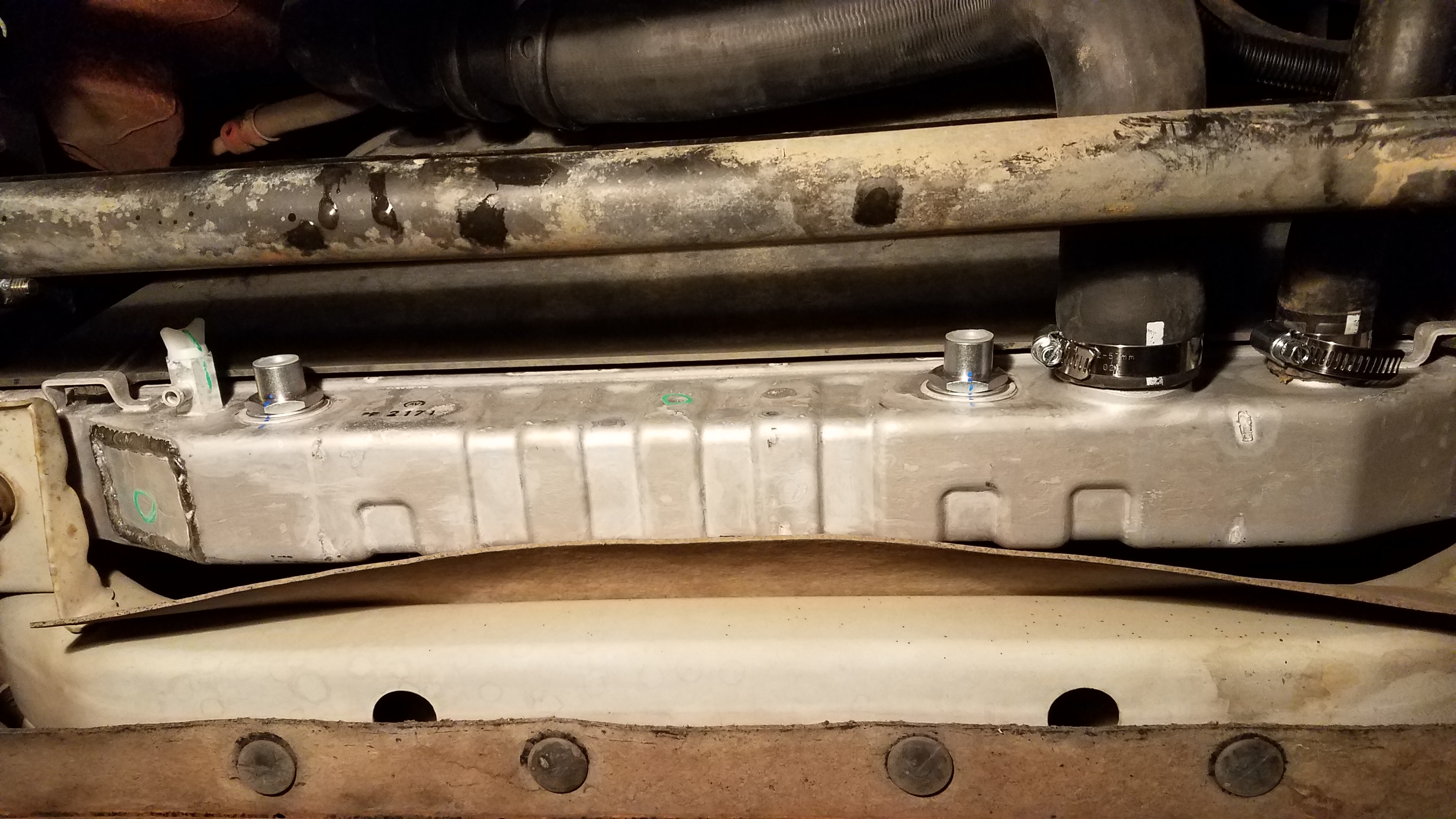

@Onug I watch Fordtechmakuloko and ETCG, seems they're the best quality, some of the others have a foul mouth IMO.
@NW Looks like your Radiator has provisions for a OTW cooler, I added it to my truck and was well worth it. You'll need a couple of hard lines, shouldn't be to difficult of an install. My thread below with some part numbers.
https://www.ford-trucks.com/forums/1380248-lettuce-discuss-4r100-transmission-temps-mark-k-i-request-your-input-4.html
awesome, thanks! That would be a good upgrade.

Up and running with the first flush. Tstat is out and it was late, so I could only get the temps up to 160s without risking annoying the neighbors or getting too far from my house to get stuck with a dead Ex.
Will keep flushing the next few days and put coolant in on Friday.
Had two codes. Reset them so I can monitor how things go with Torque Pro.

First flush is through and drained. Second cleaning is in now. Ex seems to be driving fine so far. I don't smell anything funny. Not sure what else to look out for except to drive until something happens. New coolant and oil will go in tonight. Got coolant temps up to 185 without the tstat out, and that was screaming up 204 into Lake Stevens with OD off. Cylinder heads were reporting up to the 210s range. I don't know what is expected range for that temp.

Originally Posted by NorthwesternCowboy
Oh, yeah, I emptied my bucket into these because my other huge transporting jugs are full already lol. I use a bucket and some rubber hose for nice easy, no-attention-required draining
I saw the two 5 gallon water jugs and then the gallon water jugs. Do you put the rubber hose on the petcock/radiator drain? Sounds like something I should do next time. I usually just crack it and move the bucket as necessary.

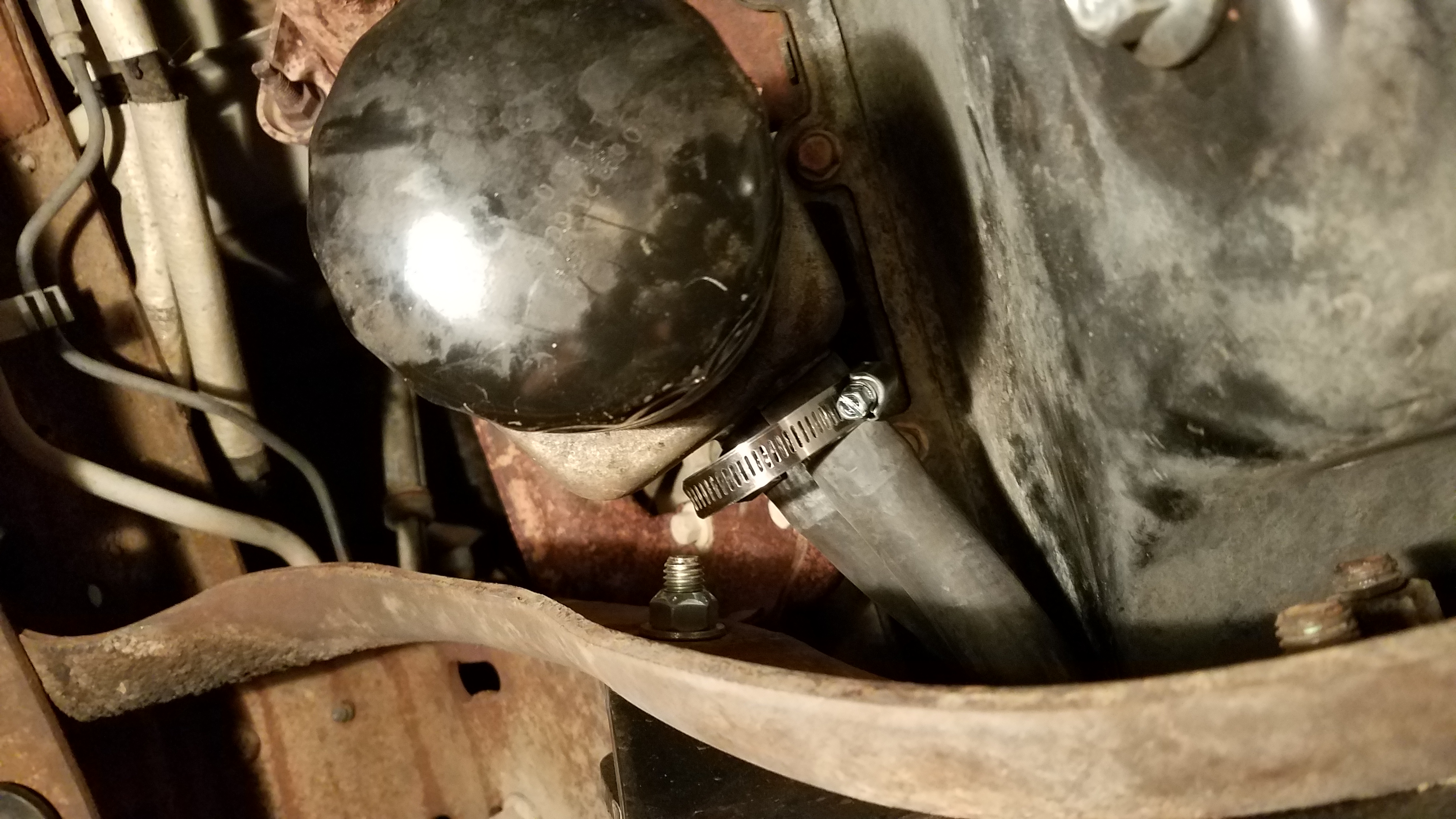

yep, same hose i used to bleed the brakes. Slides right on to the petcock. Anchor the hose high on the bucket and no moving/adjusting necessary!
