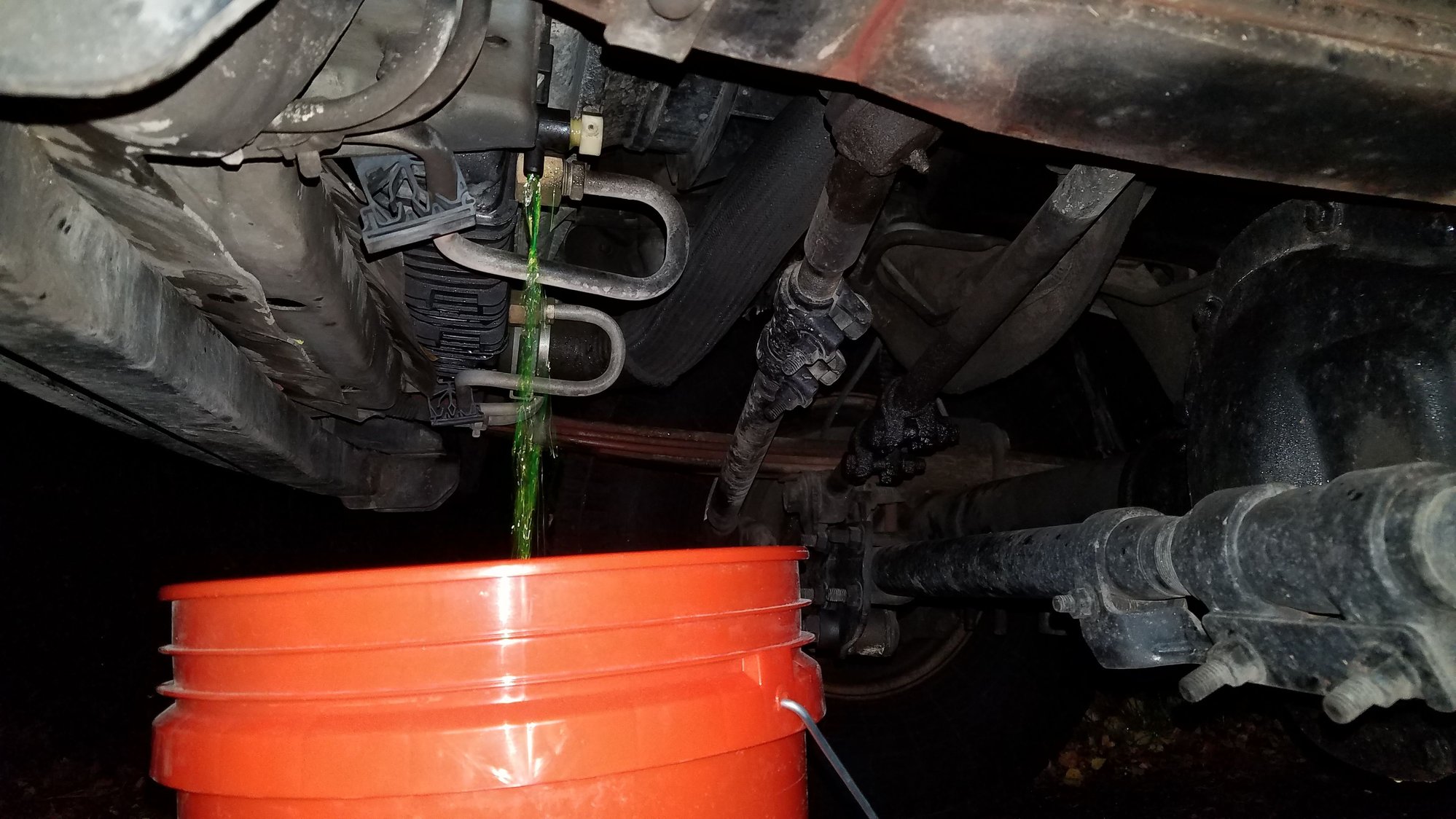

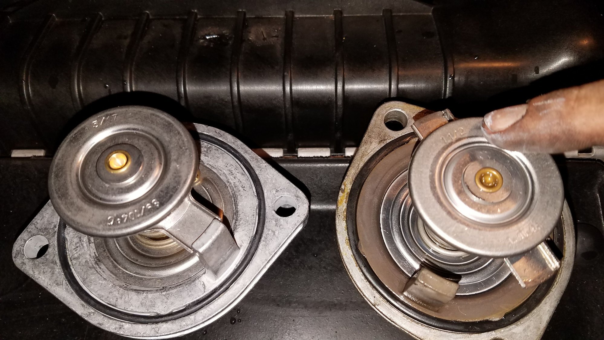

I'll check that out tomorrow. I went ahead and drained the green tonight and through an oreillys motorcraft tstat/housing combo in the ex, than ran flush and distilled water for a half hour drive. I just drained from the petcock tonight, but I'll try to pull the block plugs tomorrow since the coolant leftover should be pretty diluted I'd imagine.
Fun story - check out the tstat I pulled. Dated 11/02... no wonder I was seeing temps in the 170s, the tstat has 216,000 miles on it, lol!! Ran at 188-192 for my test drive tonight with the flush and the heaters blow nice and hot. Everything I took apart appeared to be in good shape, so I'm feeling pretty good about this rig. Rotella ELC going in after the flushes (the red one is what Tractor Supply had). It was really fun to rip into the 6.0, I told my friends I was earning my amuetur noob diesel tech license =P

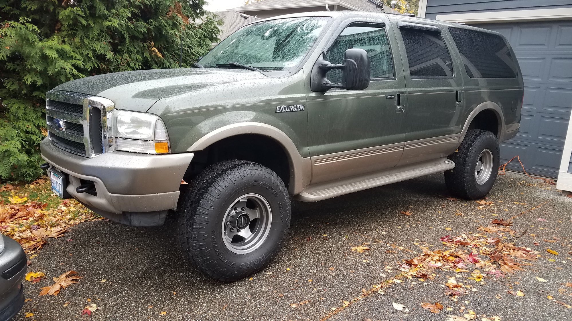

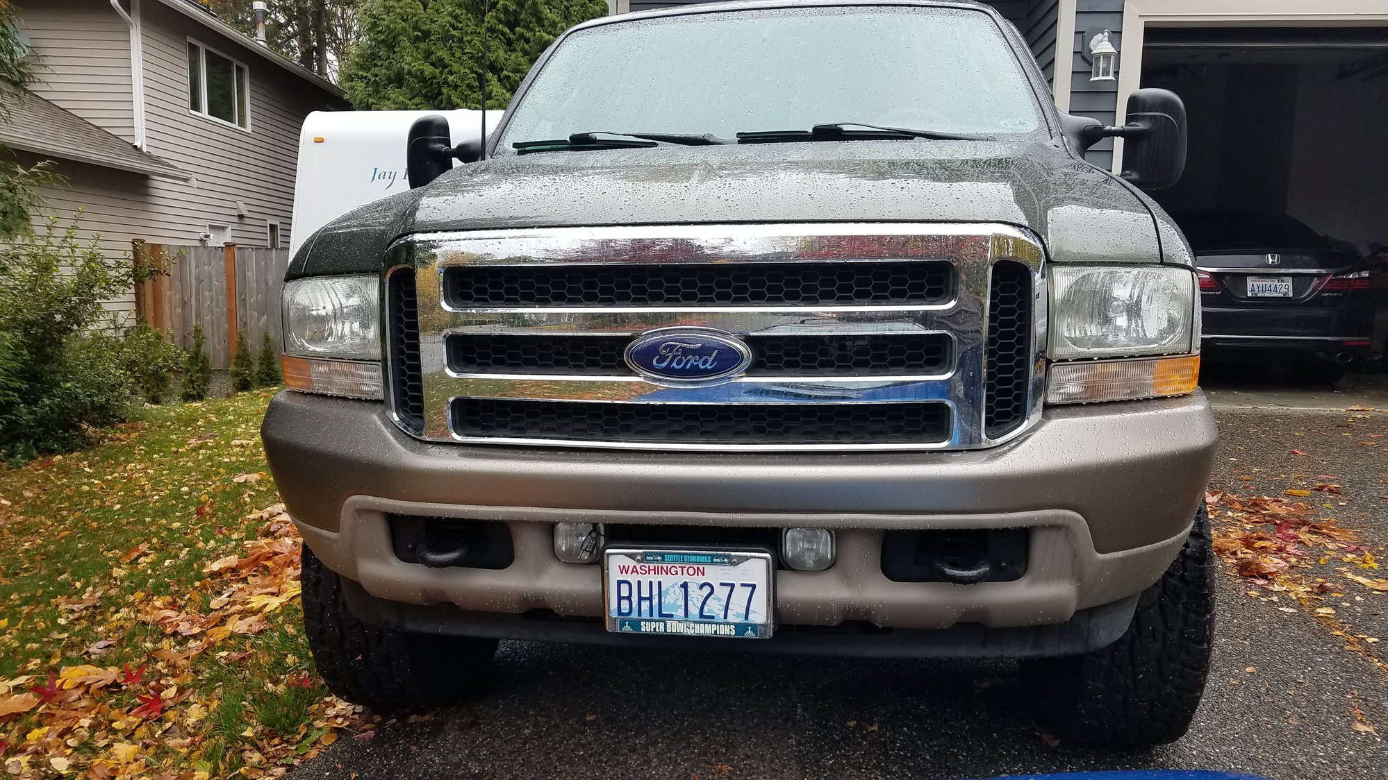

I also swapped the chrome 05-07 grille over to the green Ex. Looks much better than I thought it would, which is a pleasant surprise.

Forgot the grille pic I mentioned above.
