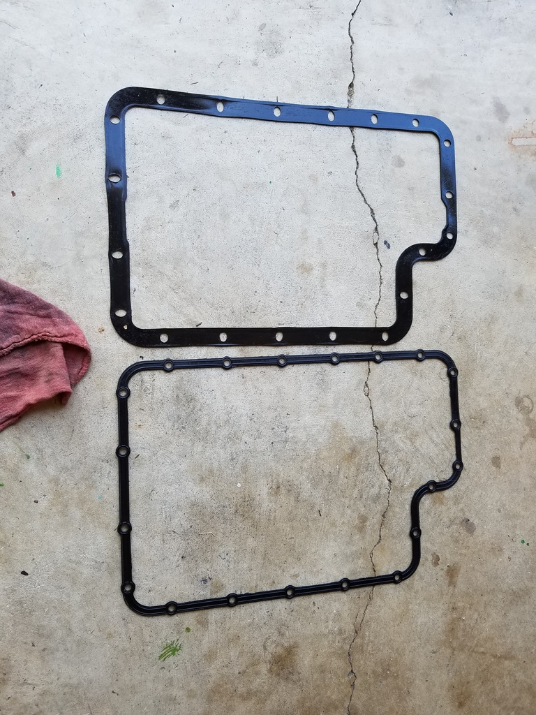

Thanks Scott and I do appreciate your comments and input always!
I've always lived the life of danger, taken a few chances, like this gasket
and probably why it leaked for sure
compared to the real Ford gasket

Thanks for posting the gasket picts -- big difference there for-sure... Good luck with that "dangerous" Wolfs Head too -- I'd take it back and pay the extra $2 per bottle x9 myself -- ask Sean what a tranny costs ok, that's it from me for friendly nudging, but if you come back talking about a shifting problem or slipping clutches... Not really, I'll still feel for your pain...

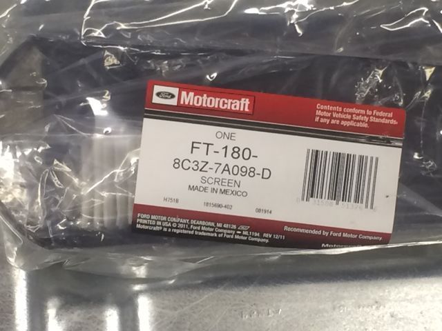

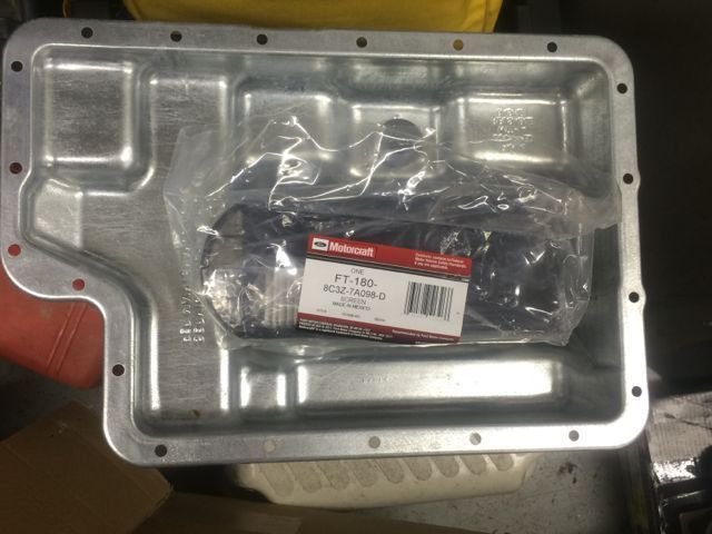

Well this is what I have sitting on the shelf in a box. I opened it to see that
that crap gasket was there or not. It's not. Also thought I would post the
part numbers for everyone.
If I go pick up some fluid I may do the install this weekend if the rain stops.
And while I am at that I will install the new drag link I just had come in today.
Oh what fun steering and transmission work.
Sean <BR>
6.0L Tech Folder
So Sean, the Pan Assembly # now gets you both the pan and the filter? Because that is the same number I ordered back in '13 and I just got a pan...

From: Jersey Shore
my pan box just has a pan,

Posts: 6,496
Likes: 94
From: So. Jersey
Same here, just a pan. The filter is separately in it's own bag and part number.
I imagine Sean has them stored together for ease of locating them in his garage's categorized filing system.
^^^ Someone knows about my filing system.
Toss things that go together in the same box when you can.
Pan only in the box. The guys at the dealership just used the box for shipping.
I posted the part numbers for the pan and the filter.
