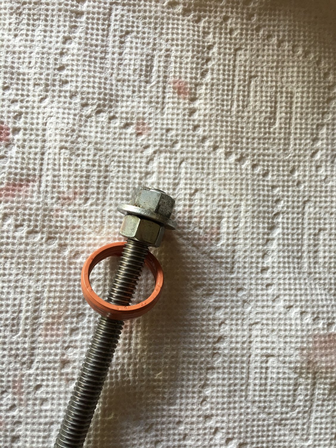

Not so easy....
Got a little quandary here guys after playing for 45 minutes. That little orange o-ring seal will not come out of the trans. Won't move with finger force. Made a tool out of a wood dowel, nope. Even went to using what shouldn't be used, a steel o-ring pick and it won't budge. Really don't want to force the new ring off the new filter and reuse the old ring where it sits, but there may not be a lot of choices here soon. Ford warns of failure if that aluminum bore is scratched with the tool I already used, so anyone WHO HAS DONE THIS with suggestions?

do you happen to have any angled needle-nose pliers? I would also consider plastic tools, if you don't have something, try to make a "puller". I have some dental picks, but I would be VERY careful trying something like that...

Non-invasive:
Hair dryer and PB blaster. Let it soak to soften and get behind the seal. Then try pulling it out.
Invasive:
90° pick jabbed into just the rubber o-ring partially.
X-acto knife and score the rubber being careful not to draw the blade through but just push it straight in to score the rubber. Then try pulling it.
For me they usually come out with the pick poked into just the rubber seal halfway and pull down.
You could make a tool out of Lexan with an L or hook on one end to pull it. That won't hurt the bore.

Jack: IIRC it is a reinforced seal, so I don't think you could cut through it all the way to the pick-up bore... PB Blaster sure became my friend, but didn't need it for this.

Got it!
I was looking around the garage for other dowels and plastics.... Have some HDPE but I sent aluminum rods I had back to McMaster just last week.
I ended up making a puller out of 3/8" washers, nuts and threaded rod, using the smooth punched through side edge towards the seal so it wouldn't scratch. I had some nylon washers but couldn't back them enough to get a good purchase on the seal. Man I didn't want to scratch this highly polished bore after reading in the manual, "Don't scratch the bore". I was able to grab it best towards the back of the truck.
Thanks for the thoughts guys. Now I need to go buy a new OTC O-Ring pick as I bent this hardened one and those molecules don't take to bending well.
